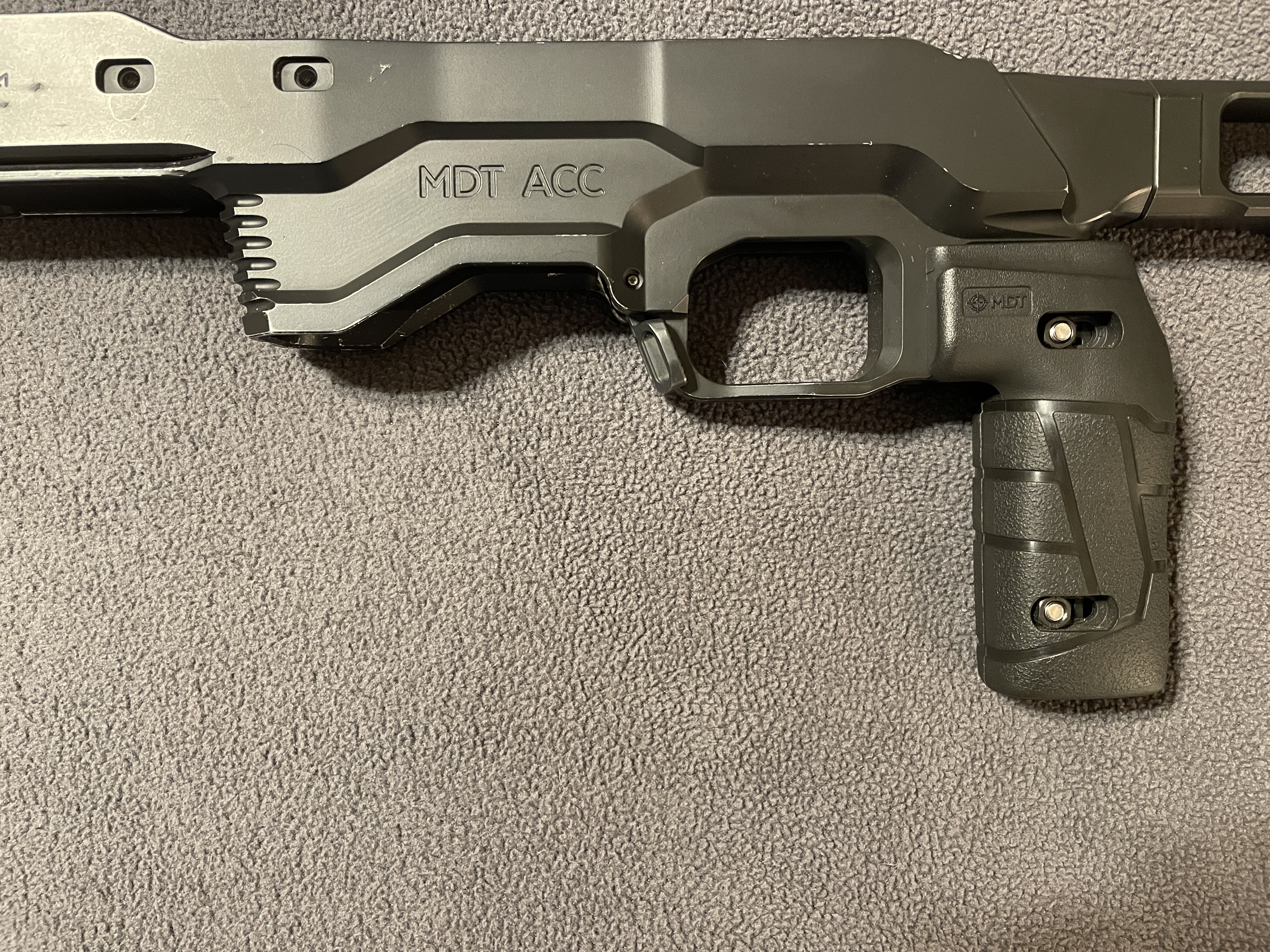

SOLD MDT ACC Premier Chassis for Rem 700SA $675
Black MDT ACC Premier chassis for Rem700SA right hand. Includes rear bag rider. It's in good shape overall, but it is used, so it does show minor signs of wear in the predictable areas like the ARCA rail and other high touch surfaces. $675 shipped to you in the lower 48. PP F&F or Venmo.
