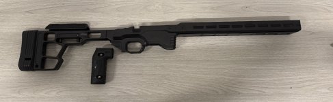

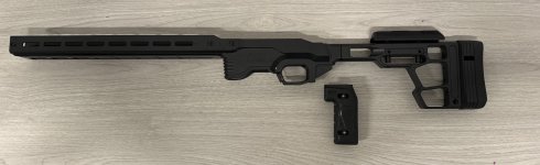

Accessories Foundation Centurion 737R $1100 (SOLD)
Saw a season of PRS use, some very light scratches in select areas.
$1150 shipped for stock + arca
Also including the 360 precision cheek piece quick adjust knob.
I also have an OTM bottom metal, internal tungsten weights, and an external (forend) 2# tungsten weight that I can include if interested.
On their own, I’ll split with the OTM bottom metal, Internal Tungsten weights, or External tungsten weight for $100 each but as a bundle I can definitely make it more of a deal.
