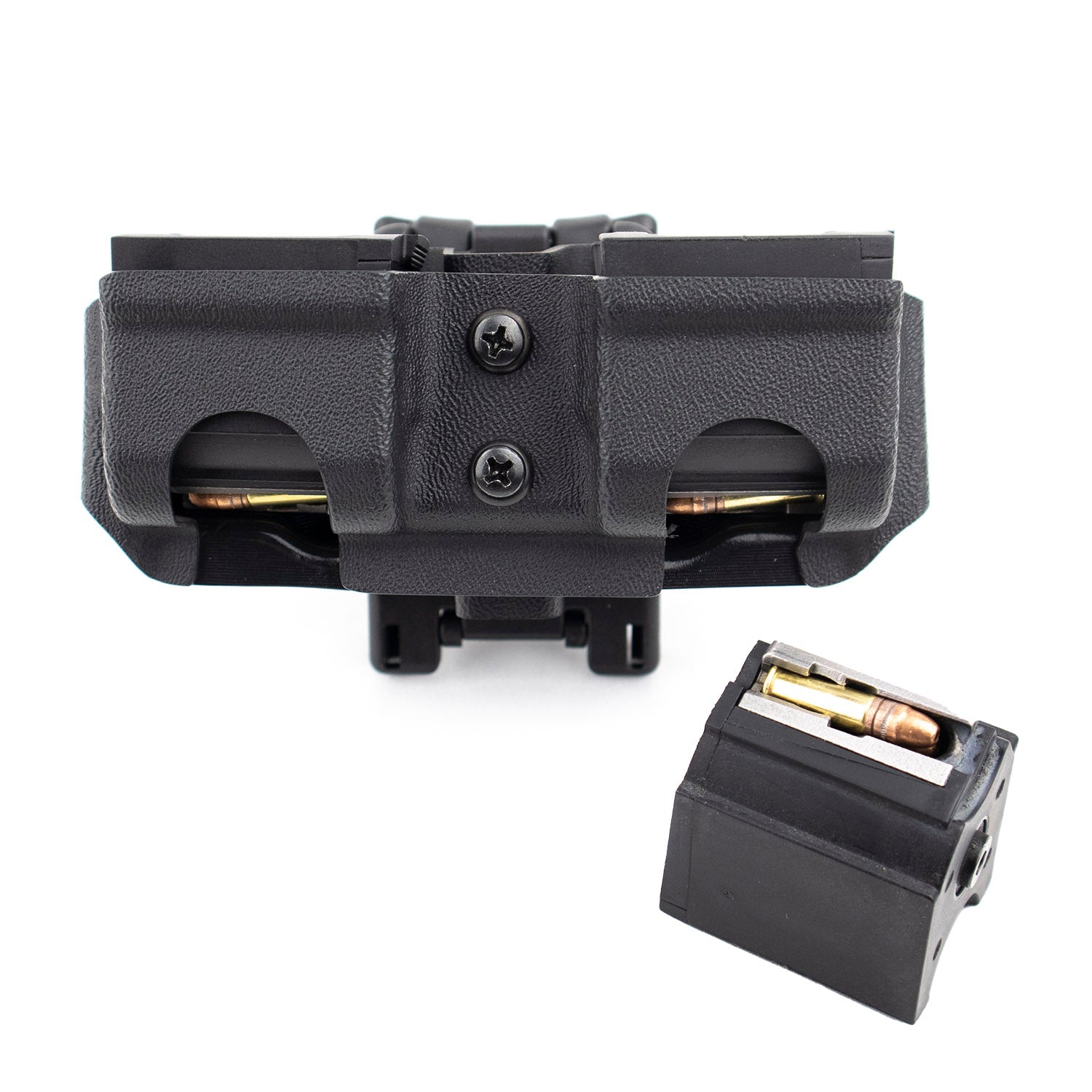

Got one of these delivered yesterday from Canukistan:
Seems very well made and only mag carrier I've come across for the T1x. They also make them for the CZ 457 and Savage Mk II.
Shall see how it does at two matches next weekend.
They work great, even with the MKM mag extensions. I have had one for about a month.
