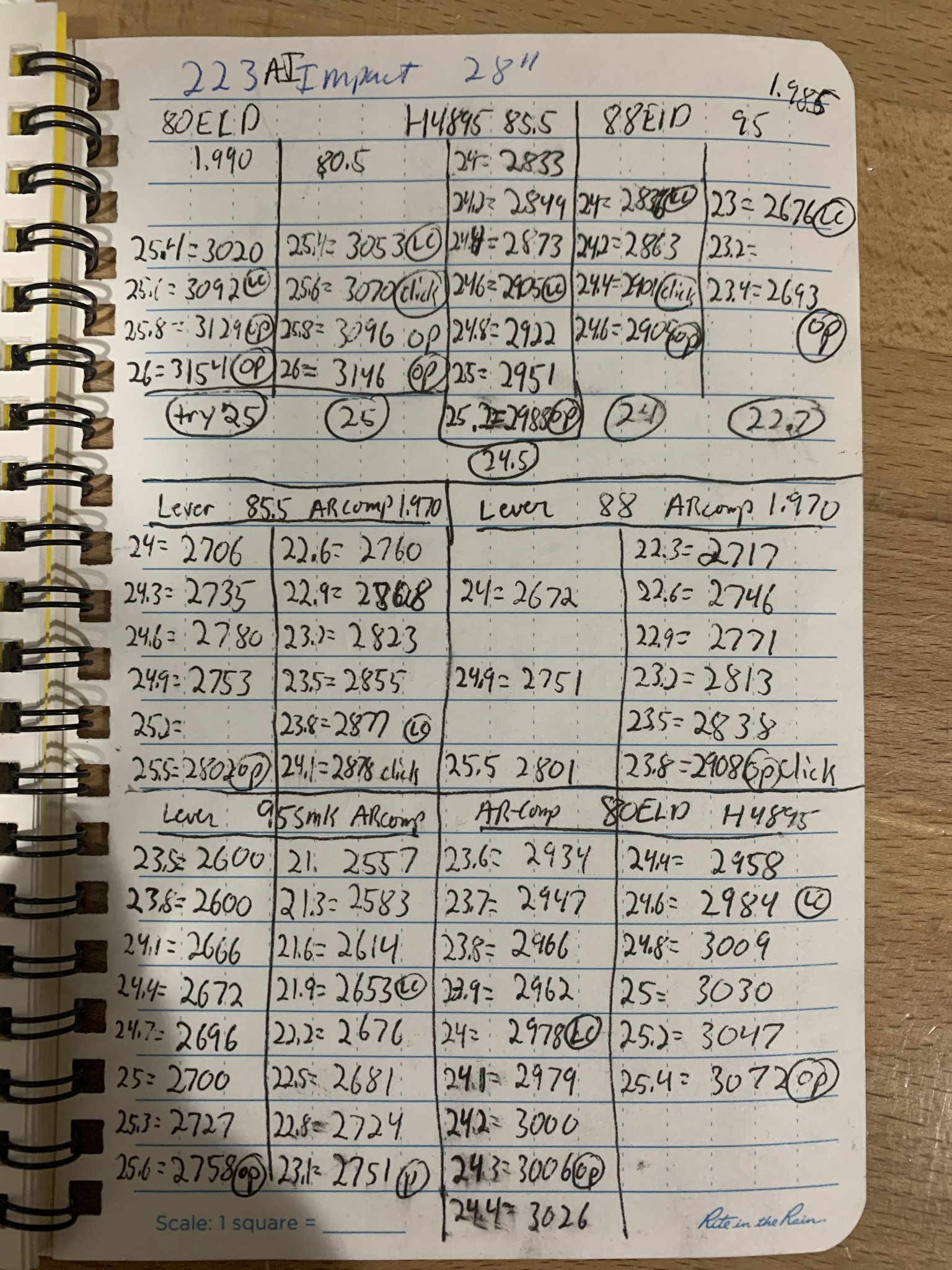

I’ve included my seating depth tests with the 80 eldm, 88 eldm, 95smk and the 85.5 using both AR comp and H4895.
Bottom targets are gas guns so please disregard the groups as I’m not great at driving them yet.

My record keeping and memory suks, on a GOOD day.
