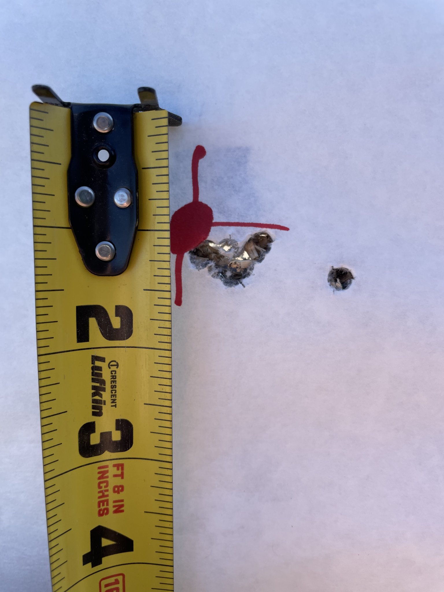

Finalized a bit of development today.
Rws fire formed brass
26” preferred barrel
80 ELD
Cci 450
27g Shooters world precision
3015 fps, sd about 8
Pulled the last shot to the right.
Found another load at 2880 which had an sd of 2.8, May explore that as The first one is a bit spicy!

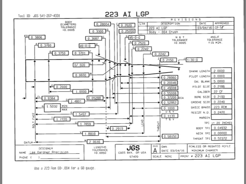

I’m getting a barrel spun up with this reamer, .100 freebore. Sounds like it is ideal for 75-80 grain projectiles in a bolt gun View attachment 7986512
What I like about this reamer is the 0.2242 freebore diameter. Often times the freebore diameter on the print is 0.2244 or larger. The manufacturer will never make it that tight, because they always make them over size, never under. I've always been of the opinion that a minimal diameter freebore helps align the VLDs into the rifling better and you'll get best accuracy.
Longer freebore would be better though as long as the round OAL does not turn out to be too long for your mag... but you can modify the mag to suit the longer round easy enough.
Just ordered a reamer with .155 fb. Plan is to shoot 85.5s over 8208, 4895, or Varget.

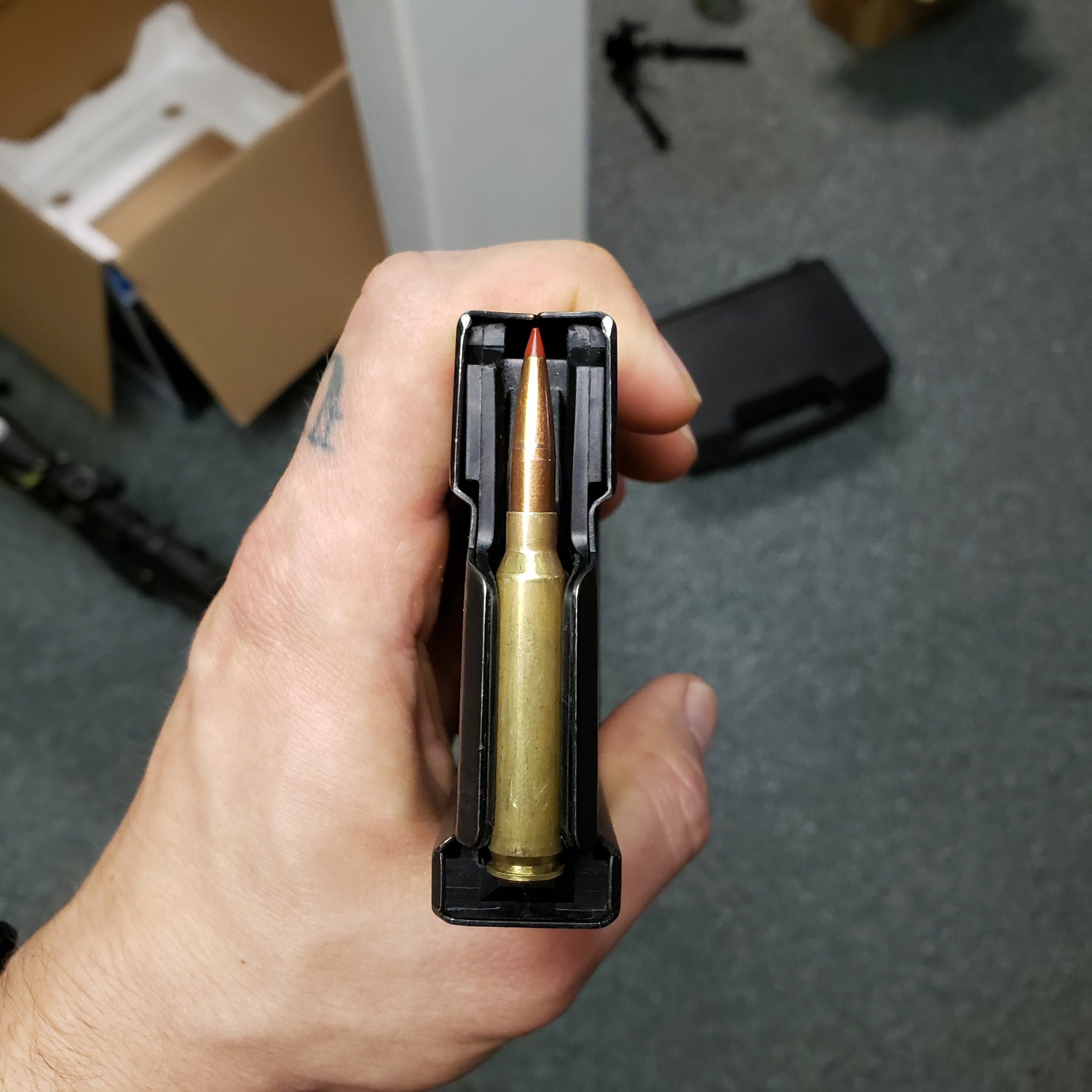

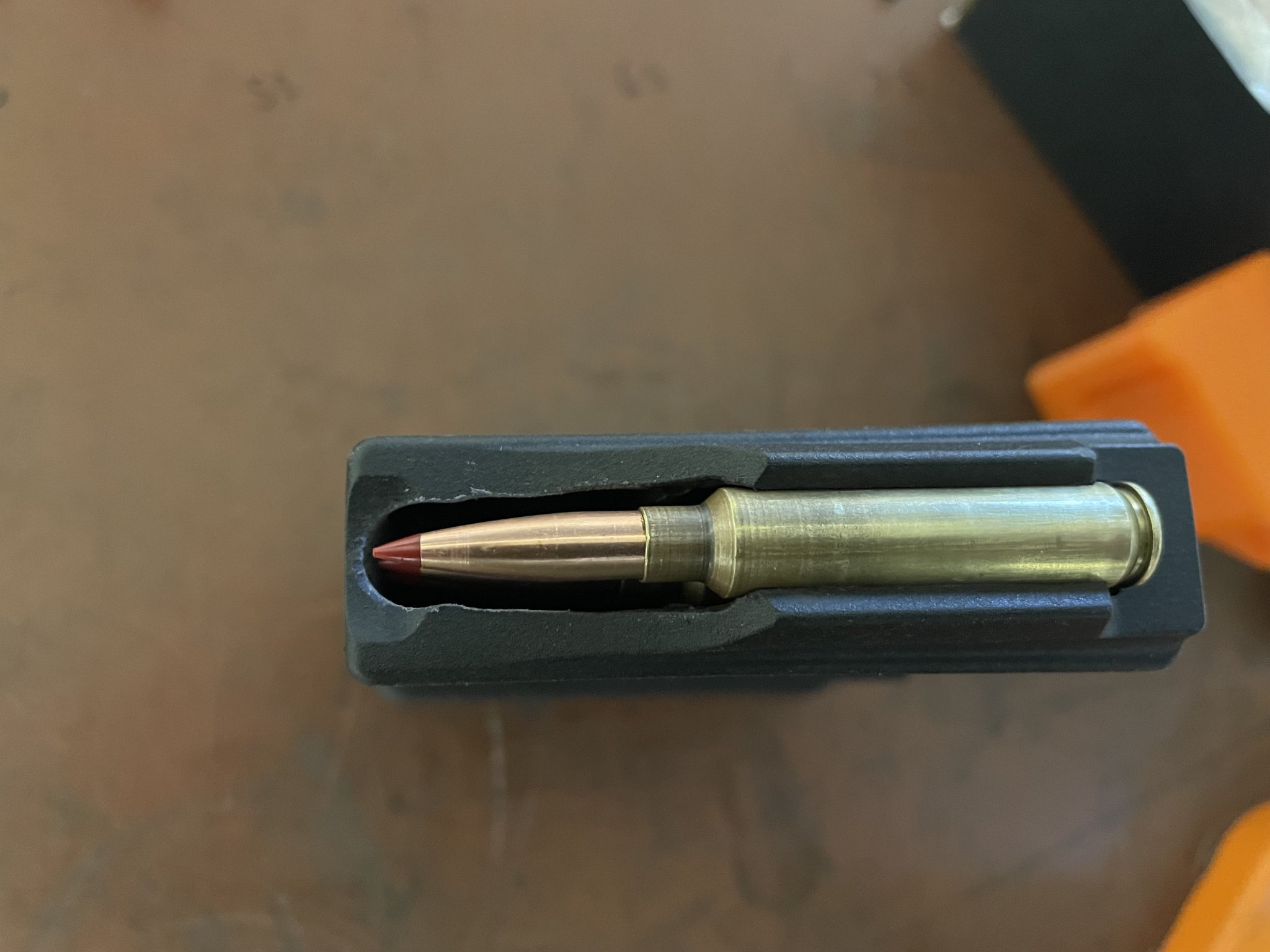

What are best mags to run for max COAL? Have heard that modified MDT Poly mags are the way to go, but I don’t have any on hand to check.
I currently have modified metal bois from MDT and Accurate-Mag, but even those seem like they will fail to fully take advantage of the longer throat.
The accurate mags have worked great for me. Just file where needed to reach the COAL you need.

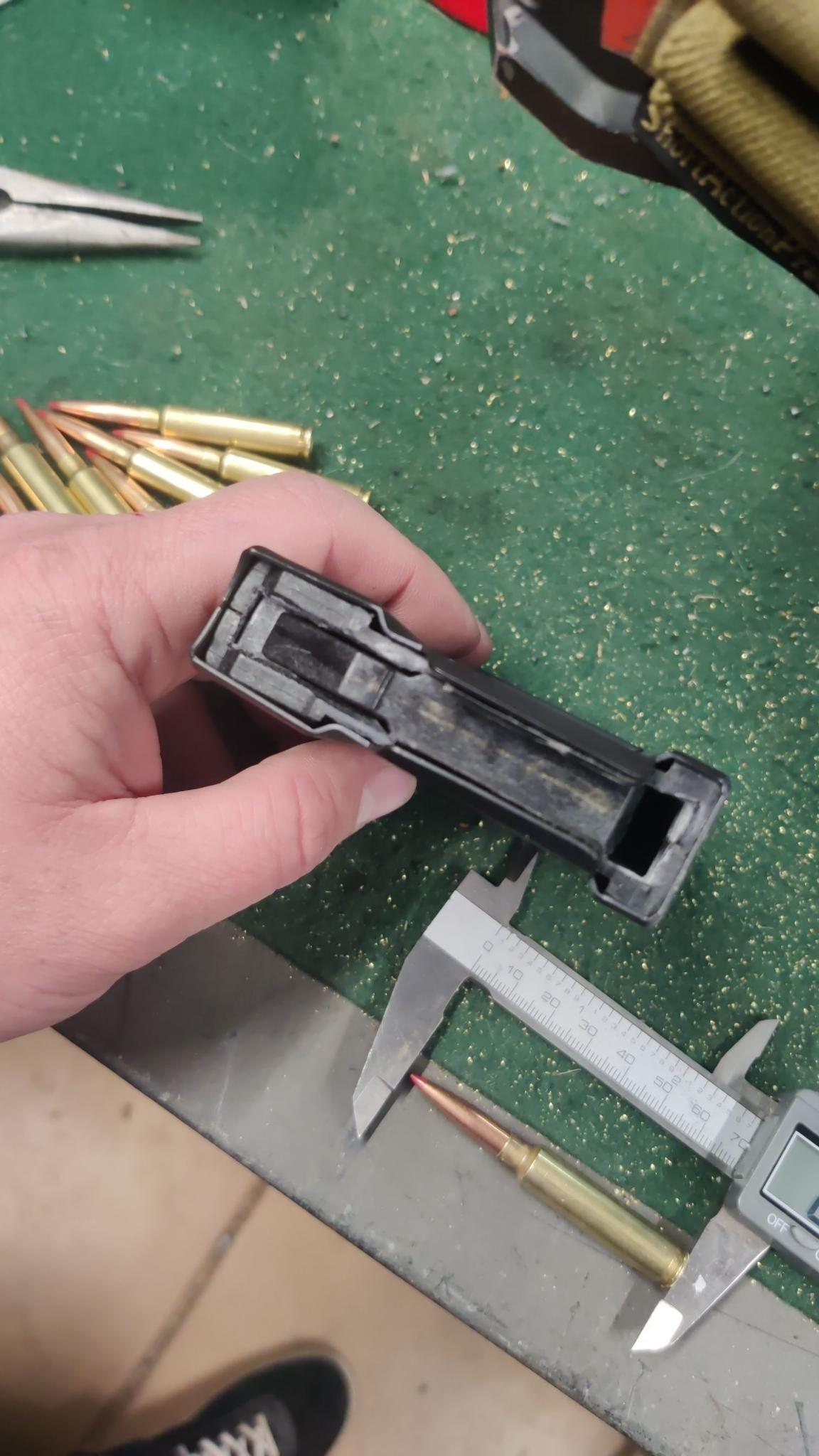

Reactions: Huckleberry75

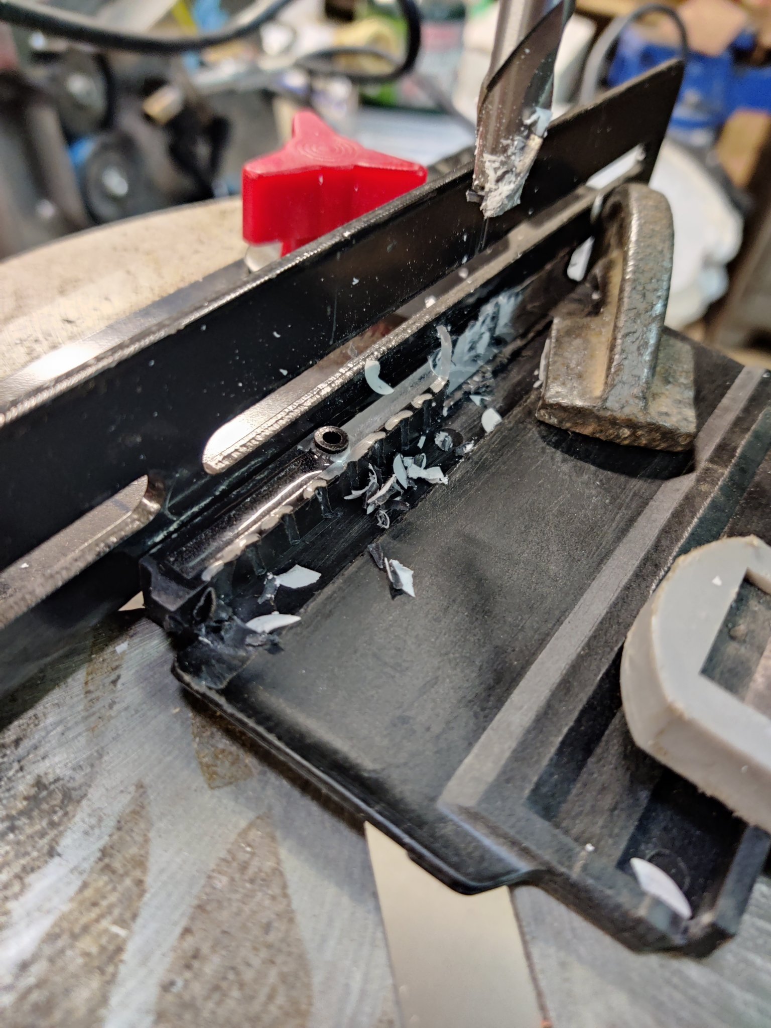

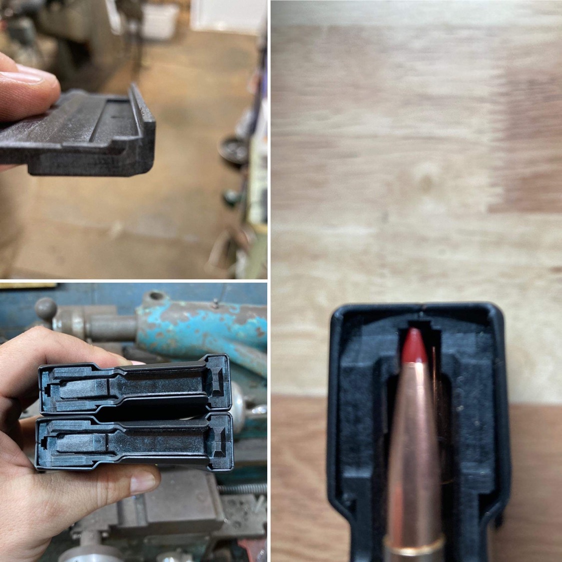

If you want to get froggy and really go for the distance, you can always open up the back end and get some serious COAL.
