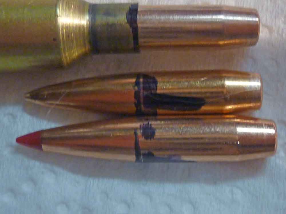

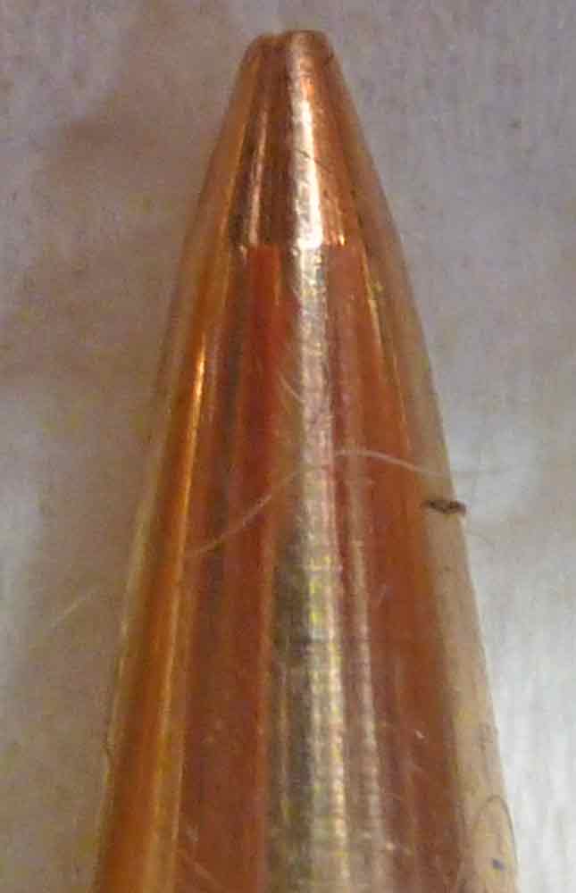

My Factory second 90gr bullets came in.
Look like Sierra SMK that have been pointed.
1.164" long.

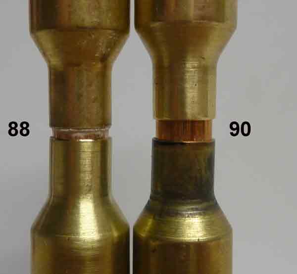

Pic next to an 88ELD-M marked with a sized case.
Padom: your data shows 0.030" Longer for the 88 with the same jump.
I jump the 88's about 0.035" in my 22N and would think about 0.005" with the SMK.
That would give me about the same OAL for both.
Need to find the lands in my 22N/28" with these.
Late Edit: Thanks.

Just a quick check.
Looks like I will load the 90's to 2.460" for 0.002 to .003" off. in the 22N/28"
The 88's get about .034 off @ 2.446".
Maybe a couple more after I clean the throat.
About 015 difference should be a starting point for me.
Will have to repeat this later. Your .030" looks closer.

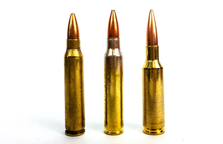

224V 28gr
220TB 29.5gr
6.5g 27.5g small from AR
6.5cm 42g large frame AR
