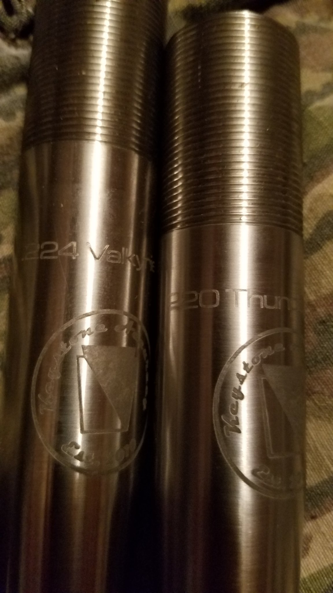

I'm still waiting on my 220 Thunderbolt barrel from Keystone Accuracy, I think that when I mailed my check to him I may have ended up getting in line behind the folks that took advantage of the sale around Memorial day for the .22cal barrels.

Loaded up some 220TB yesterday to shoot some groups at distance and some steel today.
90smk
1x Hornady brass
205M
28.3gr Varget
0.01" off
3000 SD 6
Shot this 5 shot group @ 100yd with the can on this gun for the first time to zero. The bullet hole on the bottom left circle is my adjusted zero after shooting the 5 shot group. I was good with that and couldn't wait to shoot some groups at 300 and 500yds and bang some steel at 700yd.
We moved over to the 700yd range and hung some paper @ 300yd, 500yd and painted steel. As soon as we started driving back to the firing line the skies opened up. Torrential downpour, 50mph wind gusts, and tons of lightning. We waited it out for a good 25min and it wasnt letting up so we left. Unfortunately we didn't get to shoot at distance but will be back in the next few days to get some rounds downrange again.

Just received the Bartlein blanks for the review to compare. Dropping off at Keystone next week to have them chambered but will be TL3 shouldered barrels this time.

Got back out today as the rain was ending to shoot these rounds that I got rained out on a few days ago. Wind was switching from dead still to 0.5mil right to left.
This load performed exactly as expected. 0.25moa at 300yd and just over half MOA at 500yds with the wind gust on that last shot otherwise it was right at 0.25moa. Not much more testing to do with this barrel. I think this review shows everything. Keystones Green Mountain button barrels straight hammer, 220TB is a killer cartridge, slinging 90's over 3000 with a very mild charge and accuracy is excellent.
Time to twist this barrel off and screw on the shouldered Bartlein in 220TB. Will be interesting to see how it compares to the GM button barrel.
