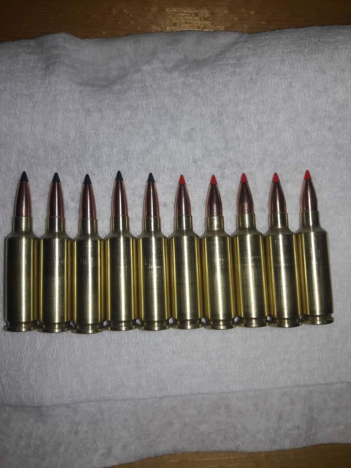

In my 220TB AR15 I run ASC mags. My 220TB AR load is a 77TMK at well over 3100.. I don't have any pictures of the rounds in the mag. Ill have to take some pictures

Originally my idea was to be able to shoot 80 and 88 ELDM from small frame AR mag , which it does .
Both AR uppers i built shot so well i wanted to see what it would do from a bolt gun.

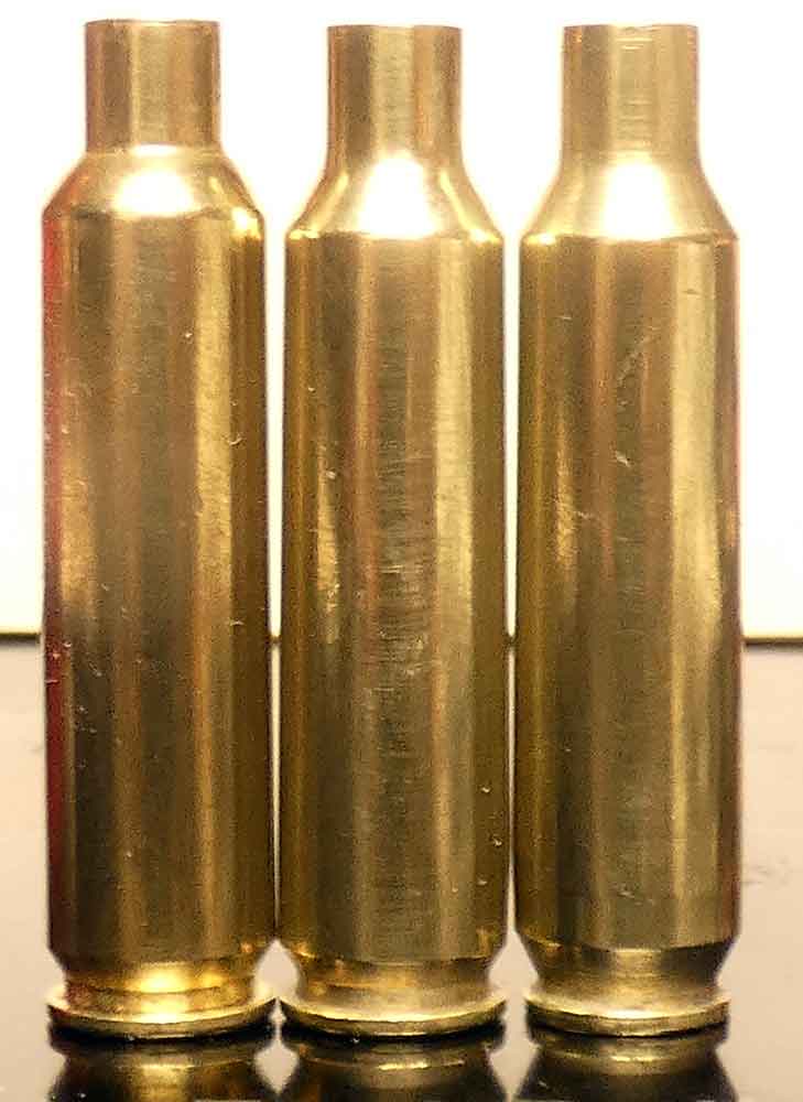

My 6mm Hagar brass order from creedmoorsports came in.
Just now going through them, so far all good.
Have a couple hundred unmolested from the first batch and now another 500.
Combine this with the Nolser and Dogtown 22N I can burn a few barrels :)
I will keep some for maybe a 6mm Hagar or a 220 TB in the future.
I'm guessing the 22N chamber could be reamed to 220TB? ? ?
You can see the capacity difference between the 6mm Hagar necked down to a 220TB as compared to the shoulder bump and neck job to make a 22 Nosgar. The extra capacity probably allows different powders that wouldn't fit in the Nosgar case. Not having to go to compressed loads would keep the pressure down a little. Right?
The lighter 22N cases have more capacity than the NOSGAR but won't hold up to heaver loads. Same bolt thrust but on a smaller
