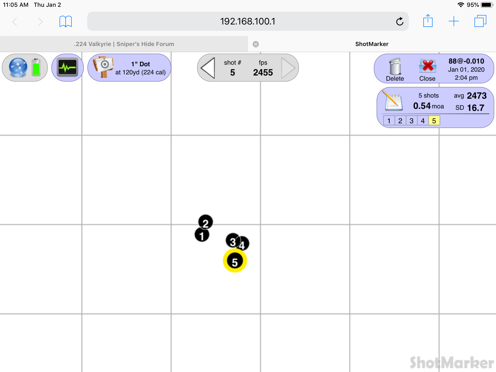

Took my ar out yesterday
26”,1-7t 4 groove Douglas
88 eld-m
Varget 24.0 grn
Hornady once fired brass
F205M primers
Best group 0.54” at 120 yards average velocity at target 2473fps

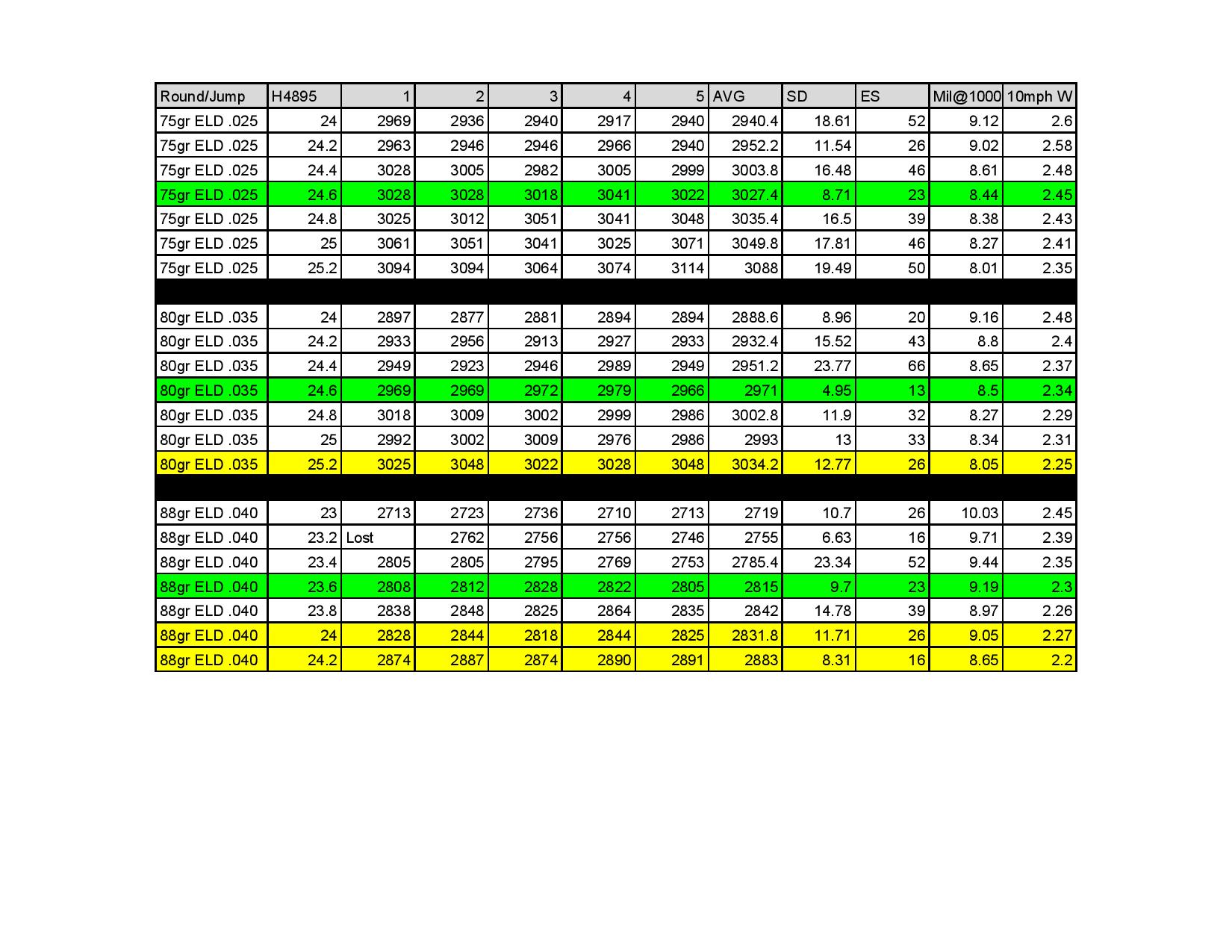

Here is a spreadsheet I made when doing some early testing with H4895 and a few different bullets.
General Info:
24" Faxon 5R 1/6.5T Barrel
Federal Once-Fired brass
CCI BR Primers
All used H4895 powder in the listed charges. All loads have the listed distance from the lands.
Anything highlighted in yellow showed significant pressure signs, green highlights are what I consider my potential loads. Haven't done any development since this.

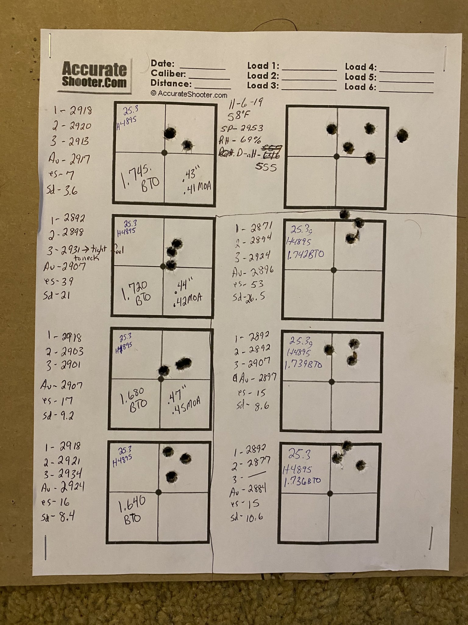

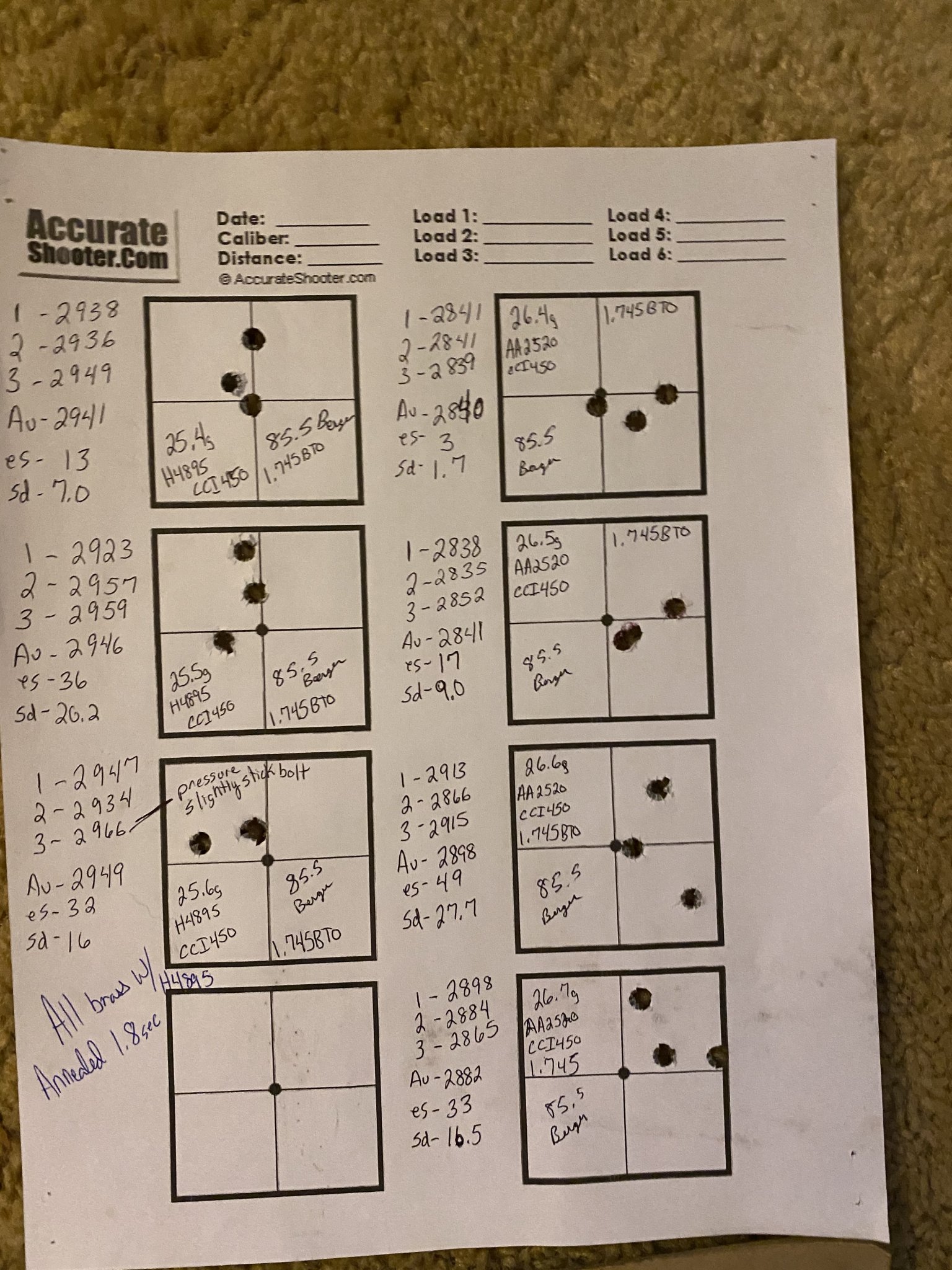

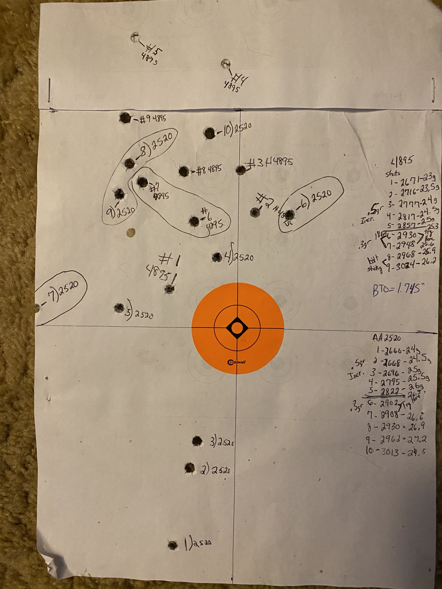

Ok, I've been busy with life on top of dicking with the Valkyrie and 85.5 Berger's and I haven't been able to be keeping the forums up to date, so, here I am with an update.
To start off I got my load data from Berger on these bullets and you will see how far I was able to go.
NOTE: This is a Remage Bolt Action Valkyrie, CBI 1-6.5 24" LT Varmint barrel, I know these are hot. Work up your own loads at the low end and go up on your own!
H4895
CCI450
85.5g Berger's
Neck turned Starline brass
Annealed every firing
All velocities taken by a MS V3 on a homemade deal to keep it off the barrel
Charge weights weighed out to the .02gr by a A&D fx120i
This is where I started, when I didn't hit pressure signs with what Berger told me I went above that in .3gr increments and was able to get where I wanted to go which 2900-2930 is where I want to be with these bullets.
Trying to verify my node or flat spot, as you can see, it started here where nothing seems to duplicate what I first got...…
Seeing what kind of accuracy I can get, and once again, what I got first is showing here now again
Settled on a powder charge, and now testing seating depth. I expect velocity changes here so, whatever.
Ok, looking good, still not the velocity I'm looking for but accuracy is capable it appears. Also started to investigate some shit and it turns out I was having the "dreaded doughnut"...….ok so try to remedy that, got a Redding type S-die.....trying different shit to get SOMETHING CONSISTANT to work but nothing is working.
As you can see, the second from last RH side target, it says I sanded the id, which I had some marks in the id caused by the neck turner when I had the doughnuts, so I used 800grit for a bit and then used 0000 steel wool. To my surprise it turned out great except when I used my arbor press with a psi gauge, I could bottom it out so I had to use my coax to seat them and I thought, oh shit this is going to shoot like shit......ha group was ok but the es/sd was awesome!!!!! Tried it again, whelp can't duplicate it...….
Still testing.....pretty good accuracy, not so good es….new Starline brass, was hopeful to find a virgin brass load but.....no
Shot the second left target and thought oh thank GOD!!!!! Tried to duplicate that below...….bloody fucking hell!!! Fell apart, again.....

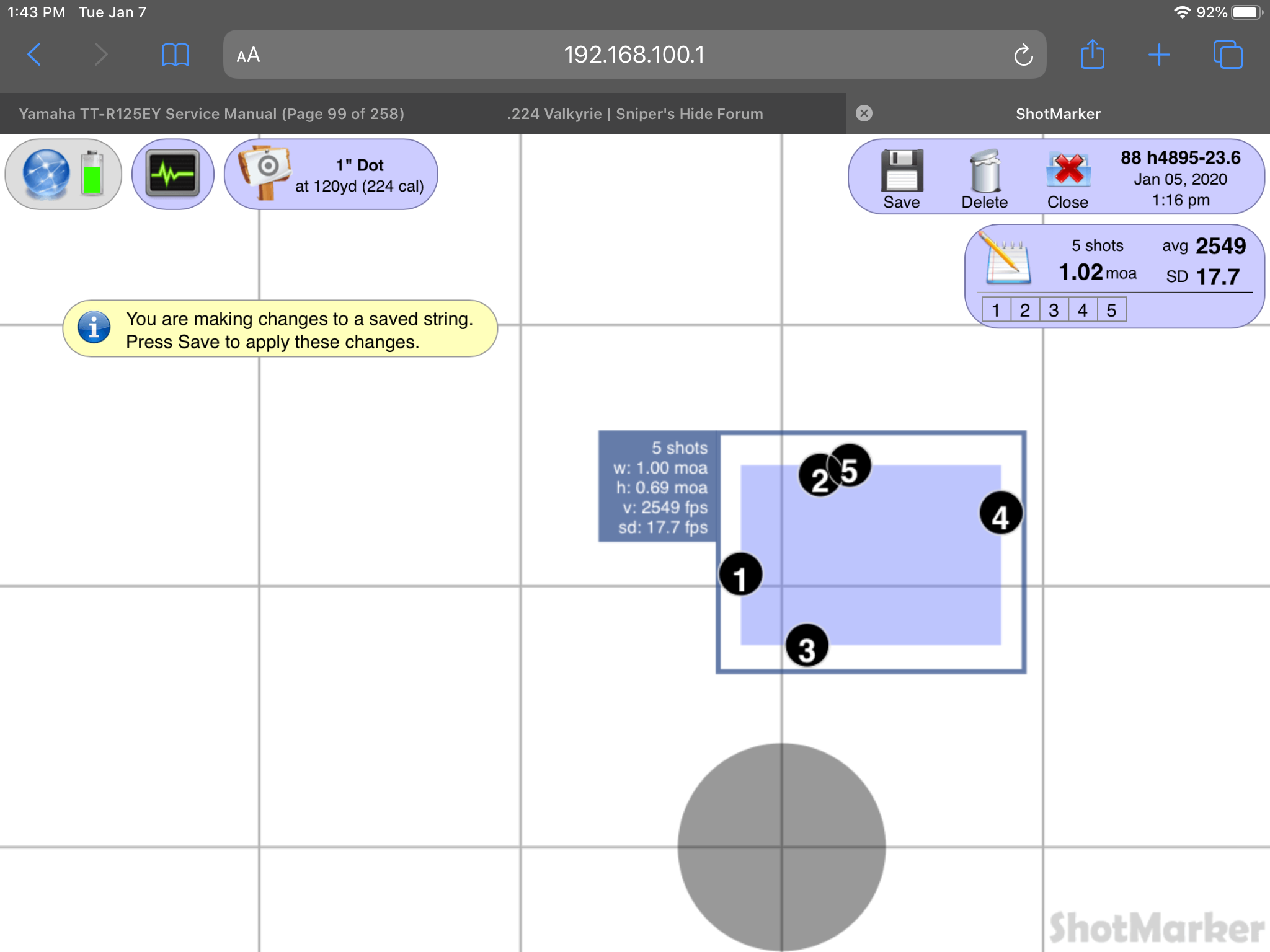

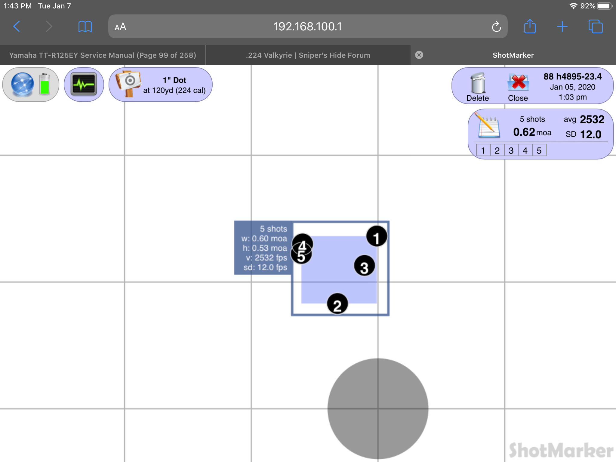

I shot my rifle (224 Valkyrie with 88 eld-m) this past Sunday
My rifle is ~100fps faster after 120 rounds fired
Is that possible?
It is normal for all barrels to speed up once they break in. Looks like you got a good one that gained a bunch of velocity. Only problem is sometimes the accuracy goes south and you have to lower your charge to get back to your node or go up and search for the next one.

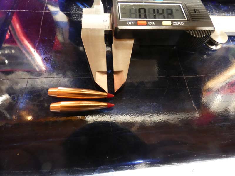

JBM says

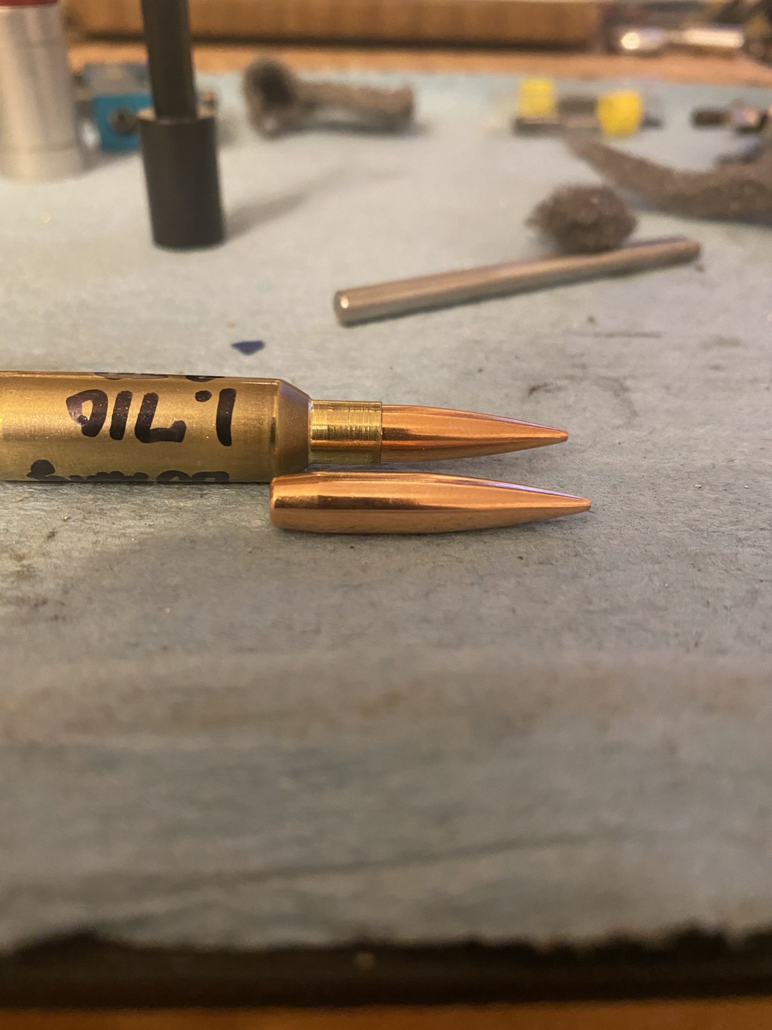

0.22488.0ELD M (Extremely Low Drag Match)1.2400.142
I measured several of the 80 and 88 ELD-M and get between 0.143 and 0.144"
I also get 1.243" for total bullet length.

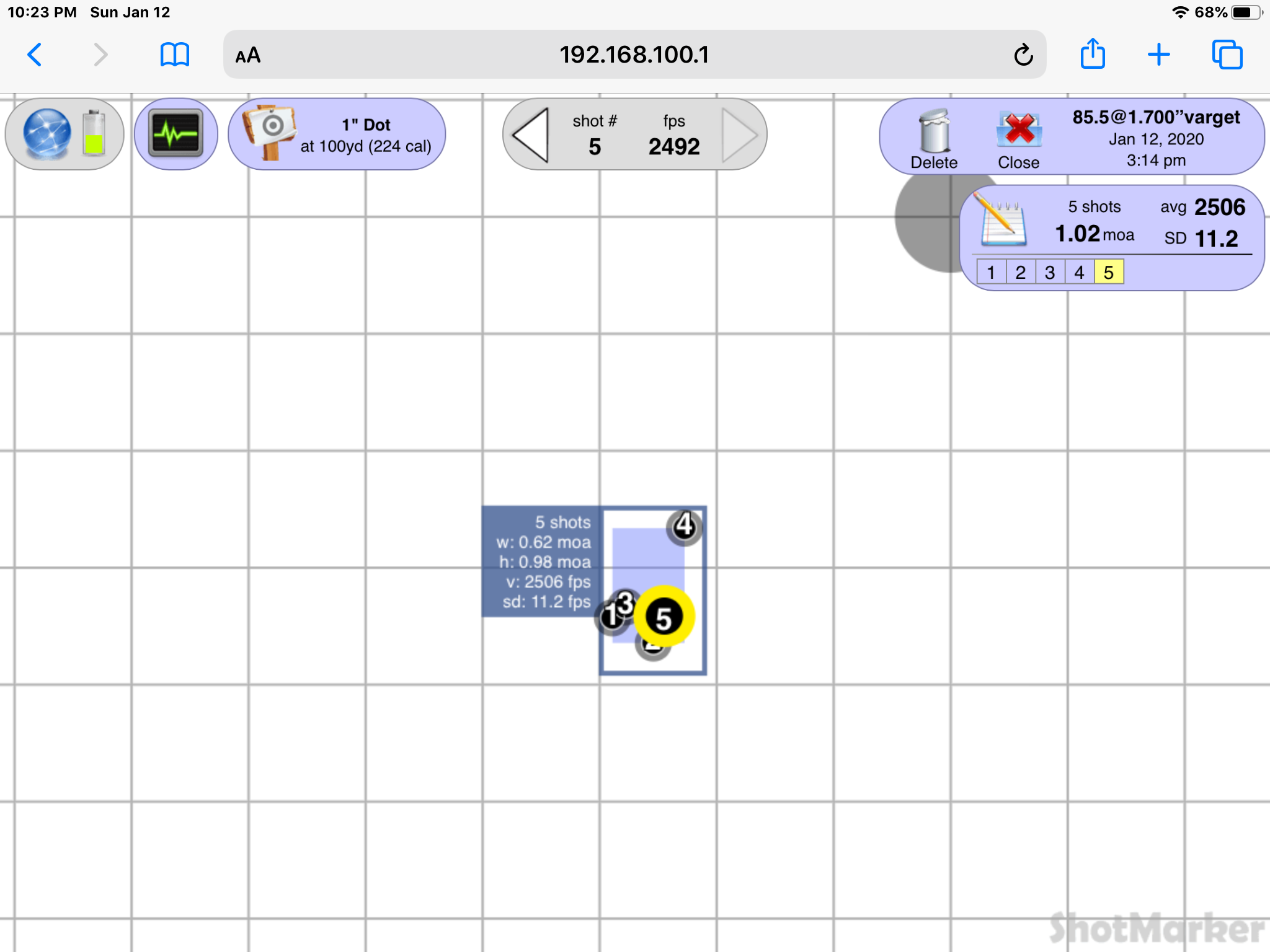

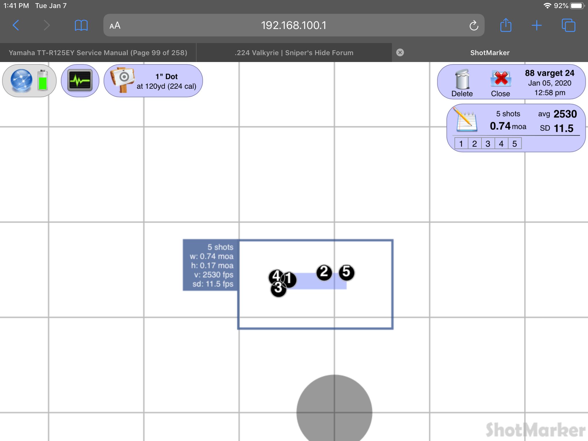

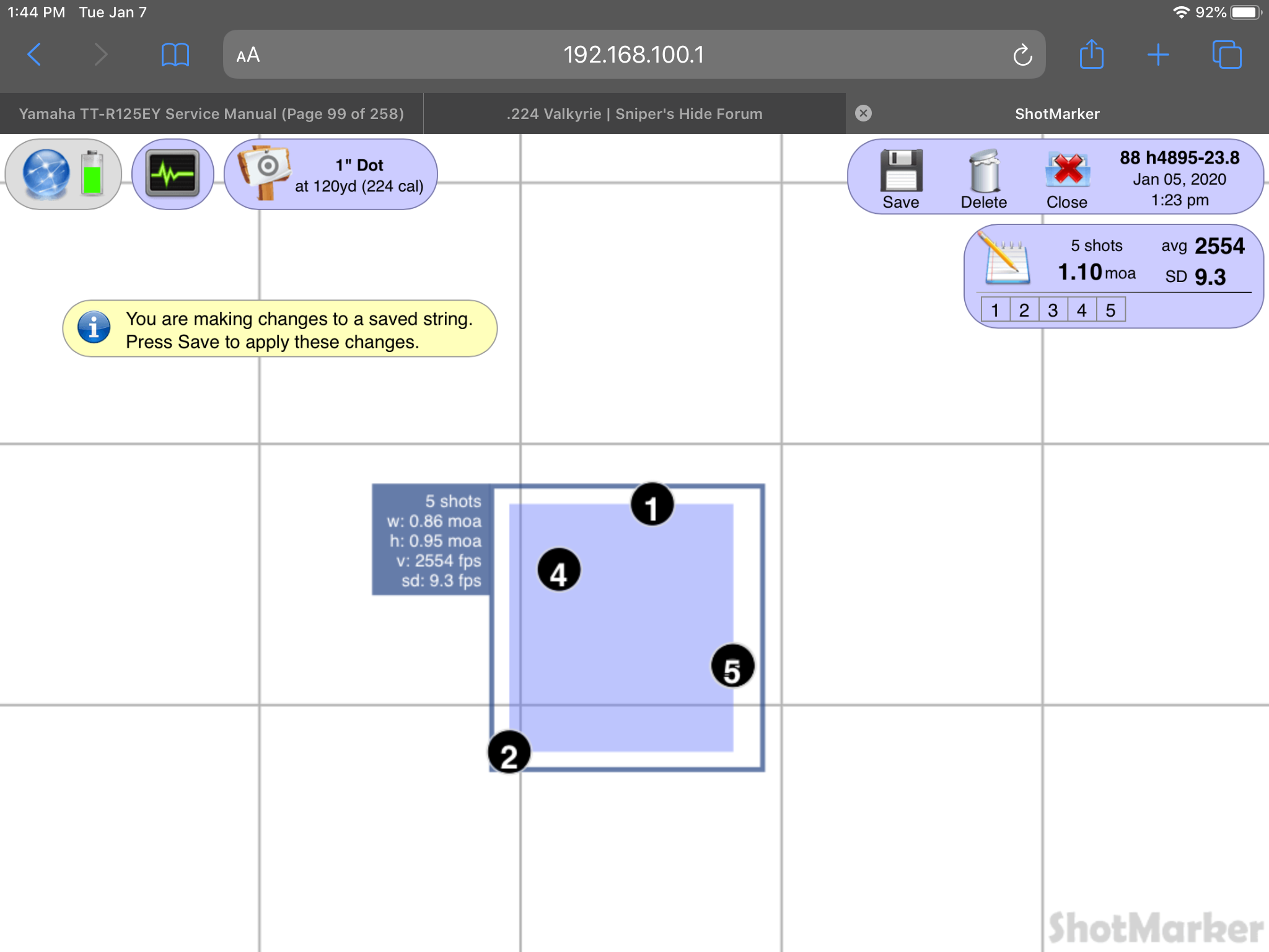

I posted my first outing with the 88 eld-m and varget
posting # 852
hope for some comment good or bad all welcome!!
my control load has very good vertical!

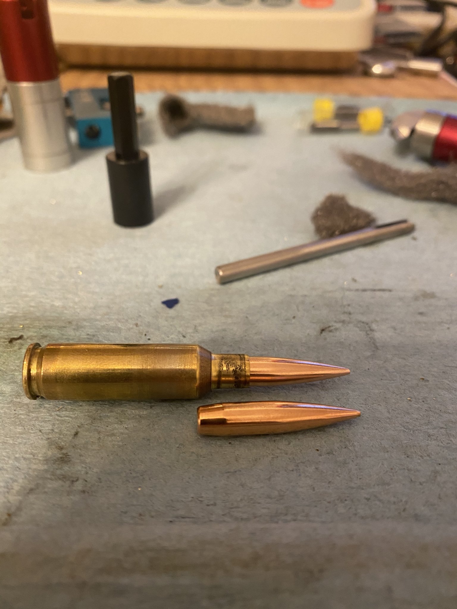

How much of a jump are the 85.5 @1.745” in your chamber,
thanks
thanks
At 1.745 CBTO that would be .025 off for me and I think that is about as close to the lands as I will go as the boat tail ends up in the neck a fair amount.
I’m shooting these at 1.710 which would make it .060 off with the 85.5 Berger’s.
This is what it looks like at 1.745 cbto
1.710 cbto
Huh, I thought the boat tail was in farther.......might have to go back to the drawing board......but I’ve been getting good accuracy at this cbto....idk
