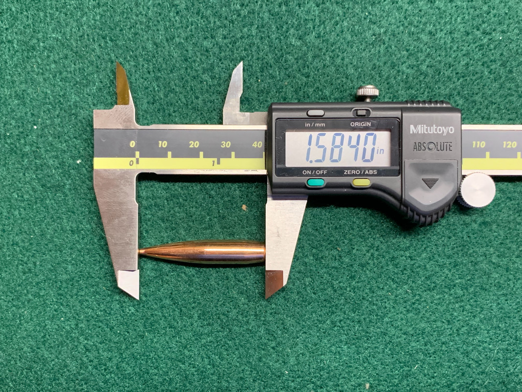

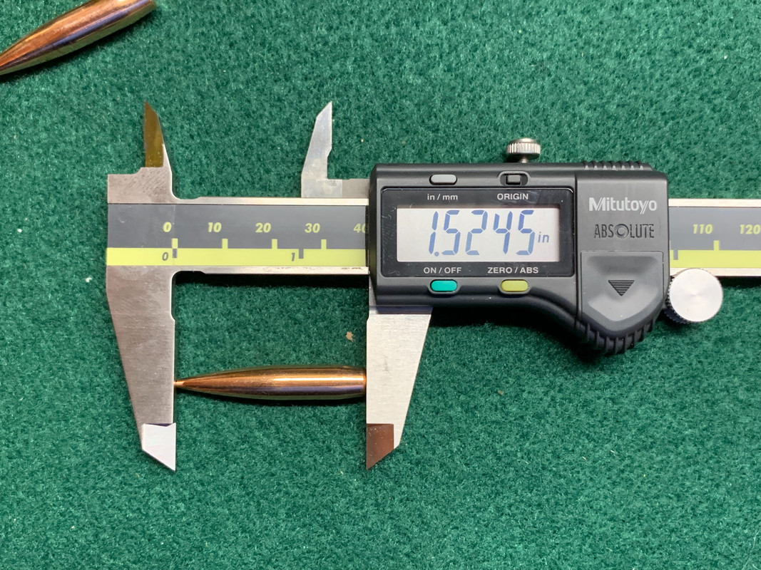

So a box of 215 hybrids arrived and I had some time today so took some pics.

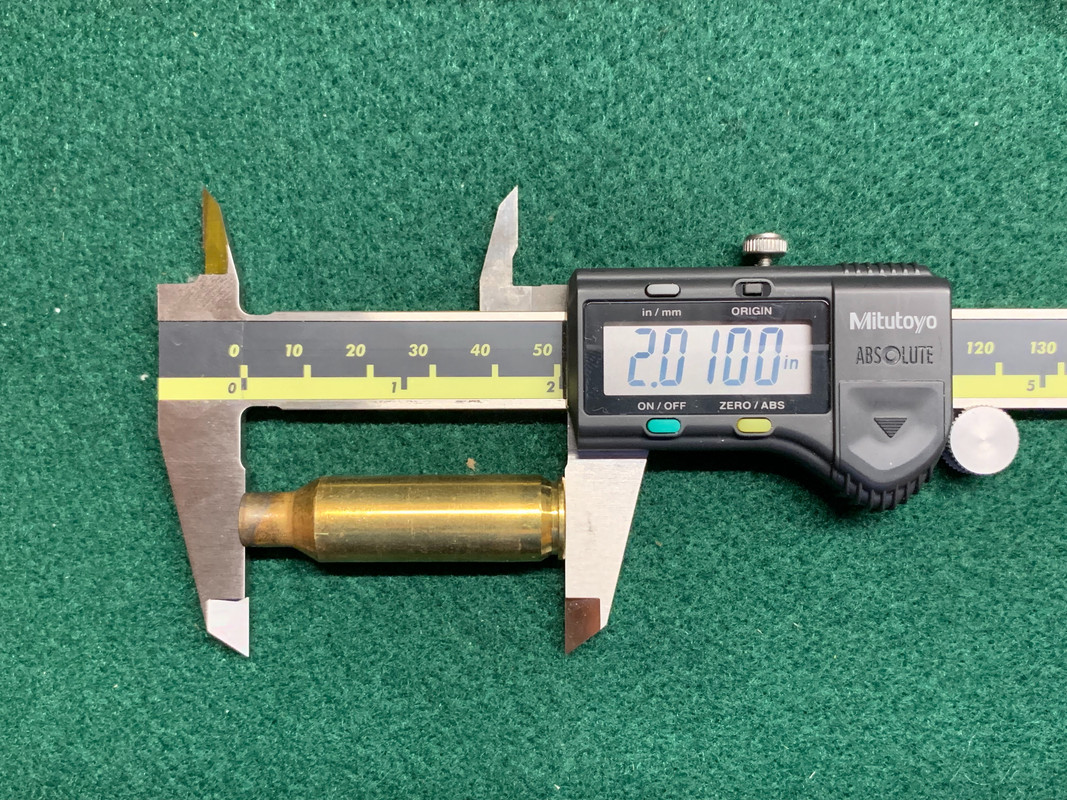

Remington 300 SAUM brass, once fired:
215 hybrid length:

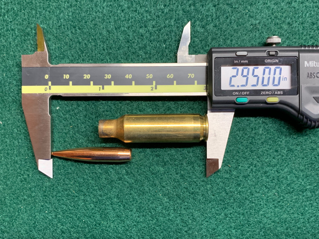

215 at a OAL of 2.950”:
