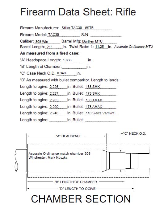

Chamber dimensions
Here is what one of my match chambers looks like for Length to Ogive.
Ok, so I got away from work for a bit to make up some dummy rounds...
I seated the bullets @ 2.800" which leaves 0.085" of room for throat erosion .
I'm going to forget about magazine feeding the 185gr vld's. Seated to mag length the Ogive was inside the case neck! lol
As for the SMK's and Amax the base to ogive was:
175gr SMK = 2.0970"
178gr Amax= 2.0800"
So 17 thou diff, pretty close.
Whats your thoughts? I'm thinking just throat for the SMK's as they don't seem to mind the jump anyways.
Maybe I'm over thinking this WAY too much, idk. I just don't want to have any regrets with this build.
