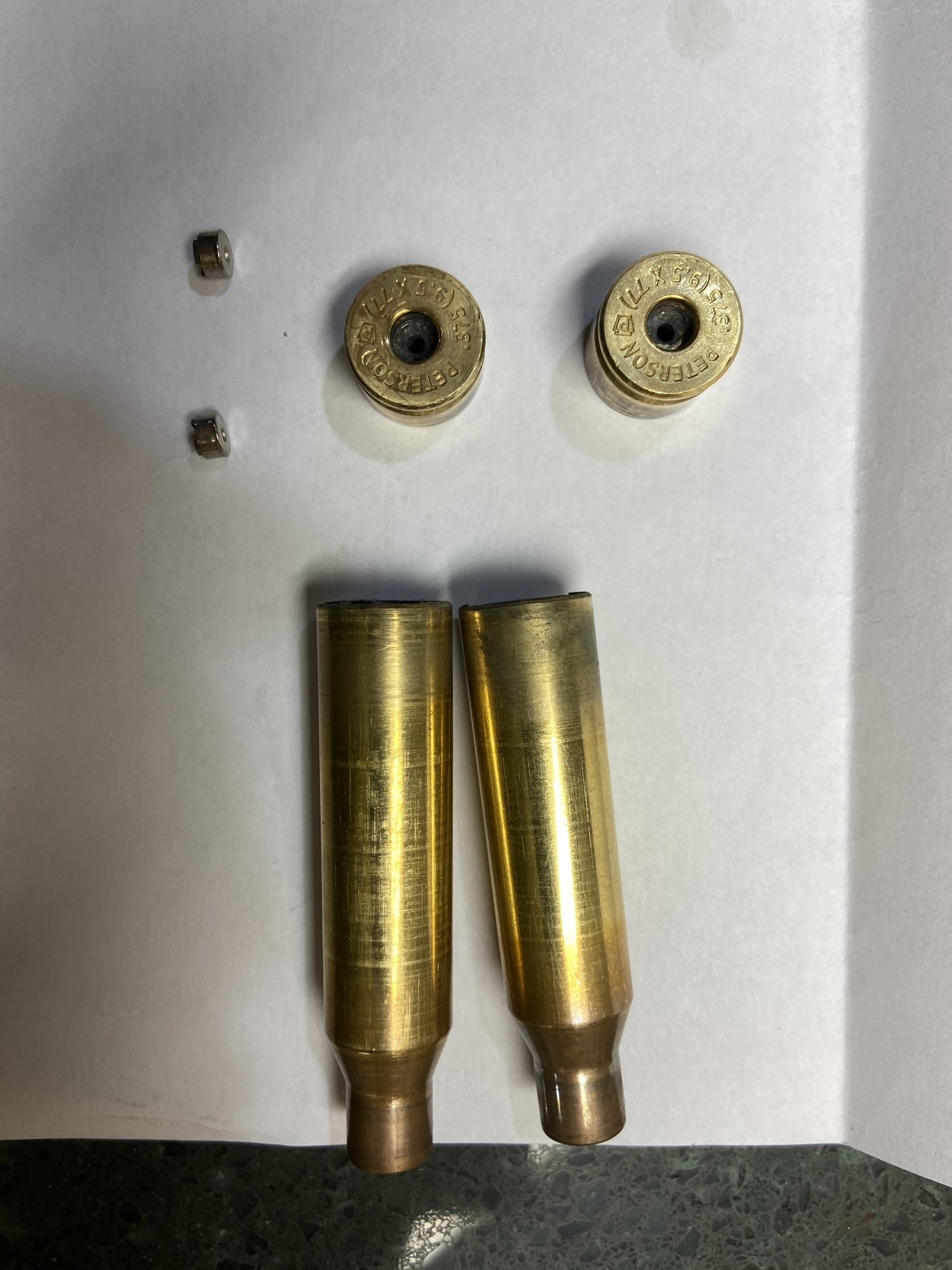

Well.....125gr of H50bmg is no go .oh and 2640 FPS on a lab radar.
Your probably at least 10 grains of powder too little for the h50bmg powder... 125 seems very very low. 125 is a good place to start with Retumbo..
Whats the story on that brass? What rifle? Headspacing good?

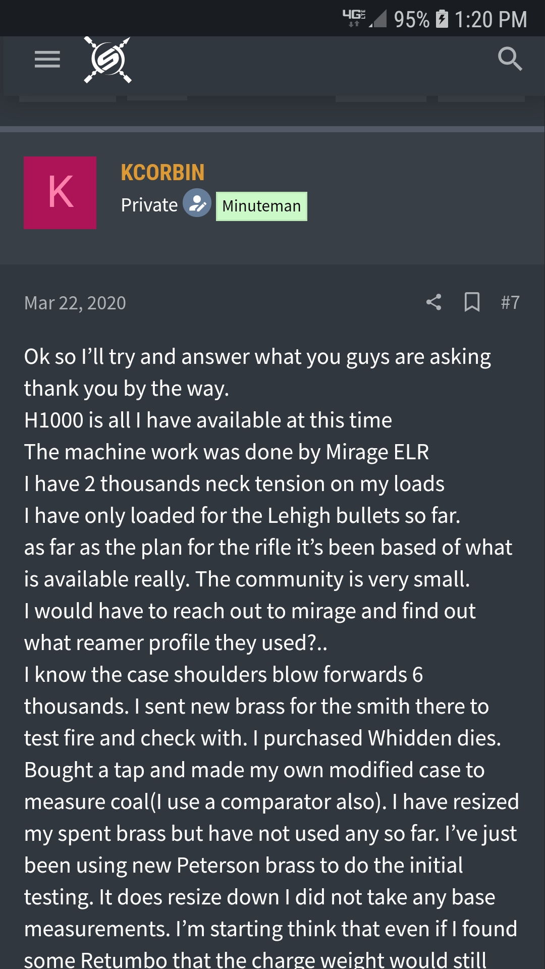

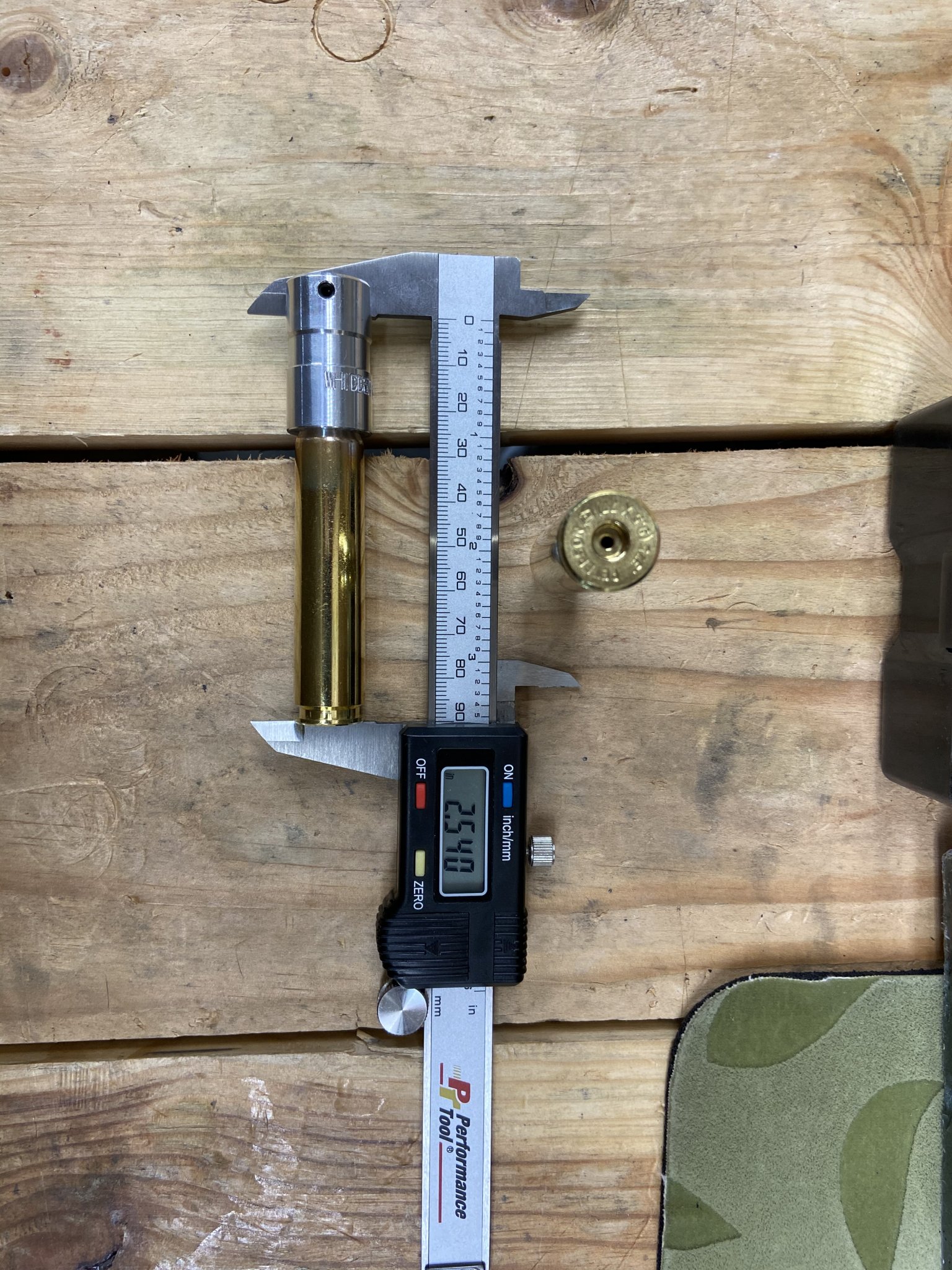

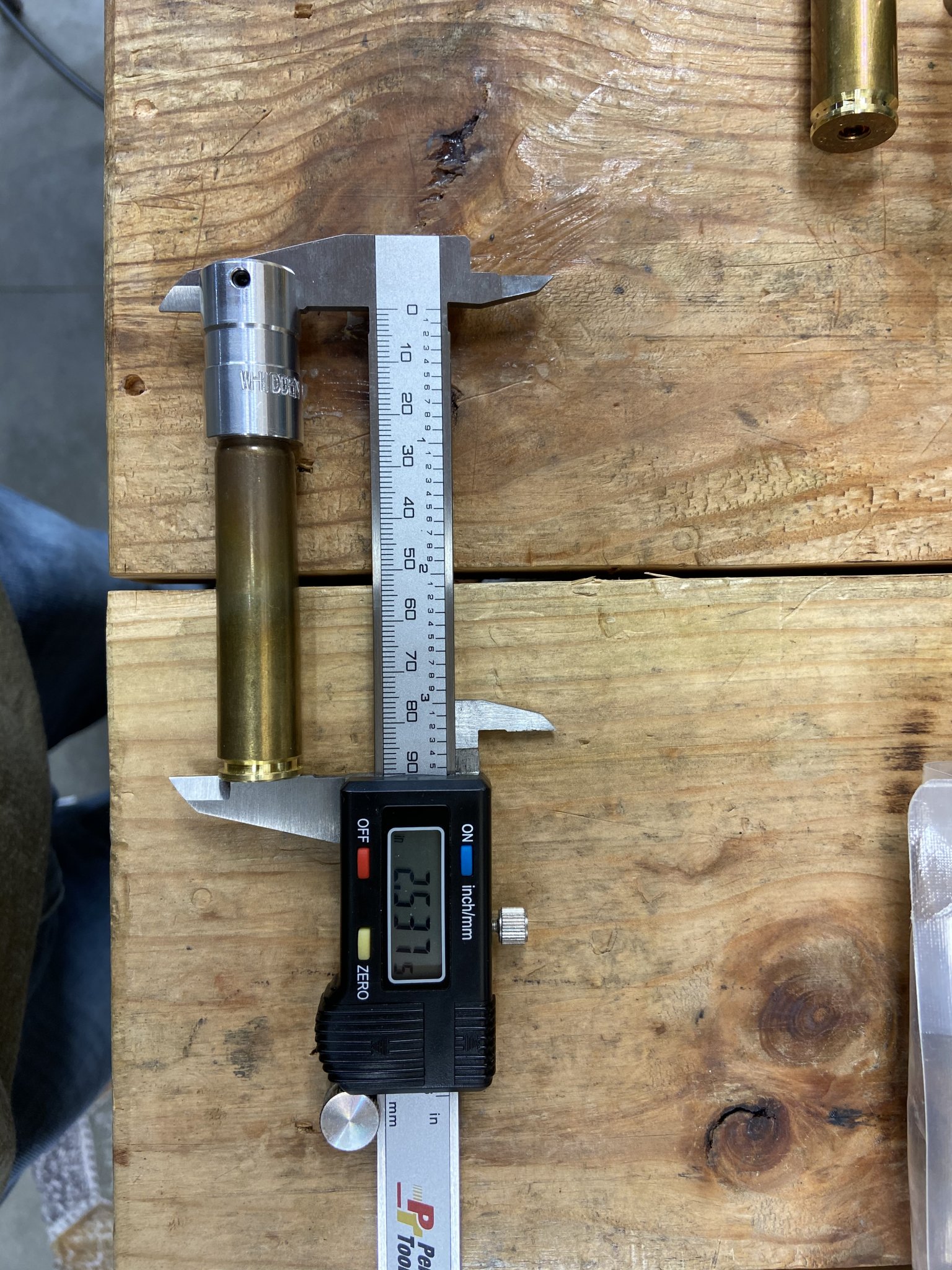

Screen shot his post, where he is getting .006 shoulder movement. A couple of times at .006 would explain the case head separation.
Could explain the flat primers too.
Screen shot below.

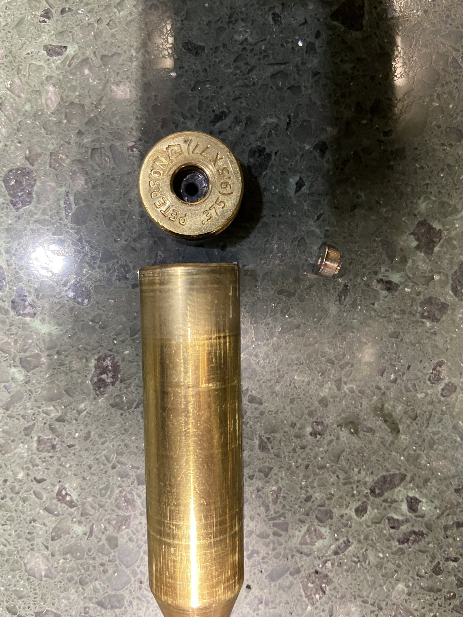

Well that didn’t work used some brass that I only bumped back the shoulder .002. One firing on it. So it’s not like this is its 3 or 4 loading.

This is not good.
And not easy to diagnose over the internet.
How far away from you is the gunsmith ?
He needs to check some new from box brass against the headspace.
.006 jump is excessive. The headspace could be off and the brass could be off. Or both.
Either way, both need checking b4 u go further.
Reactions: Steel head
The brass could also be brittle. If it's too hard, improperly heat treated, and too short, it could completely be you have bad brass.
If you took new brass and ran it through the sizing die b4 you loaded it the first time, to uniform the necks, it might be possible you set the shoulder back unknowingly.
I have done that with a bad die following the manufacturers instructions. Another if.
Would be nice if you had some other brand brass to try or compare the Peterson to.
Best I can offer right now.

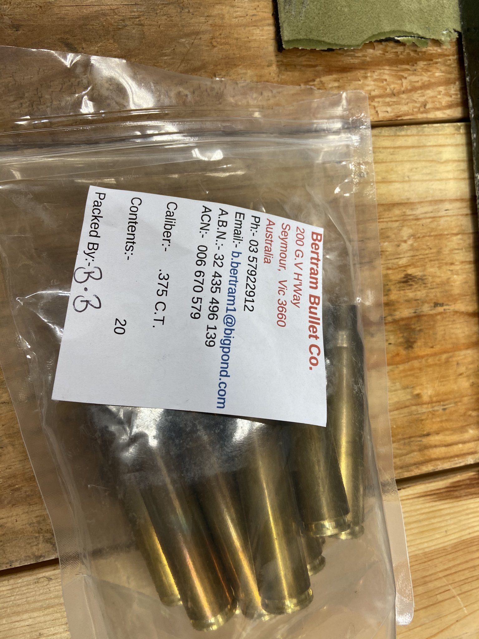

I’ve got some Bertram I could try but the shoulders are even further back on it. It seems thick but can’t prove it.

This is even more not good. Gunsmith time.
But. Take bertram brass and Peterson brass. Weigh them. Compare weights.
Put a fired primer in backwards.
Then with a 223 or pistol BALL powder, fill the cases completely. Bump pack it, fill until even with the mouth.
Then weigh the powder charges. That's the poor mans way to quick compare inside dimensions to weights and get an idea.
But, best safest idea is gunsmith.

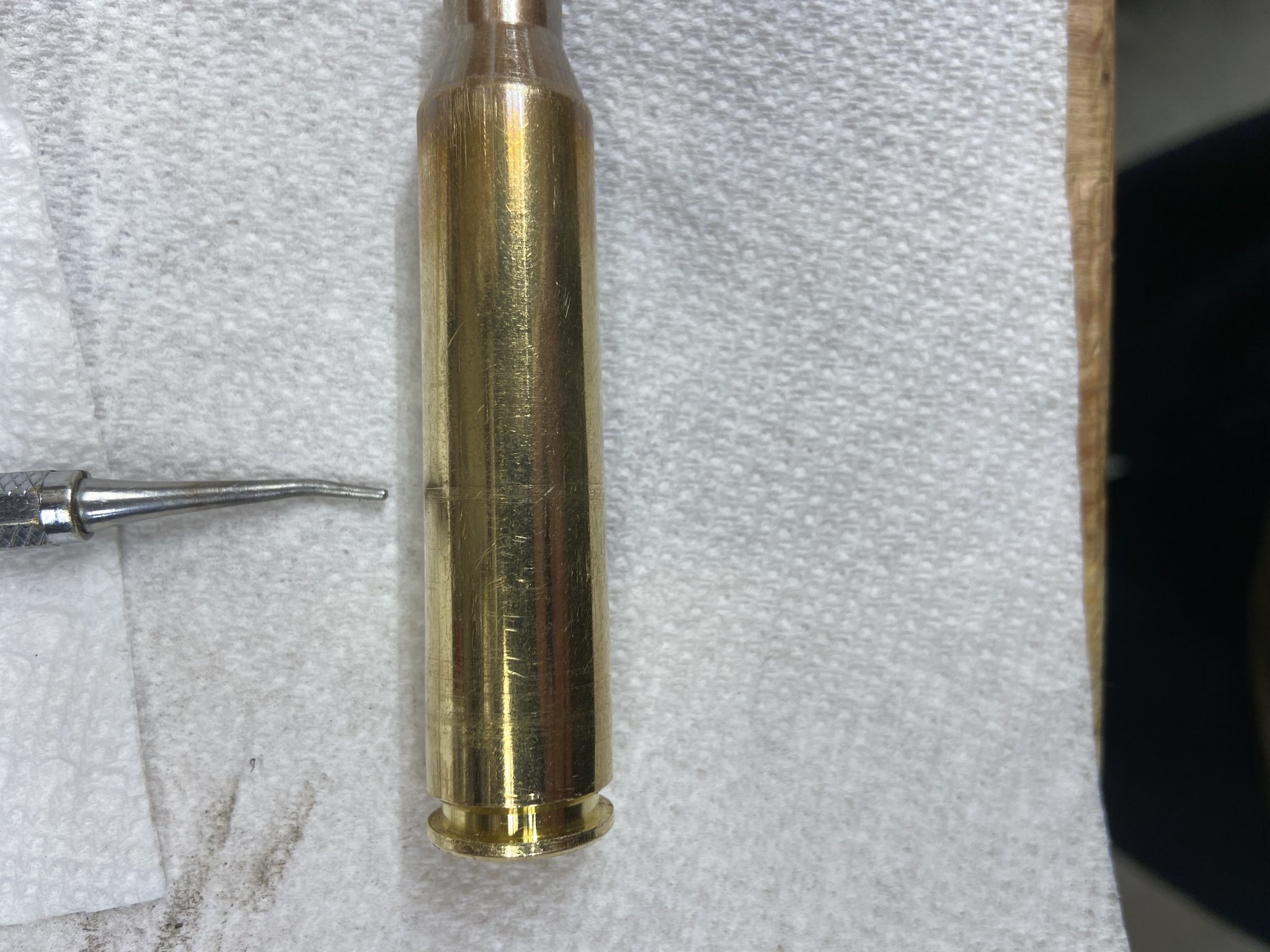

Your chamber doesn’t look great. Lots of reamer lines. Case head separation is caused by excessive headspace. I have yet to find a case that it’s been caused by anything else.
125gr of H50bmg is way too low.
Finally, I haven’t went back and read from the last time I was in here but, what is the neck diameter of your chamber? Peterson is a good .0015” thicker than Bertram. If your reamer is set up for bertram
And you are running Peterson, you could have an interface fit that is causing problems.
I have also seen wet chambers, and excessively low charges case false over pressure signs too.

When i spoke with Peterson's case designer at Shot this year he told me that when you are sizing their brass as long as the case still chambers you should not bump the shoulder at all. I am using the AB .375 ct dies and have only had 1 case separation and that was on it 7 firing. Since i have gone to a zero bump i have cases with 9 firings and show no sign of separating. I am running 131.5 gr of N570 shooting the 400 lazer which gets me 2951 avg fps with an sd of 7. I can get 4 sometimes 5 firings before i bump .001. The they chamber like new.

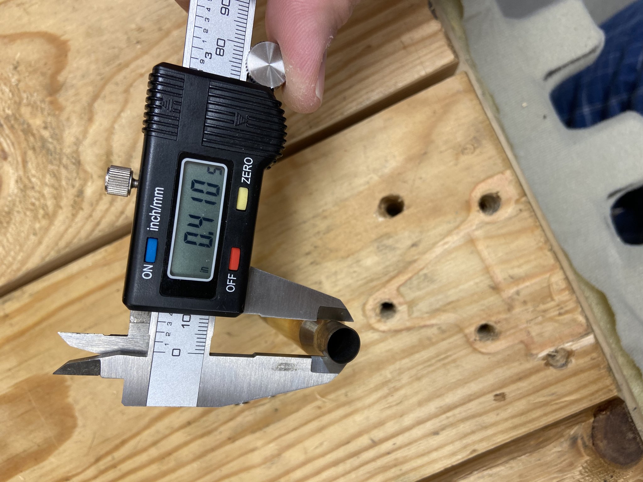

One last question before I tear the rifle down. I did the scotch tape and masking tape head space check on a unfired cartridge with the ejector removed and it closes with just slight bit of effort. While I know this is no substitute for a real gauge.
Is it safe to say the headspace is jacked? Sorry for beating a dead horse but I’m still in denial.
I've been running peterson brass for the 33XC and so far have no case head separations after about 7 shots in my load workup brass. Some were pretty hot too. I can't see any ring forming inside or out either so I'm thinking its not peterson brass.
A good friend has been using the peterson brass for his 375 Cheytac in his Desert Tech HTI using the original factory barrel and the longer barrel I made using a 36" bartlein blank. Some of his cases have 8 or 9 firings so far and never a ring or indication of incipient case head separation.
So I'm guessing there is something up with the chamber in your rifle. If the neck is tight you can get high pressure which will blow primers and if the headspace isn't right case head seps. It might be worth investing in , borrowing or taking your rifle to someone who has good headspace guages. It could save you some cash. It might be possible to set your barrel back and ream it with a known proper reamer to bring it back into spec. If the barrel is good other than the chamber it might be the most cost effective way.
If the barrel is really tight bore it can cause some of those issues as well and if thats the case toss it and start over.
Thats my thoughts.

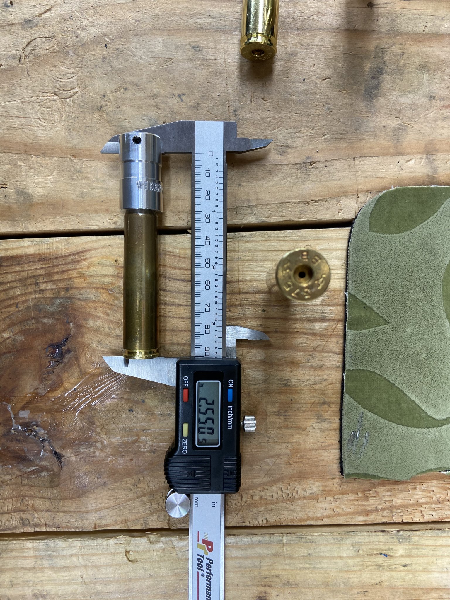

Today, I went to pick up 375#2... pic
#2 did not come home......
I sent my reamer. And go-no go gauges. Life should have been good.
I carried two boxes of boolitz with me. Both boxes were new Bartram unfired brass, loaded with retumbo and 350 sierras.
To prep the brass, besides weight sort and debur the flash holes, I neck sized it to true the necks and deburred them.
Then I checked datum line and oal. And sorted accordingly. And loaded select groups of all same same from new.
Now, good readers, these rounds fit just perfect in 375#1, and shoot ohhh so good.
Put #2 in vice and check rounds. Houston, we have a problem. 2% chambered fine. 96% chambered snug snug. 2% would have required seriously forcing the bolt.....
Each of these rounds were hand cycled through #1, with absolutely zero problem...
(Did jw say bad words, was he calm and collected, how did jw act ?)
There was a WTF moment and some discussion. Gunsmith took out his brass, new in the box and every single round chambered like a champ.
Like mine chamber like a champ in #1....
Gunsmiths brass is new peterson.
Mine is bartram. Obviously his is much smaller than mine. Ok, I can handle this.
Questioning further, since my reamer was cut off fired brass from #1, because I dont know Dave Viers reamer specs, and my dies were cut with Dave's reamers....
Fired brass from #1, resized brass fired in #1, resized in Dave's cut dies, and new bartram brass created my reamer.
This is a serious WTF moment. I'm like no f'ing way.....
A tiny bit further discussion. Tiny bit. Gunsmith cut the chamber with HIS reamer, not mine.
So, my options became.
375#1 eats bartram brass and gets resized with Dave's dies.
375#2 has to have Peterson brass AND new dies to with with HIS reamer dimensions. Gotta buy a bunch of stuff and start all over...
No f'ing way !!!!!
Hes going to re-pop the chamber with MY reamer.......
Will go back for #2 next weekend if the predicted bad weather this Sunday doesnt tornado me....
And, with calipers in hand, I'm going to seriously measure his Peterson brass and my bartram AND Jamison brass.....
Will record those numbers.
And at some point order some Peterson brass, and at some point, have reamer drawings of mine and his, and any other 375 reamer drawing I can find.
Hopefully this novelette will offer some insights to the readers who might have run into similar problems as OP KC.
This experience does not bother me, it's not the first one like it that I have had, BTDT in 308, 30.06, and 300wm.
Will report in as stuff happens.
Best to yall, vr

ok yeah I’ll go along with that. Just to give you an idea of what I’ve ive got and use: I’m using a charge master to throw and double check each load with an A&D fx120i. I’ve measure all Peterson brass using whidden shoulder bump gauge. All measure 2.540 from the shoulder to bass virgin cases. (Peterson has outstanding quality control FYI) Bertram is a different story 2.547-2.552 yes all over the place. I’ve sorted each piece. Masking tape method mine I have here measures .004 and I’ve got some scotch tape that measures .001. I can close @.005 and 2oclock lock at .008. Not an exact science but head space gauges are 6 weeks out from PTG. Back to todays work-Using the 2.549 (tightest on bolt closer) Bertram starting fresh giving the head space the benefit after firing shrinks to 2.546 under a load of H50 @115gr. .020 jump. Primers flat slightly and famous ring of starting to separate. I think the problem is with the cartridge is not standardized and people cut chamber and throats to what works best for them. Maybe that’s why Desert tech sells the ammo to go with the gun......
alright, we have a problem here. A snug close is one a headspace that is .009” longer than the great consistent Peterson brass. Your brass is screwed after the first firing.
Next, why on earth are you using a load of 115gr of H50?? That’s about 25gr below where you should be. Flat primes happen all the time with loads that are way too low.
How is your bolt lift resistance?

No this is on the Bertram brass I found a couple pieces that were at 2.549 and 2.550 they were tight on bolt closing taking the headspace up so I would not blow the shoulders any more forward on the smaller pieces of brass. FYI I checked this with the ejector out also. I’m thinking g the chamber is over bored and that’s why the brass shrinks to 2.546 after firing and I get a separation line. Bolt lift was good primers were less flat than what I’ve seen in the past charges. The Bertram brass didn’t show any ejector marks or extractor marks. The brass feels a little more heavy duty than Peterson but that’s purely an opinion.
Here is a culled piece of Bertram @2.537 and yes I spin the cartridge when I measure. All fresh out of the bag.

I tried sending the Peterson brass with my barrel I feel like they will be around a little while and what I’ve read the Bertram brass is outside the US, supply could have been an issue. Just my reasoning. PTG makes a 9.5 x 77 reamer labeled Peterson. I would have to call and find out if it’s the same. Just not label Cheytac?
Bartram is Australian. Rgr.
I have a "good" lot, and am aware the run after mine was pretty shitty.......
And, it sounds like you got in the run after mine. Sounds very much like it.

Just for my curiosity,
What is the width at the body shoulder junction?
.410 - .409 fired Pe
.403 virgin
I use neck bushings .402 Peterson
And .396 for Bertram
no fired measurement Bertram
I had to use the rounds that had the case head sep because I resized everything checking primers

Here is a picture of the test fired brass that was returned to me . The pick is pointing to it. It was defined enough to where you could feel it. Like a hair was wrapped around it. Normally don’t get wound up about a damaged piece of brass but my concern was that when I got the rifle originally I put an empty unfired case in because I was told my action that was brand new from Stiller had a used extractor in it. Needless to say the extractor was bent and would not extract the empty unfired case. Feeling less than thrilled thinking that the case was fire forming to the chamber and bending the extractor when they extracted the spent round. (Rusty pitted chamber in service rifles have the same problem.) it was sent back they repaired it. Here we are today. Third times a charm? I’m all about second chances. And by all means I hate to be “that guy”. Lord knows the internet is full of them. Do I ask for them to short chamber it or cut my loses. I’m trying to stick to the facts with out bad mouthing a company. Everyone has a bad Monday.
Been where you are, at least once. If there is any way u could go see Geno. No doubt in my mind you would know your next step b4 you parted company with him.
Any competent riflesmith with rifle in hand could find the problem in a very short time. As I said in an earlier post, you have a sick rifle, and will add, it needs a very good doctor.
bty, vr
Reactions: Geno C.
