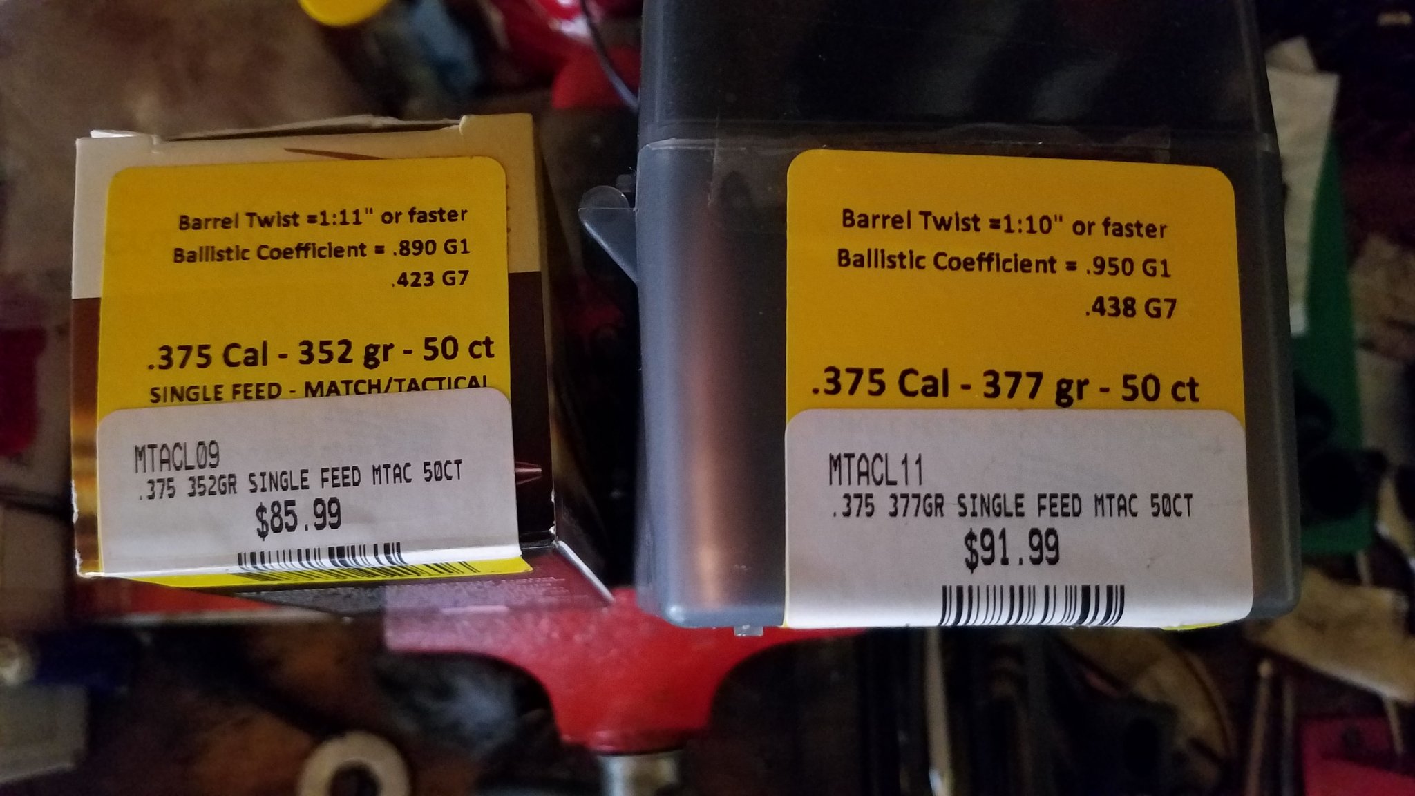

My backup barrel is 1-8. Should be able to handle 375-400gr bullets
Just for information purposes, on mfg suggested twist rates.
And add @Geno C. 's real world 10 twist experience, my personal thoughts have been at least one twist rate faster based on other caliber experience and what experiences people like @MACHTECH share with us.

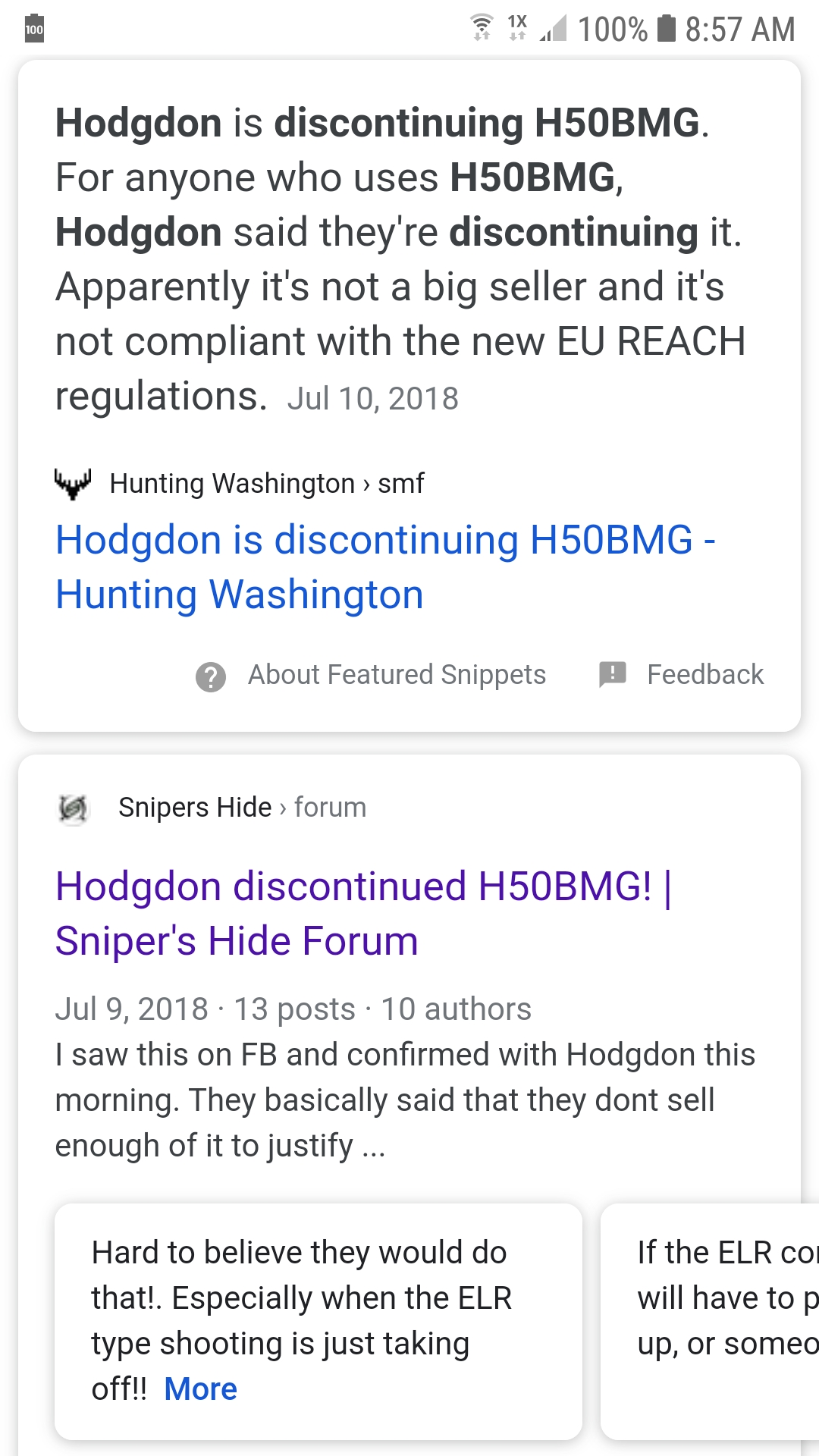

H50bmg hasn’t been discontinued
I think the "rumor" started because Hodgdon announced that they were discontinuing the powder about a year or so ago. As far as I know its no longer available. If it is I'd like to know too.....lots of things that would use it instead of something else in the shop. Can't get any IMR 5010 anymore and it was a wonderful powder for the 338 lapua mag and others. H50BMG was about the only equivalent.

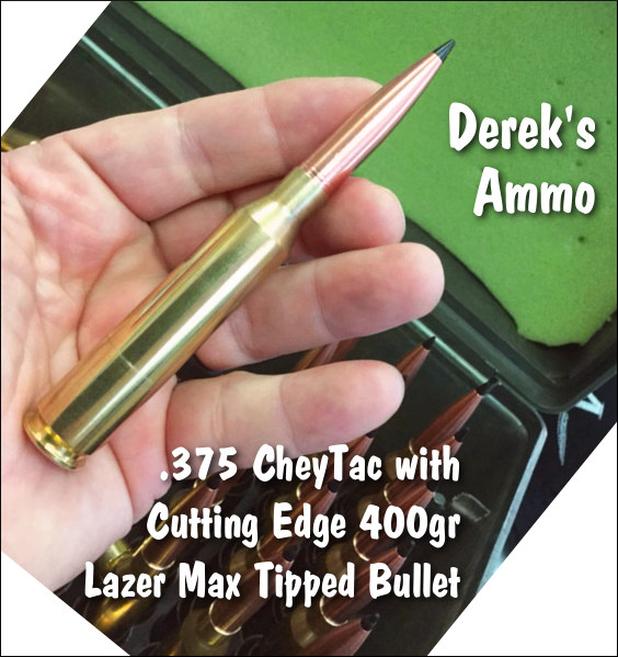

Just sent my Cadex Shadow .375ct off to Vestals Custom Rifles today. I am going with the same set up as before. Bartlein 32 in 1-7 twist barrel. I will be shooting CE 400 Lazer with N570. The load i used was 131.5 of N570, 215m, Peterson Brass. I was able to get 2960 AVG with an SD of 7.8. This set up was good out to 3090 yards and I have no doubt it will work a 2 miles.

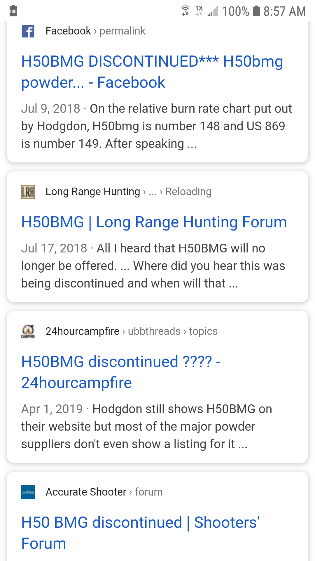

@geno C.
PLEASE BRING US UP TO DATE.
View attachment 7285615View attachment 7285617
PLEASE GIVE US THE GOOD NEWS AND WHERE TO FIND ?
The rumors even got me back then. There was a shipment into the US last spring. Myself and a few others I shoot with got some then. If I were to guess; I figure it will show again this spring. It’s about like any powder these days. The stuff is out of stock for 6 months to a year, then we get a shipment and it’s all cleared out again.
I spoke to Hodgdon a couple of weeks ago and was told H50BMG is being made again and a couple of shipments had already been sent to distributors. Since it is still “out of stock” at most outlets one can only assume it was bought quickly when it arrived; hopefully the next shipment will stay on the shelf a little longer so those of us who only get on the computer once or twice a day can locate and purchase some.
I got mine from Midsouth last time and it was in stock for about a week

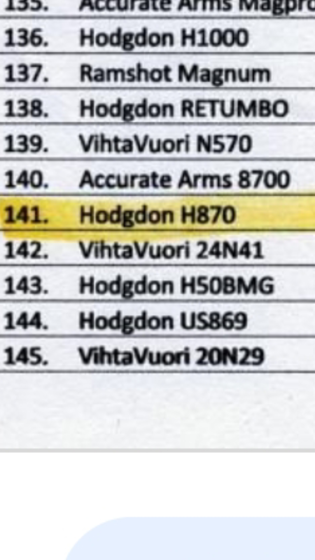

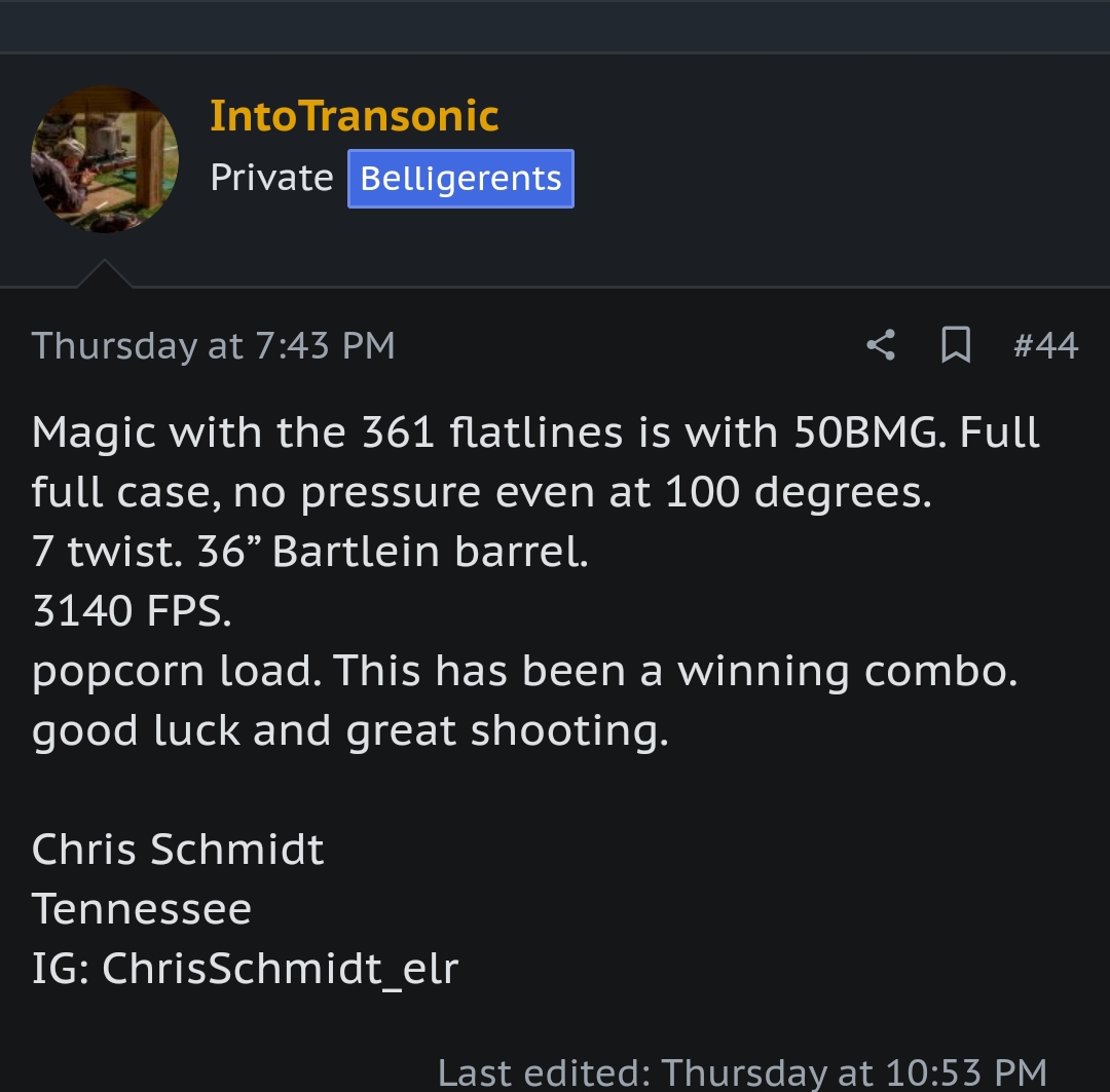

Bear in mind the attached post. 869 is a bit slower than bmg50.
Note Chris said a "full full" case. You will be experimenting.

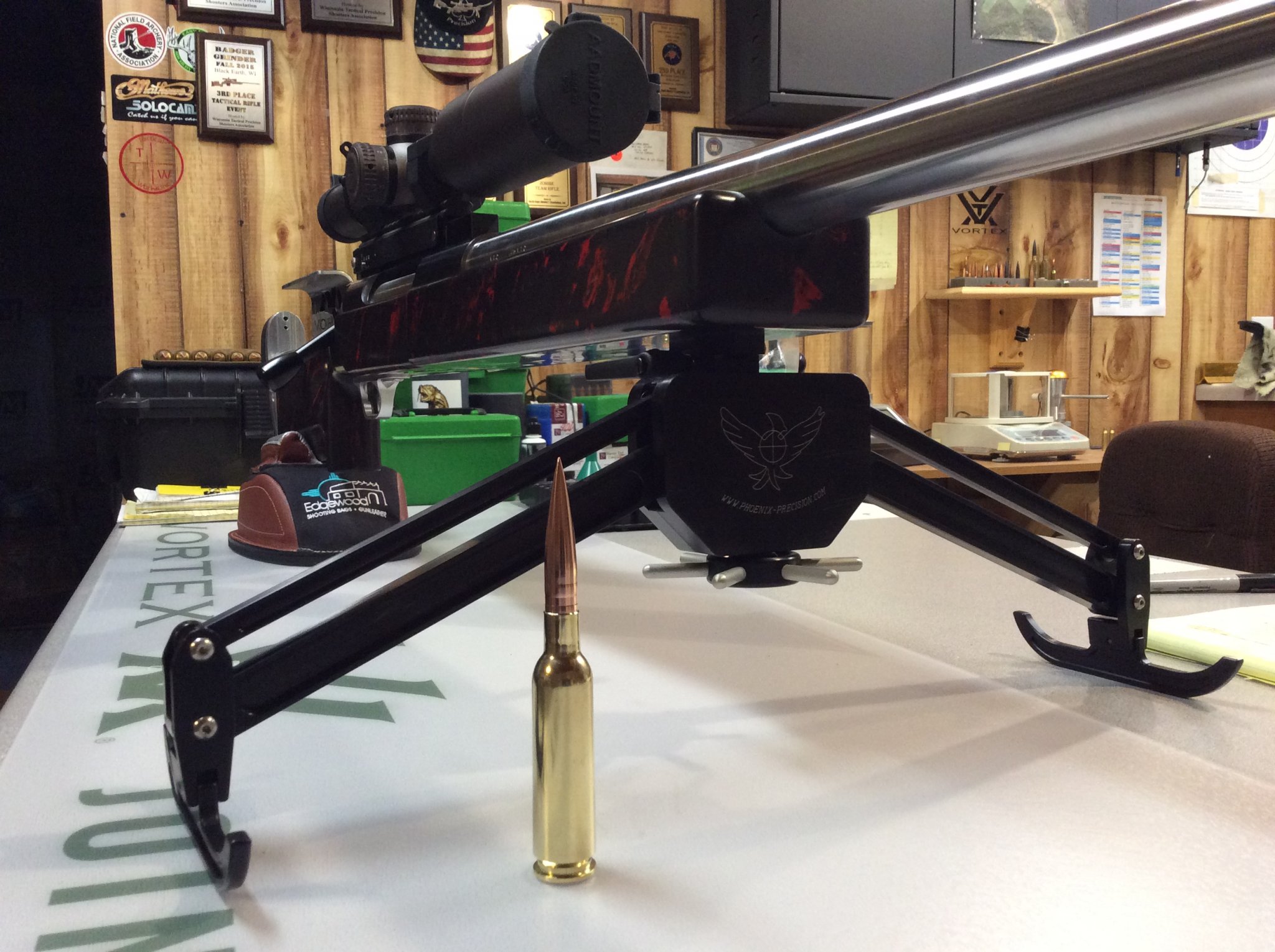

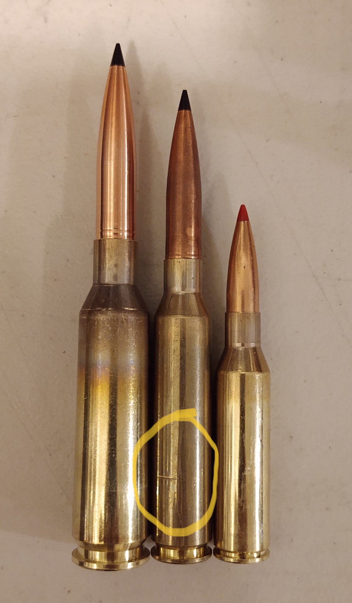

@MATCHTECH is it a reflection or is it common to cheytacs to have this mark on them? Mine chamber leaves the same mark on the brass. I had my gun smith fix it, I noticed it on another fired round from another picture from another shooter. I thought my smith didn’t have proper pressure on oil supply on the reamer gouged it with a chip
Not really sure. I just went out and looked at that. It is a mark, but that is an unfired dummy round. None of my fired brass have it and some are on their 7th reloading.
