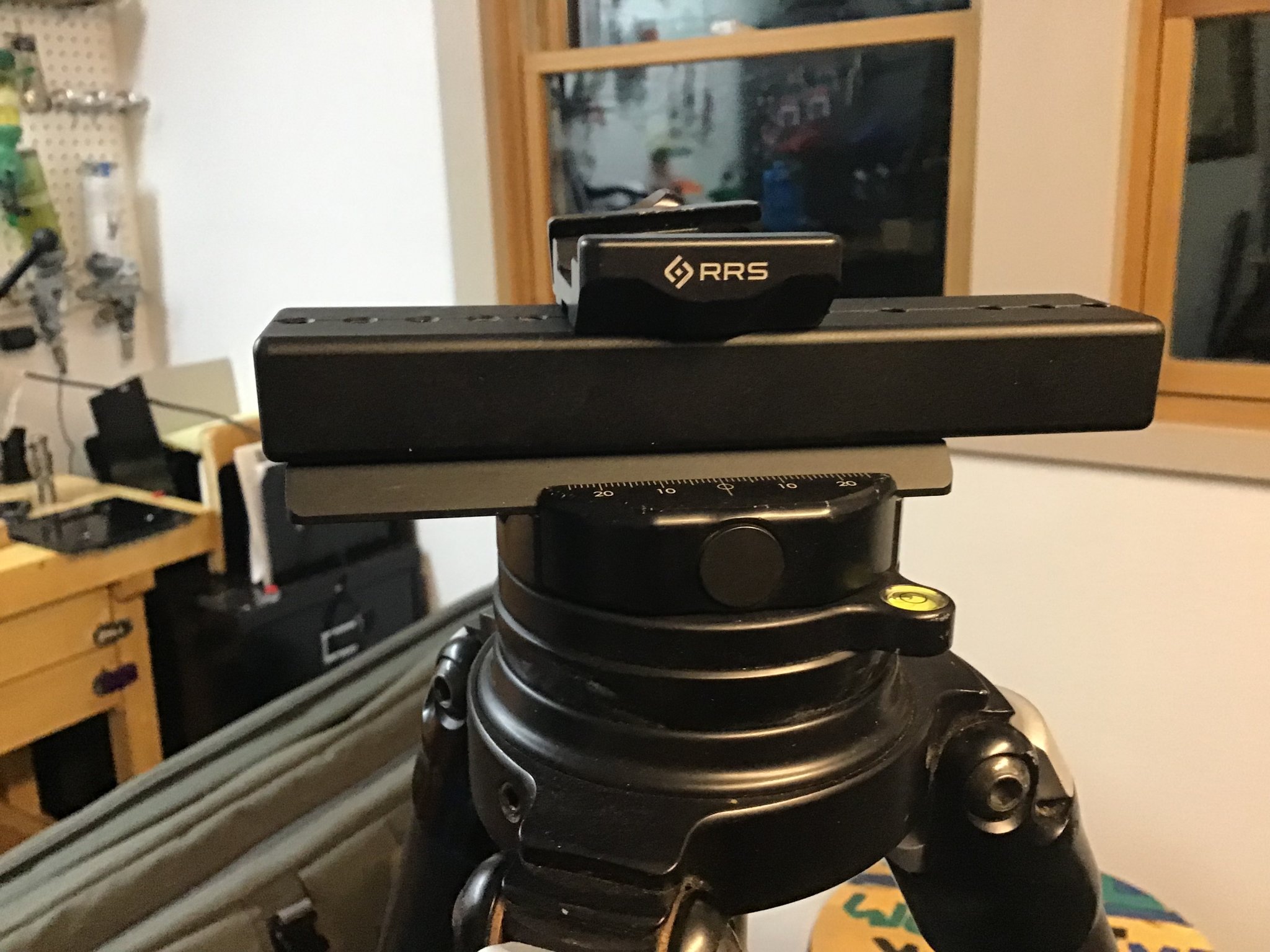

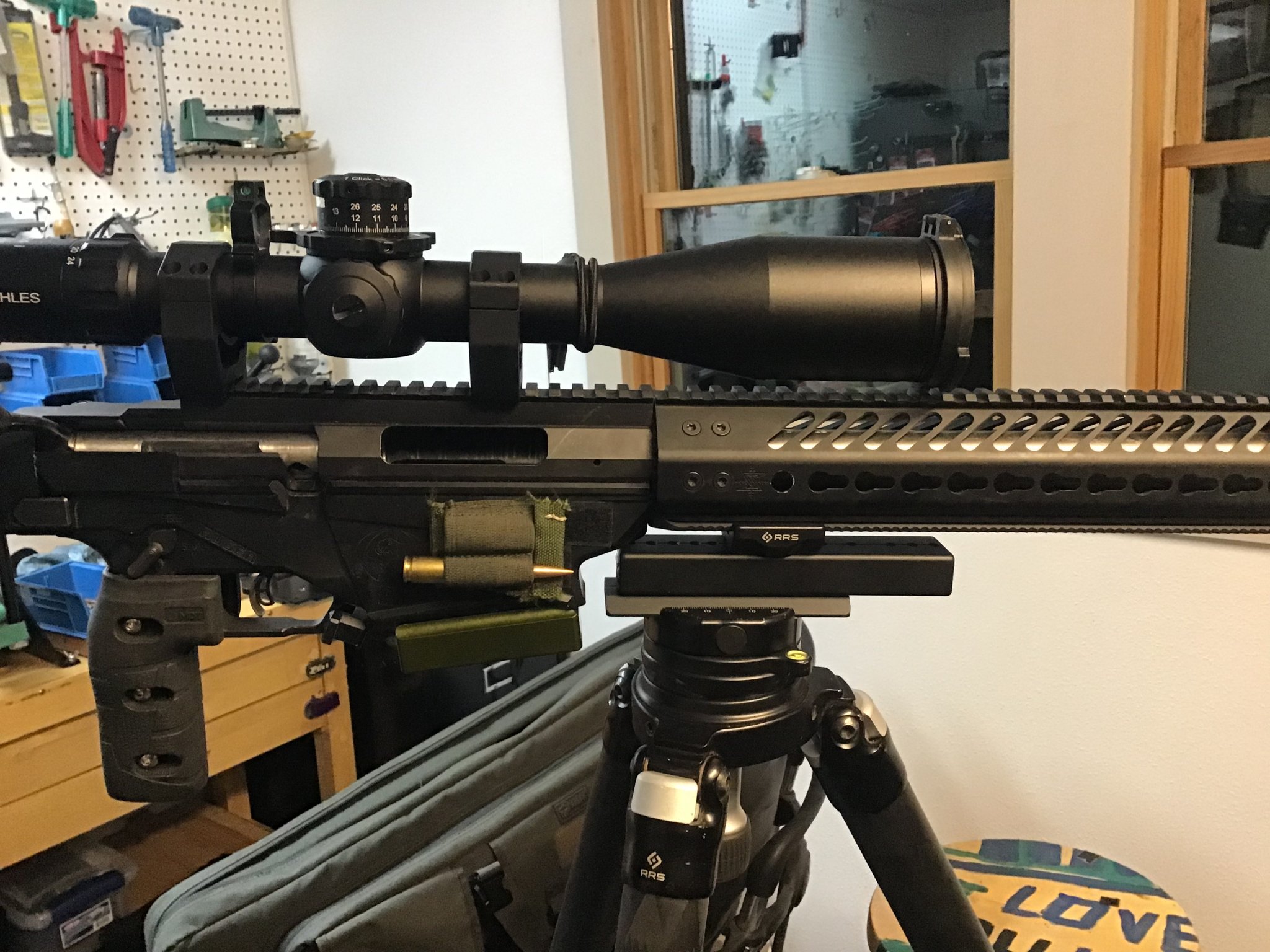

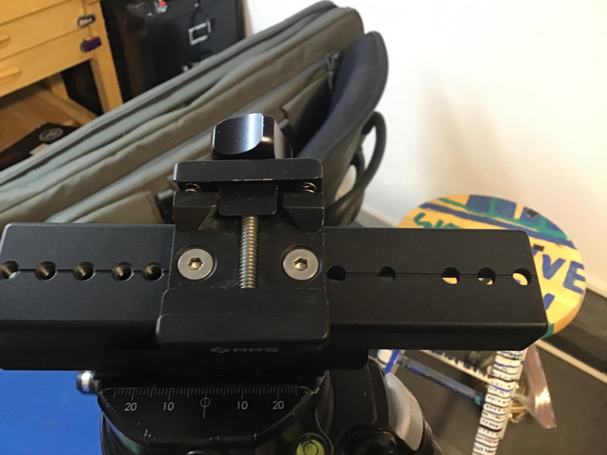

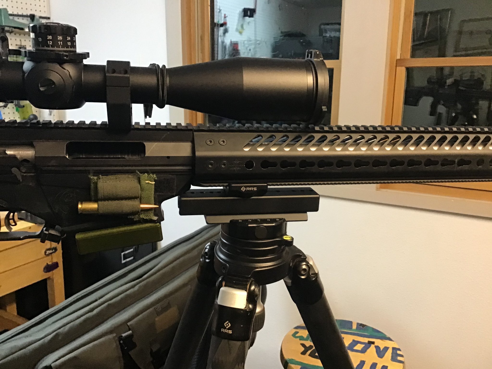

I have been playing with a slider on my AI ATX. So far I found that I can shoot very tight groups off tripod at 100 yards, allowing the rifle to free recoil wo reducing the slider travel. I have had the recoil affect my spotting shots, as I lose sight pic. I was also using 25x on scope, normally use 16x for matches and varmint shooting.
My next step was to shorten slider travel using screw inserted in base plate. My groups increased in size, but I was able to get sight picture back after initial recoil.
I attached slider to a bag/frame and found zero was same as tripod. And that zero was also same as my OTB bipod (not using slider).
Next step will be refining my hold to better control the slider recoil travel. I think my reducing slider travel was initially due to my form. Ill be shooting it outside in excess 200 yards, with 16x (vs 25) power. I expect I’ll be able to spot my own shots wirh slider.
Pros so far are tight groups off tripod. And same zero for bag, tripod one OTB bipod.
And it seems I’m getting close to performance infer recoil as with muzzle brakes I’ve tested, using a suppressor instead. That’s actually pretty nice.

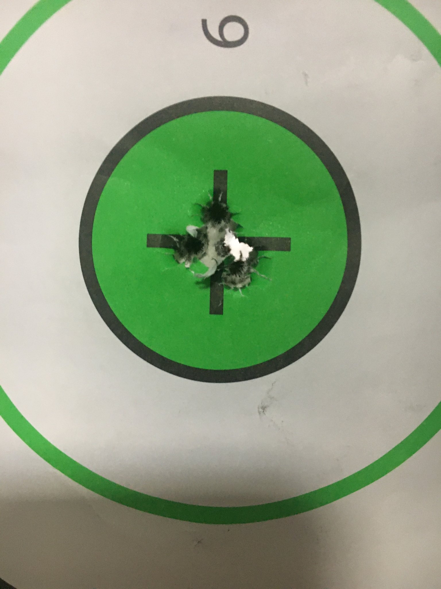

Second session with slider, standing tripod at 100 yrds indoor, 5 shots. 6mm CM, 115 gr DTACs
i am improving my position, square up behind rifle. I’m seeing the point of aim for brief time after recoil starts, and lowering power to 16x im spotting my own hits out 5-600 yards on outdoor range.
the slider makes the recoil come straight bak into my body, and the recoil, follow thru is consistent shot to shot.
another thing i found is my sitting tripod zero same as my prone 1-600 yards.My standing tripod was lower by 2/10 mil from prone, but consistently
I ordered another slider, with Intent of having other shooters test it. That’ll be telling
Reactions: carbonbased
