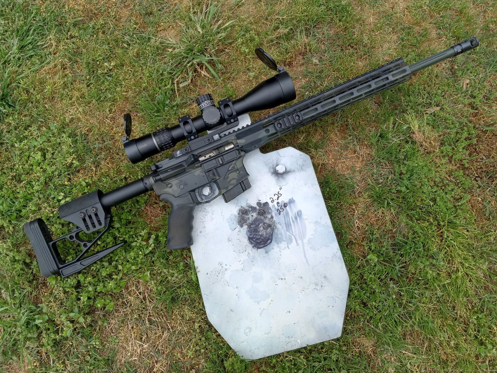

The accuracy is so good its hard not to want to go there. Its almost 1/2 Moa better on both tests than 27.5 or 27.8 and more than that above lighter loads. I would bet going a bit higher would be great as well but dont want to go there.
This lot is Hornady brass. 28 is basically just shy of the bottom of the neck so not super crunchy but crunchy none the less. Maybe I'll load 5 over and over and see how many firings I get before the pockets start to give up. Convenient enough for me to do that before I commit to this whole lot of 300 and blow them out after just a couple firings.

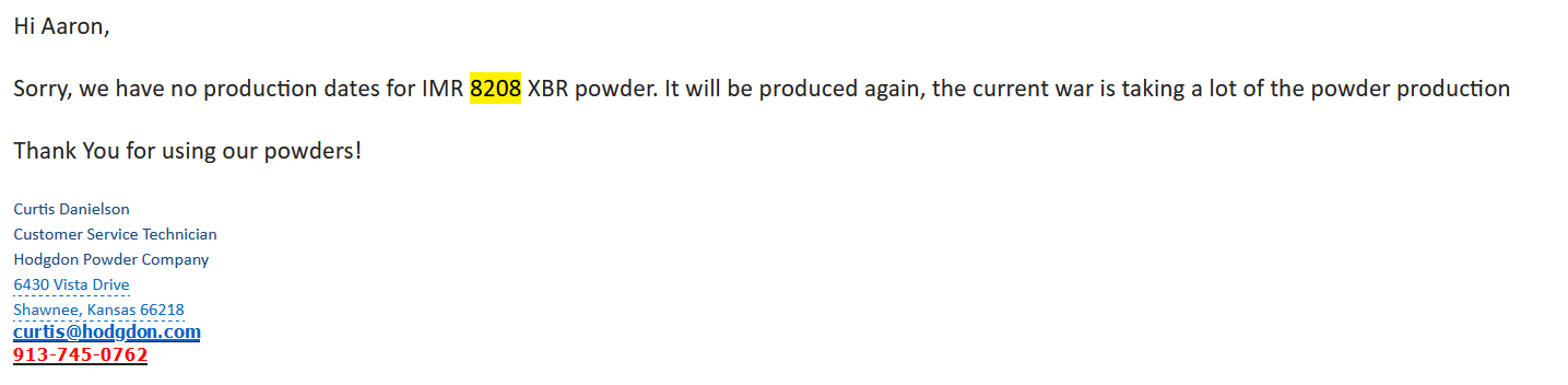

I missed 8208, I ran out not to long ago and switch to CFE223. I did contact Hodgon asking about the Unicon Pu$$ known as 8208 and here is the response. I may try tac on the 130 as I have a decent amount of 130s laying around.

I missed 8208, I ran out not to long ago and switch to CFE223. I did contact Hodgon asking about the Unicon Pu$$ known as 8208 and here is the response. I may try tac on the 130 as I have a decent amount of 130s laying around. View attachment 8152792
Honestly, if we can’t hardly support the Ukraine conflict, we’d be absolutely crushed in an actual drawn out war…
In the mean time, I guess I’ll do my best to be ready and buy 8208 next time it hits the shelves.

Tony,
US politics has nothing to do with the availability of 8208 because it is made overseas. Hodgdons sells what it can get, when it gets it.
Hodgdon buys single-based powders from Australia, and double-based from Canada. Powders are then rebranded to give them a local feel.

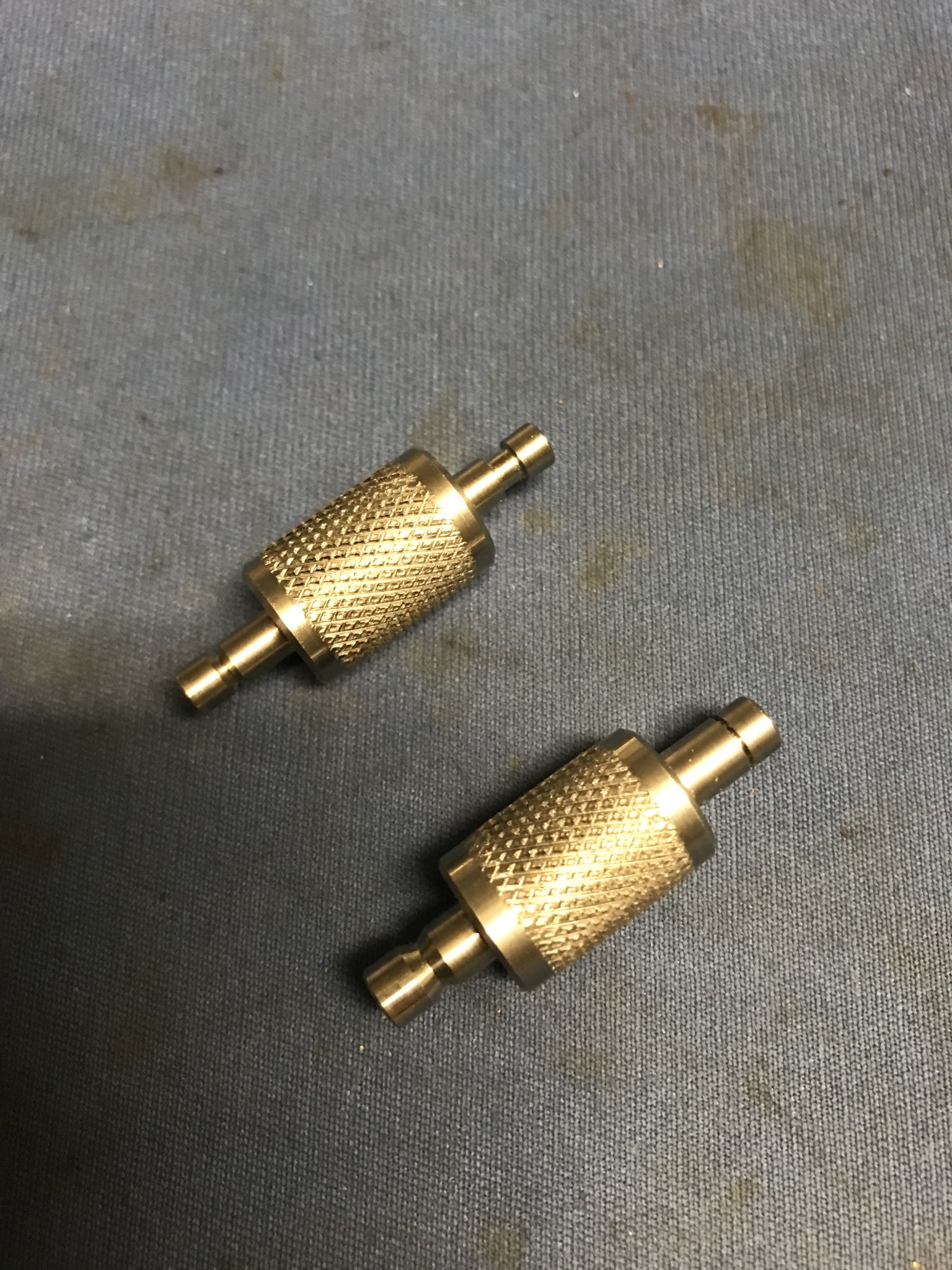

One hack for tightening Small Rifle primer pockets is to use the RCBS Primer Pocket Swager 2. Fit the wider Large Rifle stem and spud; and instead of the spud going into the Small Rifle pocket it presses the brass around it. Brass then splays into the void of the pocket. Pocket is pressed back to the original diameter and leaves no marks. Seems a waste to throw away expensive brass before its time just because the pocket has come loose.
Not suggesting you buy the swager just for this but just saying - I use it on the larger 6.5x47 which uses Small Rifle primers and it works. Never tried but you could probably do something similar with a hammer, flat-ended hole punches, and a vise.

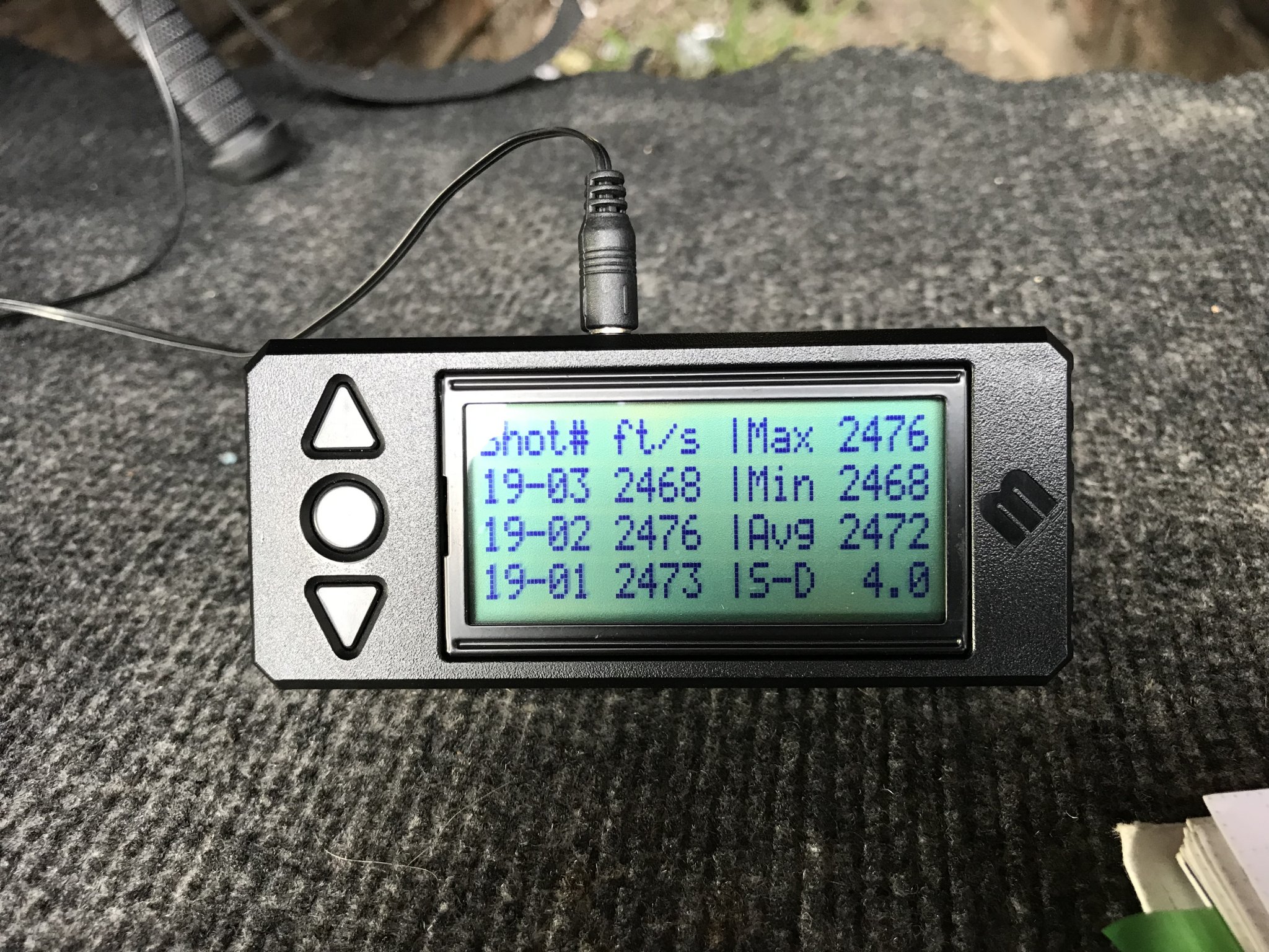

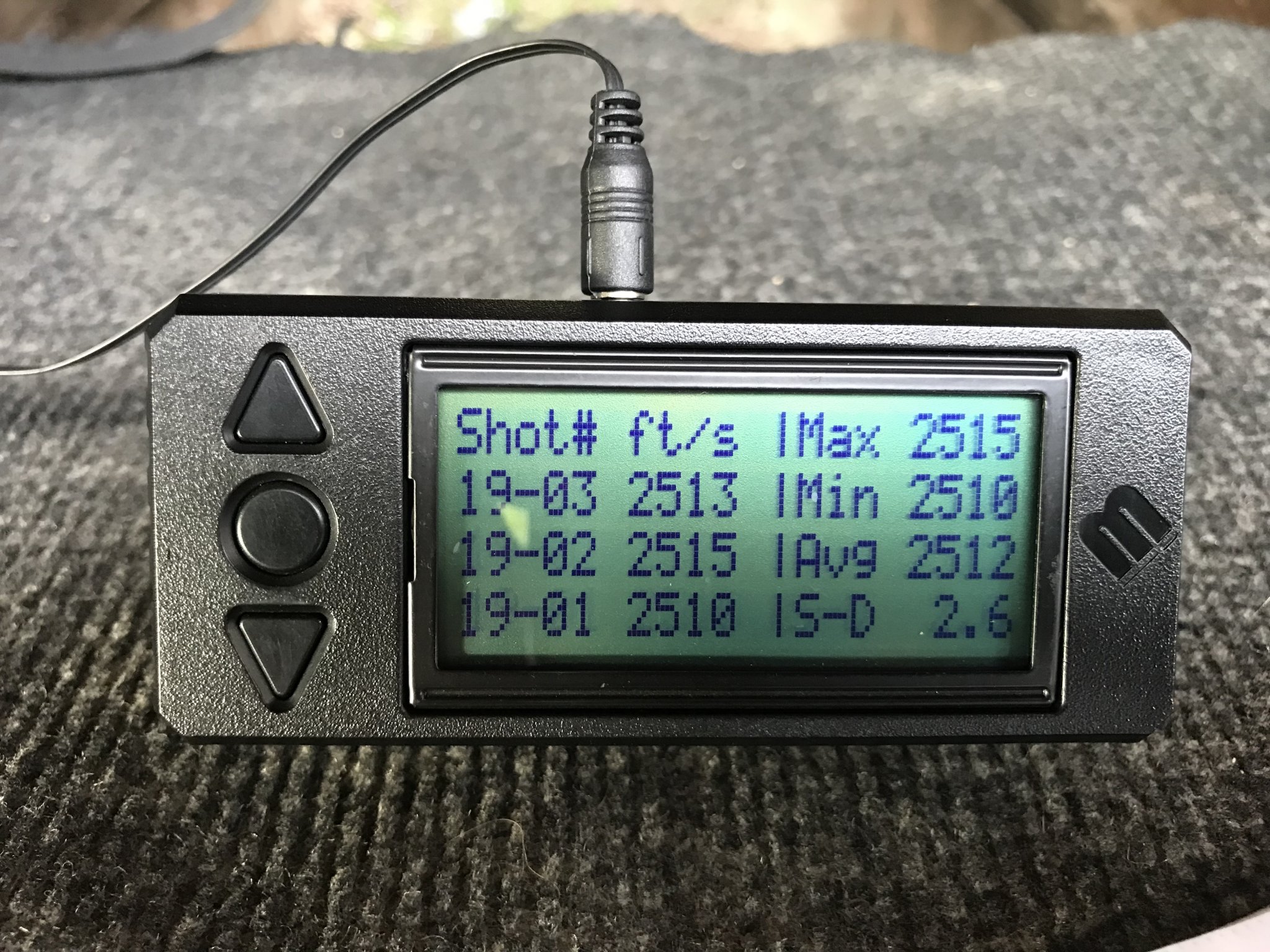

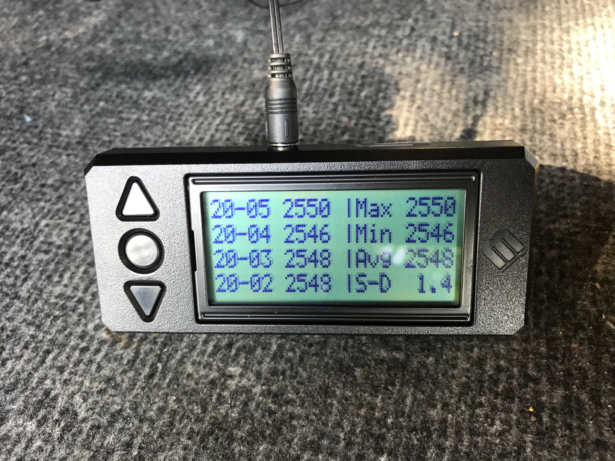

Took a brief look at Lever today. 92D/50-60RH, 5-7SSE-pretty good conditions. Just a short test-ran 30.0/30.2/30.4 with Sierra 123’s, RP 7 1/2 in Lapua brass at 2.270 OAL. 2517/2514/2539, with no pressure signs in 20” Satern cut rifled barrel. Seems like there’s plenty of room to move up a grain or so and see where this goes, and how temp stable it remains through the summer. Very reminiscent of CFE223 loads. For reference, 27.2 AR Comp with Sierra 123’s and RP 7 1/2’s runs 2525 with 7.0 SD in same barrel. More, as able.
For Lever loads in the Grendel, you can start with CFE223 data, and expect to end up 50-75 fps faster on the top end for the common bullet weights. SD's and accuracy are both generally best when it's pushed up to the top (and if you're not going to do that, might as well use 8208 or H4895 for temp stability with those lower velocities.
Lever and CFE223 are both fairly temp sensitive in most loads, but they're not the same powders and don't react the same way. As someone else said, CFE223 gets squirrely pretty quick on the top end, but all my experience with Lever, in a bunch of different cartridges, is that it's more forgiving when you get up to max. Just watch that temp sensitivity, and if you've got 20-90 degree temps, you'll want to use different summer and winter loads. If you develop the load at 90°, in the winter time it'll be slow enough that you might as well just use a stick powder unless you bump the charge up to get back in the same velocity window.
This is why I've been talking about Lever loads in terms of velocity rather than powder charge. Velocity is a much better indicator of pressure; the powder charge can vary a lot depending on the temperature.

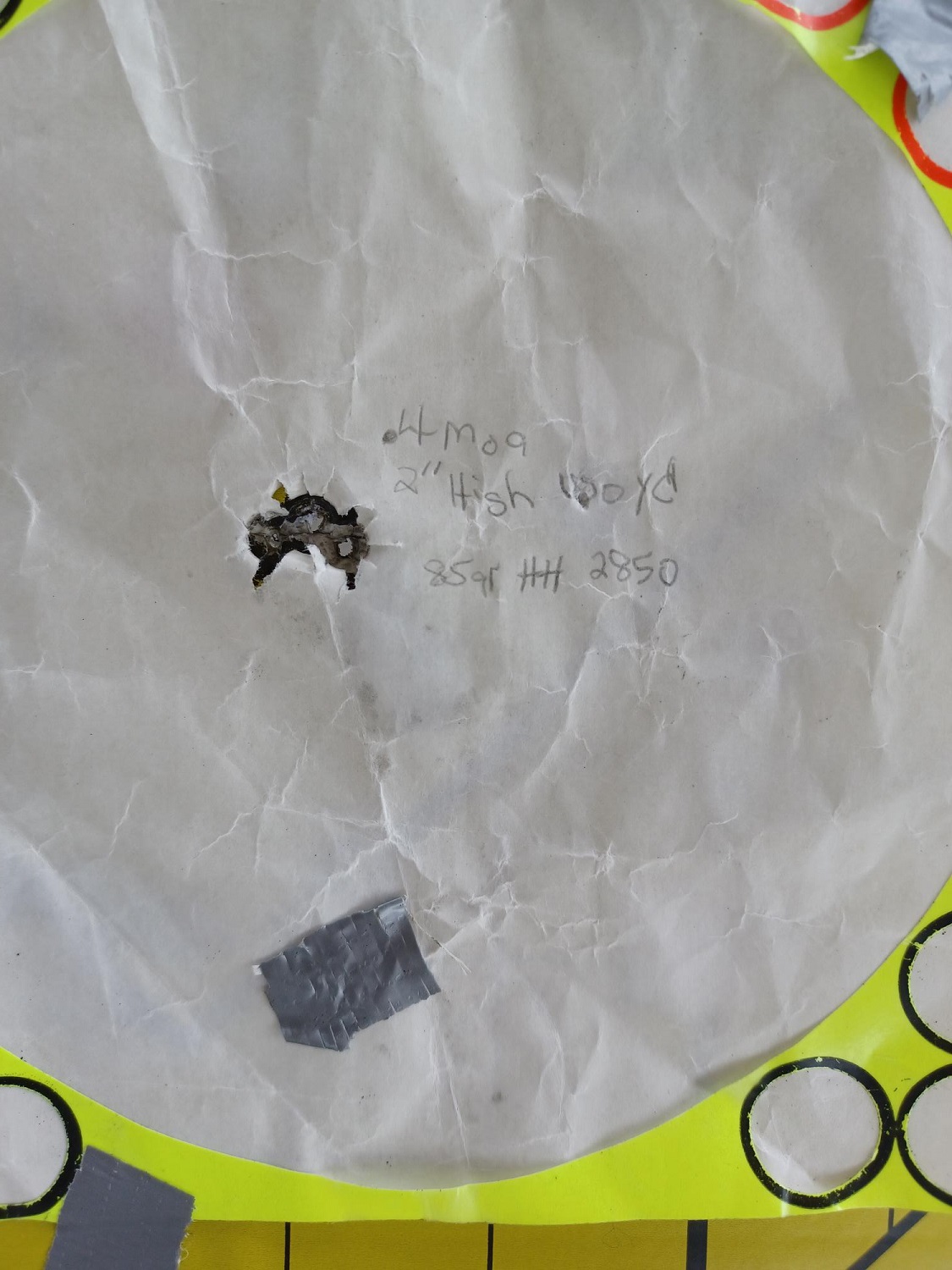

Recently got a BCA 6.5G 18" upper. Its shooting great. Just worked up a load using 85gr Hammer Hunter, 30.5gr TAC, Hornady case, WSR, 2.166col, 2850fps. Grouping .4moa 100 and .75moa 200yds. Been working on a load for 120gr ELDM right now looking real good with CFE223 30gr @2460 got me all touching .4moa also @2.255.
  • Love
Reactions: Snuby642 and bobke

Basic,
Depends whether you are more interested in internal or external ballistics.
If you, like most of us define shooting by what we achieve down range, then what happens inside the gun is only a clumsy proxy for what happens down range. By clumsy proxy I mean shooters can still get good groups even thought their velocity spreads can be better. Annealing will lower those MV spreads to single digits but you still might not see any change to group size down range.
Be great if we won prizes for having the tightest velocity spread while shooting into the butts (no targets). Unlikely too many shooters would sign up to that discipline however.
As for group sizes, it is all about statistics. It is more precise and helpful to talk about the average group size, than cherry pick the best group to post. And if you define your accuracy by the best groups on the day, you only fool yourself.
I agree, you are correct. I guess what I'm asking is, is that normal? I was always under the assumption that really nice groups are usually from really tight ES's (providing of course the shooter is consistent in their fundamentals on the gun) If you would have told me a really tight group can be had with a 121 es I would have called bs.
Basic,
Yes, you can have a 120fps spread and still group well. Accuracy is more about all the velocities, not just the extremes. Standard deviation (SD) is a better metric to describe a string of shots than extreme spread. This is because it describes all the shots, not just two.
If you still have a record of every shot in the string what is its SD?
At 100 yards you can have big extreme spreads but good groups, because the velocity variation doesn't affect the trajectory very much. As you increase the distance though, you need smaller velocity variations to maintain the same accuracy, because those velocity differences start to show up as vertical stringing on the target.
And yes, at 100 it's "normal" at least in the sense that it can and does happen. Group size is not really linked to velocity consistency at that distance. And, conversely, consistent velocity is no guarantee of accuracy, at any distance.
Basic,
My buddy helped me work up a load ladder (only 3 rounds of each as we're short components right now) and the SD was 53.51 between the three.
