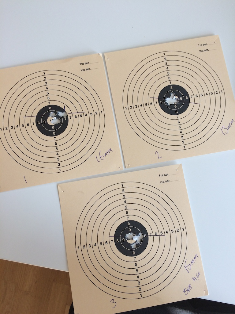

So its been a while since I shot for groups and I know my rifle is a solid shooter. But since I was challanged on a Swedish forum, I took my 6.5x47L to the range the other day and shot 3 x 5 shots from the 100 meter line, and this was the result:
(There was no warm up, no sighters, noting more than laying down on the ground and shoot. prone with bipod and rear bag)
Group 1, 16mm including coldbore. (0.62")
Group 2, 13mm (0.51")
Group 3, 15mm (0.59")
My rifle has had +2400 rounds down the barrel. I am more than happy with the result.

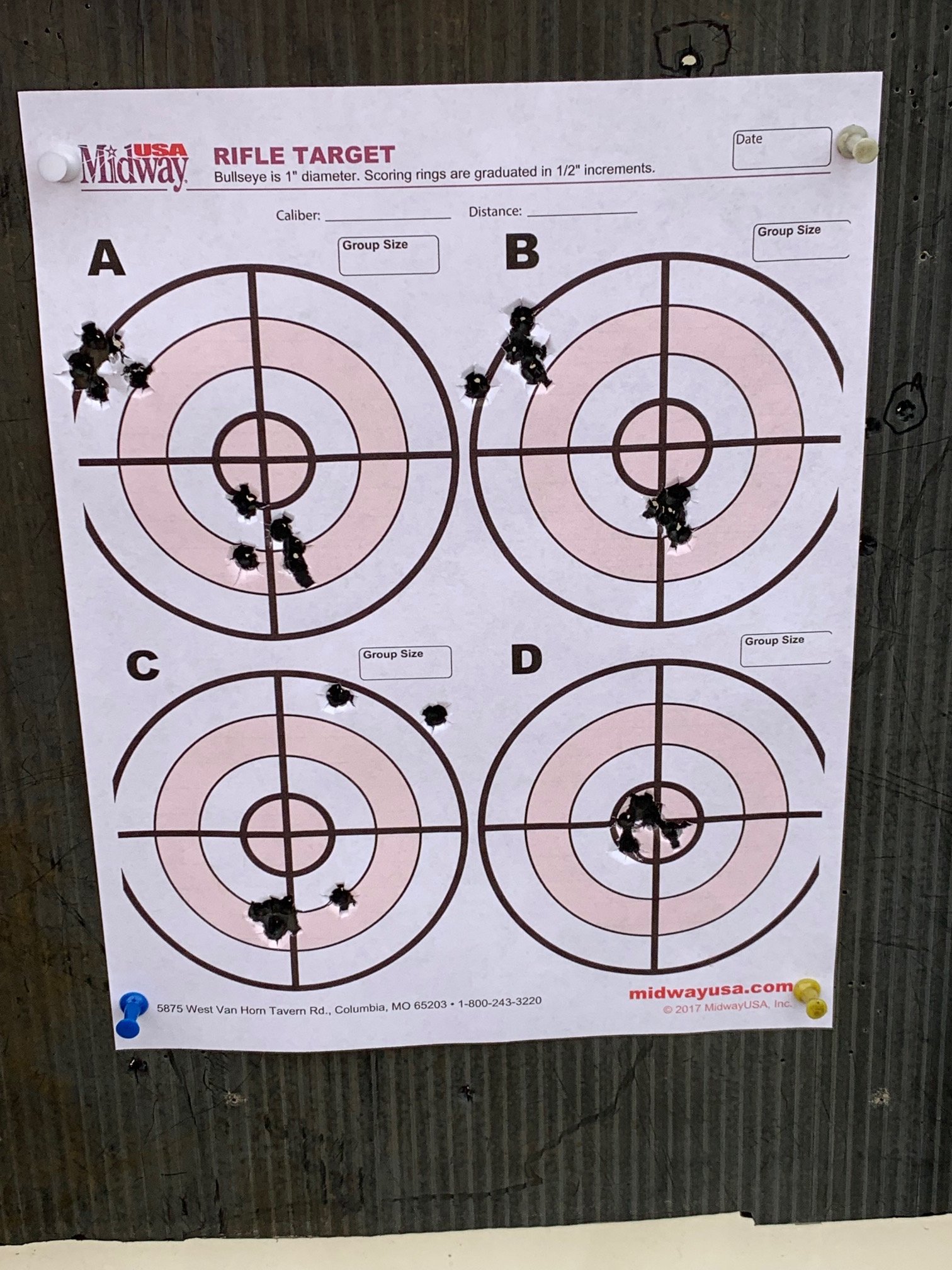

I shot a series of 5 shot groups yesterday with the Berger 130 Hybrids based on my initial testing with it that showed a good node between 36.5 and 37.0 grains of Varget in .1 grain increments.
All loads were seated .010" off the lands with a CBTO of 2.1005" but I was having issues while sizing I'm sure were related to the brass needing annealed that were varying in headspace as much as .002" but my average group size was in the .4" range.
The best two groups were at 36.5 and 36.6 but 36.8 showed the least amount of vertical but all were between .416 to .486" and just curious if I should go ahead and run with those numbers on the new brass I have or push for the higher node and see were I end up.
The highest I have run to is 37.0 grains of Varget and attached the Magneeto Speed for that five round group to check my speeds that averaged 2845fps with an ES of 5 and no hint of pressure or resistance on bolt lift.
