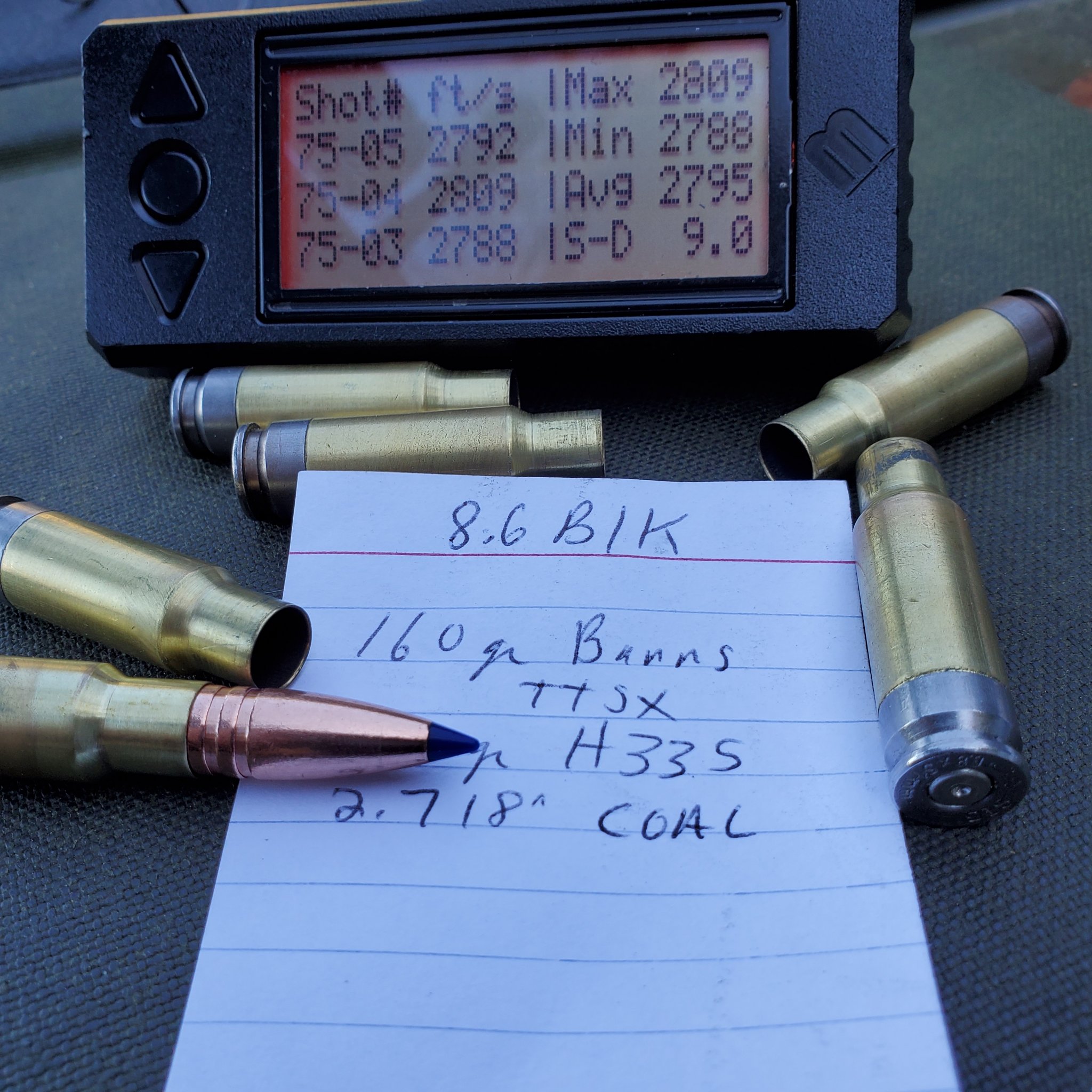

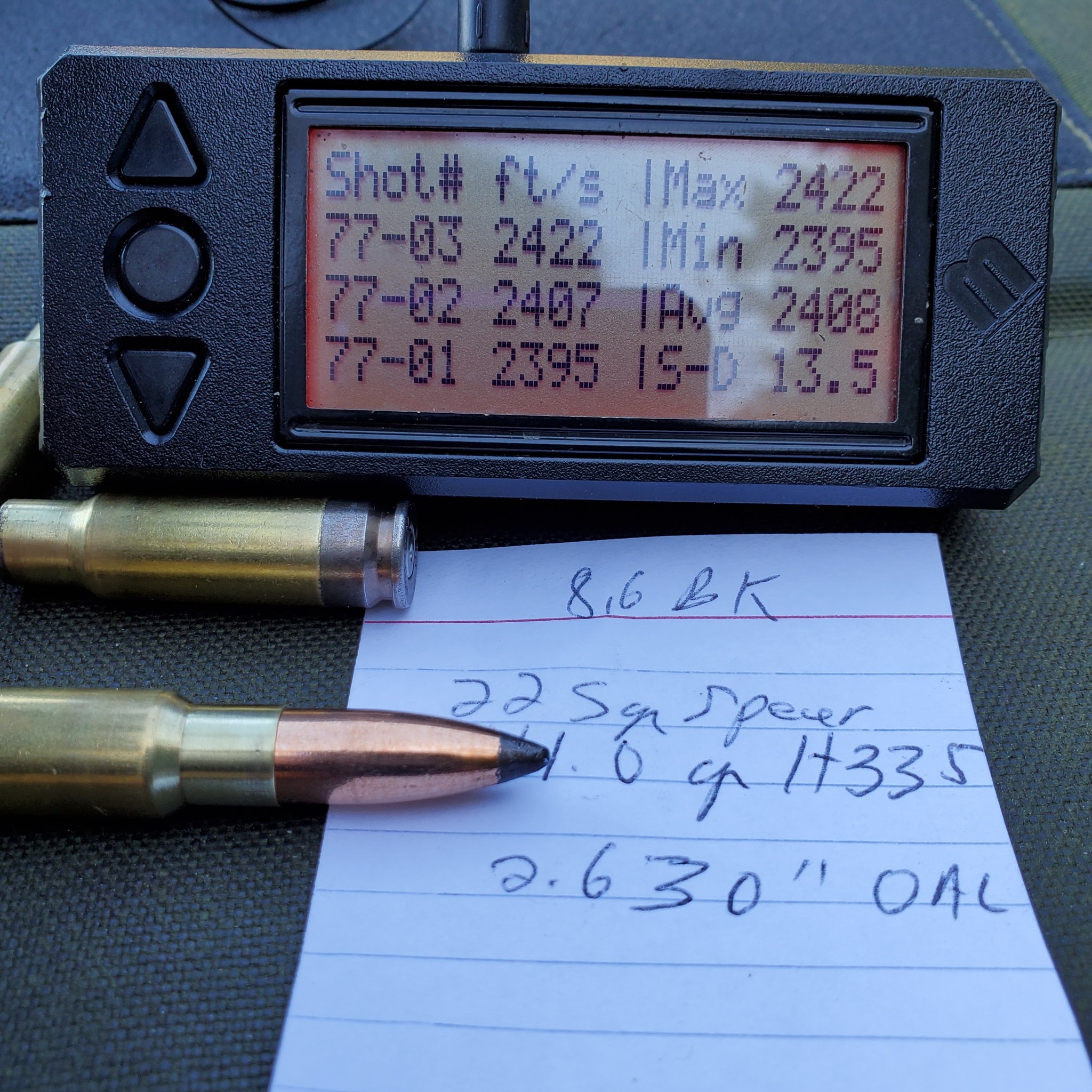

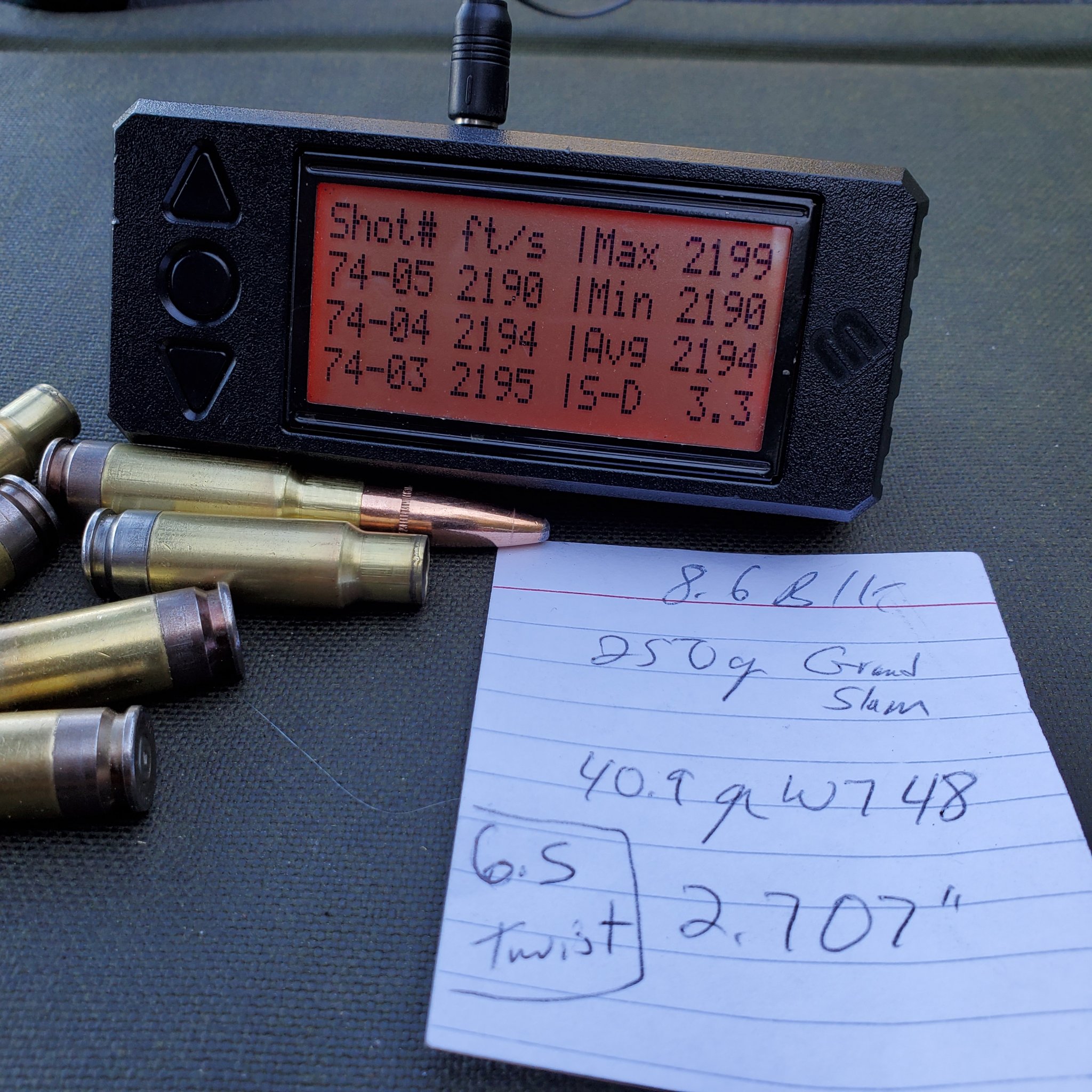

Well got the super sonic test done today for the 8.6 Blackout with a 6.5 twist.
Top velocity for the cheap Speer 200 gr lead bullets was 2604 fps with H335.
AA 2495 =2451 fps
CFE223= 2572 fps
IMR 4198 =2433 fps
2000 MR =2494 fps 4.3 S/D
Machined copper Hornady 225 gr GMX cut down in lathe collet to 154 gr were fired with H335 and reached 2788 fps.
Caught one in water jugs it mushroomed up very nicely.
Shot a few 300 gr Subs in both Sierra with 1680 and 300 gr Berger with imr 4198 in the 6.5 twist the Sierra strung out vertically...the Berger was round 5 into 1.1"
All in all a successful day. The 6.5 twist is totally versatile as I suspected it would be. And the 8.6 Blackout comes close to the 338 Fredral, with supers, for some real killing power.

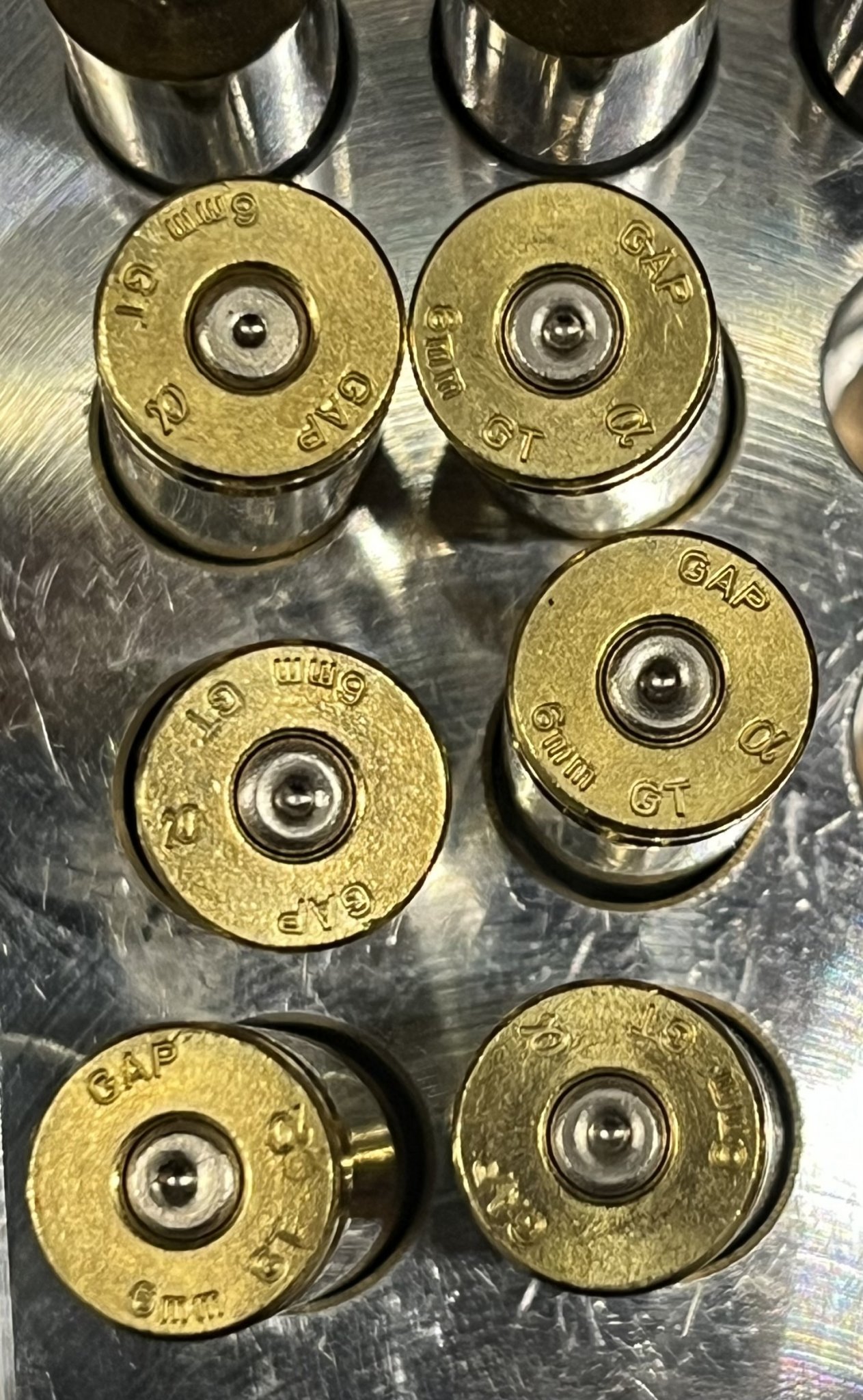

I went with the 6 GT SRP brass. Couldn’t get enough data to come to any conclusion. I loaded 9 cartridges using CCI BR4’s and had 5 failure to ignites. It was definitely easier sizing up without having to neck turn.
Were the BR 4s hard to seat?
The primers may not be seating properly.
If so run Remington 7 1/2 primers in your Alpha brass, as I do in the 6 Dasher...they will seat normally as the cup has a bevel to start and not square like the CCI and most others.
The Alpha brass has tight primer pockets, even with my 110 gr 3085 fps Dasher loads they will take awhile to loosen up.... stay with the Rem 7 1/2, they fire every time and produce small groups and are for high pressures, with their thicker cups, but no problem seating them, and they all go bang.
I did notice they were harder to seat than what I’m used to. I’ll have to give the Remington’s a try.

I reloaded more converted Alpha 6 GT brass with SRP. I think I solved the FTF issue. I’m using a Q Fix that had a Q “hard spring” in it. It seemed to be working fine until recently. I swapped my BR4s out with CCI 450s and still had FTFs. Took out the “hard spring” and replaced it with one I know will work every time. Every primer fired. It still seemed like the primers were tight in the Alpha brass even after changing to 450s. I loaded a batch of 10 using N133, BR4s and 300 SMKs. Here’s a photo of the fired primers, one misfire (top left). Fired primers seemed to look like donuts, maybe pushed out slightly from the pocket. I loaded these without powder or a bullet, not sure if that causes this to happen.

They are pushed slightly out of the pocket because there is no force pushing the case back against the bolt face to seat the primer, like when an actual loaded round is fired.
