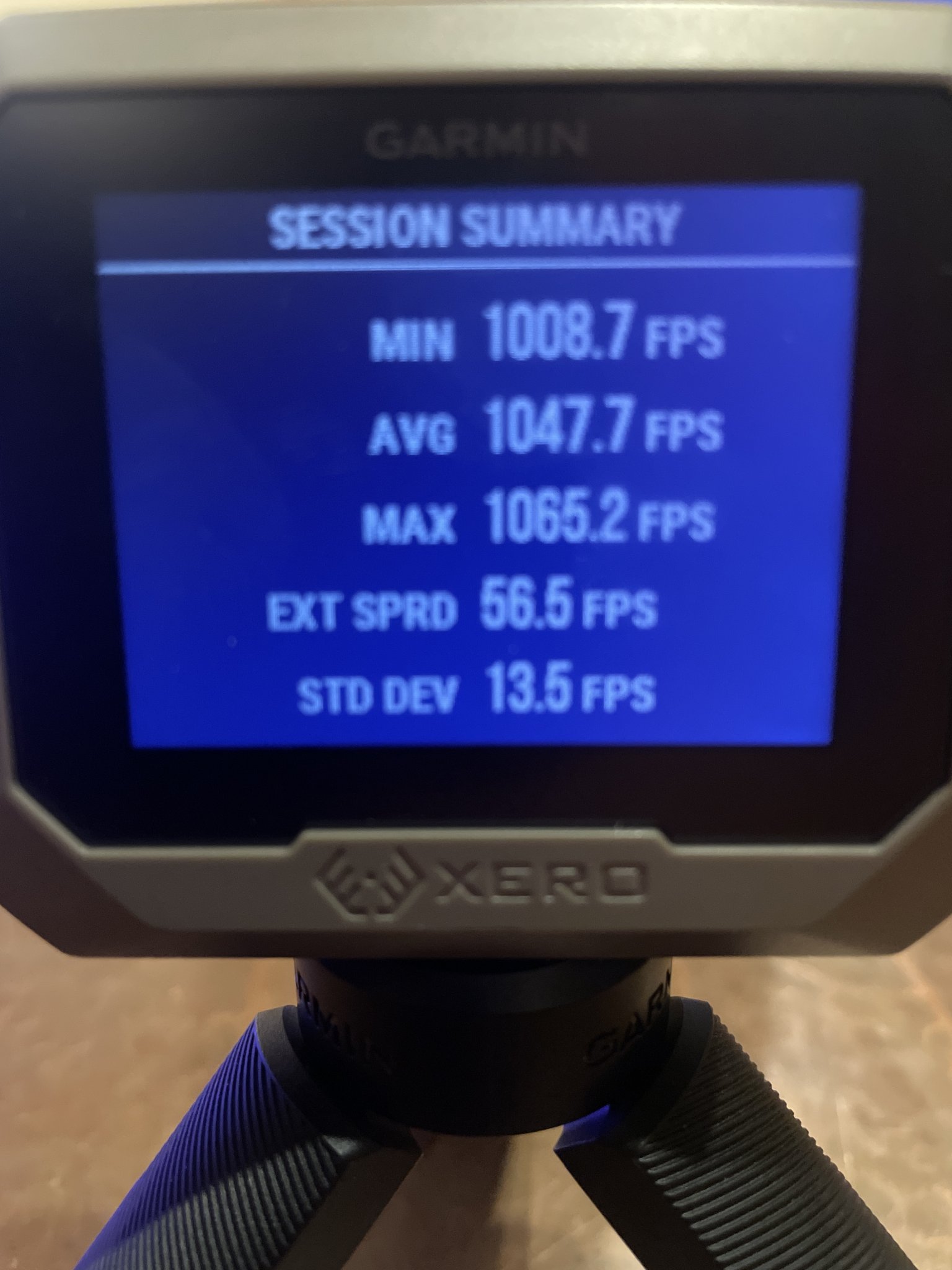

Interesting. I had decent results with them. Just at MOA at 100 yards averaged 1047 fps and std dev of 13.5fps out of 16” Mos-Tek barrel. Not perfect but good until I load my own. It would have been closer but had one slow shot at 1008 out of 20 shots. The rest ranged from 1039-1065.

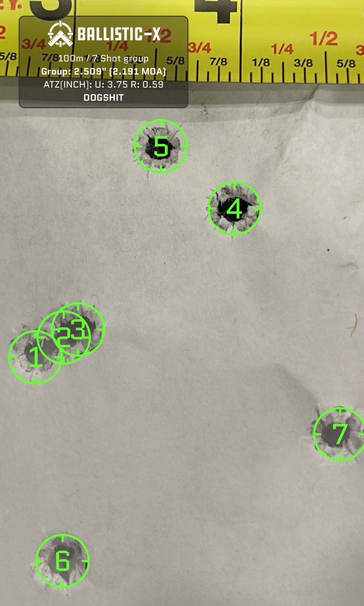

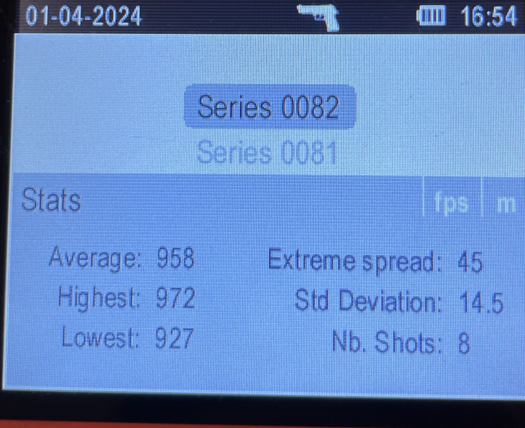

Not sure what is going on with loads lately. Above is 14.9 grains of N110, BR2 and 350 grain Makers at a CBTO of 1.943”. I made sure everything was just about equal and did a load development with the combo. Test several shots with a batch and this is the result. I thought I was expecting too much out of subsonic ammunition but can get 1 MOA out of 300 BO subsonic. Has anyone tried the MOS-TEK 8.6 barrels in 1:6.5?
Some other notes, I did 9 grains of Unique with the 350 makers. GRT gave me a velocity of about 1000 fps. Actual velocity was 400 fps. I sat the 350s all the way down to 1.900” using 15 grains of N110 and started getting a heavy bolt and ejector swipes.

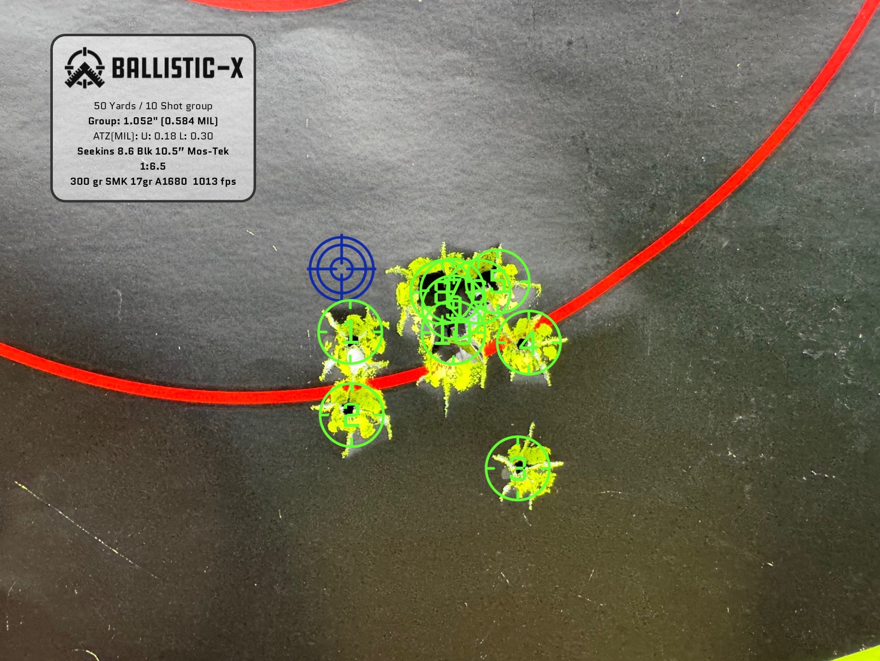

Changed the load to 15 grains of N110 and CBTO to 1.940”. Groups shrank to 1-1.5 MOA. Average MV was 977fps. Has anyone tried N120? I’ve read that it does better for subsonics in 300 BO. I was curious if maybe it would be the same in 8.6.
Just getting started on load development. Prelims look good. Very excited about this gun.
Seekins SP10 Mos-Tek SS 10.5” 1:6.5 twist
SiCo 36M
Garmin Xero C1
1/28/24
46F 88% 29.70in
300 gr SMK HPBT (factory seconds)
A1680
FGMM 210M
BTO 2.1900
Q brass x 1 firing
BTO 2.1880
COAL 2.790
COL 1.6765
16.5 966, 985, 972, 979, 996
SD 10.3 ES 29.7 0.8” @ 50y
17.0 995, 1013, 1017, 999, 1010
1007, 1010, 997, 1009, 1023
SD 8.5 ES 27.8 1” @ 50y
17.3 1033, 1049
Ballistic-X-Export-2024-01-28 17:14:30.097945.jpg

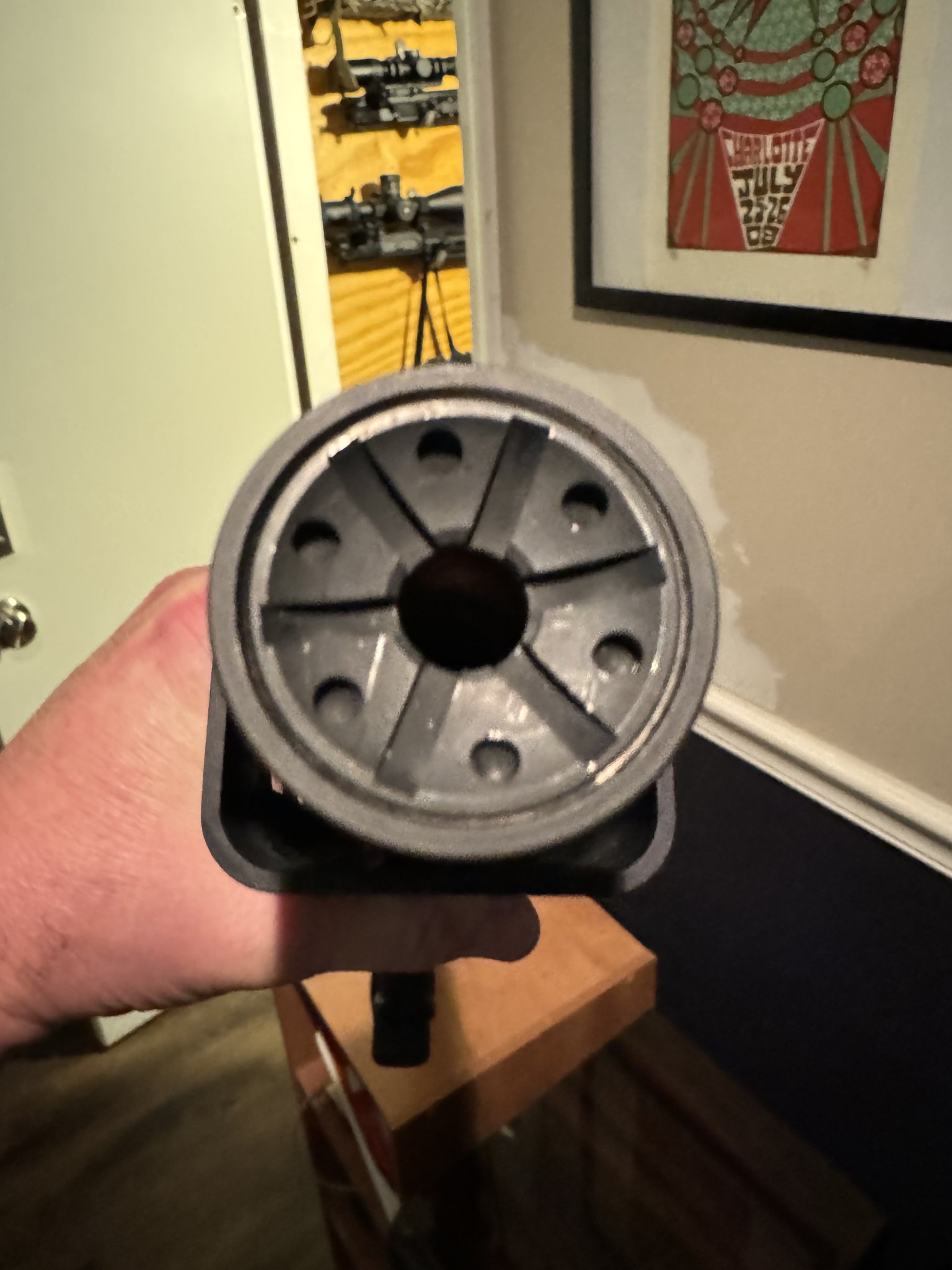

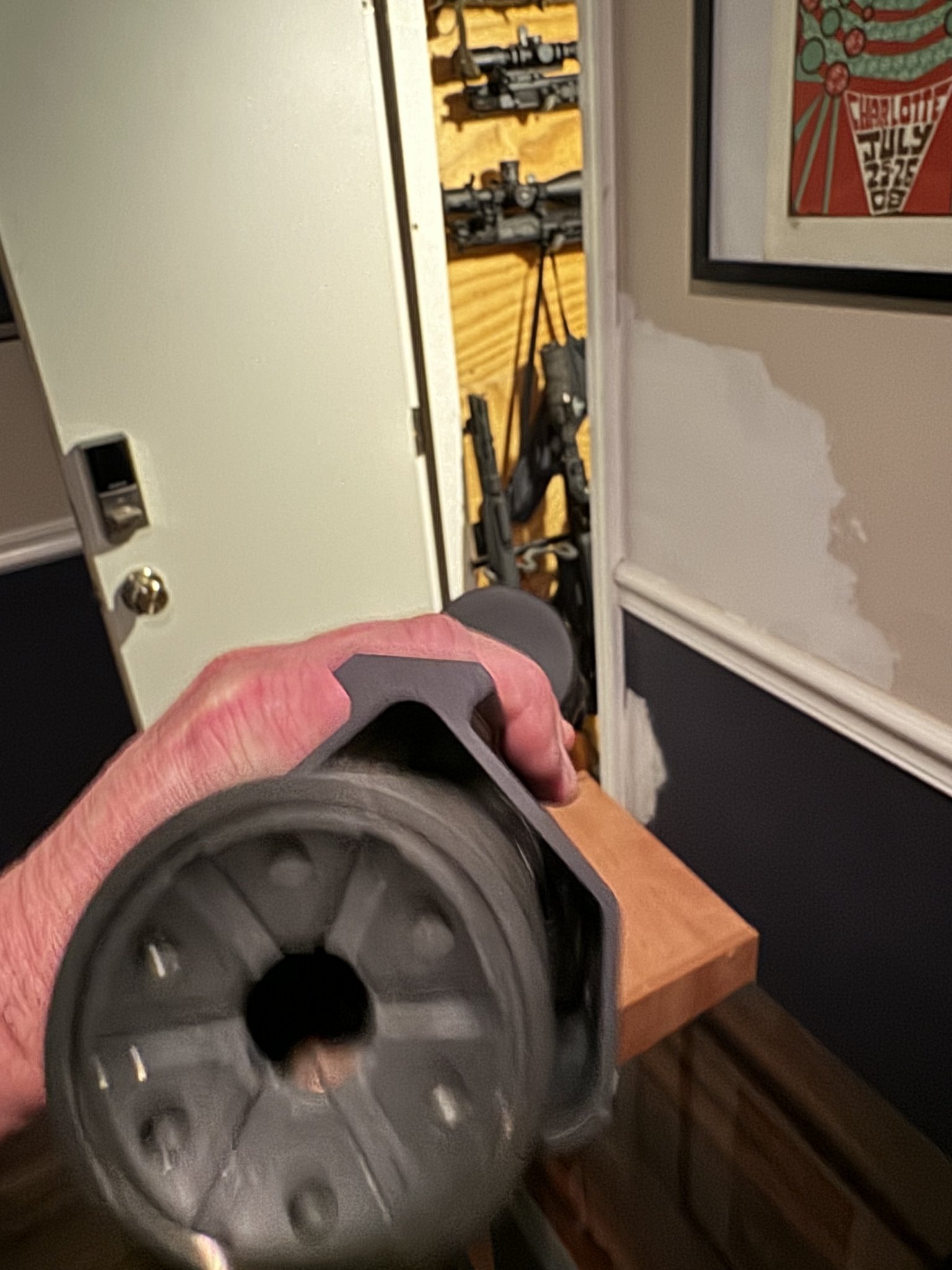

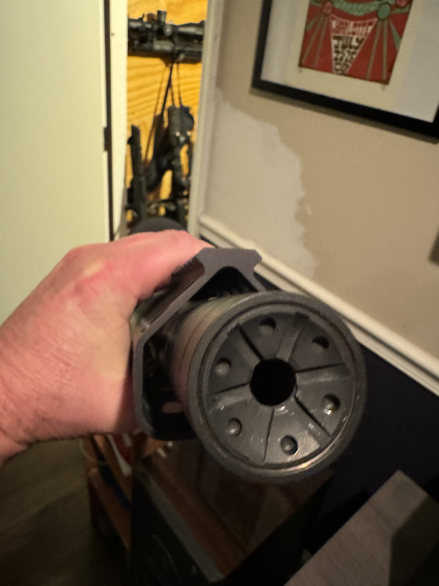

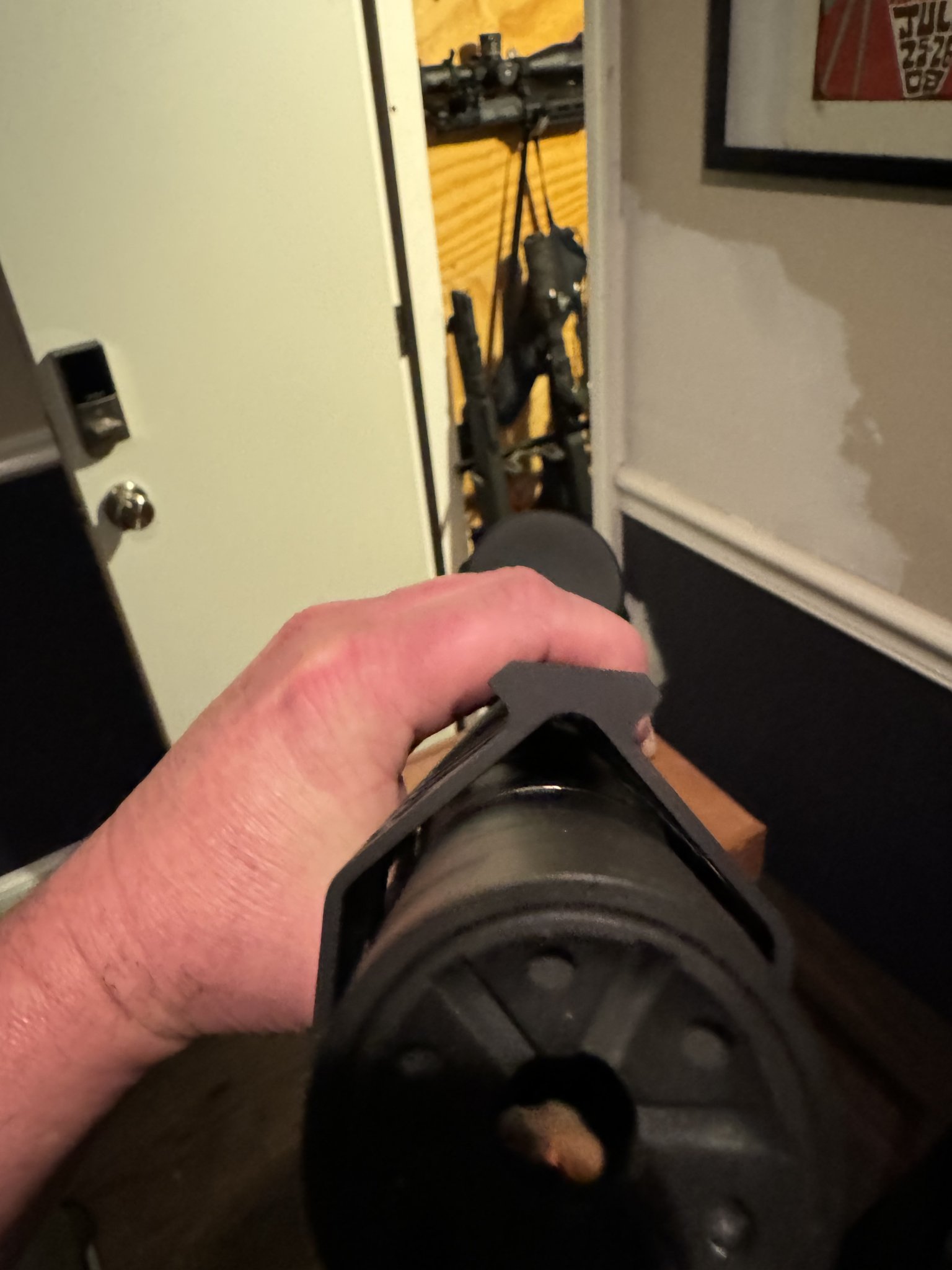

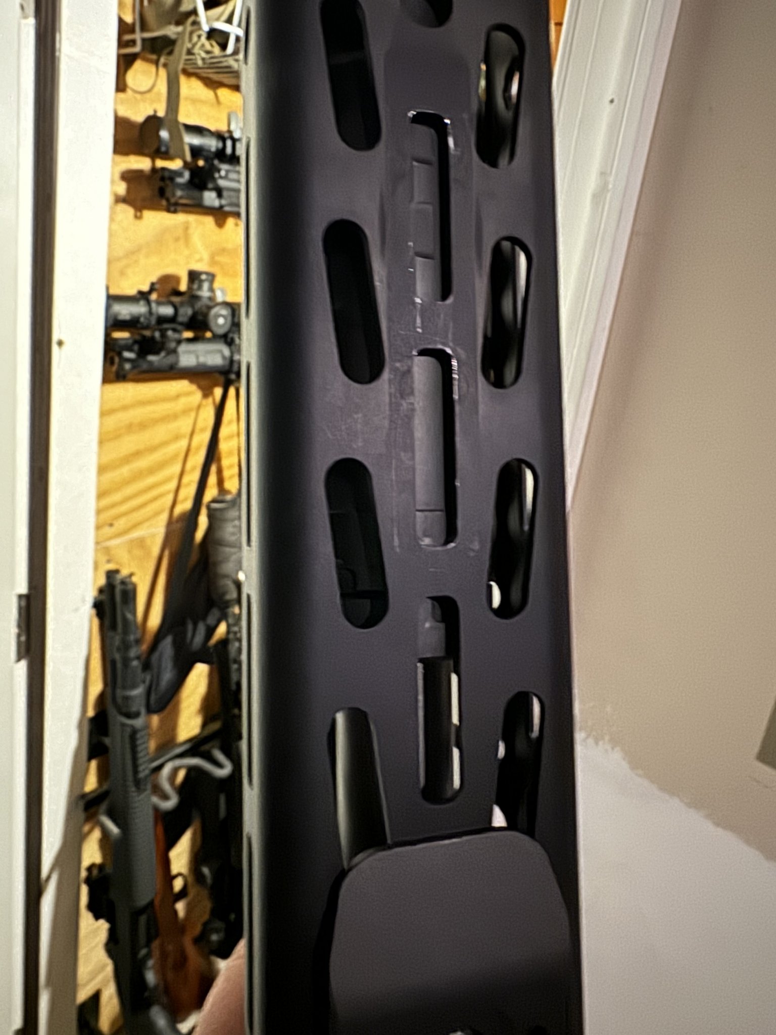

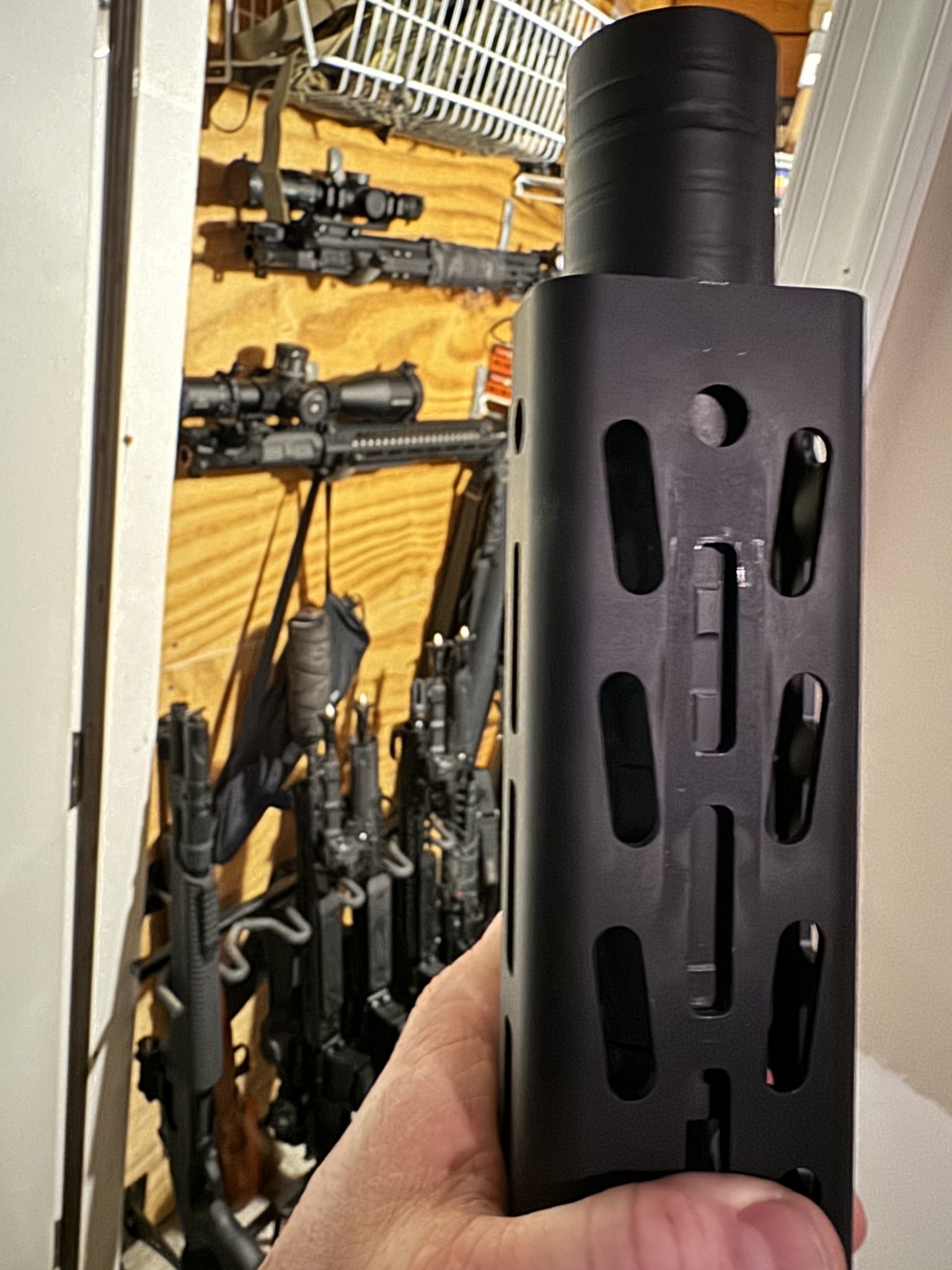

Any issues with the suppressor and the handguard? I was wanting to run this setup but worried the suppressor wouldn’t clear.
It clears. I’ll post pics. I have to direct thread obviously. There is not room to attach any 2” M-Lok picatinny pieces. The Seekins rapid attach ones with the spring loaded buttons on the end do fit but barely touch the suppressor so I wouldn’t recommend it unless you just had to. I’m ordering a one screw piece as there is a little room behind it with my 10.5” barrel I think it will fit.

using a .45ACP can for subsonic 8.6BLK (reloaded with 14.4gr of Accurate 1680 behind 285gr ELD-M bullets in a 12" barrel)?
Allowed cartridges for this particular suppressor list 350 Legend which has pressures upward of 55,000psi... I'm assuming a .338 projectile traveling at subsonic would be safe in such a can (assuming you have the correct barrel thread adapters)??
hint: Rugged Obsidian45

So far so good keeping things to subsonic. 1024,974,976,1006,971,958,969,989,990 fps for the first ten rounds with my not so trusty caldwell pro chrono.

That's a NO GO for the Obsidian 45 supporting 8.6BLK according to Rugged. If I had money to waste I might test it for myself ;)

Edit:
Seekins SP10 Mos-Tek 1:6.5 twist 10.5” SS
Garmin Xero C1
2/20/24
48F 42% 30.38”
Maker 350
A1680
Q brass x 2
FGMM 210M
BTO 2.4200
COAL 2.7910
COL 1.6775
16.0 910, 869 fps not stable @ 50
16.5 917, 918, 927 not stable @ 50
17.0 942, 959 stable @ 100 and locks bolt
Barnes 210 GR TSX BT solid copper
A1680
Q brass x 2
FGMM 210M
BTO 2.6100
COAL 2.6670
COL 1.6775
29.5 1762, 1773, 1757 fps
30.0 1837, 1799, 1794
30.5 1920, 1817, 1834 1” @ 100
BTO 2.1900 (308 comparator used)
17.0 1020, 1023 fps
17.5 1045, 1046, 1048
Q brass x 1
FGMM 210M
BTO 2.1880 (308 comparator used)
COAL 2.790
COL 1.6765
16.5 966, 985, 972, 979, 996 fps
SD 8.5 ES 27.8 1.2” @ 50y
17.3 1033, 1049
Reactions: 65x55guy

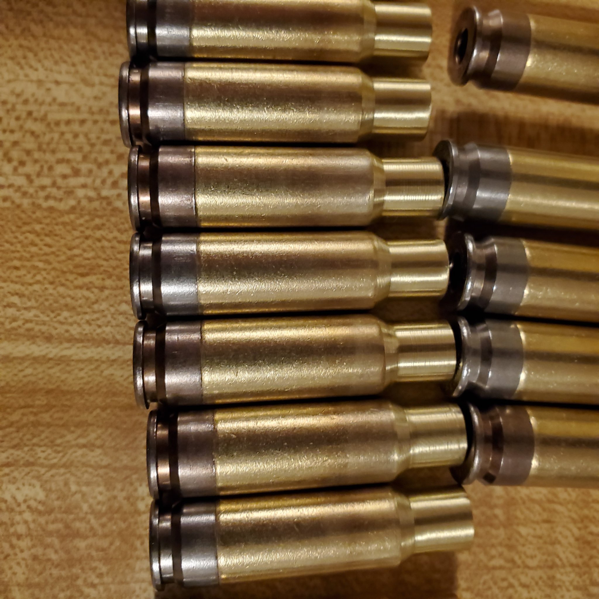

So I trued Rem 700 action and chambered a new 6.5 twist barrel blank for 8.6 Blsckout.
Going for high velocity experiment, making 277 hybrid cases into 8.6 Blackout on a bolt gun. Annealed, formed, annealed, F L die, neck turn...gonna finish one hundered, hybrid 227 fury cases to 8.6 Blk and load the with 300 gr SMK, the goal is 2200 fps QL says its possible. A 1400 yd gun? Just curios as to what can be achieved. I have better calibers for LR, but this will easily reach past 1000 yds, with excellent wind drift numbers...Run the ballistics on big 338 bullets. Plus it can easily sub sonic if needed. Spent a lot of time, effort, & dollars trying to see if this caliber is useful.
