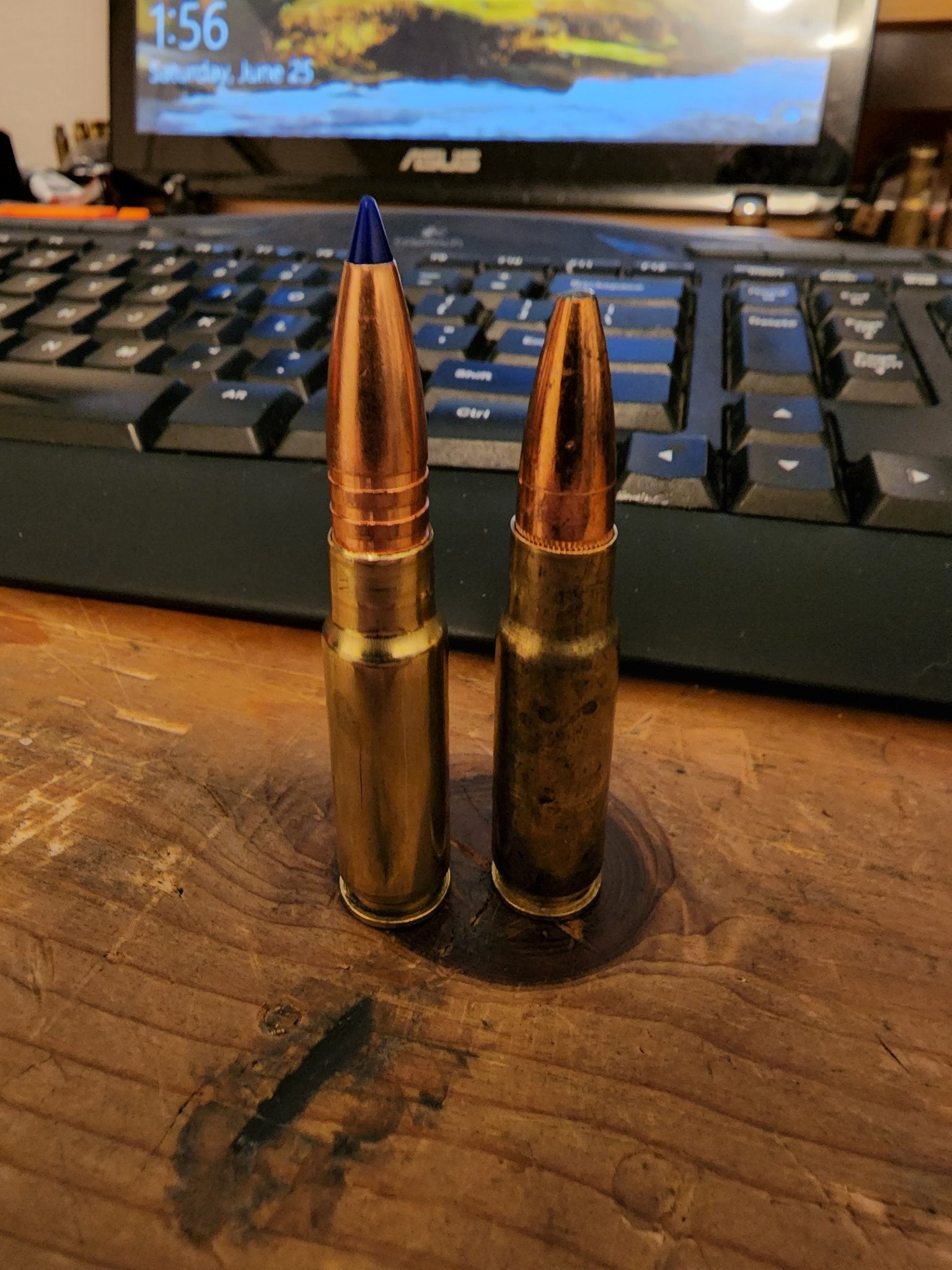

Continuing the journey with the Peregrin .338 subsonic projectiles. Currently working ATF Form6 with BATFE and a Customs Broker. Still sorting out how much shipping, customs, and customs broker fees total....

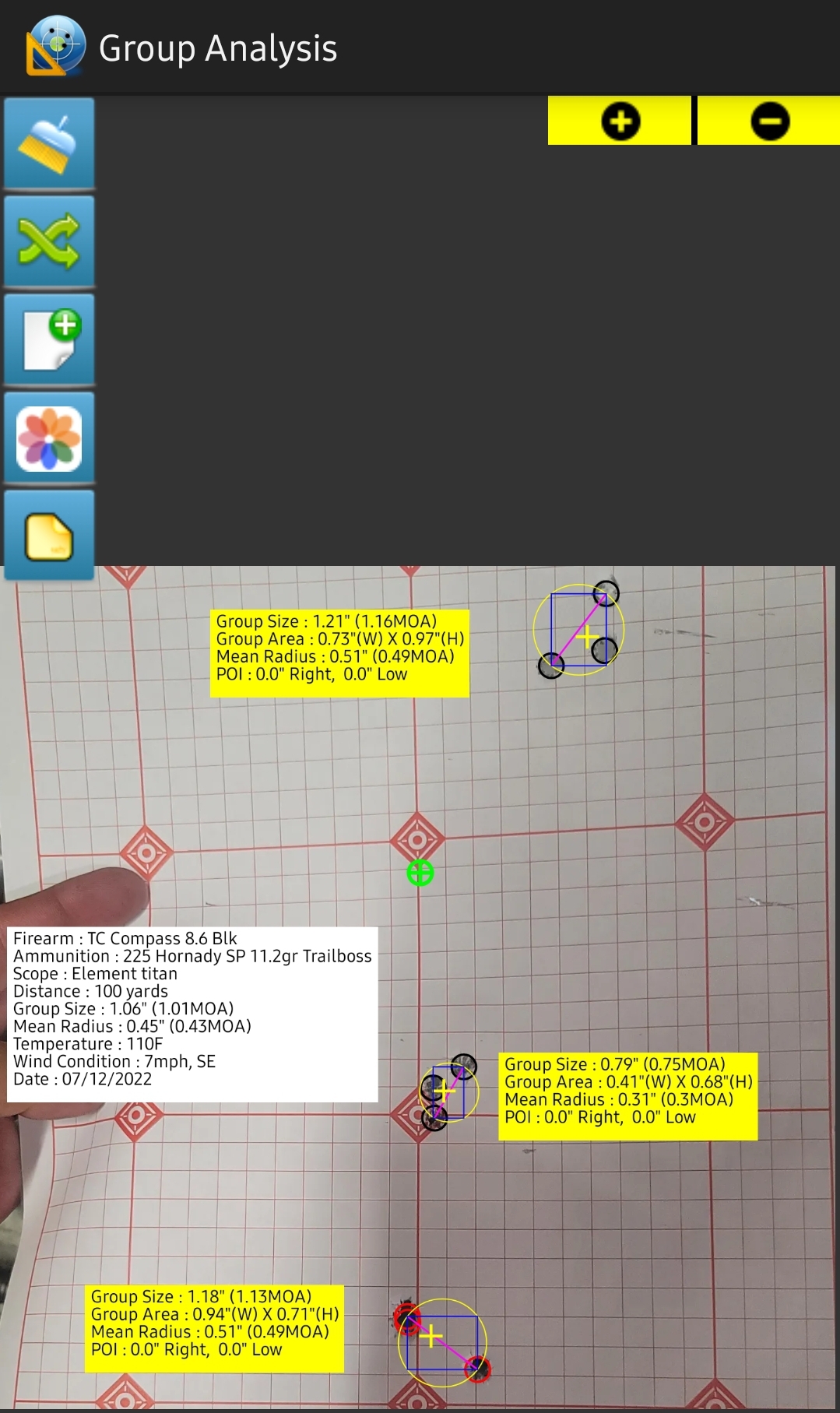

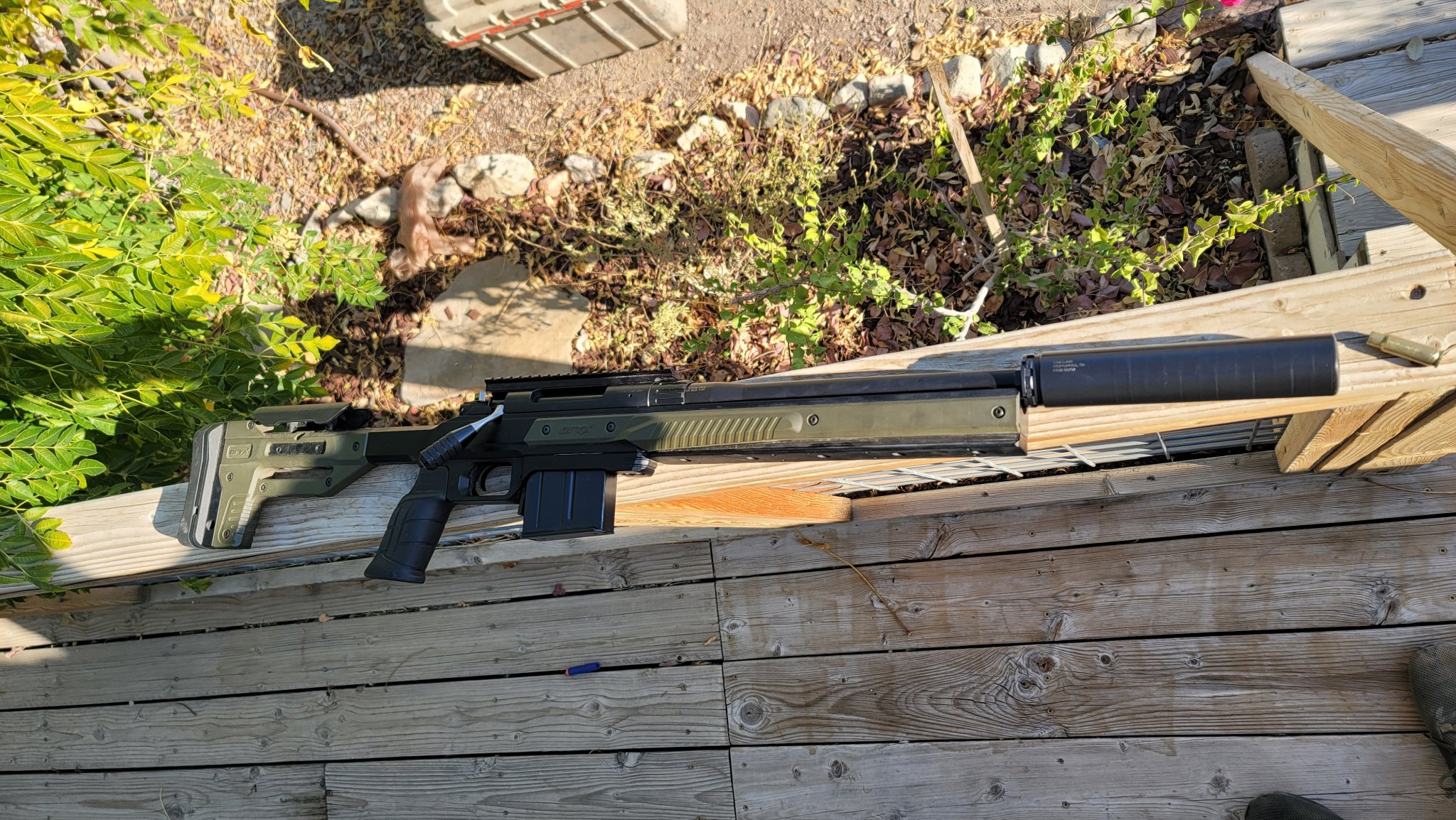

Just diving into this cartridge but in a bolt gun for some ultra sneaky shooter. AP2020 has been puting out some awesome content on his YT channel and will be doing the same for these bolt guns soon.
Initial load testing was with a Hornady 225gr SP. The load used was from the published load data from Faxon of 35.8gr of AA1680.... A bit TOO SPICY! Caused my end cap to shrapnel from the bullet comming apart. No baffle damage. Case was way to over pressured. 6.5 Creedmoor brass is the way to go so far. I've tried 308 brass and had zero luck. Used Lee Precision pace setter die and it plunk test perfect.
Rifle 1 specs:
TC Compass SBR
Faxon OEM chambered barrel cut to 13" and threaded 5/8x24 modified breech end
Deadair Primal Can
Rifle 2 specs:
Kauger Arms CRS action
Faxon OEM chambered barrel 16" (for now)
11.5gr of Trailboss yields 1020 FPS
11gr of AA1680 pushes right at 1,000
Both with good accuracy so far at 100 yards

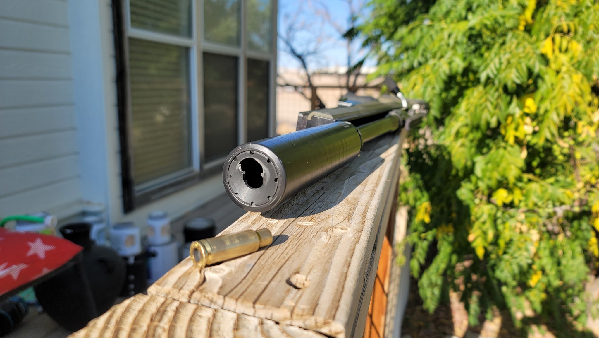

I really like that TC. Sorry to hear about the can, but nice to know the load data is a bit much for non-monos.

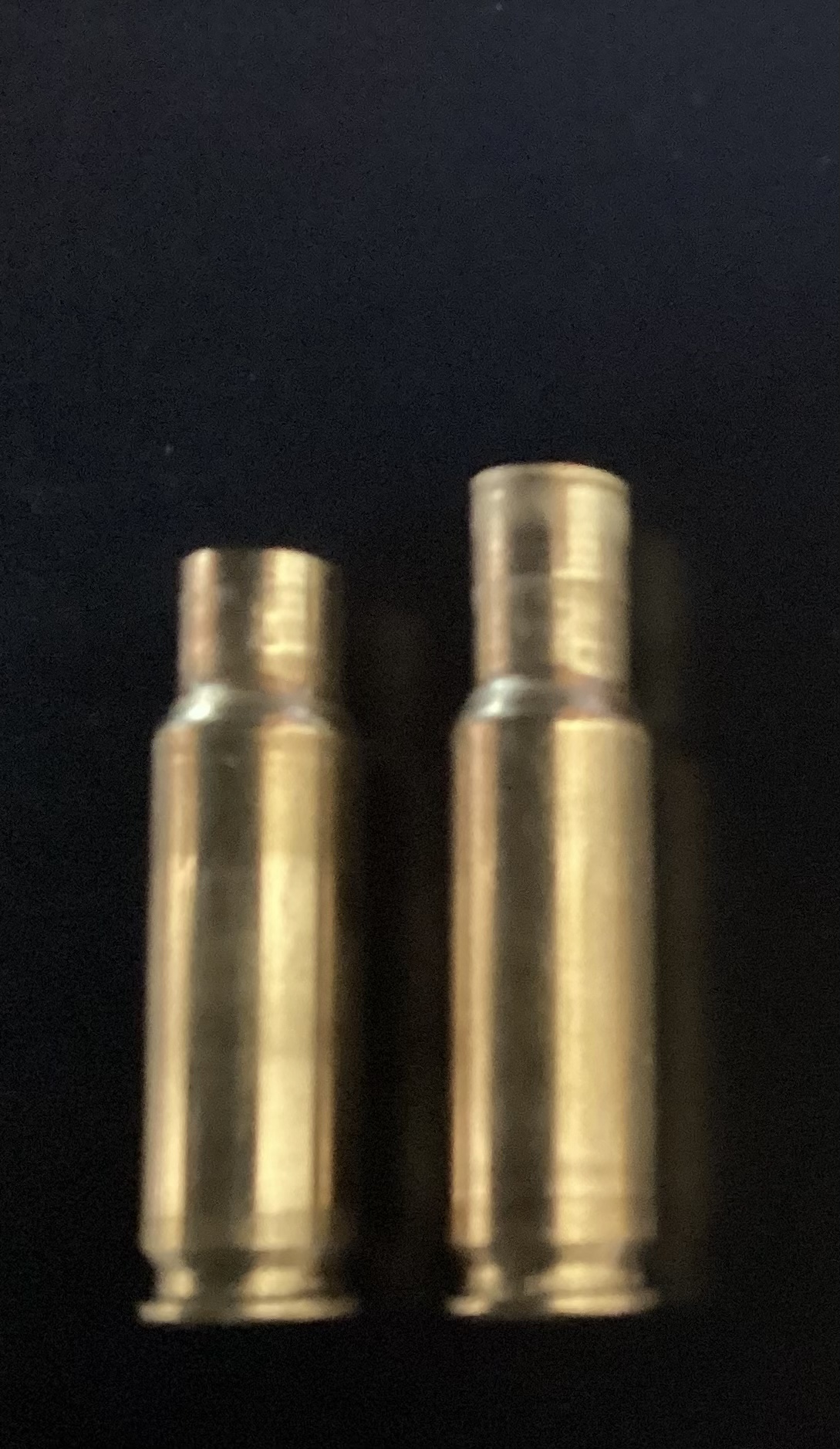

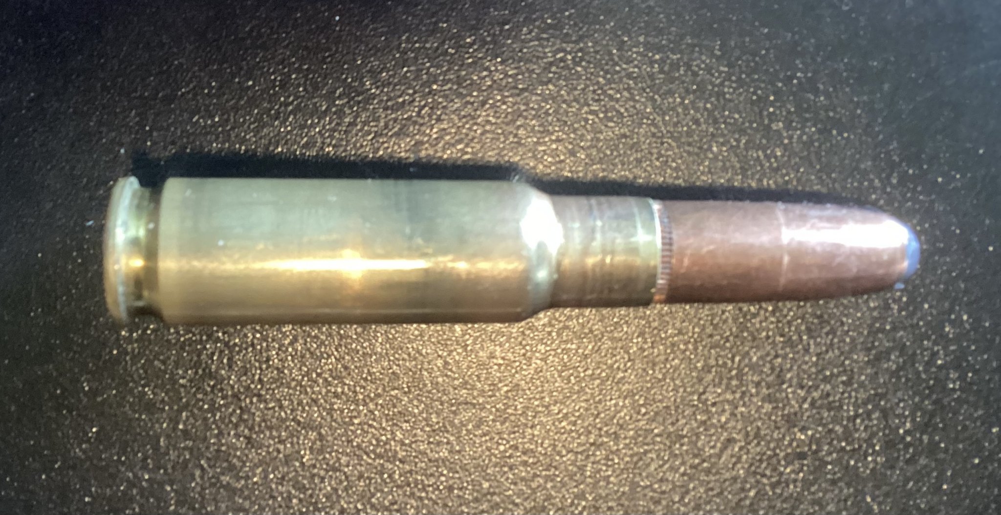

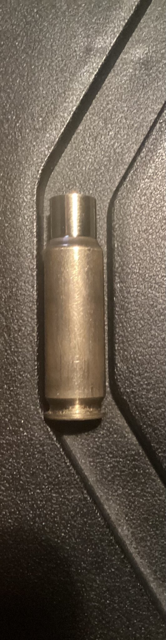

Made up another 38 cases, but ran across a snag. Because of the thickness of the case necks, they really need be neckturned and it looks like my .336 expander mandrel is bit undersized. I could neck them down to .30 and make a skim cut and the expand back to .338 and remove the rest, but thats more trouble than I want to deal with at the moment.
Nevertheless, while not a sexy as. 300SMK here’s a canelured 250 grain SP that fits great as the base is just above the neck/shoulder junction,OAL is 2.575.The neck diameter is a bit tight with .3654 at the center of the neck though.

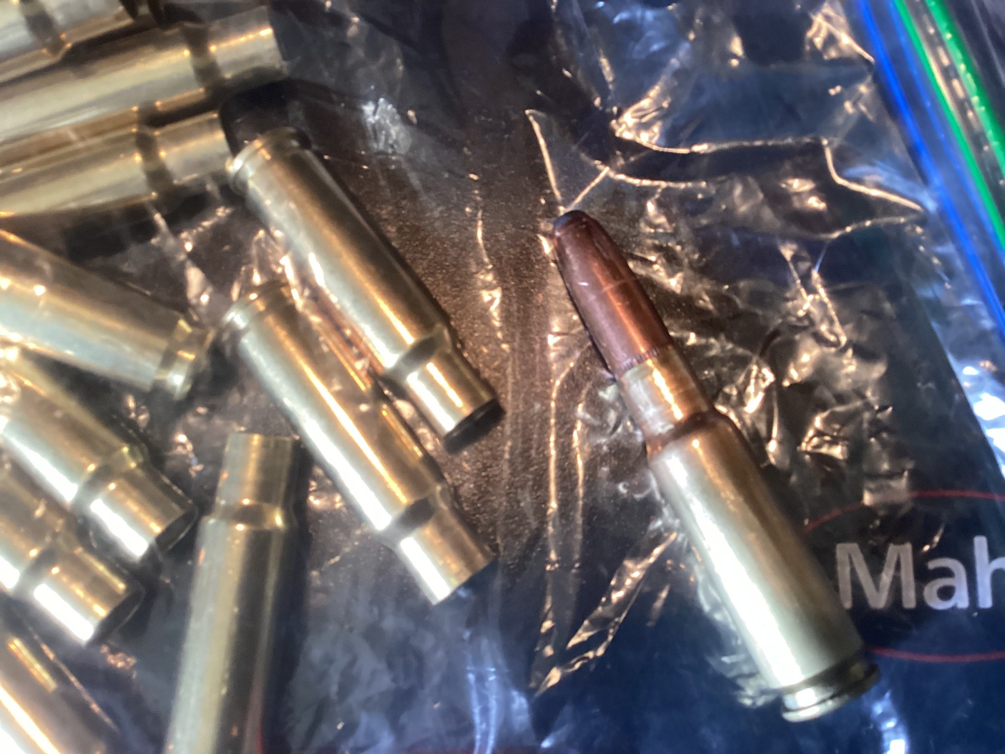

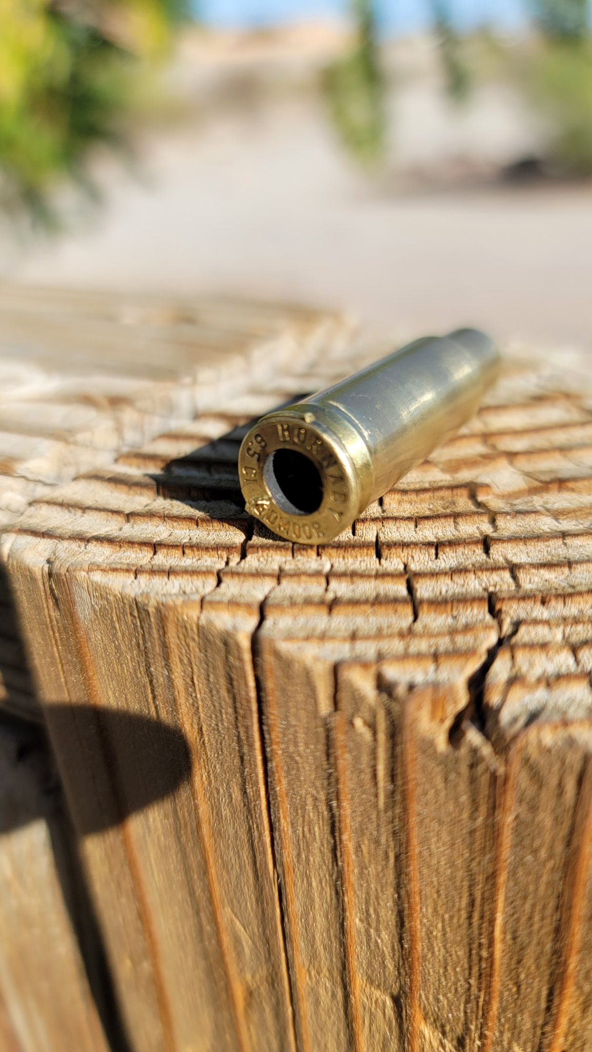

Thanks, I maybe to throw some H brass into the testing mix. So here’s a Fed 6CM donor, neck turned , skimmed for 100 % clean up and trimmed to 1.687.
