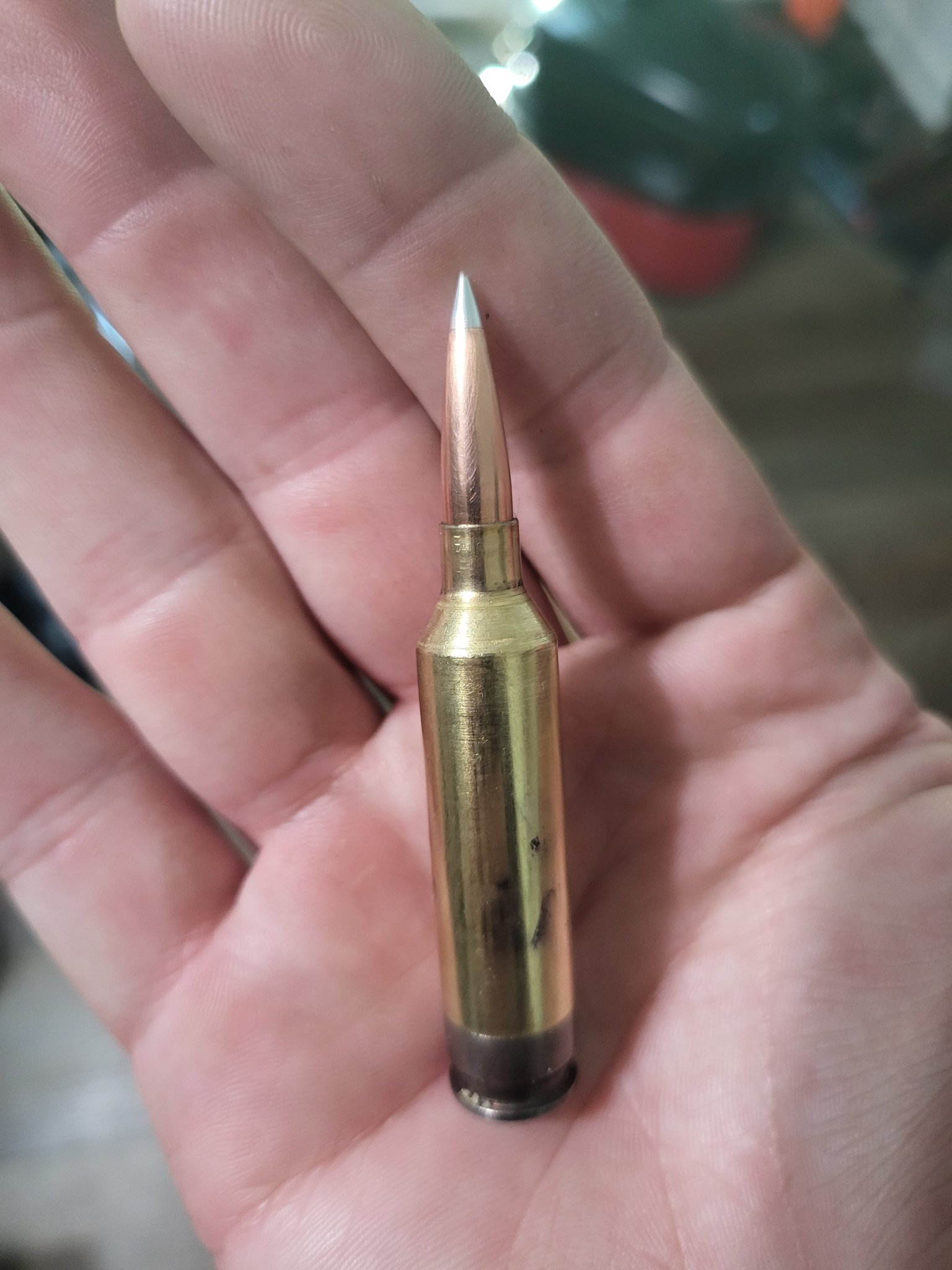

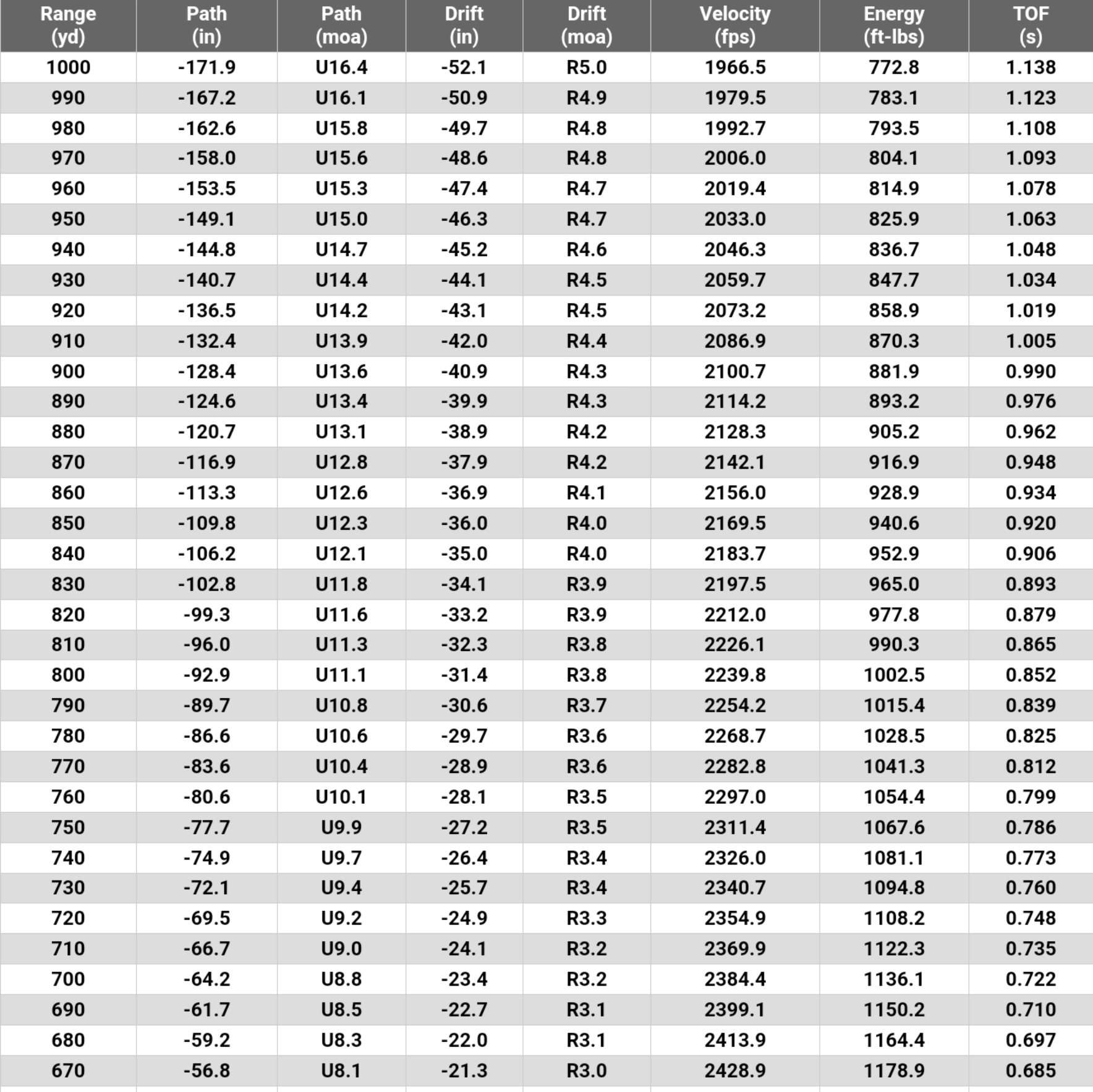

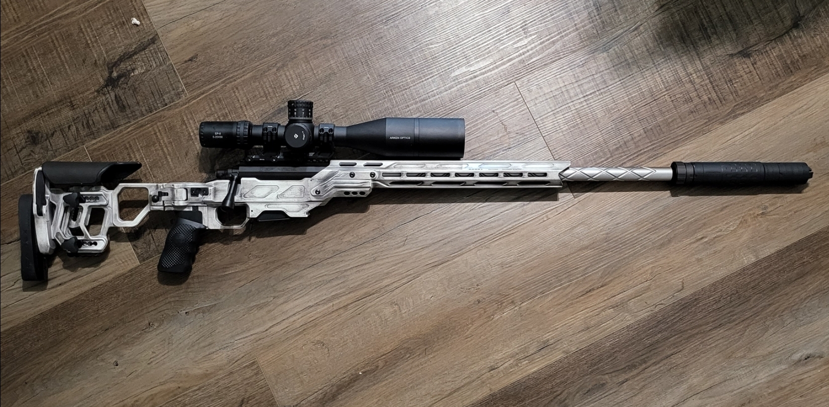

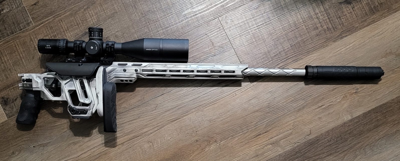

Hey Everyone,
As promised I finished building my 22 Vengeance (22VG for short) off the sig 277 Fury.
She is everything I wanted and prayed for. 😆

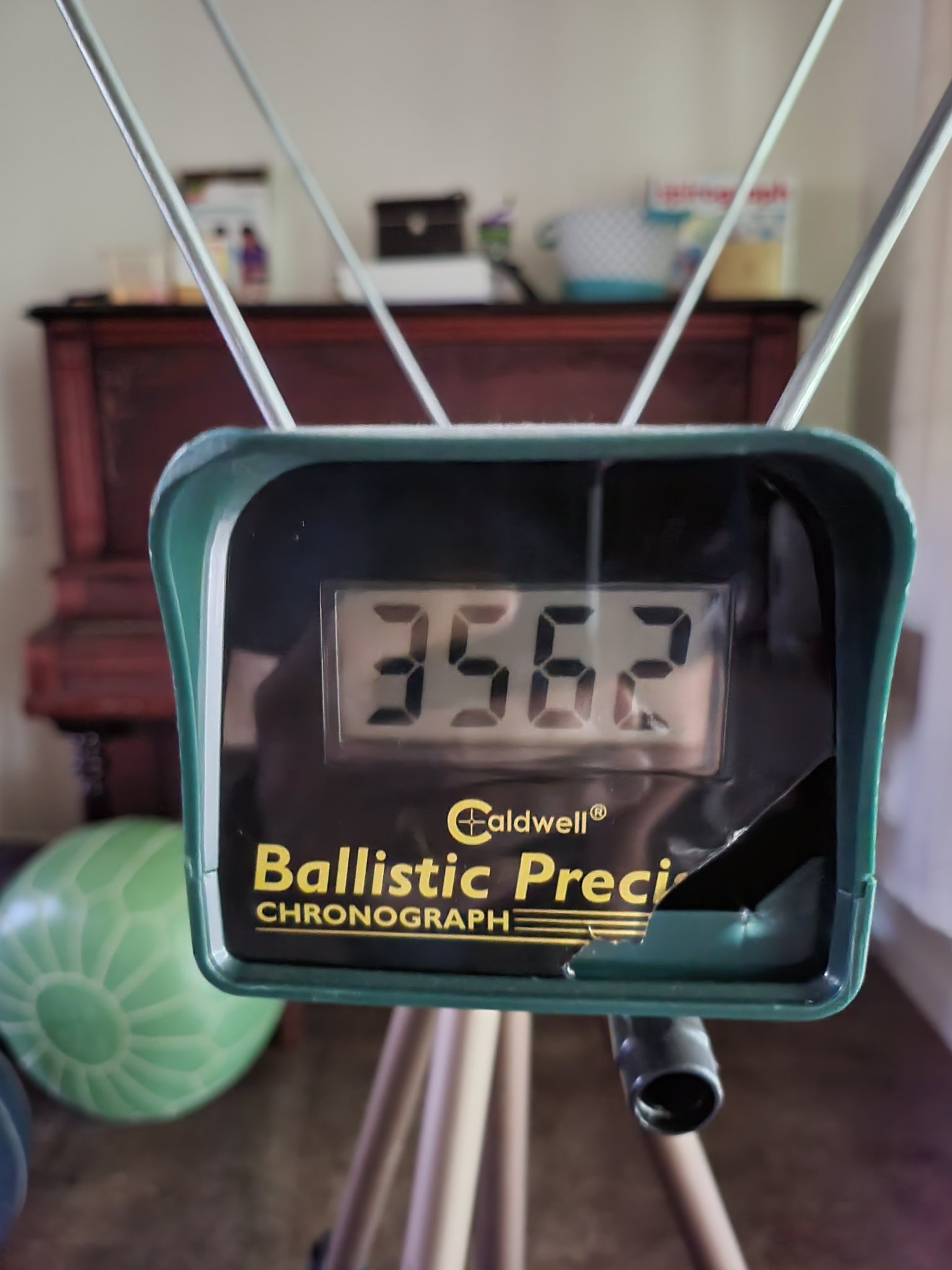

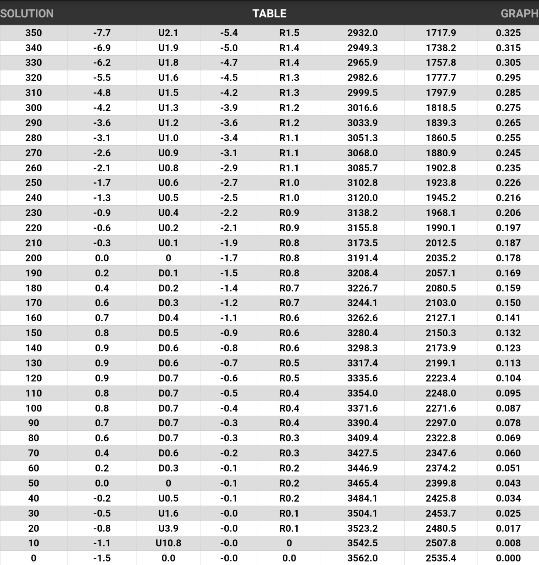

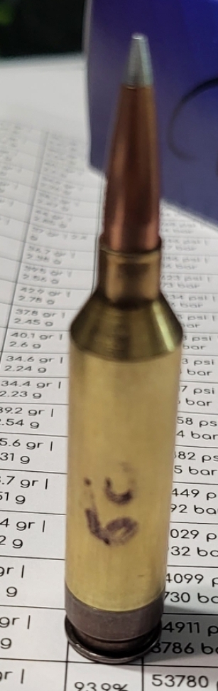

I worked up a backyard load of 50 grains of VV N165 with 90 grain Hornady A-tips.
They are cruising out the muzzle at a mind-boggling 3550+fps.
Thats over 2500 ft lbs that I was aiming this build for. Worlds first 2500 ft lb 22 rifle. Ridiculously unnecessary level of speed.

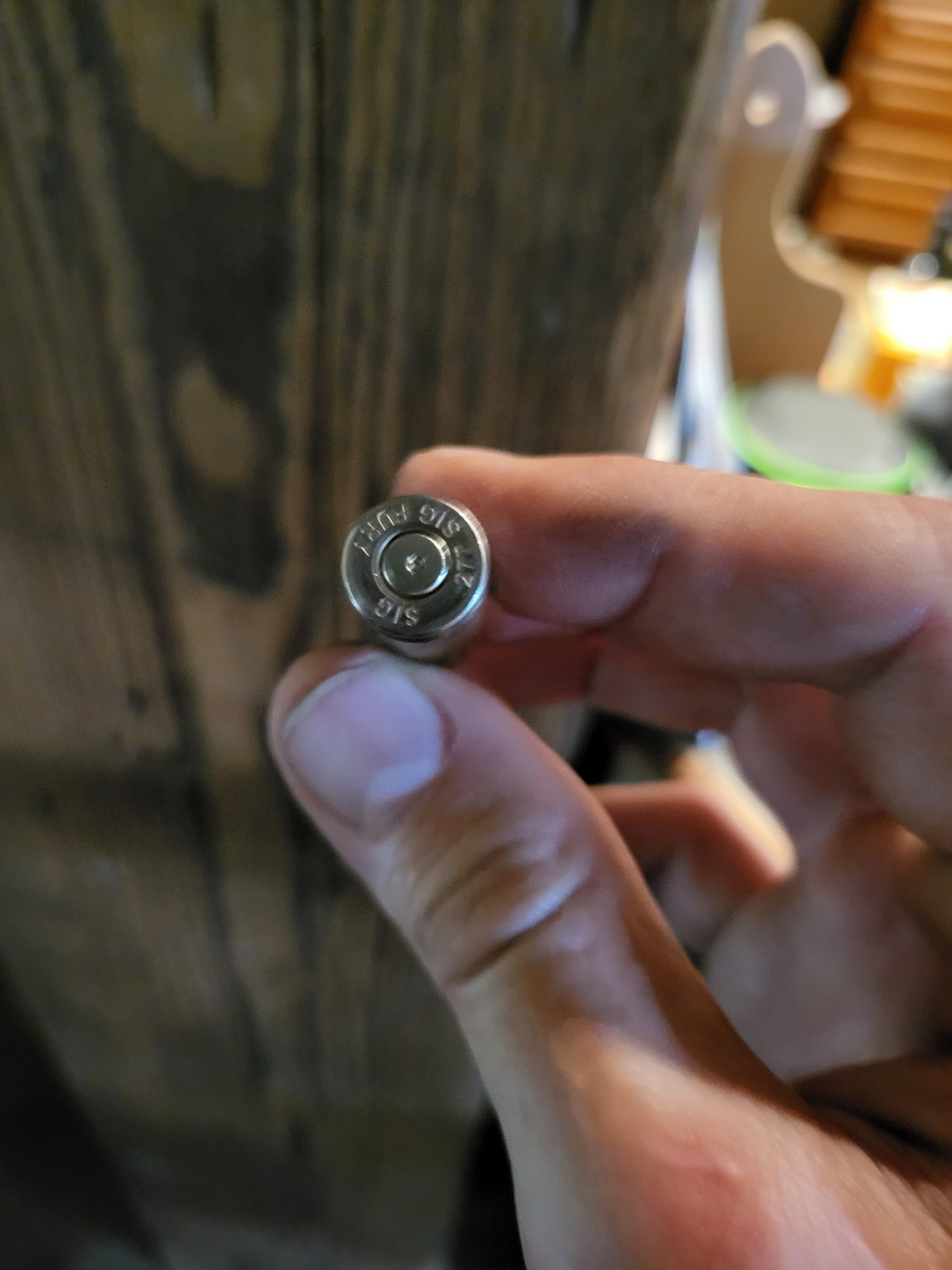

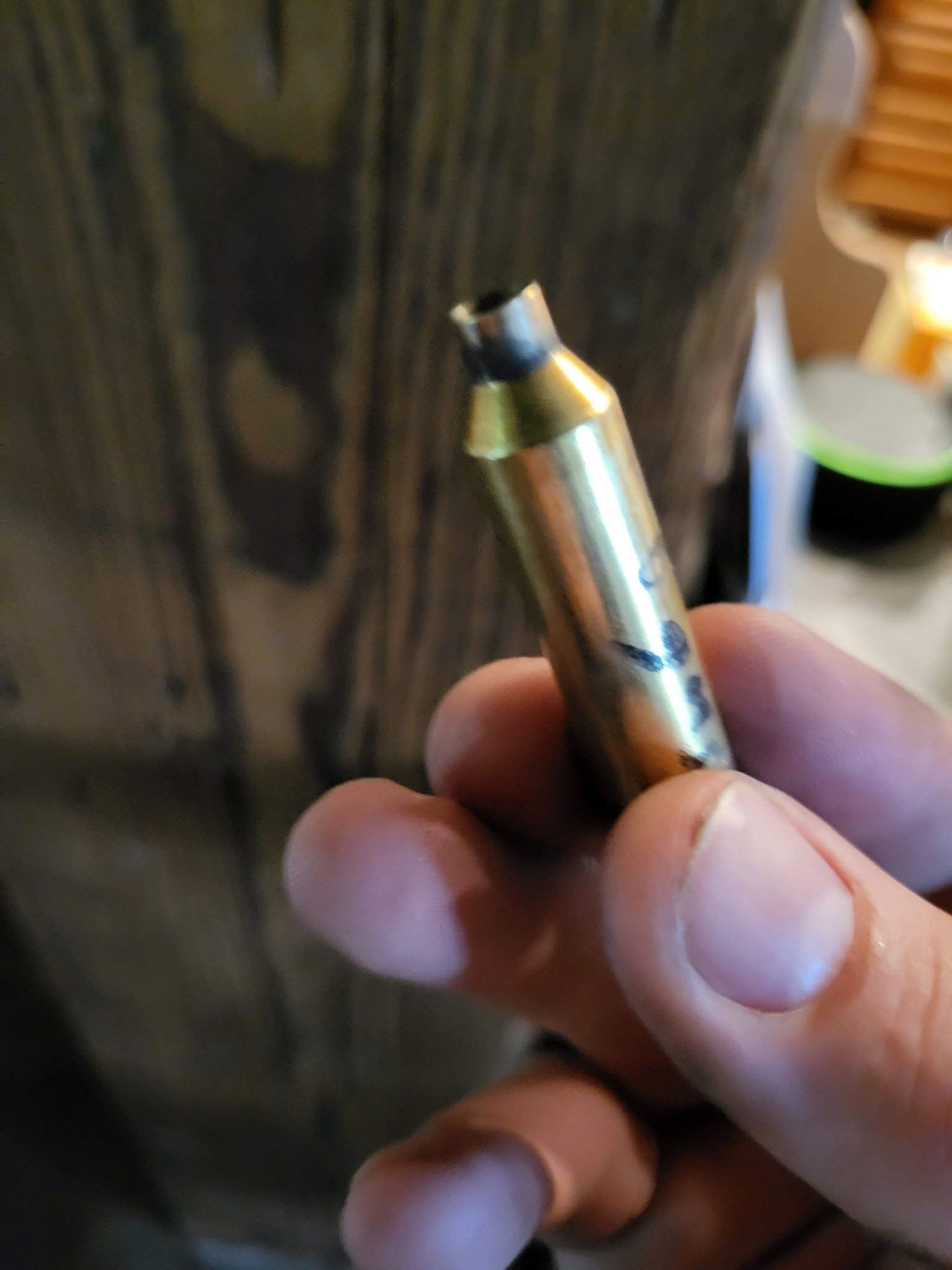

No sticky bolt, no pressure signs, no loss of primer seat...no problems at all yet. Multiple firings and reloadings on a single case. Cant wait to test on hogs and coyotes this weekend for Father's day. Also will head to 600 yard range and test ballistic performance and post again.

It pretty much is with the only addition being a alloy base that doesnt lose primer fit even at 80ksi.
