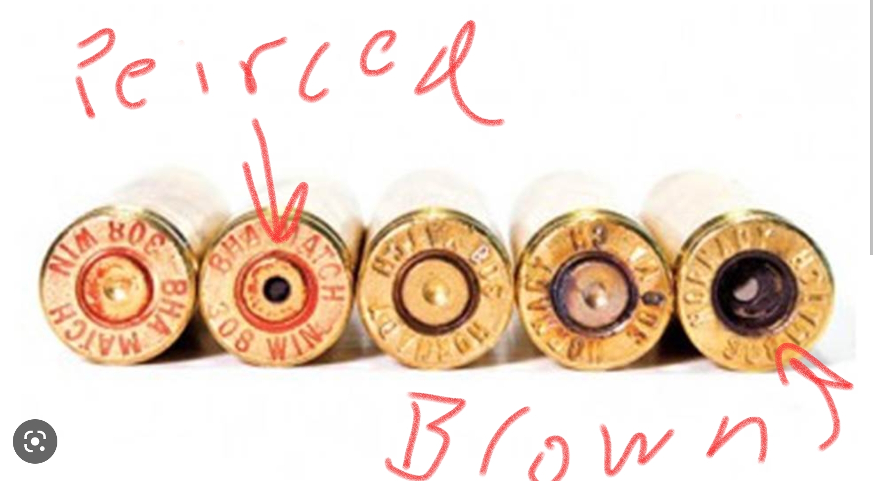

For the ammunition pressure test barrels they also had to come up with a pressure sensor that can operate at even higher pressure levels. I think the standard sensors are rated for 87k.
Here is another concern... the cases are a hybrid. Steel case head and brass body. Under pressure these two materials will expand and relax differently.
Will this have an effect on the chamber and wear?

...people just dont understand the pressure they are quoting and how not only the case materials deform and become plastic but also the surrounding materials
its not as easy as adding a few grains and hoping not to pierce a primer

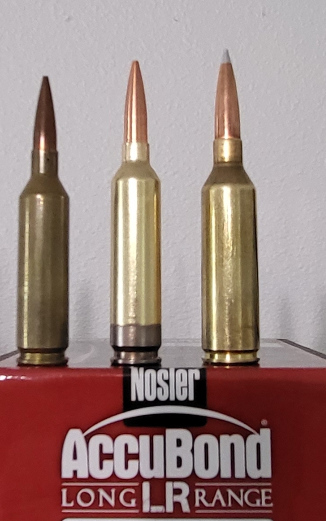

Sig is offering a high pressure hunting load for 277 Fury, with the bi-metal case. It is not the exact military load because, presumably, the military load will use a steel tipped bullet similar to the M855A1/M80A1. The Army owns the patent and refuses to allow their sale to civilians. But it is still a high pressure round nonetheless. Civilians are seeing 2900 fps out of a 13” barrel.
The cartridges and chambers have been extensively tested during the years of development and trials for the NGSW/XM5/M7.
Sig, with their barrel, is seeing 12k round lifespan for the barrels. More than the program’s 5k requirement. If you’re manufacturing a stainless 277 fury/6.8x51 barrel for precision, then yes I’m sure barrel life will be short.

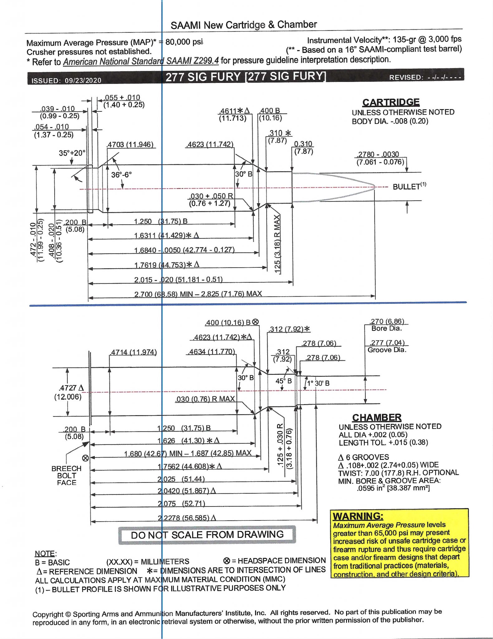

What would it take for you to be comfortable selling a barrel for an 80K PSI cartridge?
a bigger tenon diameter
stronger material action
stronger material bolt head
stronger material action lugs / if separate from action
large gas escape ports (2 is preferable)
"fat ass" bolt so if there is blow by you have a debris shield for your eyes
pressure is not linear, it spikes exponentially when it gets to a certain point when using smokeless powder
80k running compared to 65k running pressure is a big difference in proof and catastrophic stresses on a action
small tenon barrel start flexing and the case expands more than normal, now you have all sorts of stuff moving around
comes time to extract and the case is getting squeezed back down to original chamber dims, and extraction gets more difficult
...so you pull it out harder with a stronger extractor and bolt handle..now your worried about ripping up the chamber
add some moisture to the chamber and the bolt thrust goes up and adds even more sheer force to the lugs..im not worried about the action or barrel splitting, i worry about the lugs letting go and you eating a bolt body in the eye.
bad heat treats, and stresses can occur and not get caught by QC checks, so if shooting 80-85k the action better be over built to handle it
in a previous life the only people who were going to get the higher pressure ammunition were ones who had a proper OEM rifle with OEM barrels on file of that caliber etc
its only a matter of time until some basement gunsmith chambers a barrel for his rusty model 70 from 1950 for the new ammo, and has a bad day
im sure smarter people will chime in but the barrel will do it fine, its the rest of the system that needs to be designed properly

So it's going to be a full platform change to get us to 80K; which means not any time soon. Thanks for taking the time to lay it out.

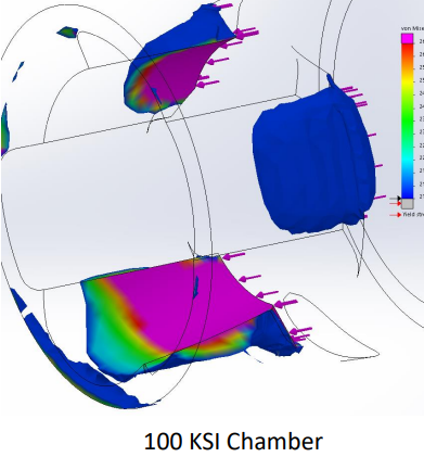

I would hope so
the testing i paid for with the other projects showed that the bolt lugs of made of 4340 were not capable of;
85k running (that was out target) plus 25% proof testing, with a 50% safety margin on top
there was bolt lug set back at proof loads and overpressure points
4340 is a "better" material than 416SS (old rem 700 actions) and 4140 (almost every action body on the market)
companies can market what they want but NTS testing (NASA and military use them) say otherwise
i may be overly cautious but this is a hobby and selling a product to a customer needs more discipline, id like to keep all my parts working after a fun day at the range
when people get "clickers" on extraction..thats because the tenon and barrel expanded more than the material / design is capable of and is squeezing the case back to size causing extraction issues..we did that as well..by mistake and needed a redesign
this was one of the 4340 test results:
6.5 creedmoor chamber used for testing
purple and red were above the yield strength (ability to return to original shape) at 100k chamber pressure
thats 80K plus a proof testing of 20-25%..manditory in England (but not in the US for some stupid reason)..bolt lug set back occurs
materials and their properties arent special just because someone says they are

I have blown primers in my 22 creedmoor being stupid with N165 so I think I can. We will see. 48 grains N165 will blow magnum LRP federal or winchester behind an 80 grain berger hybrid. 277 fury has ~15 more thousanths of case capacity as well.
Except you’re not going to blow a primer in the bimetal case.
Why not? 🤔 same primer. Should pierce at same point. It wont "blow" out but it will pop a hole where the firing pin weakened it. You will retain primer pocket retention though I think. I want to stay just under pierced primer territory. I have been using some posted peterson universal receiver data from unsafe 78kpsi-84kpsi 22 creedmoor loads and some pressure and velocity calculations to try and predict the 80-85kpsi range. I think I will end up where crazy people were running their 22 creedmoors. 3600-3700fps with 80 grain vlds...3300 with 90 grainers. I have reasonable expectations 🤔...if anything about this stupid 22 VENGEANCE build can be called reasonable...
Because the case head isn’t going to expand, leading to primer pocket expansion.
So you think it wont peirce due to lack of radial strain due to stiff bimetal primer pocket walls....i didnt think about that....need to boot up my solid works and run a finite element analysis with 100% ridged primer walls...that would leave the primer with just lateral strain...intersting thought. You speaking from experience?
Just so we on same page. This is what i mean by pierced vs blown

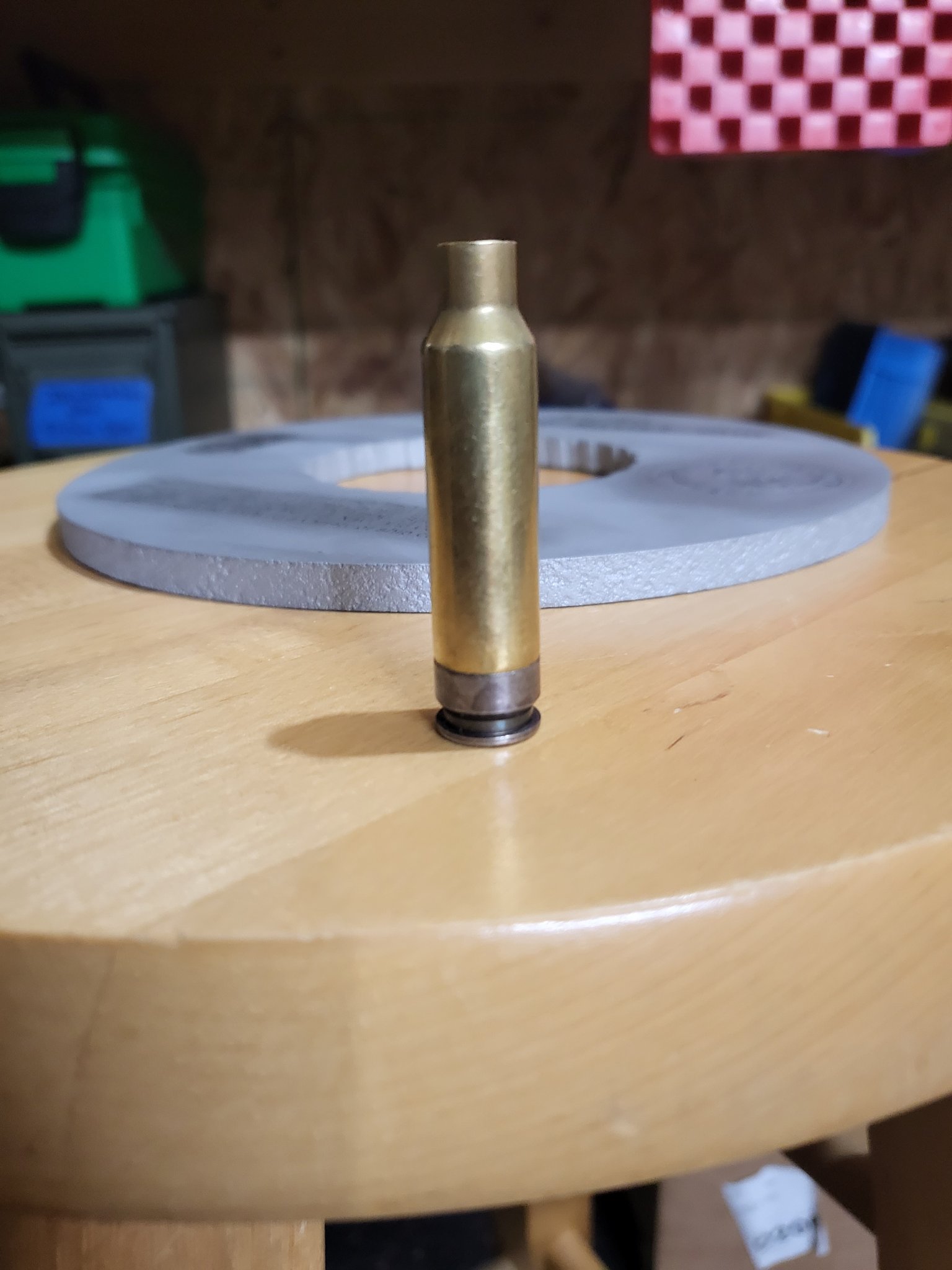

Since I picked up loaded bimetal fury ammo I intend to disect the 100 primers I am getting that sig is putting in them and see if the cup is different and if they pierce where my normal federal and winchester ones do. Its definitely a question I want to answer.

Left to right. 22 Creedmoor, 22 Vengeance, 6 PRC.

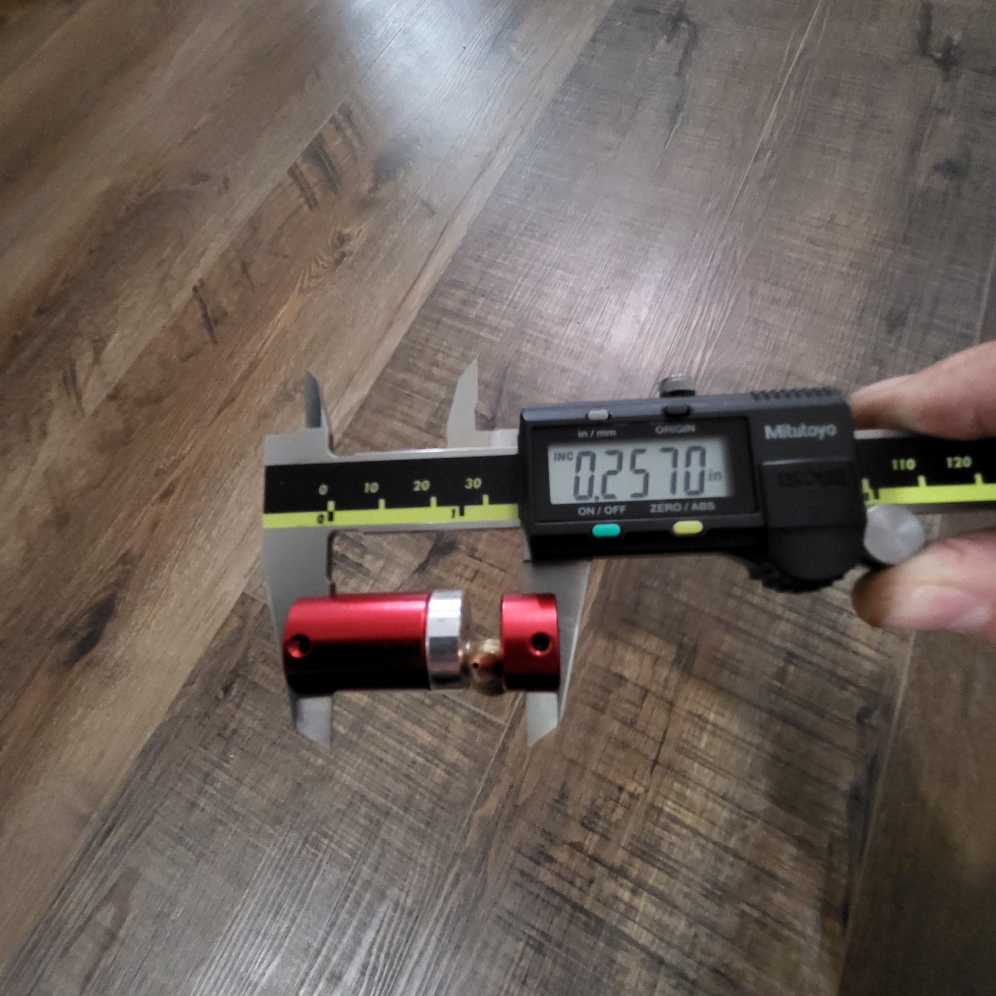

Necked her down in three steps with a .288 -> .271 -> .257 redding bushings. Landed perfectly at .0015 neck tension. 😈
.257 is only 1 thal under neck chamber dimention of .258(highlighted below)...yall think I should turn it? 🤔
It will be a little snug....

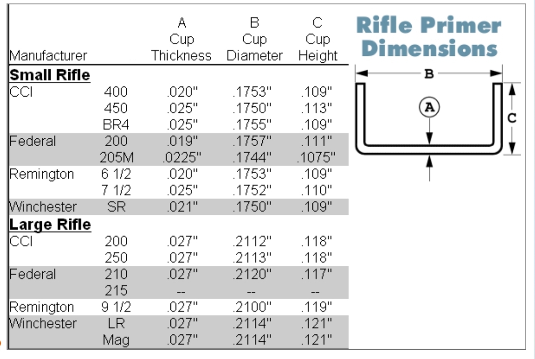

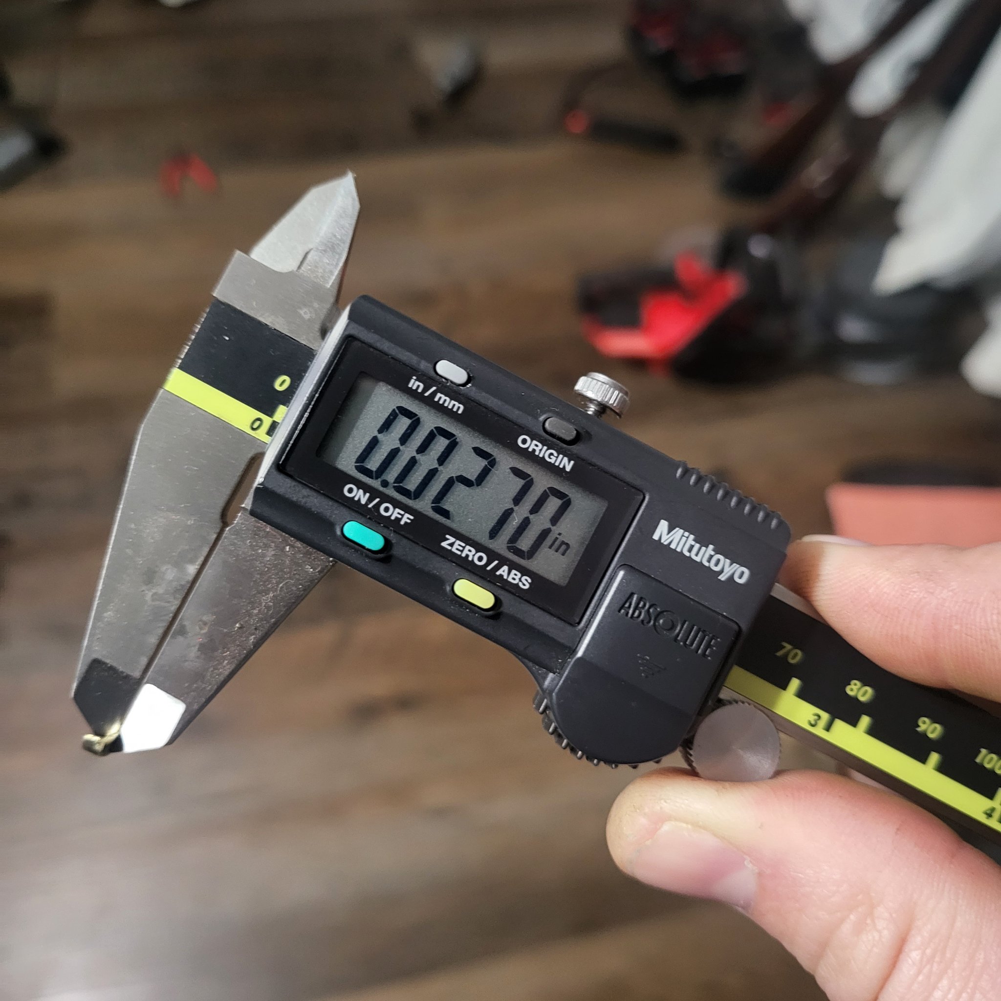

So havent peirced one yet but I took my dremel and calipers to one and it looks like sig used a normal large rifle primer to me in their hybrid 80kpsi case.
.027" cup thickness like all large rifle primers...not ferrous(not magnetic i.e. not steel).
Its not a winchester or federal I believe...i think its cci or sig's own make.
Its very small but I will try to use the pmi xray gun to get its alloy makeup later this week and get a hardness value if I can.
