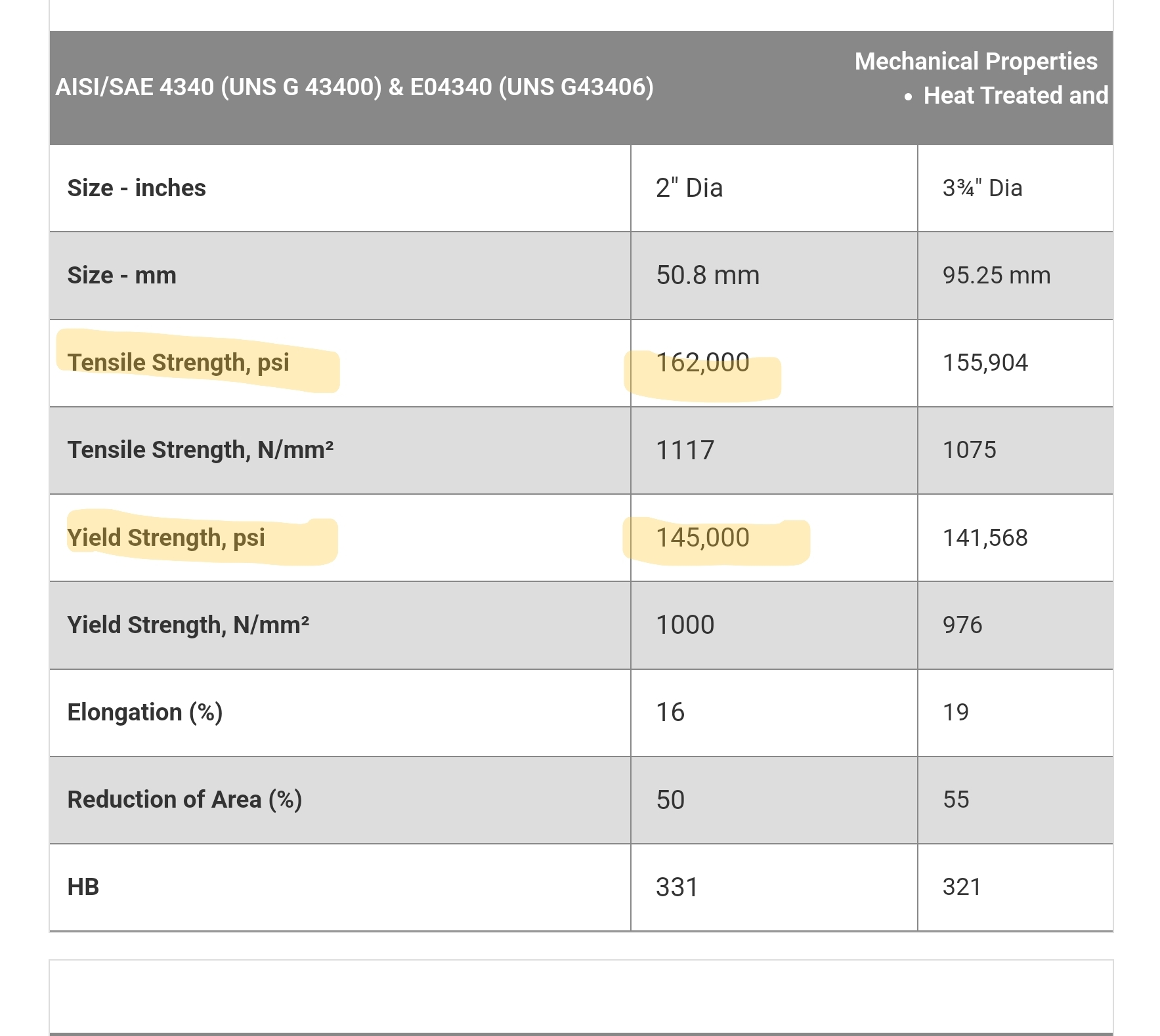

Defiance actions are one peice bolts made from wire edm cut prehardend 4340. 4340 has a Ut of upwards of 160ksi.
They claim their lugs are rated for 120kpsi.
yield strength is much more important that ultimate tensile when looking at bolt and action body lugs
once it passes yield strength head space can change causing a domino effect in subsequent over pressure situations
most companies use 4140 for the action body and 4340 for the bolt as 4340 is more expensive and 4140 is good enough for the task...rifles are a combination of materials 99% of the time

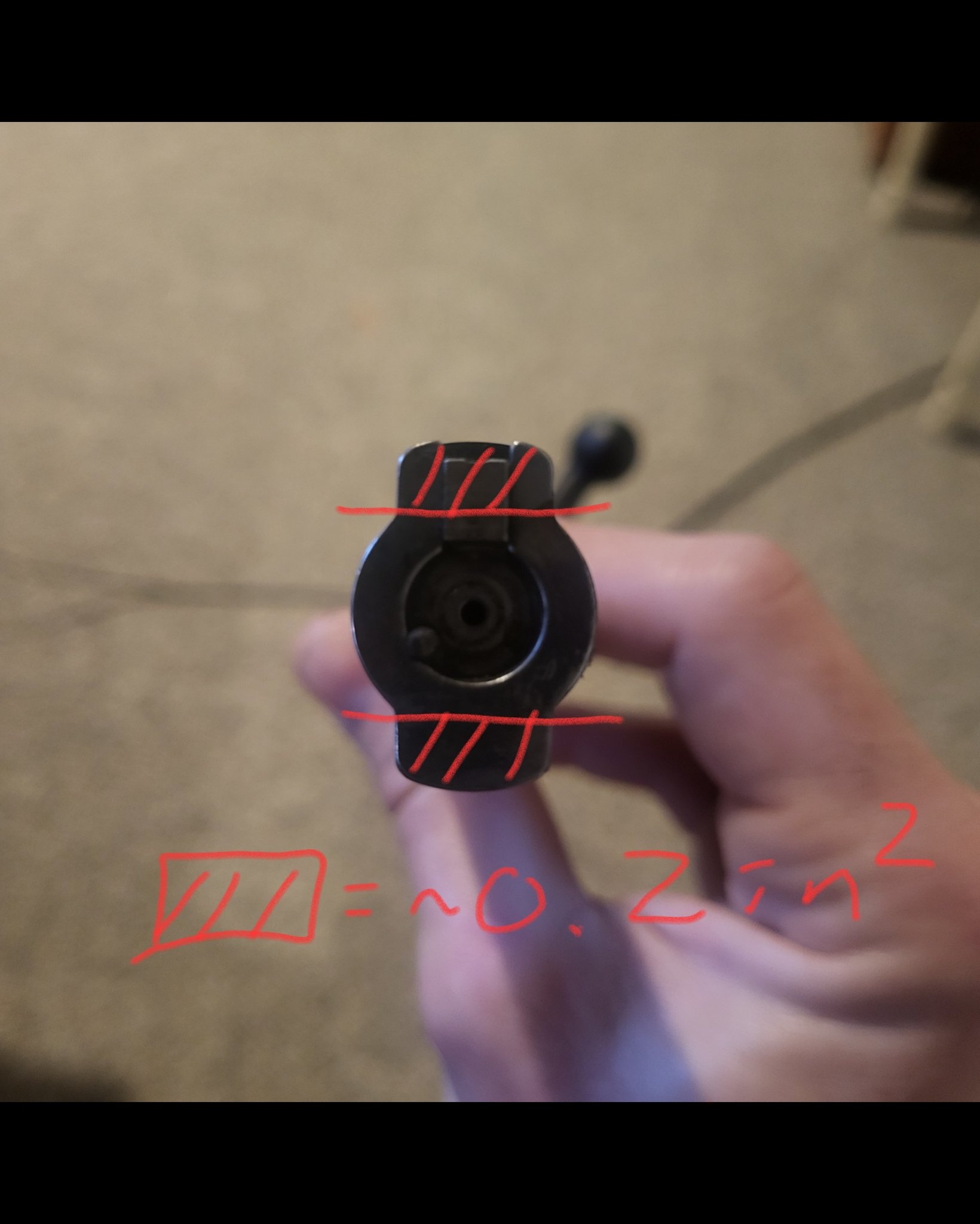

To compare apples to apples we actually need to think about this not in terms of material strength but in terms of force.
Standard bolt lug surface area for both lugs in a R700 style two lugs action is about 0.2in^2
A 308 style cartridge (6 creed, 277 fury etc) base surface area is about 0.169in^2
If we choose a material like 416SS which is weaker than 4340 and has varying material properties based on whether or not it has been tempered/hardened, then we can use the weakest link methodology as the action will be made from the cheaper material than the bolt and give first resulting in lug imprint and sticking.
416SS can have a yield strength from 75kpsi to 138kpsi depending on heat treatment. Based on what defiance says about the bolts/action being rated to 120kpsi I would say that the 416SS is likely tempered to 480DegC-540degC after quench which would put it at 110kpsi-126kpsi to give 10-20% factor of safety.
First lest assume the bottom for hardened 416SS at 75,000psi from being tempered to 700degC. The force that translates to being able to handle with 0.2in^2 lug surface area is around 15,000 lbs of force.
Taking the base surface area for 308 cartridges and applying our round pressure we get 0.169in^2 * 80,000psi = 13520 lbs of force.
Thats just over a 10% factor of safety.
Now assuming the range I think Defiance is hardening to for balancing machinability and yield strength we get
110,000psi*0.2in^2 & 126,000psi*0.2in^2 which is 22,000lbs and 25,200lbs
Taking the 13520lbs of force from our cartridge base into our bolt face from above again that would result in 62% to 86% factor of safety.
Just spit balling some basic math and estimating. Please let me know if Im being retarded somewhere.

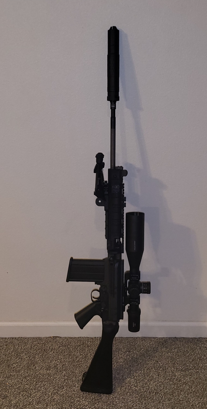

My FAL SA58

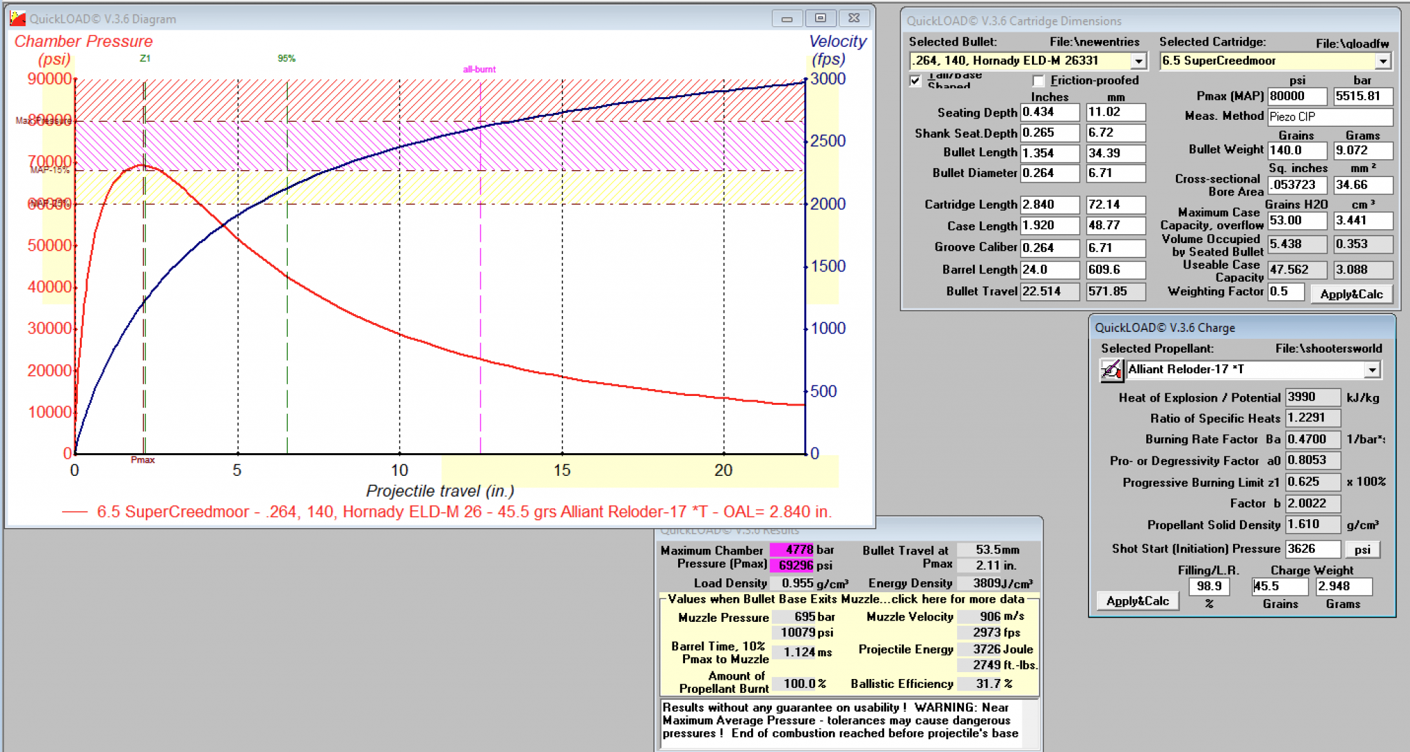

I'll post a load once I get a chance to test for safety (which should be today) in my ruger precision. aiming for faster velocities on my 140gr ELD-M loads and personally made brass match solids
actually, here's the load data:
Cartridge: 6.5 "super creedmoor"; Cartridge Length 2.830in; PMax 80,000psi; PMax-15% 68,000 PSI
Case: Resized and trimmed sig .277 fury bimetal case; Case length 1.920in; Case capacity H2O 53gr
Primer: CCI large rifle Benchrest, ram primer seated
Projectile: Hornady 140gr ELD-M (PN 26331); seating depth 0.444in; bullet length 1.354in
Powder: Alliant Reloder-17; 45.5gr; 99.2% case fill
Expected Performance: Preal 68,015psi; MV@24in Barrel 2981fps
worth noting this isn't a "test the limits" type load, but a realistic usage load with the usual Pmax-15% safety margin applied for environmentals, etc

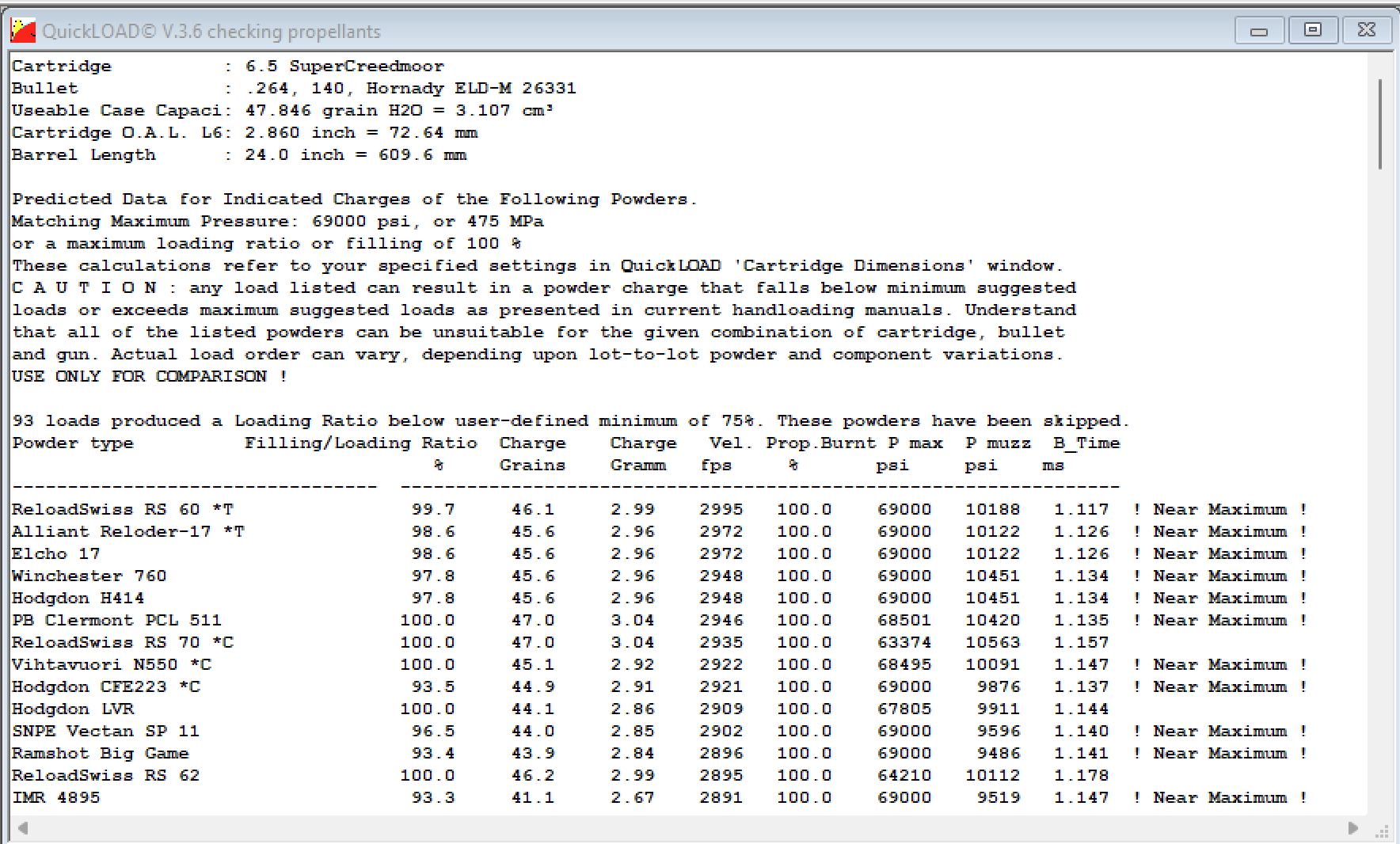

Thanks, yeah some good looking loads possible in the 70k range per GRT.
For what bullets and powders I've got on the shelf:
143 Norma Bondstrike, 22" barrel, 2.92" OAL
CFE-223, 42.8 gr, 92.7% fill, 70271 psi, 2814 fps
IMR 4895, 40.0 gr, 85.5% fill, 68017 psi, 2769 fps
StaBall 6.5, 46.2 gr, 98.9% full, 70293 psi, 2747 fps
129 ABLR, 22" barrel, 2.92" OAL
CFE-223, 44.4 gr, 94.7% fill, 70774 psi, 2967 fps
H4895, 41.7 gr, 88.3% fill, 70589 psi, 2935 fps
8208XBR, 40.7 gr, 92.5% fill, 70830 psi, 2923 fps

I fired it yesterday, my MV was spot on, no pressure signs. yes the powder charge is high for "standard" creedmoor, as it should be, but the pressure doesn't even get anywhere near the PMax of the case.
for the record here, a QL workup that was part of the prep for this:
Also for the record, the possible powder iteration tables sorted by velocity for 140gr loaded to 2.860" COAL:
I take reloading safety very seriously, especially when I am dealing with experimental reloadings of cartridges well outside the norm. I've also reloaded the polymer-cased TV ammo using similar principles, even though that isn't recommended either.
I spent a lot of time with manuals and my chrono making sure my QL results are accurate and not a load of crap with other cartridges before attempting this.
if you want to chase raw velocity, a 123 or 127gr projectile would be better, but I think being able to safely reach MVs that would normally be out of reach with a standard case is an interesting development. I will note that 6.5CM benefited less overall than .308 does from the same approach.
if you want to play really stupid games, 47gr of CFE223 is an 80,000 PSI load, but only gets you ~24fps more on a 24" barrel.
Reactions: Eric_F and 45-90
