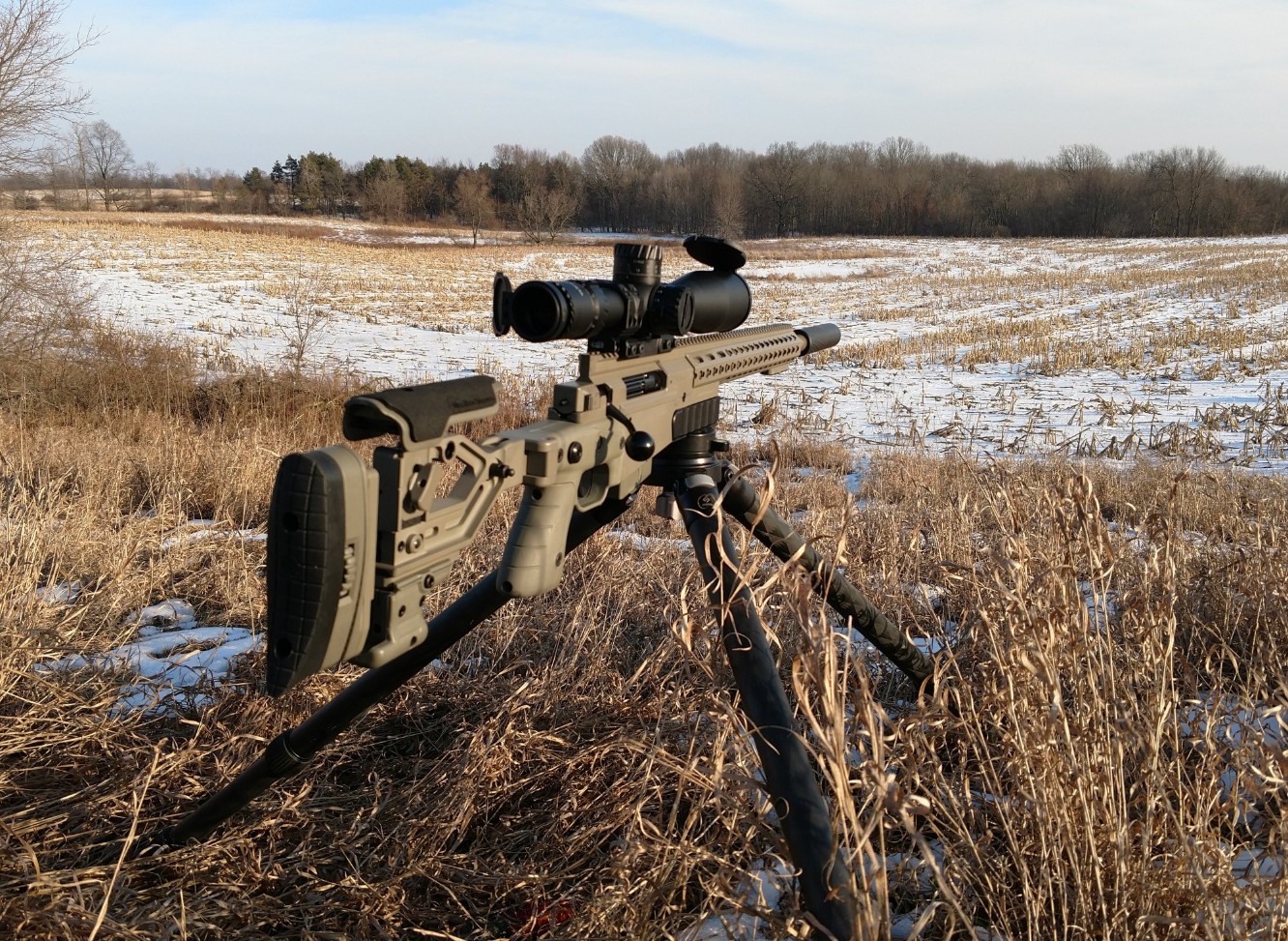

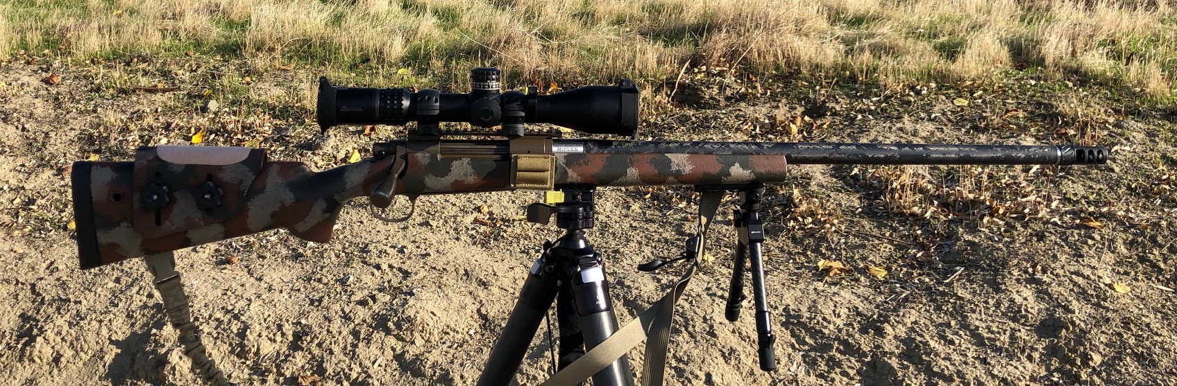

You can do both but the straggles might differ. You can take your current match gun and get a barrel vice and wrench both NREs, and a light weight hunting barrel spinning them off and on. Or get a entire new gun of course. I certainly took both approches. That said, both the match guns I converted and shown below, are the ones I shoot and the new gun, Tikka Superlite magnum, sits in the safe almost always.
I wanted a hunting gun and a field (hiking) match gun, but also one if a friend need a PRS style gun I could spin a heavy barrel on and be set.
Below is a 6.5CM Pig gun it comes in with the light fill, heavier 28oz scope, bipod and sling (most guys don't include that in their weight claims) at just over 11lbs. I can spin a match barrel on in minutes and it's about 16lbs with Atlas. Honestly, the gun hammers with either barrel that @MarcS at Spartan Rifles chambered. For Reference my Tikka superlite magnum with tiny pencil fluted barrel is 5.9lbs but with all the gear tips in over 9lbs for the real world and it is a beast to shoot, just no fun.

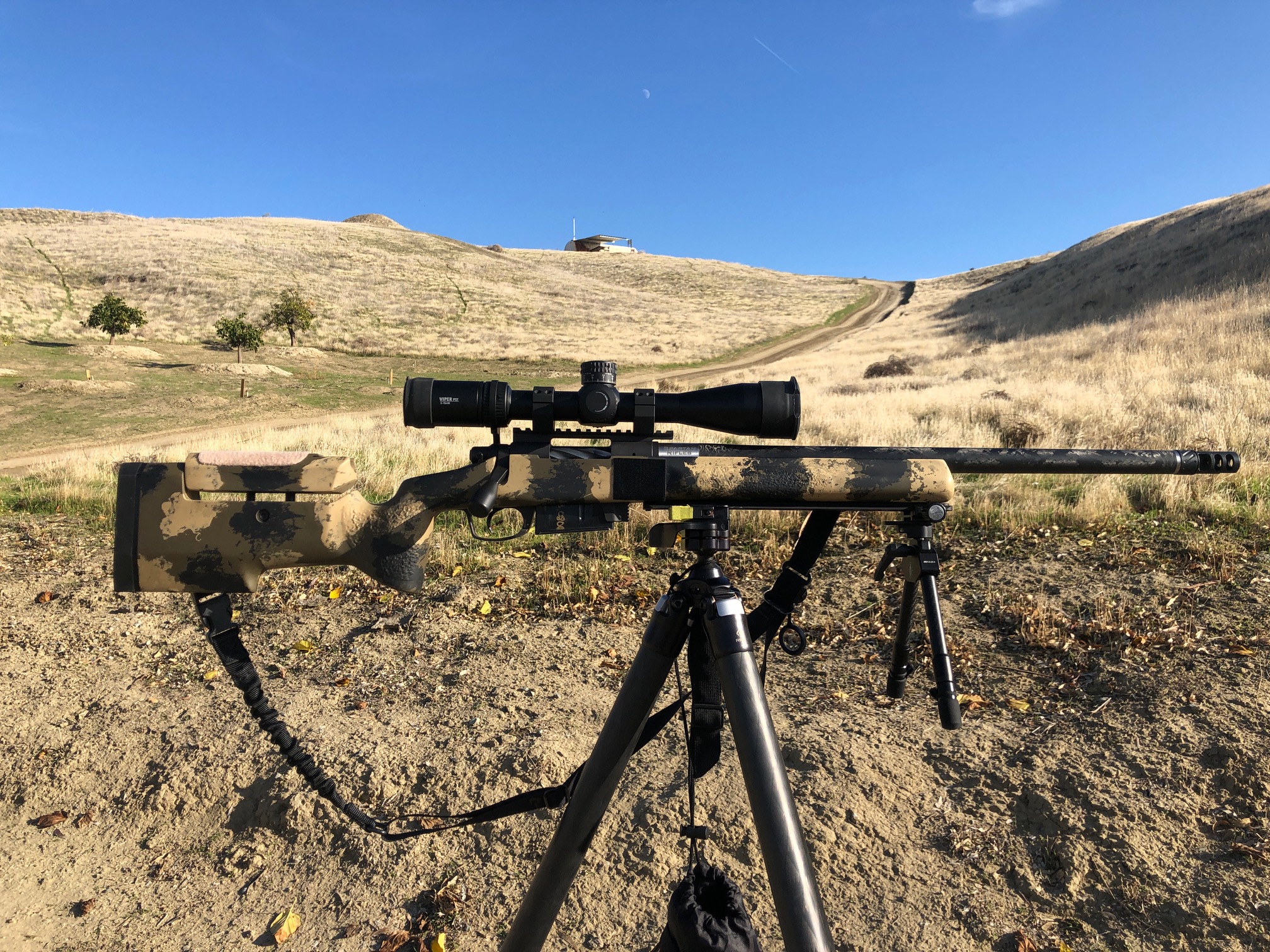

Below is my longer range hunting gun tossing 7mm 168s out about 3050 with this barrel and over 3100 with my longer heavy barrel.. same deal as above @MarcS at Spartan Rifles chambered it. Gun/scope is not set up the same way today and the gun fully kitted is just over 12lbs
So I could have saved almost 1 pound buy getting a cheap traditional hunting scope but that defeats my long range hunting, wind calls and any chance of really using it like the op described. I can also save weight if I did a detected hunter stock without adjustable comb but that just is 100% a deal breaker for me personally.
