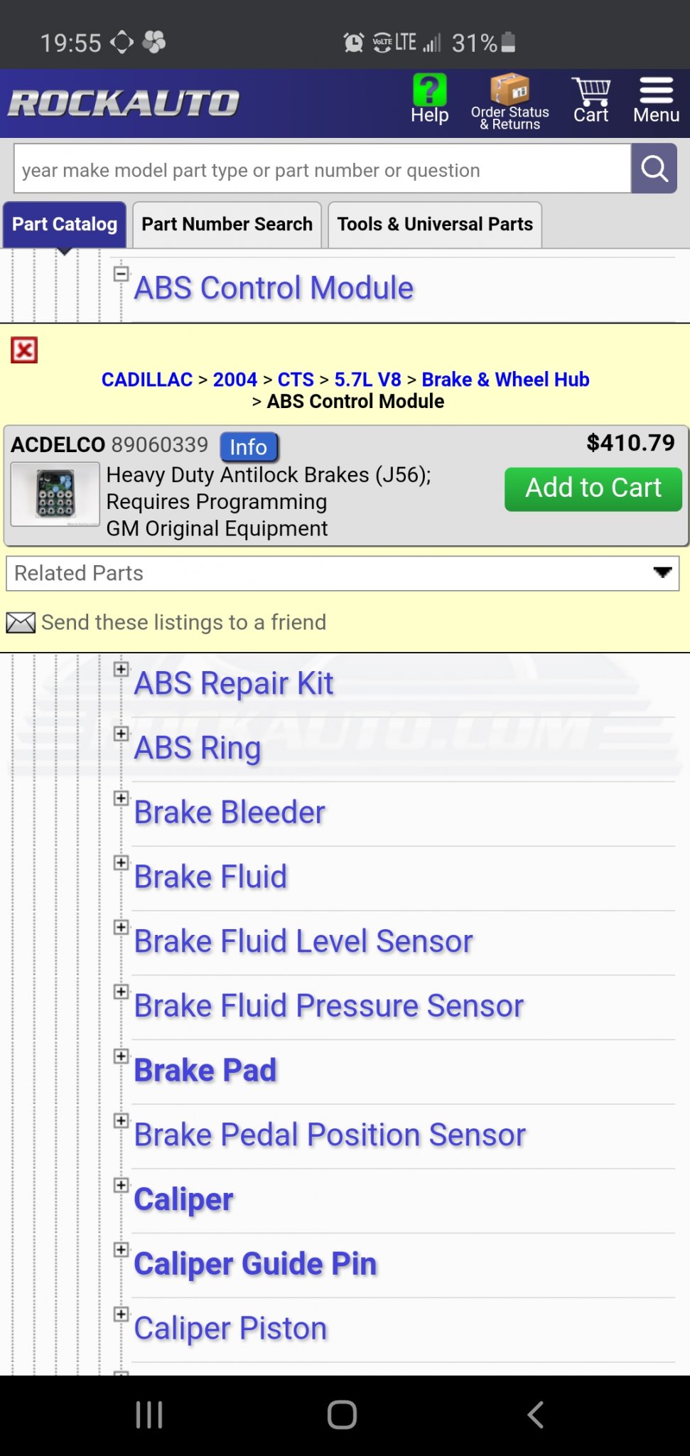

    Have you tried Rockauto.com ?
    Call dealer, give serial number and ask for the part number. Have your RPO codes (3 digit alpha numeric... example: J56 in image) handy. Google search part number, it may have been superseded. The ABS module should be easy enough to find as there are plenty of C5 Corvettes on the road also.
