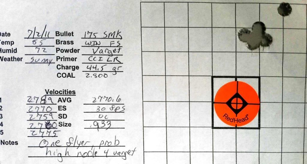

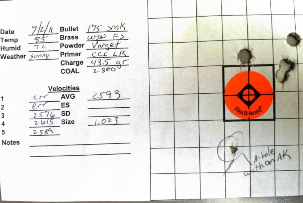

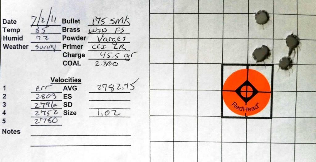

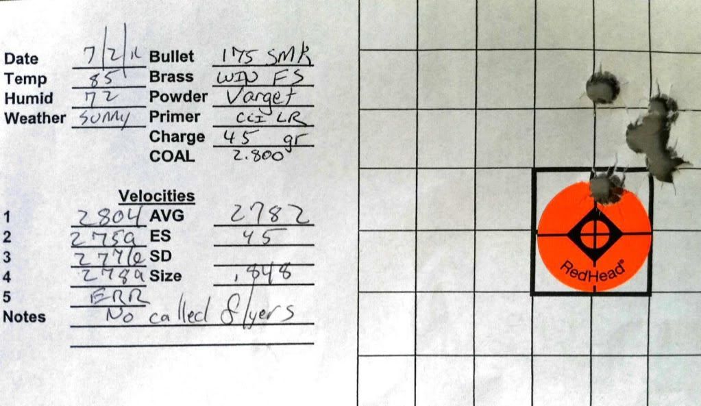

Figured I'd show the baseline Varget workup next to it. There were a few flyers in there, but generally noted and spotted. The graph lines are at exactly 1/2 inch, and all groups were measured with calipers to outside edge with a .307 subtraction to obtain center to center group size. Chrono did mess up a few times, but I verified its accuracy on some FGMM.
Rifle was a Savage 10 FCP-K with just a lightened triggger and Karsten cheekpiece, otherwise 24 inch barrel, 1/10 twist, bone stock!
Here is Varget:
