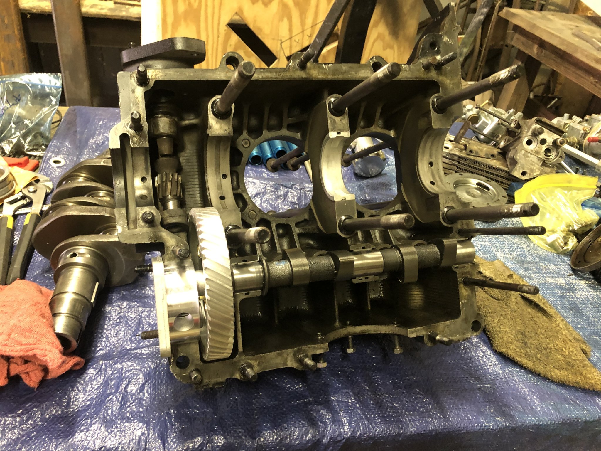

Is that cross shaft the oil or fuel pump drive shaft? Looks like it needs a new gear... 🥳

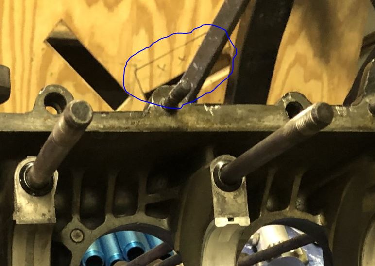

Actually the problem is in plain sight.......didn't cut out the Xs. Why the fuck mark them, if not removing!
Some broken parts In there. Hopefully that was a salvage motor your rebuilding
Nothing broken that I recall...but some mis-matching and shitty assembly. It was a motor I had gotten cheap that had a bunch of new parts and was assembled but never started. Good thing, it might have lasted 60 seconds the way it was done. Had brand new KS P+C that didn't have the cosmoline washed off :rolleyes: . NOS genuine VW heads. Lifters were worn out, God knows if they were installed on the same lobes. Two old used rods and two brand new ones. Tons of sealer blocking off oil passages. Quite the mess.
