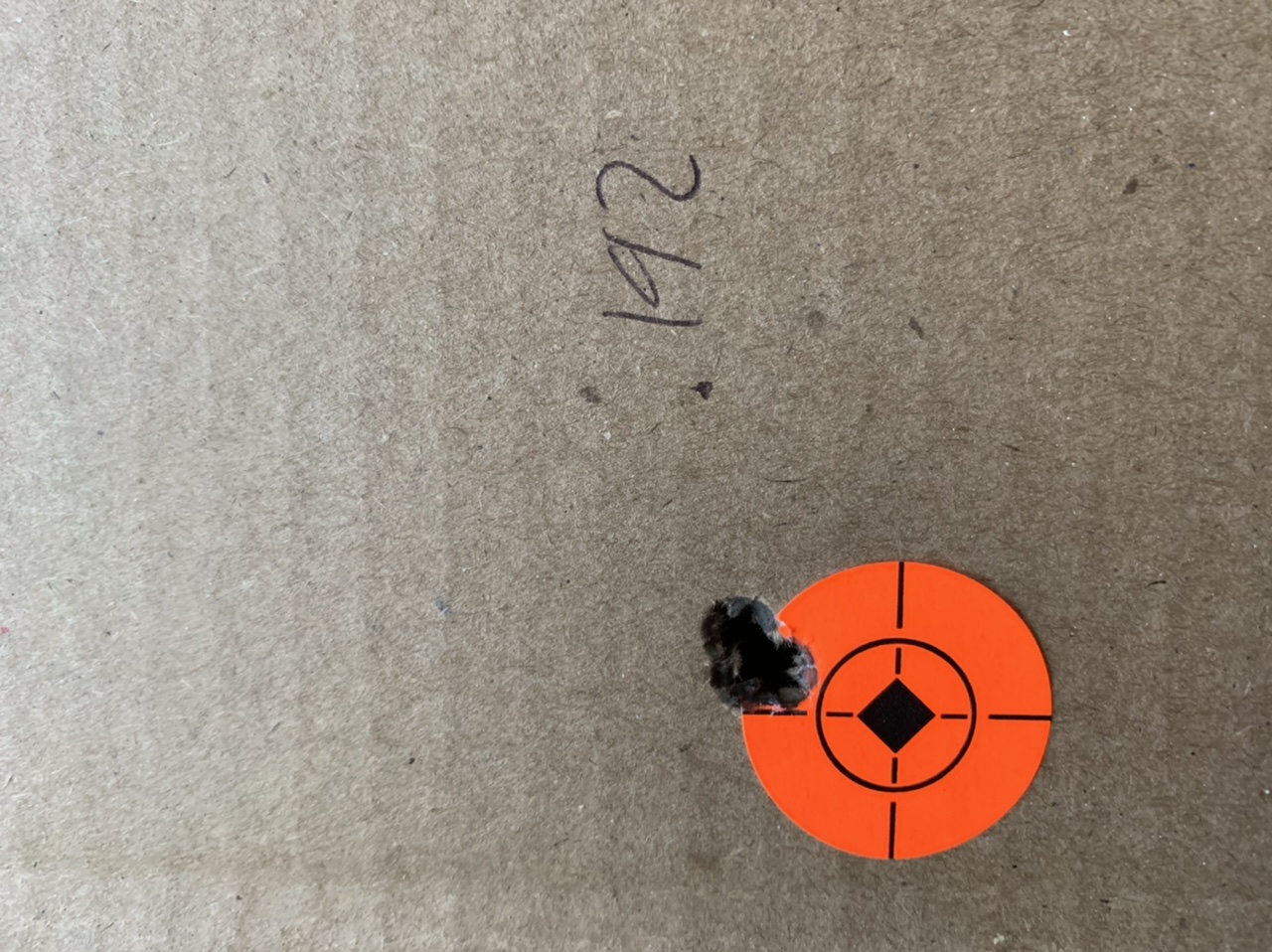

Is that the only ammo you have used? It is absolutely capable of better. I have one in 6.5... tried hornady precision hunter, got 0.8 moa. Then tried hornady match, got 0.6. A very fast and effortless load up (less than 20 rounds) got me 0.6 moa with 143gr eld-x. There is more potential to squeeze out of it for sure.
Starting hand loads in mine were average of .3X lowest was a .2. This was with 140 Berger vld and 142 smk. I would suggest trying some different ammo.
