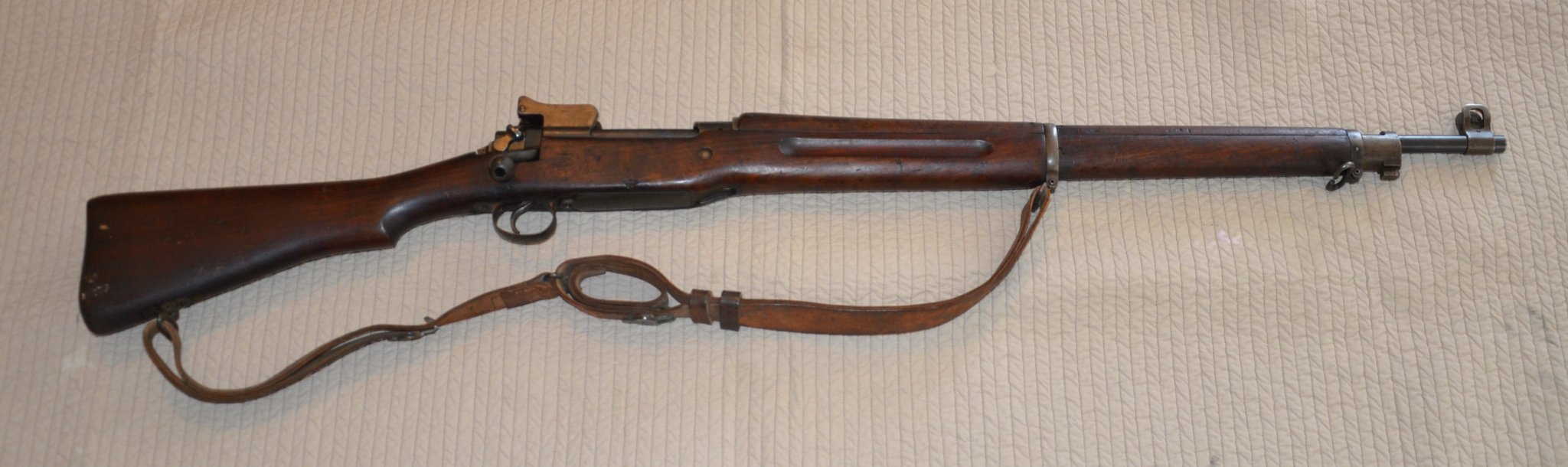

1917 Enfield for the win....... And I'm the proud owner of one of these bad boys!!

1917 Enfield for the win....... And I'm the proud owner of one of these bad boys!!View attachment 7818528
I have one of those in .30-06, grand-dad had one in the attic a long time ago (sadly it was sporterized long ago, I love the way the original ones look), surprised how well it shoots for a gun nearing it's centennial
