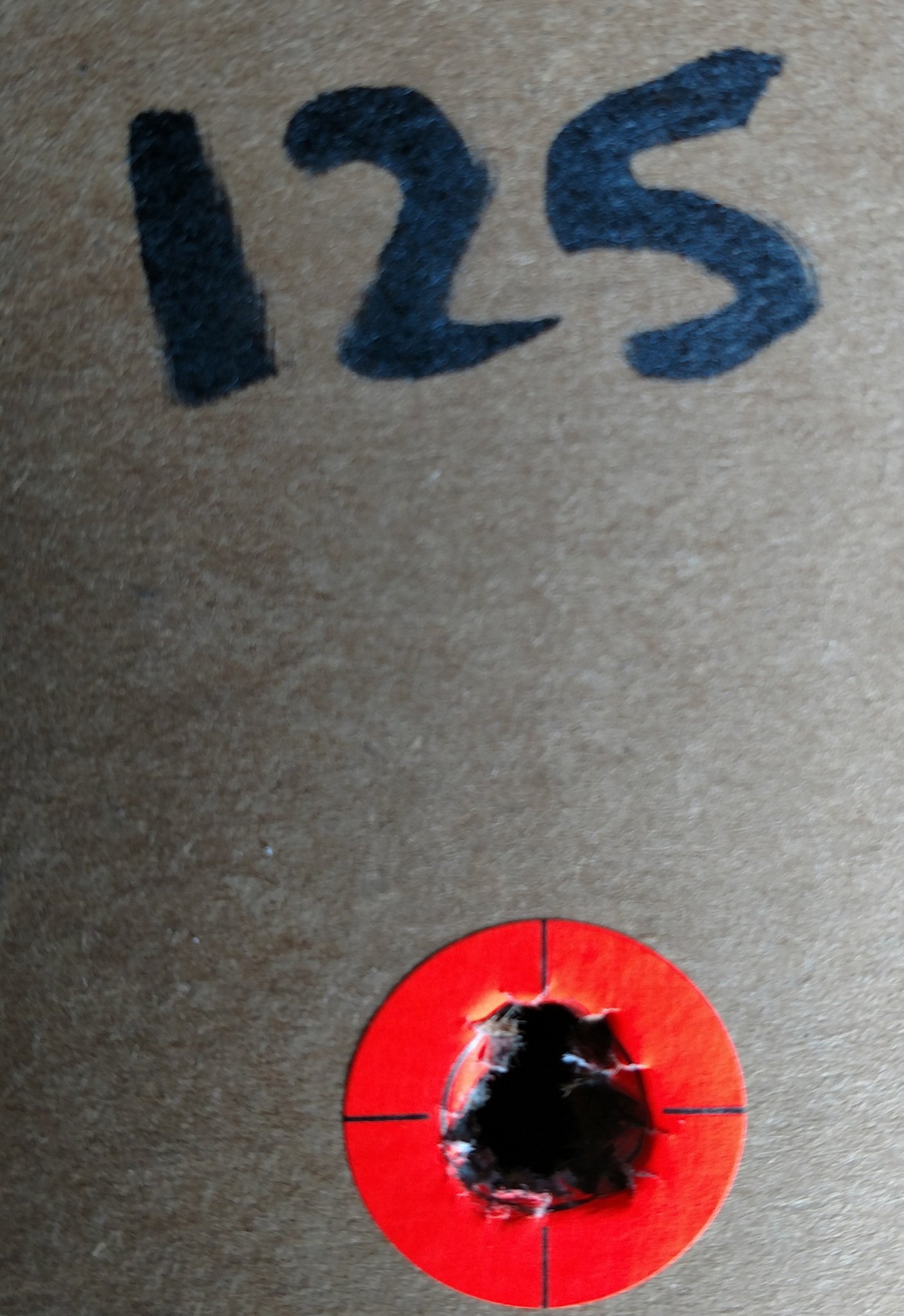

I also would recommend a J.J. Rock, I shot one of their Cadex chassis rifles and finished 8th at Ko2M this year with it. And she shoots alright, here was my first 3 rounds out of her at 100 yards...

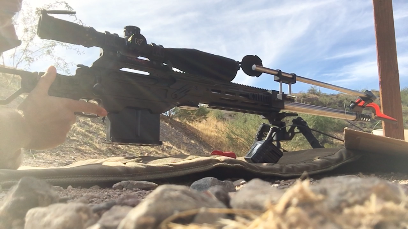

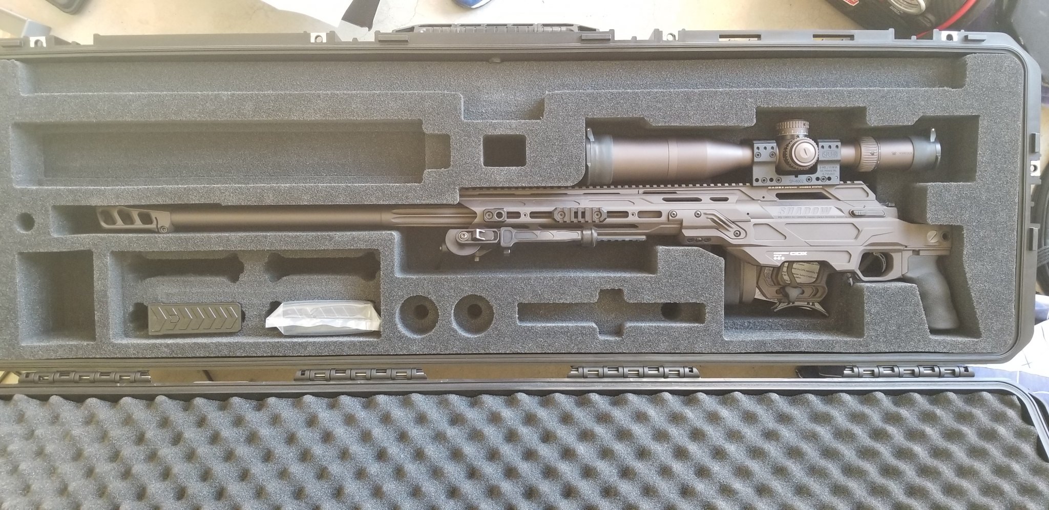

Just took delivery of my Shadow in 375. Starting with 350 gn SMKs and then will transition to 377 gn solids. This thing is a work of art as far as for and finish are concerned. Went with 32" 1:10 twist.

Beautiful looking rifle! Post some pics up of how it shoots! I had a really hard time deciding between the Cadex and the DT. I ended up going with the DT for the simple fact that I can switch barrels or calibers down the road if I wanted. I have been extremely pleased with the factory barrel and the 350 SMK. I'm working on loads for the 353 grain Lehigh now. Loading for this cartridge has been a lot easier than I thought it would be too. Good luck!

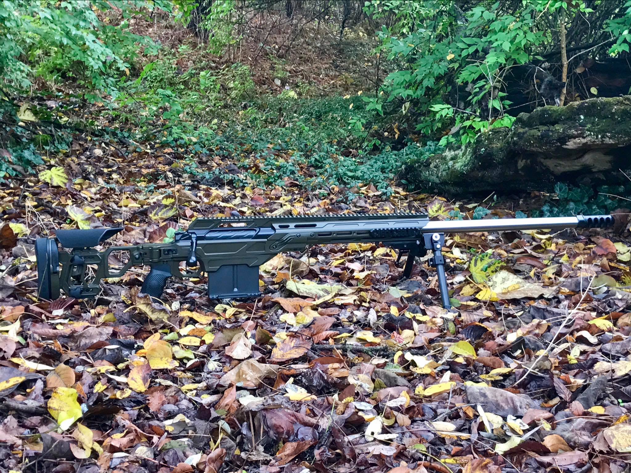

Here’s my Shadow 40 built by Robert Vestal’s.
He’s a Cadex dealer. He built this rifle, plus three barrels, plus the gunsmith work cheaper than a JJROCK built rifle.
My action and recoil lug are bedded as well.
If you happen to know which bullets you want to shoot for a particular cartridge, Robert can set up the freebore for that specific bullet which pays dividends for ELR.

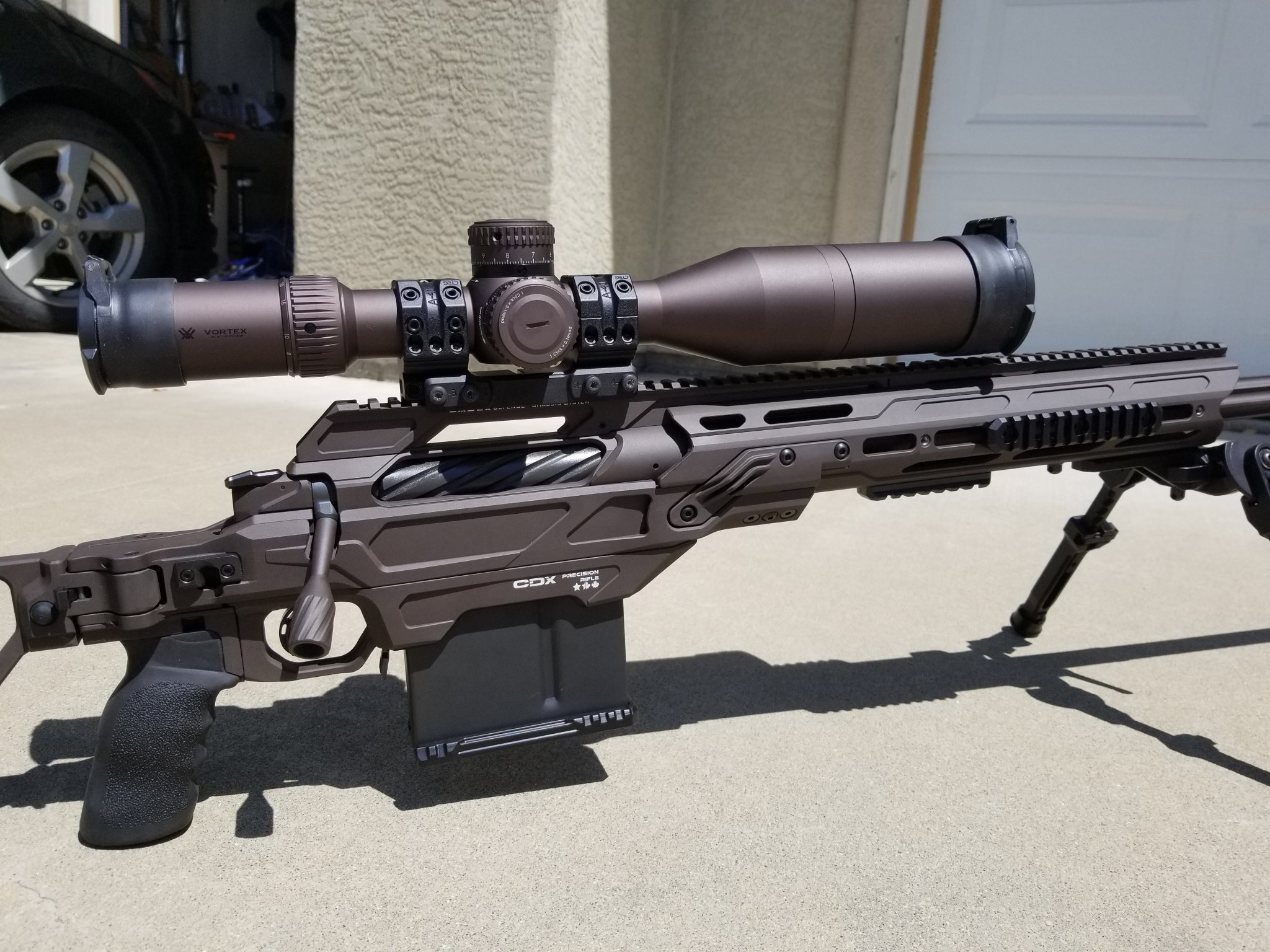

I got my CDX Shadow this summer with a 32" 1 in 7 twist. Sadly I have not got my reloading components put together for it to shoot.
Plus I have a CDX 33 in 338 Lapua. Only had this one out to 1057 yards. But it was boringly easy.

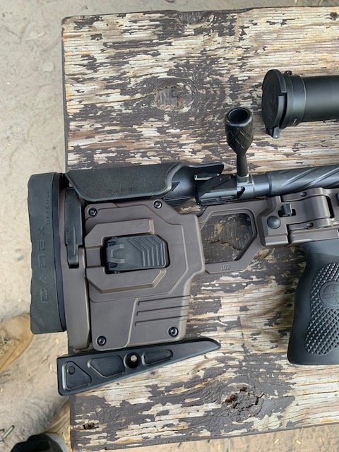

Bag rider, longer foreend to place a bipod further out there, faster twist rates that aren't custom orders, the folding stock is a potential weak point that I fear could loosen up over time, rail on bottom
I use an angled KRG bag rider on my CDX40. I had one laying about and found it fit well.
Bottom rail is there, and solid: I can confirm it works well with Rempel and LRA bipods.
I'm keeping an eye on the folder too; and will let you know. I'm 300 rounds in and haven't had to adjust tension yet.

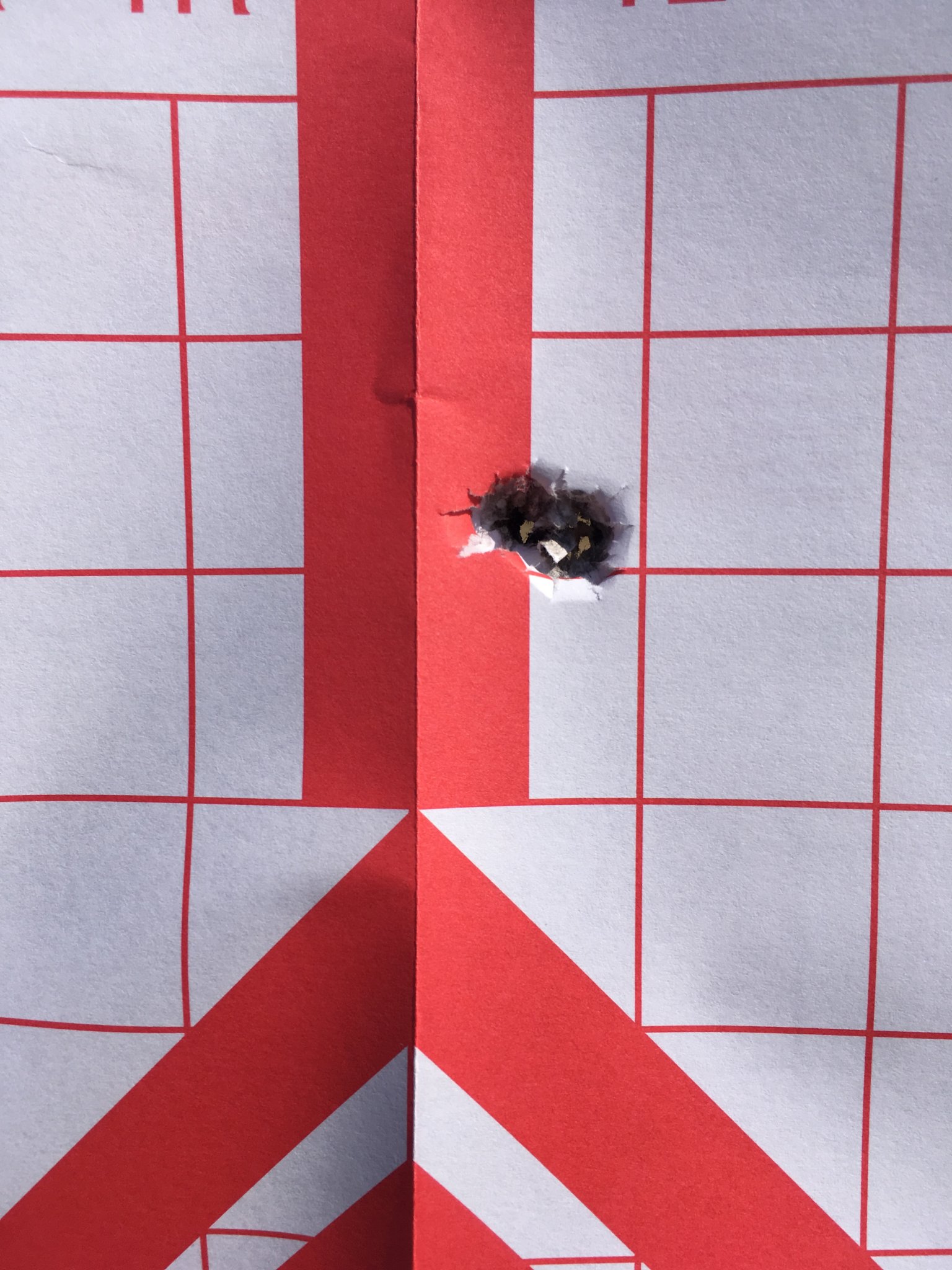

Had good luck with my SHADOW 32'" 1-7. I have had hit out to 3090 yards on 40in plate. Sadly my barrel is getting tired and will having a new barrel out on soon. Going with a little heavier contour barrel and going to go 34" 1-7 Bartlein . The main thing is spend the money and get a good set of dies. My brass loads just like new even after 7 to 8 firings.
