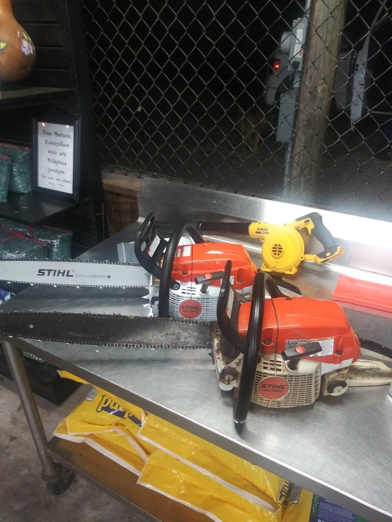

I couldn't agree more
4 years ago when I bought my 2nd 261.
And if you really want a dirt bike in your hands get a 500i like I just bought.
