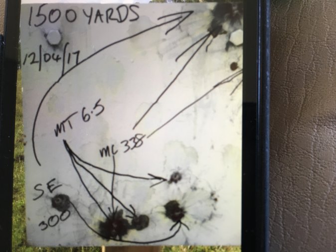

IMG_0019.JPG Not quite subsonic but transonic . Three 140 Hybrids in a row at 1500 on a 12 by 12 .
Three shots are MT initial .
