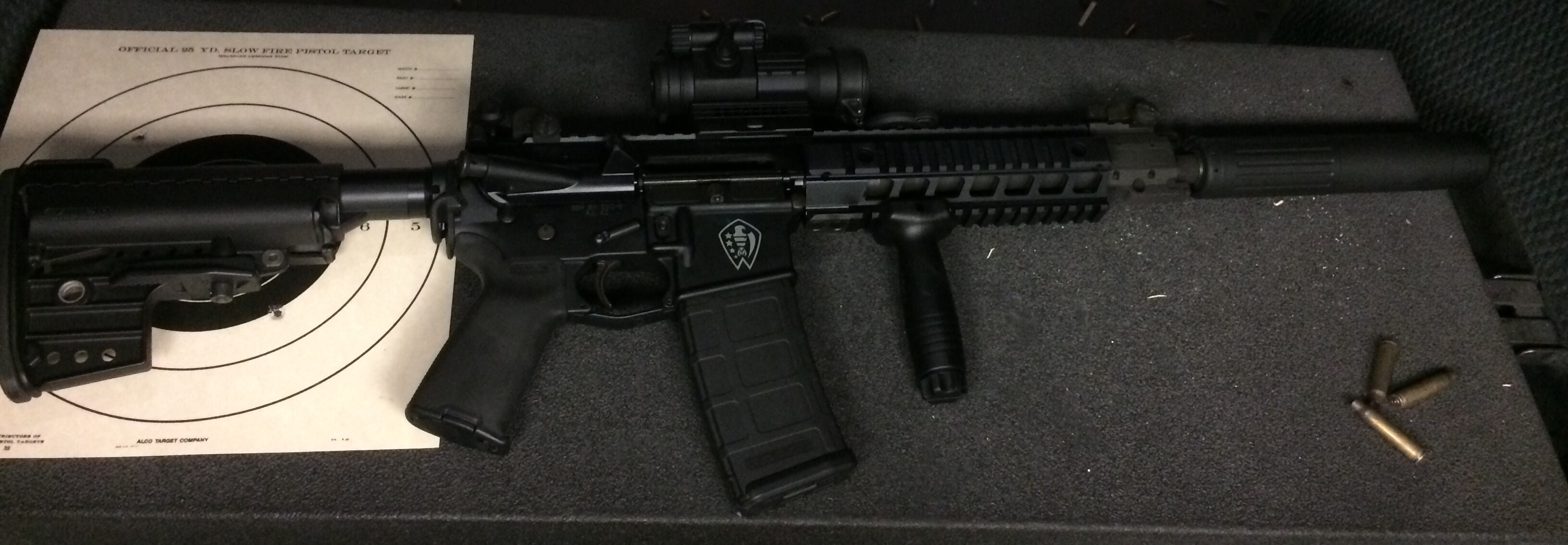

We'll after a nice 11 month wait, suppressors are in my hands! I've had a dd mk18 upper on my registered lower for a while (all properly setup for sbr) and it's functioned flawlessly, however my other guns are either piston or adjustable di for the suppressor so it got me thinking about selling the mk18 upper for something with adjustable gas. Am I stupid for thinking about selling the upper or would I be better off with say a sig 516 10 inch that I can gas down for the suppressor?
Why dont you just spend $60-$120 and buy an adjustable gas block. There are low profile ones that fit under most rails. Plus if you decide that you still dont want it then just sell it. That way you are only out $120 at the most instead of the cost of a new upper.
None will work with the mk18 setup, the suppressor is thousandths of an inch from the end of the rail. I can also sell the mk18 upper for just about what the sig upper costs new, so it would be a wash.

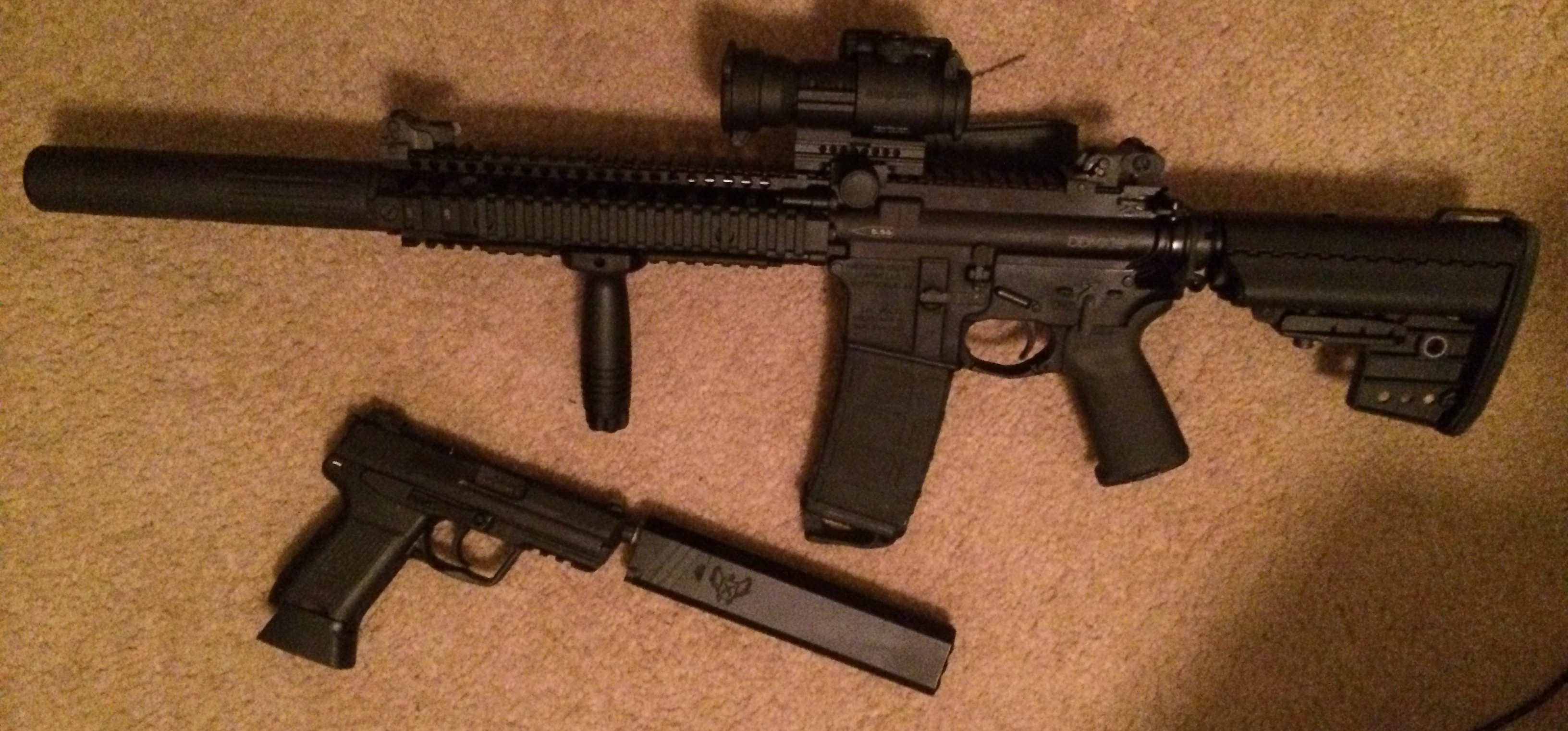

After researching a bunch, looking into a pws, noveske and multiple other high dollar adjustable, I found a silly deal on a sig 516 10 inch upper and snagged it... It shoots amazing and absolutely zero recoil with the suppressor, and very little gas in the face on the lower gas setting. Cycled beautiful, so I'd say good purchase!
Nice. Good to hear you ran up on a good set up. You know, seeing this thread got me thinking about the whole 5.56 SBR topic. Back when I was trying to make a call on a 10.5, 11.5, 12.5, and/or go the DI or piston route I couldn't find jack shit comparing them head to head suppressed. Now I have a 8.5" Navy retro-fitted with an XLP kit , 10.5" switchblock, and a 12.5" switchblock. If anyone in the state of CO (or TX where I frequent often) wants to sync up and do some legit comparisons with different barrel lengths, ammo, operating systems, to measure real world variances in accuracy, recoil, effective range, maneuverability, and 20 other aspects anyone might consider personally important for their application - and likely spend months researching - let me know. I'd be all in for participating in that!
