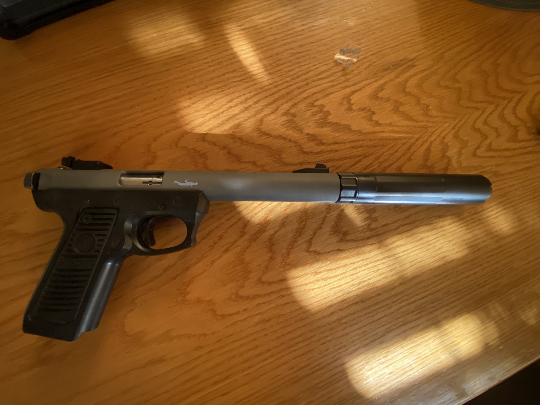

I still haven’t shot it on my new TACSOL 22/45 upper.

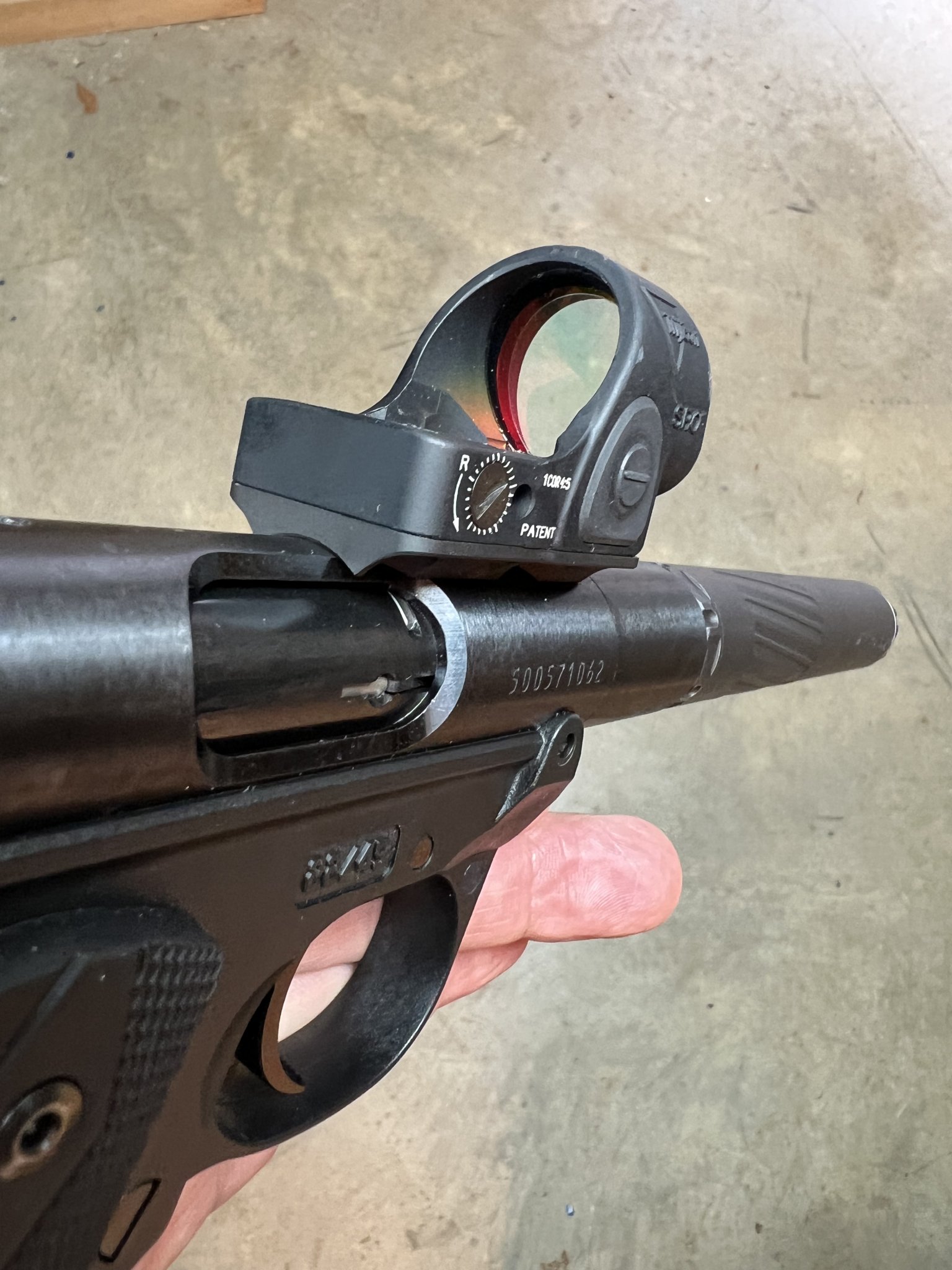

Also have both TBAC and dead air
This is the TBAC on a Ruger SSH Special
I have both as well, but my TD22 is FDE, so it doesn’t match. But because it’s such a sweet setup, I plan to order a black TD22 as soon as they come back in stock at SS again, just for a permanent residence on the SSH. 👍🏼
Here's a video of me shooting 8" plates at 100 yards with the SSH/TD22 combo...
