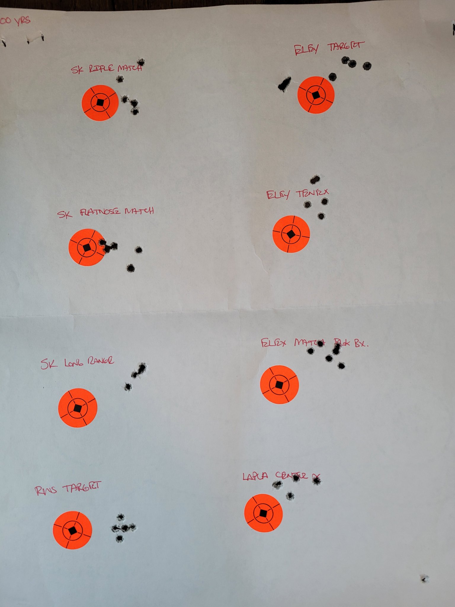

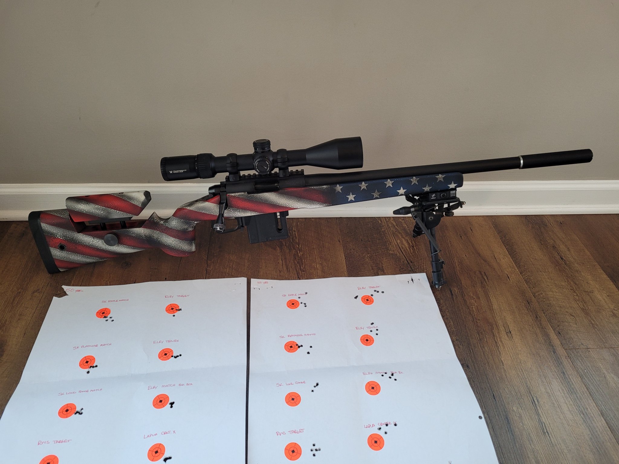

Saw a lot asking about ammo. I just ran 10 different kinds at 50 and 100. Not that every rifle is the same...regardless all kinds shot really well and both yardages. I've been shooting the sk long range stuff as it was the most consistant for me anyway from.box to box on paper testing and beyond 100yrds.. Shot really well at 200 and good at 300 as well.

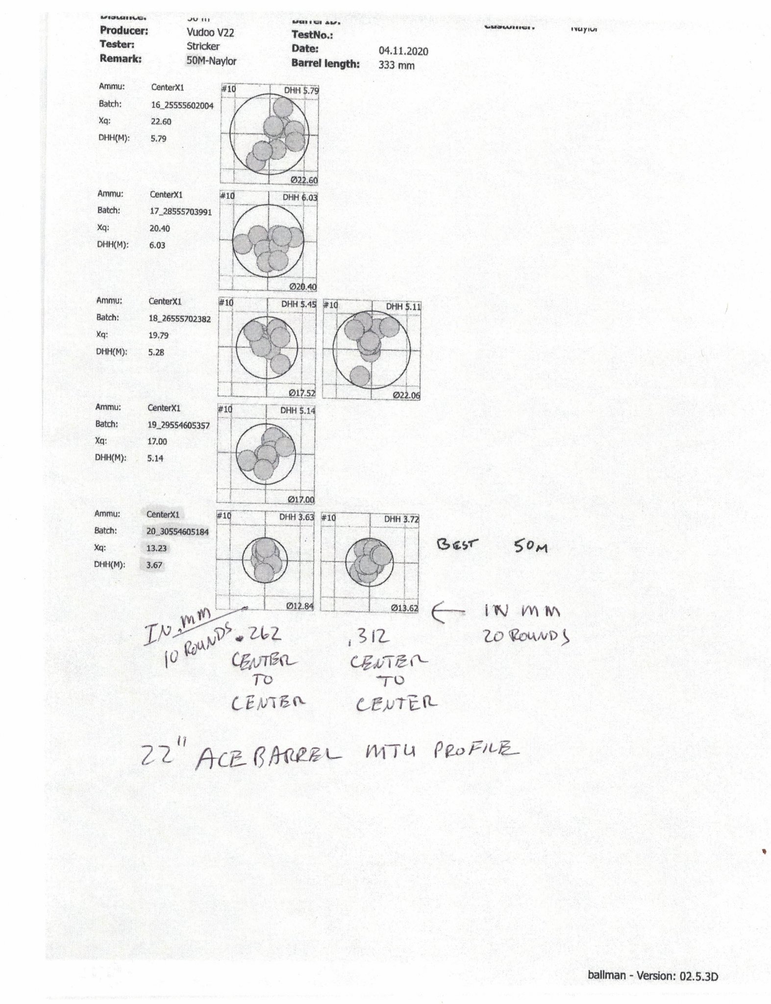

I sent mine to Meas Az. Deva tested 20 lots of Center-X and found one that shoots .262 10 round groups at 50 and .312 for 20 round groups at 50. I ordered 2 cases of that lot. The rifle testing and turn around was 2 weeks from the time I sent it till it was back at my door. Well worth it!
