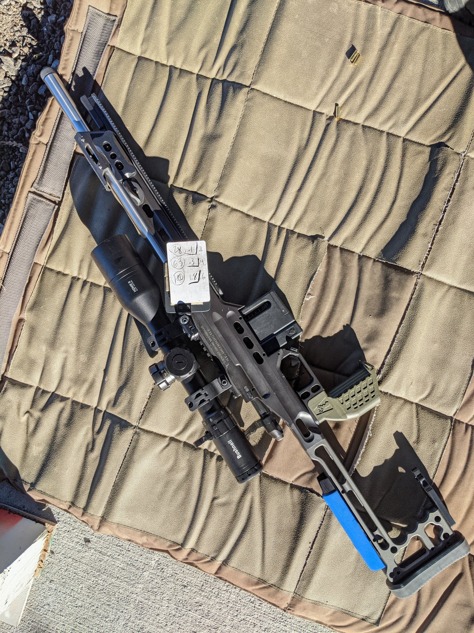

Just be aware, if you aren't already, that the fore-end of the MDT ACC is much longer than the MPA BA Comp. This image shows my 20" Vudoo (actual measured length 18.75") in MPA chassis in front of ACC-mounted 6.5CM, with the fronts of the actions aligned. Due to the way the dividers in my safe were arranged, I actually had to cut one out so the ACC would fit.
Yeah I’ve talked with Littlepod on here, he got his cut down 3.5” but I think I may be going MPA. Waiting to hear back from woody on a color scheme (fde/black distressed) for the vudoo. And then maybe a blue/black distressed for a 6.5????

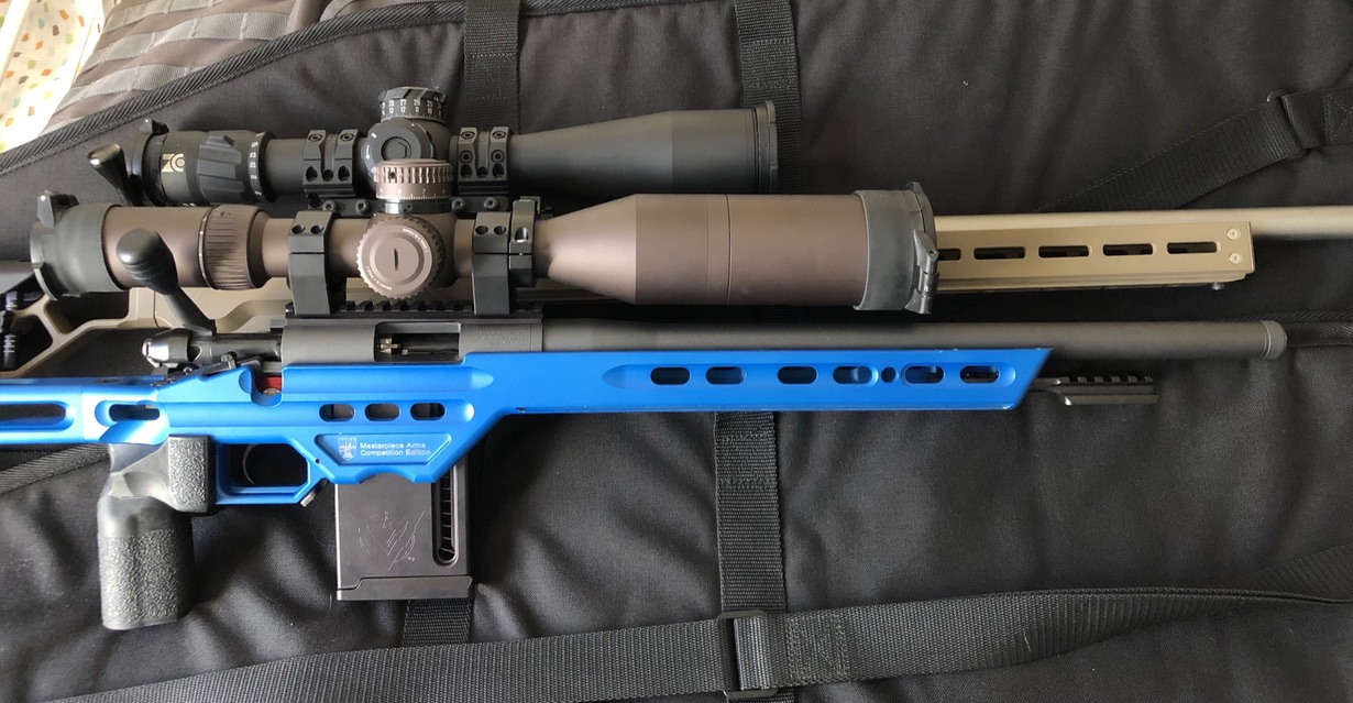

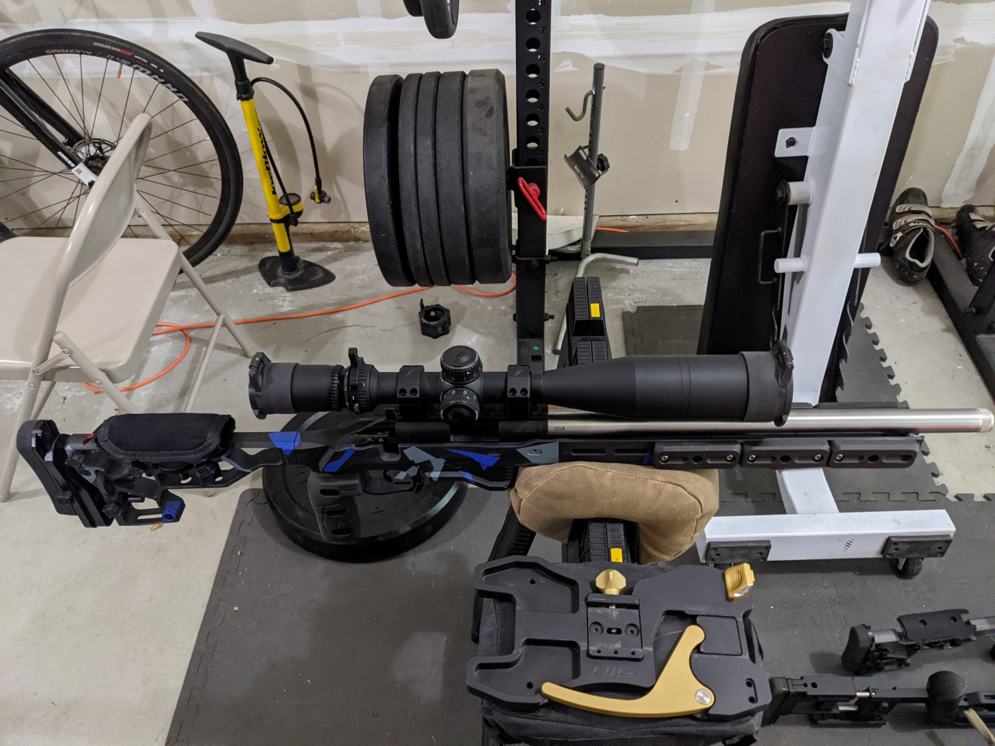

If I had to do it all over again, this is after running with 3 different Vudoo's, I would get a 20" MTU Vudoo. I would get an ACC, and not worry about cutting it down since the 20" MTU extends pass the barrel. I would ask MDT to send me the aluminum buttpiece instead of the steel one to reduce the rear by .5 lbs. I would run 5 internal weights. This leaves a really well balanced Vudoo in an ACC.
Cutting down the ACC is fun and compact to run a 16.5-18" barrel, but for NRL22/22X/PRS, the best thing you can do is get a balanced rifle and these chassis are made for centerfire rifles and to balance about 3-4" from the mag well. My ACC balances really well with my centerfire rifle running a 7lb Proof Comp Contour barrel, and I don't have to run any weights.
MPA vs MDT, just preference. MDT's longer fore-end allows more weights to be added up front to get balance w/o super heavy weight. But you can slap on all the weights on an MPA to get balance too, it'd just be heavier overall.
Is any of this required? No... but this is talking about stretching the limits and reducing the wobble as much as you can. This is not about lying down in prone and shooting the 1/4" KYL, this is about shooting the 1/4" KYL off a sawhorse / ladder.

Thanks for the detailed info. I ended up going with the MPA and 20" Kukri barrel. I will add the weights up front as needed. Can't wait to get it!!!

Definitely go 20” MTU man. I’m running a 18” proof carbon fiber kukri barrel in mine with a 13” forend. Looks awesome. Just rear heavy, even with the ZCO on it.
... I would get a 20" MTU Vudoo. I would get an ACC, and not worry about cutting it down since the 20" MTU extends pass the barrel.

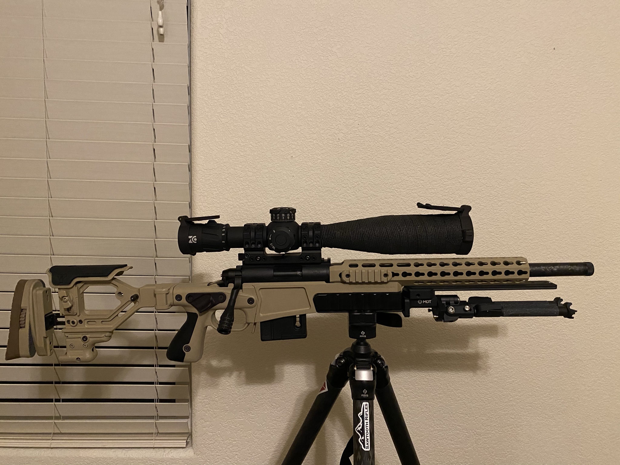

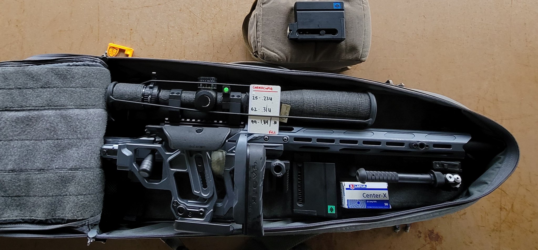

Here is my 20" MTU V22 in Cadex Defence Lite Competition Chassis inside a LBX Rifle Bag. https://lbxtactical.com/products/4k3a
It fits the rifle very well, has plenty of storage places and it's comfortable to carry.

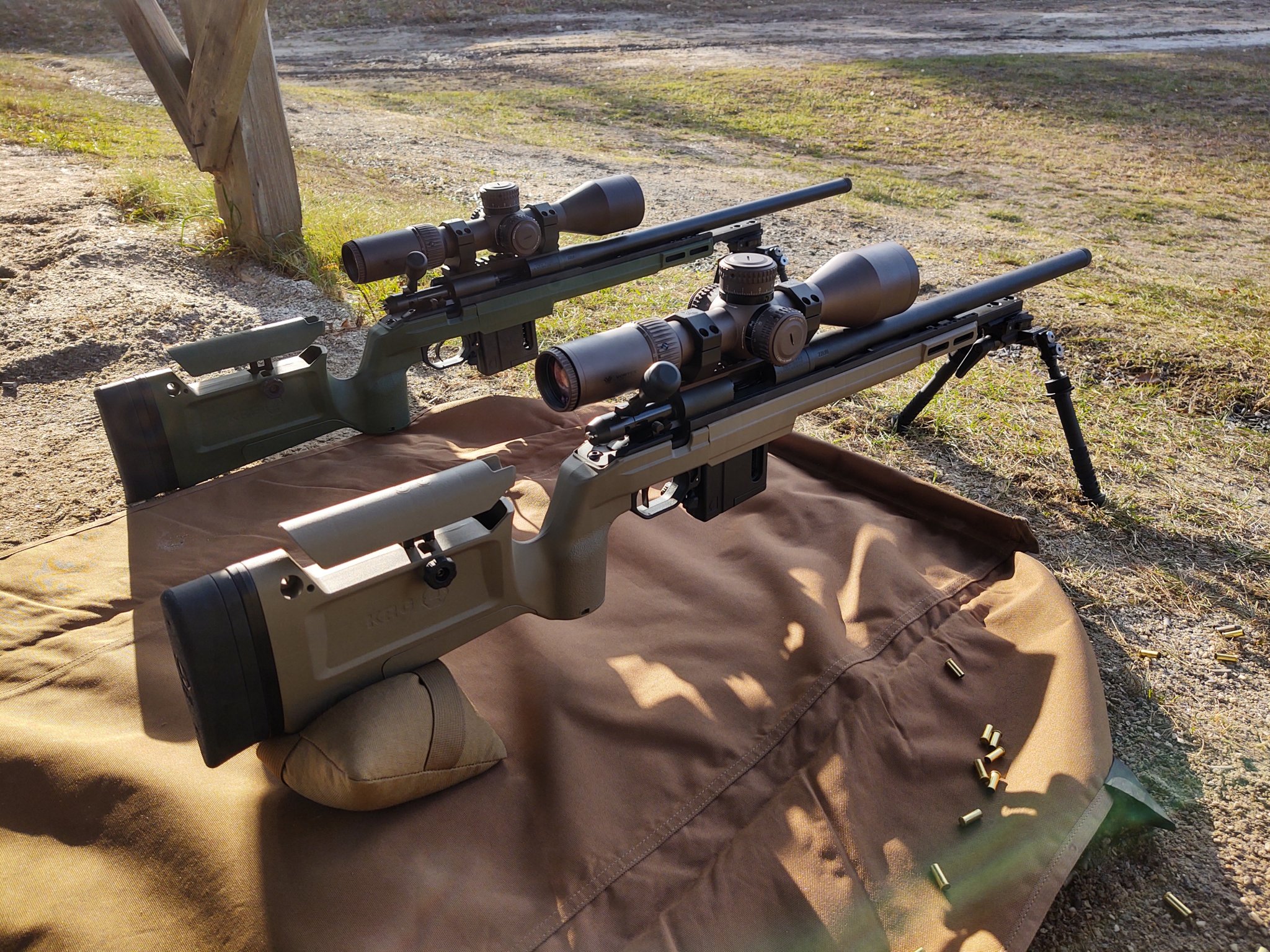

I have posted about my latest Vudoo’s in some other places here on the Hide, but I might as well put some ”results“ from my latest here too for anyone on the fence about their first Vudoo purchase. Back story these two are among many VGW rifles or barreled actions that my family and I have owned. I bought these for my daughters as this summer they expressed interest in shooting again. I picked up a 20” Kukri BA (Ace barrel) from Mile High and the next week a 22” Kukri BA (Bart barrel) from Altus. They both got 2 stage Timney triggers, KRG Bravo chassis (I am really liking these chassis), 0.66# KRG butt plate spacer, KRG spigot, Atlas CAL, and a Vortex Razor Gen II 4.7-27X56.
Both rifles are killing it as far as accuracy goes and have been 100% reliable (as I expected). My daughters are really enjoying these rifles and they shot their first match last weekend, with more to come in the future. They did really well with my oldest daughter (15 years old) winning the match and her sister (14 years old) tied for 3rd only a few points back from her sister. It was the best day I have ever had on the range and I did not fire a shot. I was just on the spotter calling wind for them. They were dead on with every correction I gave them and when the wind was switching I was changing the correction mid shot it did not phase them in the least, they just held it and broke the shot for a center hit! I can’t wait to get back out behind the spotter for them.
We definitely are a Vudoo family and we would like to say thank you to everyone at VGW for all you have done and continue to do for our sport.
The rifles:
The shooters:
The rifles:
The shooters:
