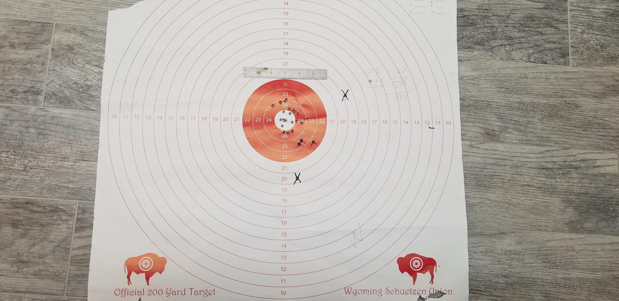

Another 200yd string match. No sighting/warming up. Guess dope and go. shoot 25 keep 20

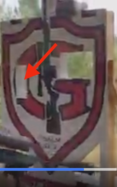

Out of curiosity, what is the black wrap's function on the objective area of the scope?
I was pretty "meh" about the wrap thing until the last Guardian match and its sheet-metal-sandwich barricade, whose little window (arrow) left a long scrape on the side of my scope's objective bell. Sure, equipment gets scraped and banged up with normal use, but a roll of 2-inch black wrap was a dollar on the clearance rack so why not.

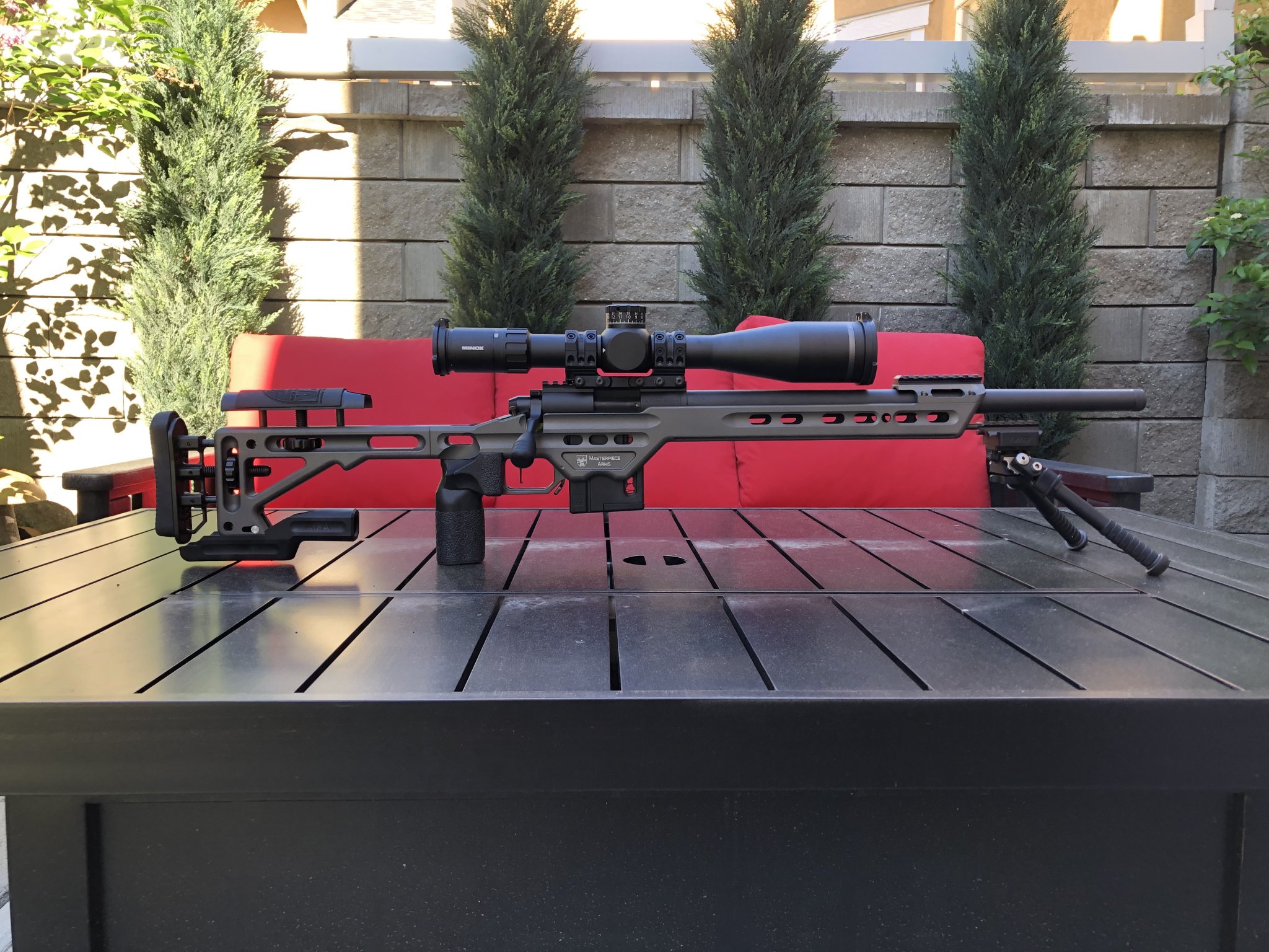

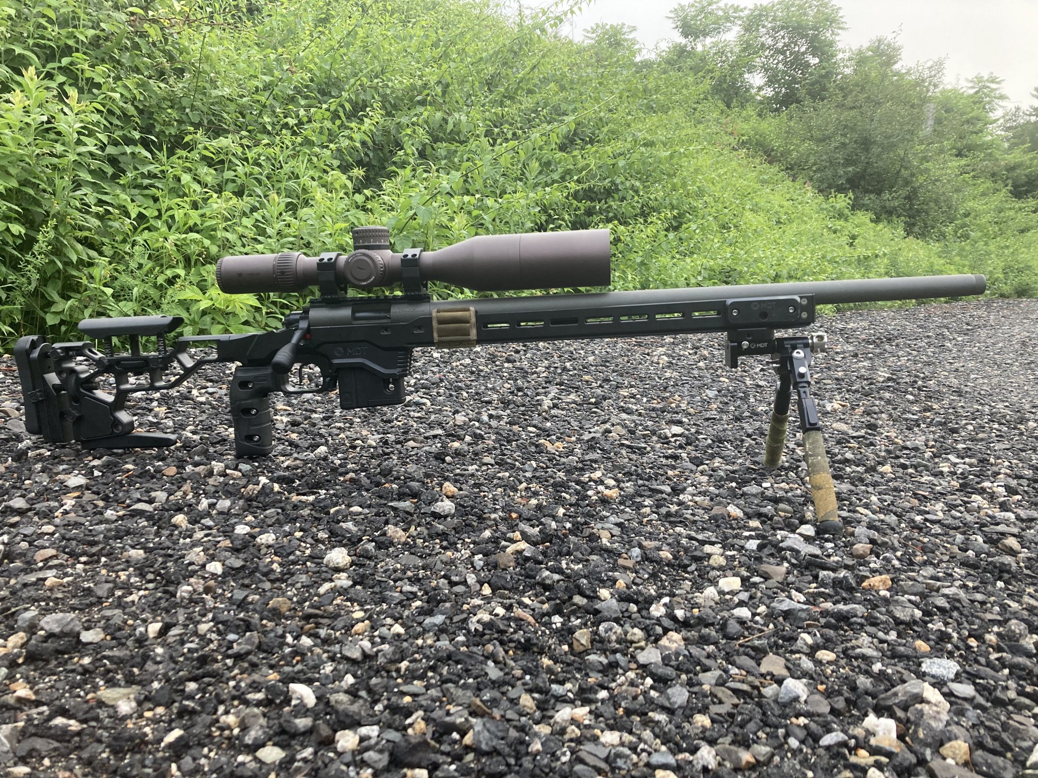

New build for my long range 22lr. Vudoo V-22 360 Barreled Action, TriggerTech Diamond 2 Stage Flat Trigger, MPA BA Comp Chassis in Tungsten, Minox LR 5-25 Scope, Spuhr SP-4601 Mount.

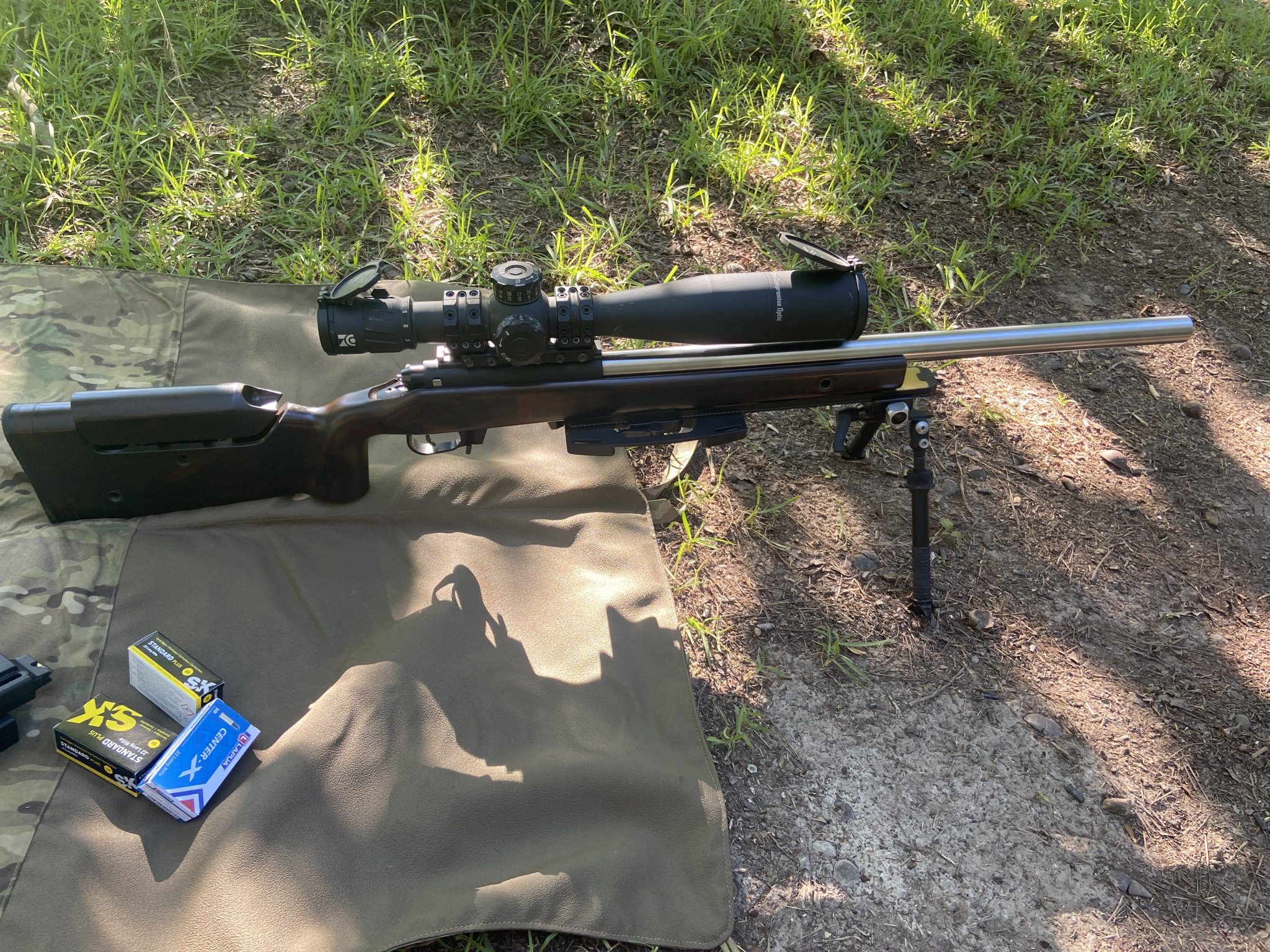

I watched @RAVAGE88 videos on the installation and setup and have had no feeding issues in the first 250 rounds through it. I can’t believe how smooth the action cycles. Really glad I made the jump to the Vudoo.
Breaking in my new Vudoo 360 per Mike Bush instructions. Love the rifle. 20” Kukri with Straight cut Flutes, Trigger Tech Diamond, American Rifle rings (Thank you Greg!) Vortex Strike Eagle. Greyboe Renegrade Blck Grey Web. This Rifle was more than I expected. I ordered a Vudoo without ever seeing one. The rifle is tight! Thank you Vudoo. I just giggle when I see the groups I’m getting. I understand it’s suppose to get better . Now if I could get some Lapua. Thank You Vudoo!!!!!

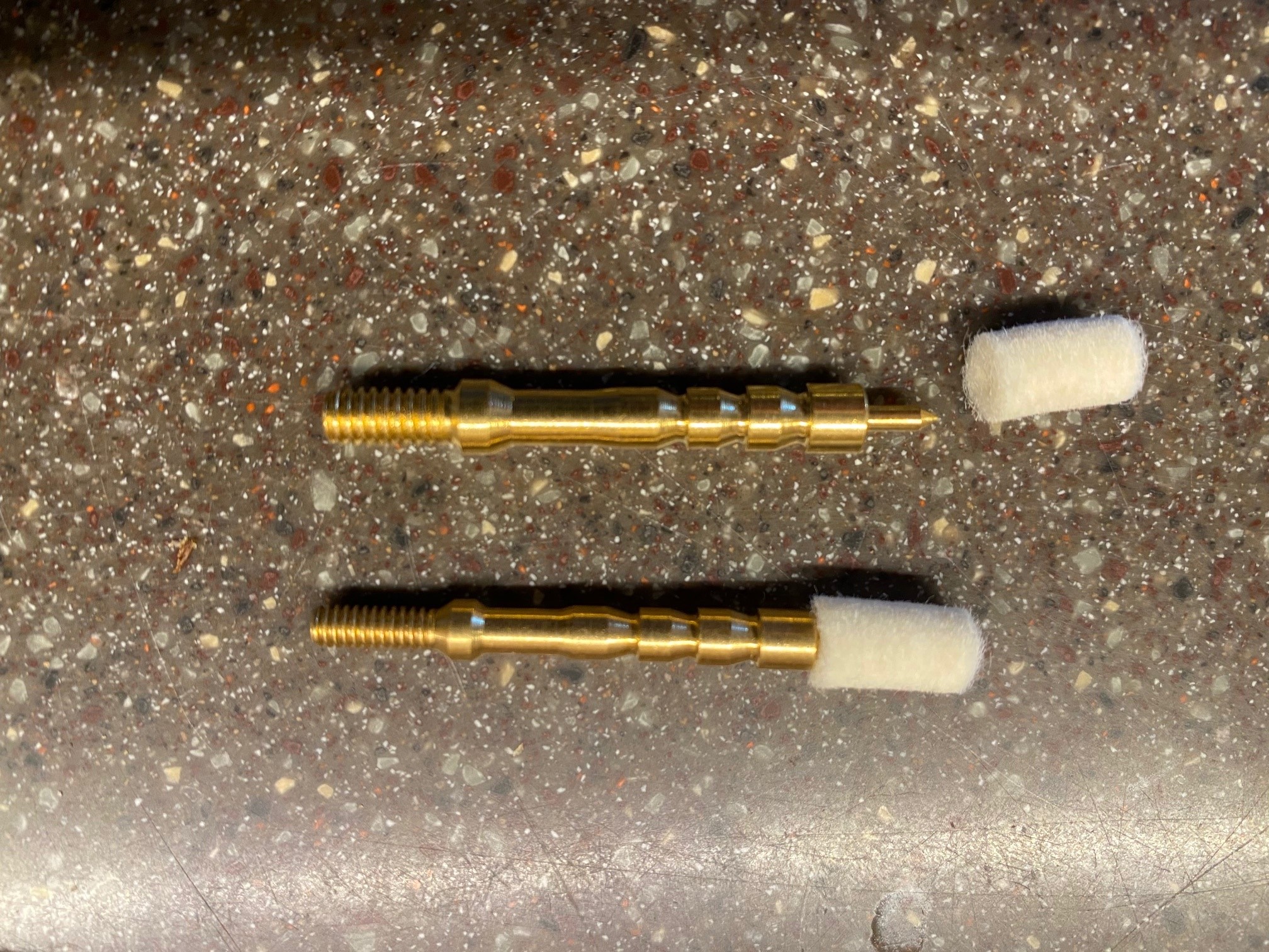

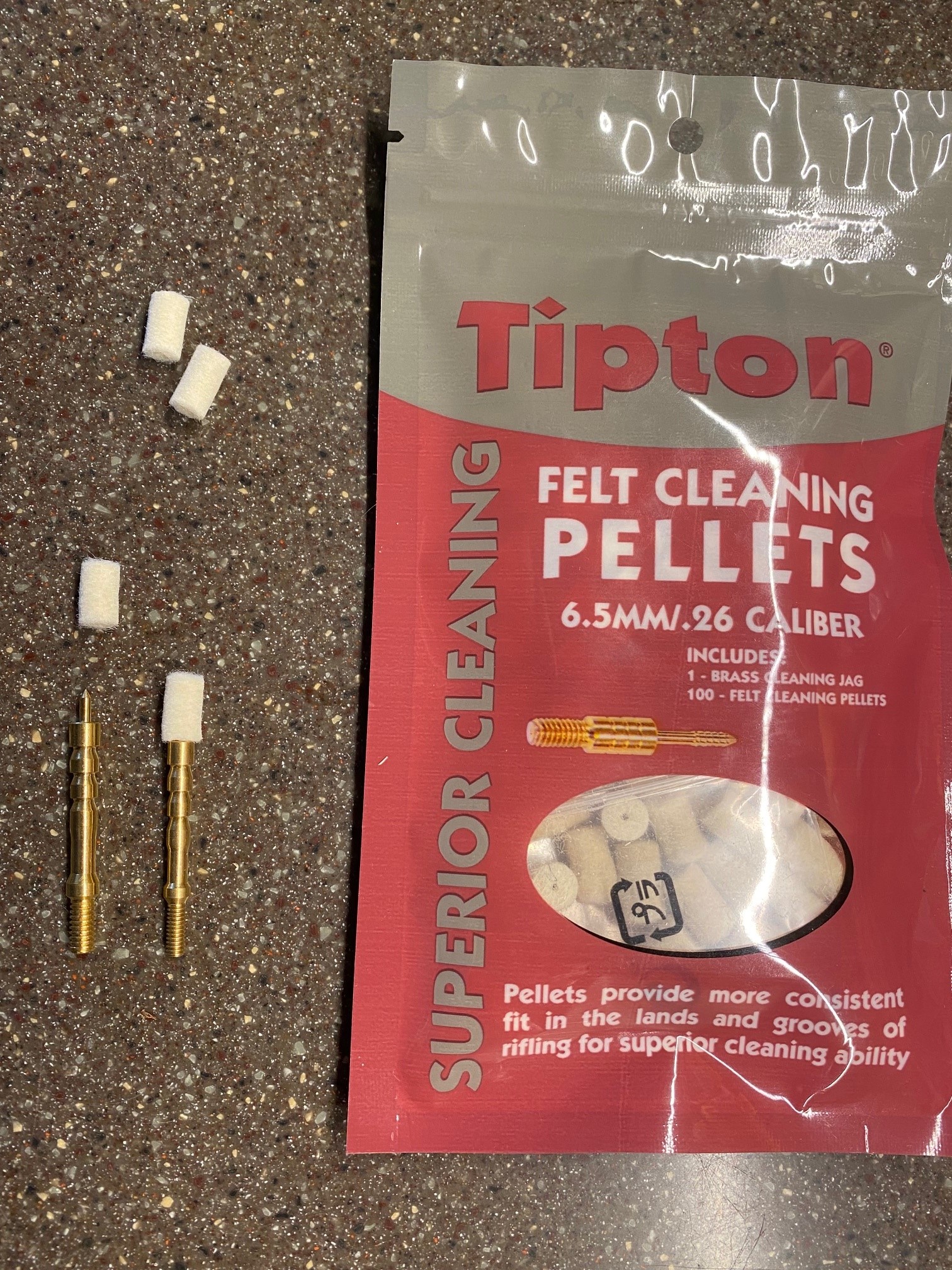

How do you “soak” the carbon ring?
Sekaf, I soak the 22 Caliber Felt Cleaning Pellets in Bore Tech Carbon Remover, Perch them on the end of my 20 Caliber Tipton Rifle Jag and then Carefully insert into the chamber. I push it in just past the chamber into the rifling. I do this for Three Felt Pellets. And on the third just push them in to or just at the end of the chamber. That makes them 'swell' and forces the Bore Tech Carbon Remover into the carbon build up area. I leave it for 15 minutes then push them out. And finish cleaning my barrel. I do 80% of the cleaning before I go after the carbon ring.
The Pic attached is a similar Felt Pellet but 25 caliber. It is for my Air Rifle. I just could not find the 22 Caliber Package....
I use the 20 caliber jag because I like to control tightness with patch size.

ok. Thanks. I use the same type in my cleaning. I really do like how they work. Ever find a deal on a big amount Of pellets?
Sekaf, It seems the Tipton come in the 100 count. So far I have gotten these from MidwayUSA. I do reuse mine. I keep the used ones in a small screw lid container. They stay pretty clean from what I can tell. So I reuse for a bit then discard. I have seen 300 count in another brand on Amazon. But they did not have the little center hole. The little hole is quite helpful in getting them placed.

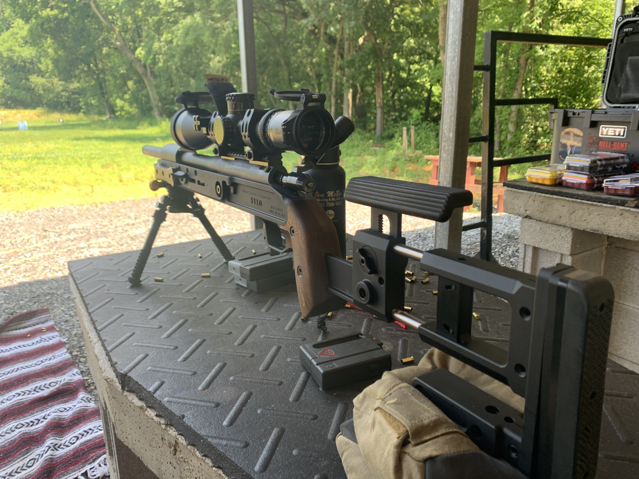

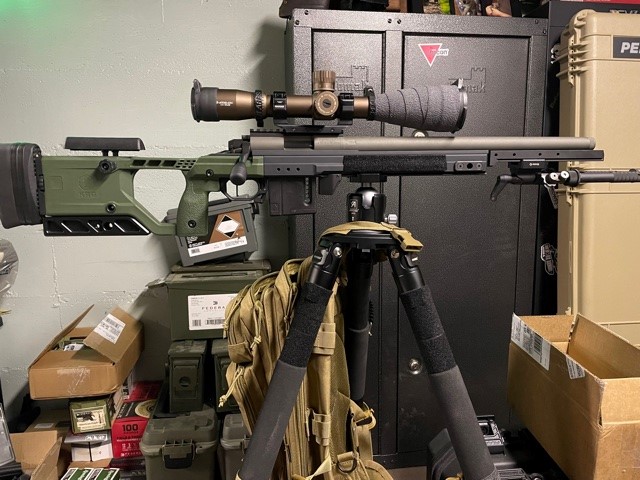

Three 60 action 18" mtu in Vudoo green
KRG xray with arca forend and xl spigot
Triggertech two stage diamond
Athlon etr in warne skyline mount
Weighs 15.2lbs balances right about where the tripod head is. Will get out to break it in Friday!
Holy god that xl spigot is huge!
Nice setup :) I'm jealous on the three 60... I have a few more months until mine arrives...
4 certain
what is the front rest in your images
Good evening F4. It is the www.targetshooting.com Rest Model 2400. Wally Brownlee is the owner. He is a good guy from what I can tell. I have purchased several rests from him over the last 10 or 14 years. He has a number of variations possible and will talk with you if you need something added to your rest. So far the 2400 has been great for me. It does require a separate knob for Up and Down and Lateral. But I think that has been good for me. I have not yet used the Joy Stick kind. I also have a Model 1000 with the upgrades on the rear of the rest like the 1200 LP. I like it as well, but that, being a one piece rest, is not allowed on most benchrest matches. Good luck on your efforts.
