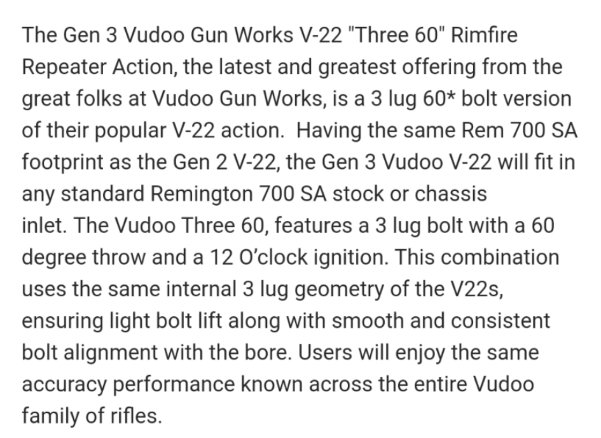

My Three 60 is the best .22lr I've ever owned...or shot. I wouldn't worry about 2 lug or 3 lug, it's the 90º or 60º bolt throw.With my luck they'll release Gen 3 of the 2 lug right after I buy the Gen 2...
I agree with those above, my family has two of the earliest V-22 rifles and they are every bit as good as the V-22’s that we purchased just a few months ago. I stupidly sold one of my real early V-22 and seriously regret that decision.With my luck they'll release Gen 3 of the 2 lug right after I buy the Gen 2...

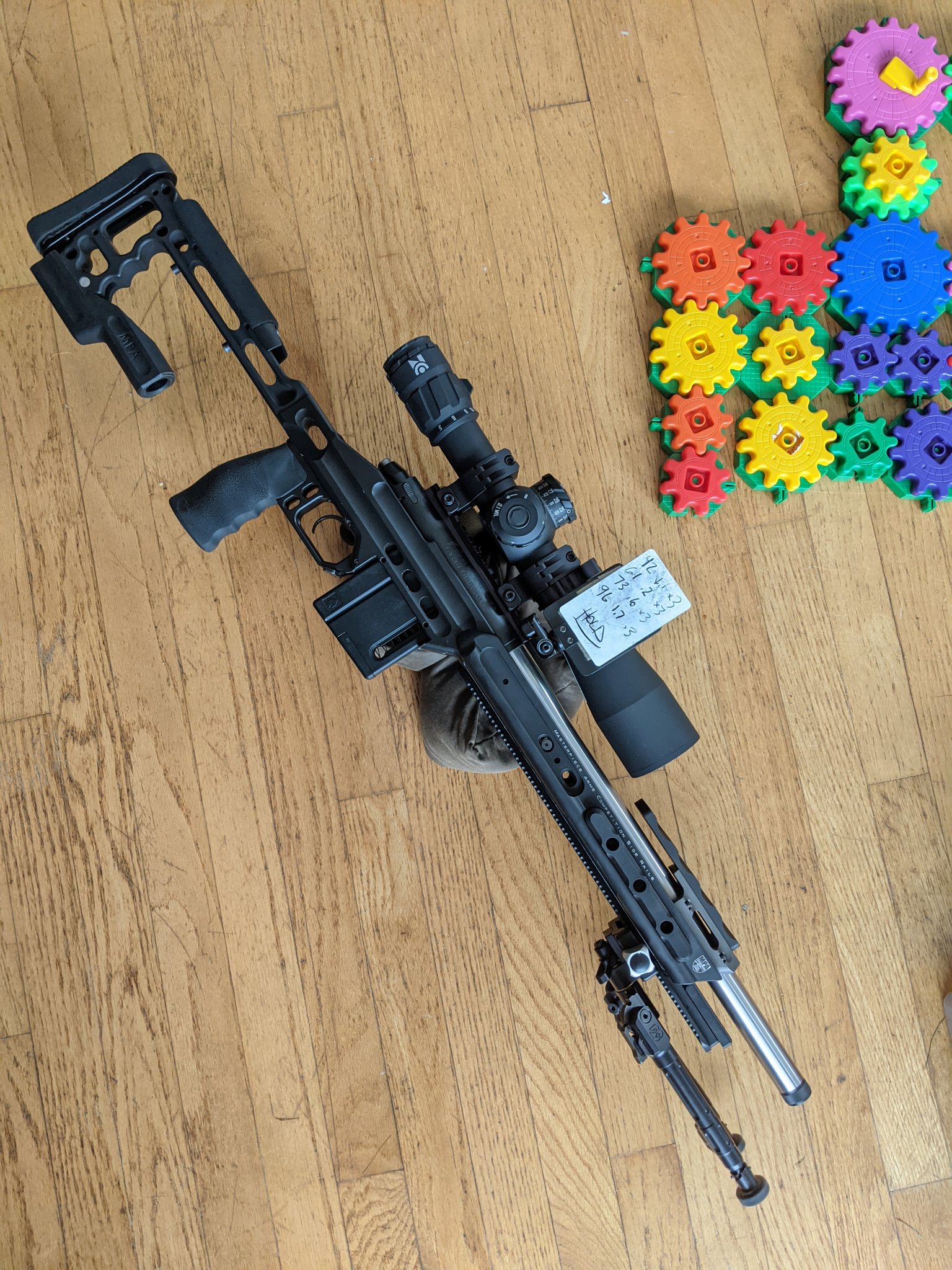

Use? PRS vs walk n stalk vs benchrest?For those with a 22" barrel in a chassis, are you happy with your choice of the Kukri or MTU profile? Why or why not?
End goal is the stick a 22" V360 into the AI AT-X R700 chassis and a Leupold MK5 3-18 optic.

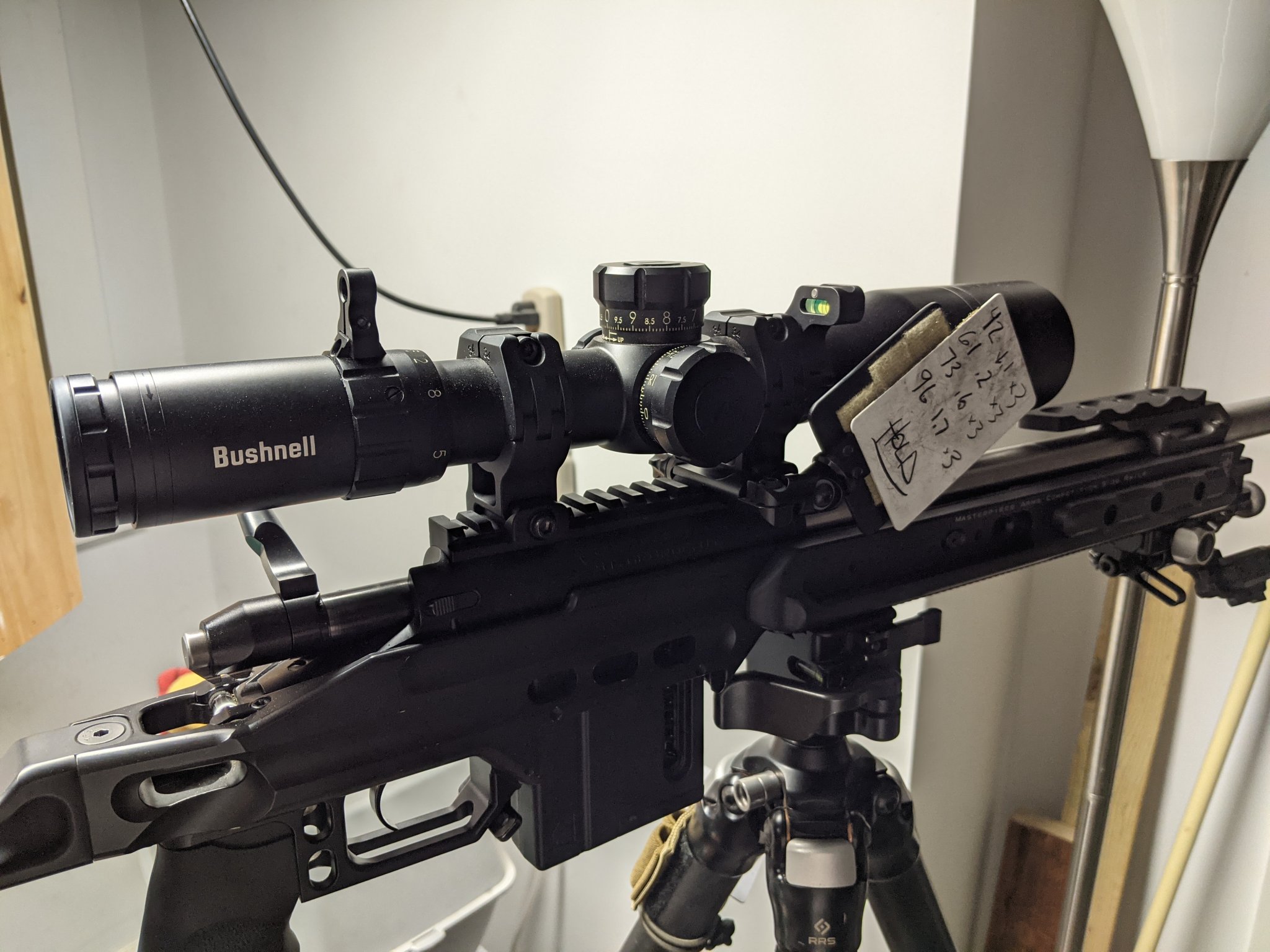

For this exact reason I use a Athlon Cronus gen2, love the “fine” reticle at high mag. and turns down to 25y parallaxI would love to try a MK5 but the 50y min parallax has me worried about the NRL22 game. I would like to hear others thoughts on the optic at yardages as close as 25y.
It will be for PRS, as clone of the AT-X I’m never getting. If I could save money by not buying extra weights up front with the MTU, that’d be the move.Use? PRS vs walk n stalk vs benchrest?
I don't know how soon you are going to pull the trigger on your order, but I have a V360 with 22" MTU in an ACC due any day now. Two guys I shoot with almost weekly have RIMX's with 22" M24's in chassis and both still required internal and external weights to balance well on barricades. The MTU should be a bit heavier out front than a M24. I expect to still need to add weight.

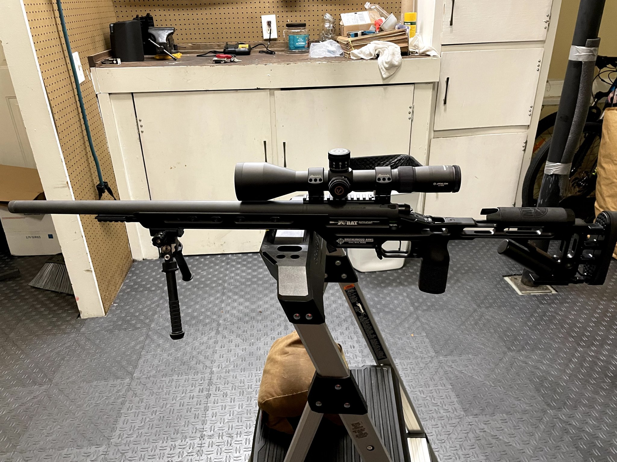

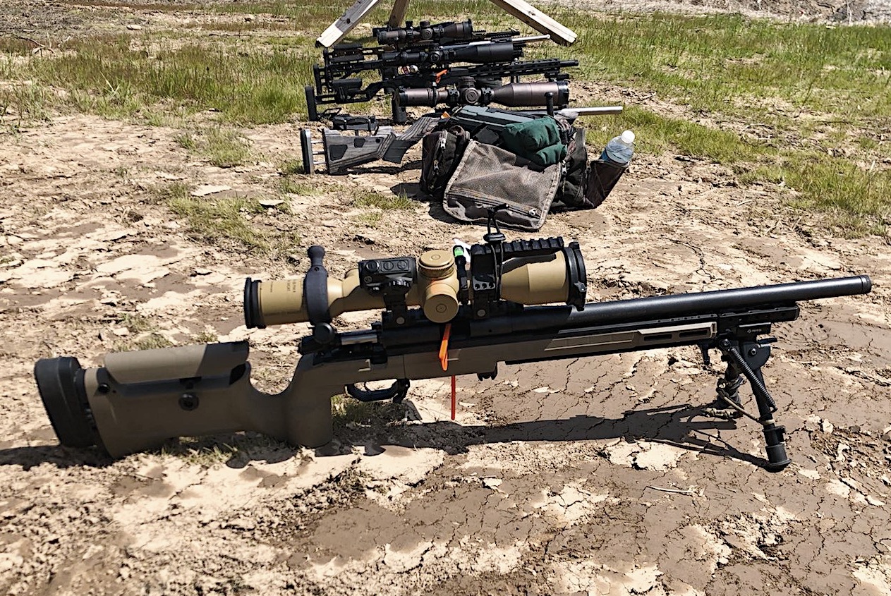

Action | V22 Three 60 w/ Large Knob - Black Ceratoke - 60 MOA base |
Barrel | 20" MTU - Polished Stainless |
Bolt Knob | Large |
Chassis | MPA BA Comp - Gun Candy Mongoose |
Trigger | TriggerTech Diamond Pro Curved Trigger |
I'm rockin' the 22" MTU... No ragerts!

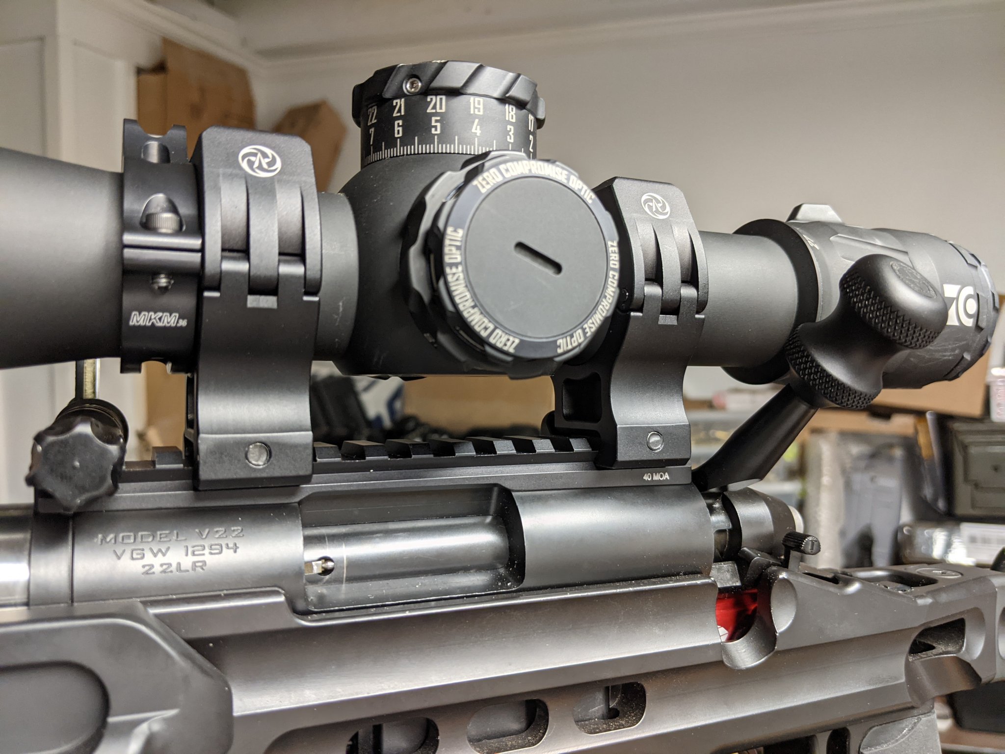

Just confirming that with the 40 MOA base you’re still able to dial down for 25 yards on the Cronus with room to spare? Vudoo said I would be able to do it with the 60 MOA, but just validating.Other than the color (mine is FDE barrel and MPA) and 40MOA base, same as mine. I changed my order to "non-threaded" barrel with 11º target crown after seeing a "problem" video with the threaded barrel(s) that VGW posted on instagram...link somewhere in this thread, on or about 15 July 2021.
I'm running the same scope in Warne Mountain Tech medium rings, model 7221M.

Have far do you plan on shooting with a 60 moa base?My order has officially been placed!
Action V22 Three 60 w/ Large Knob - Black Ceratoke - 60 MOA base Barrel 20" MTU - Polished Stainless Bolt Knob Large Chassis MPA BA Comp - Gun Candy Mongoose Trigger TriggerTech Diamond Pro Curved Trigger
I'll be putting a Cronus BTR GEN2 4.5-29x56 APRS6 FFP MIL on it. After reading some of the posts here I'm still debating if I should go with the 22" barrel though.
Yes, I actually have to dial "up" .4 Mil from my 50 yard zero, to get it hitting the bullseye at 25. I have 7.4 Mil down, under my zero stop with it set at 50 yards...and I still have 25.6 Mil up before the turret hits a hard stop at the top. I probably should have gone with a 60MOA rail, the scope has the vertical range for it. According to the Kestrel, adjusted for known dope at 75 and 100 yards, I could dial up to 480 yards with no hold over, and out to almost 600 with 10 MIL hold over that the APRS6 reticule has on it. I haven't taken it passed 100 yards yet, so that is theoretical at this point, but the dope my Kestrel calculated for 65 and 85 yards was perfect. Knowing the muzzle velocity has to help it run those calculations...for that I use a MagnetoSpeed V3 with an MPA spigot mount, so it's not on the barrel.Just confirming that with the 40 MOA base you’re still able to dial down for 25 yards on the Cronus with room to spare? Vudoo said I would be able to do it with the 60 MOA, but just validating.
I’ll have to see if I can find the video you referenced because I had ordered the threaded barrel.
Correct, Athlon spec says 32 Mil vertical adjustment. With mine the hard stop "bottom to top" is 33 Mil...maybe they took the distortion in to that when they spec'd it, there's supposed to be some "clouding" (can't remember the correct term) when you get close to the limit(s) of the adjustment.60 moa would be pushing it pretty close. I think with 50moa I have 30 up left, so 60moa would get me like 31.5. Cronus is 32mil i think?
That sounds extremely close to what mine is. As for optical clarity (better use of words than "cloudly" as I used), I wonder the same thing. With the 40 MOA, and looking though it, the way I have it set up, mine should have very good optical clarity out to 350 yards...probably even 400.Vudoo with 40 moa base and athlon cronus 4-29 Mounted with 1.125” nightforce rings. Zeroed at 50 yards, able to dial almost 25 mils of the cronus’s useable 32 mils. That means I’m leaving a little over 7 mils. 7 mils x 3.47 moa = 24.3 moa. So if I add another 20 moa to the base that adds 5.76 mils elevation. 7-5.76 = 1.24 mils left over if I switch out to a 60moa base.
This will let me roughly dial about 30.5 mils elevation with the cronus on a 60moa base with 1.125 rings and a 50 yard zero. My dilemma is : am I getting out of the scopes sweet spot of optical clarity with that much movement to the edge limits? @koshkin
