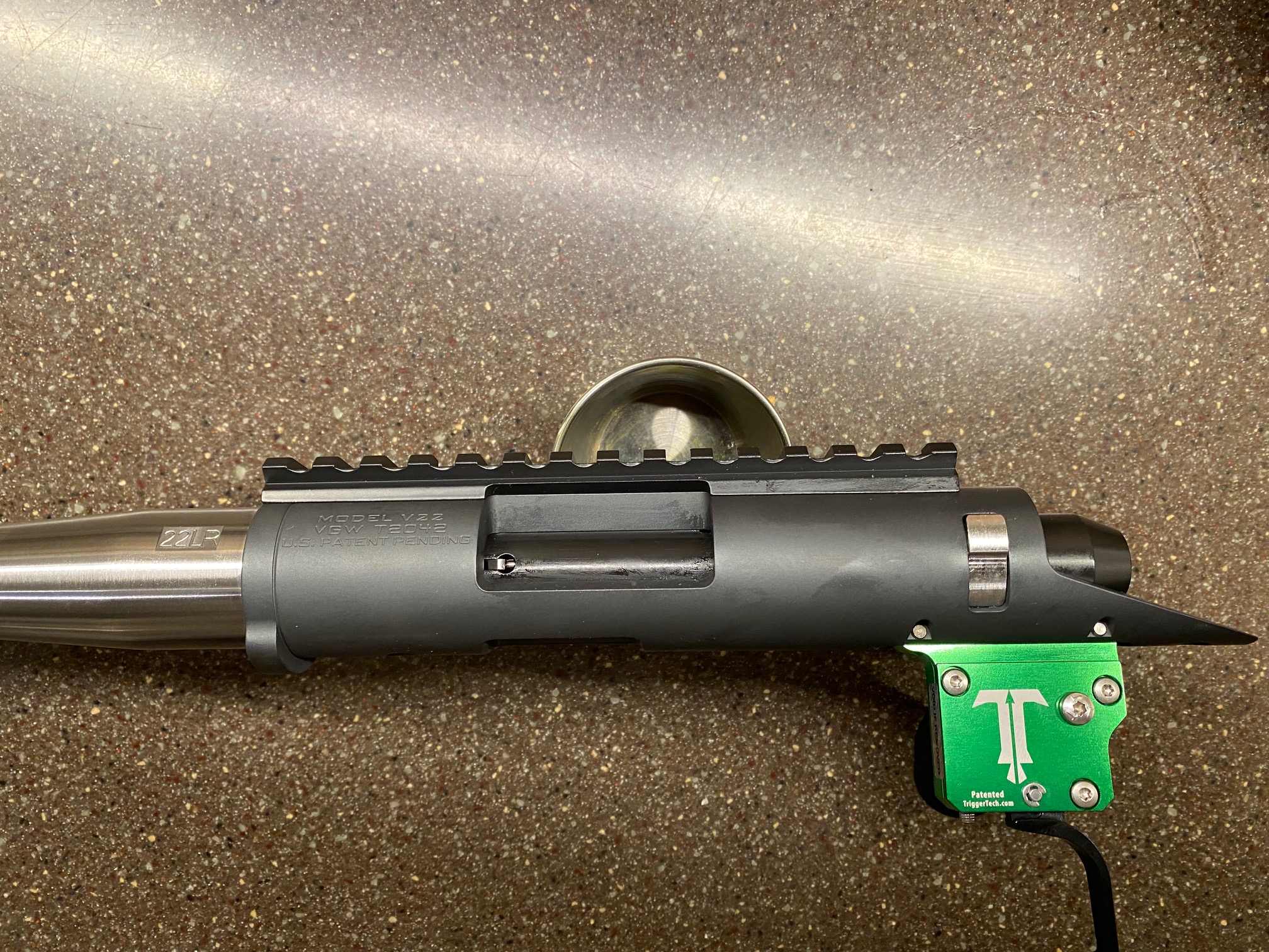

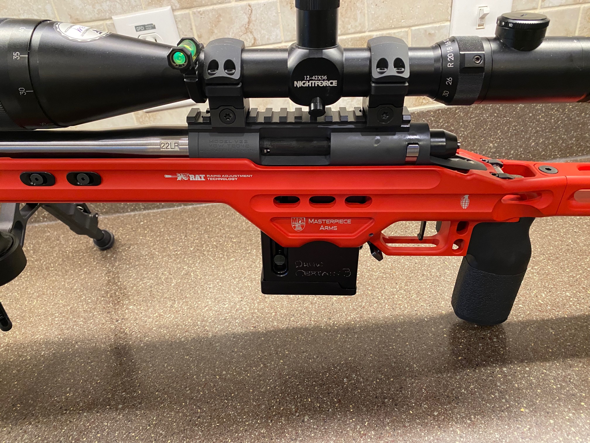

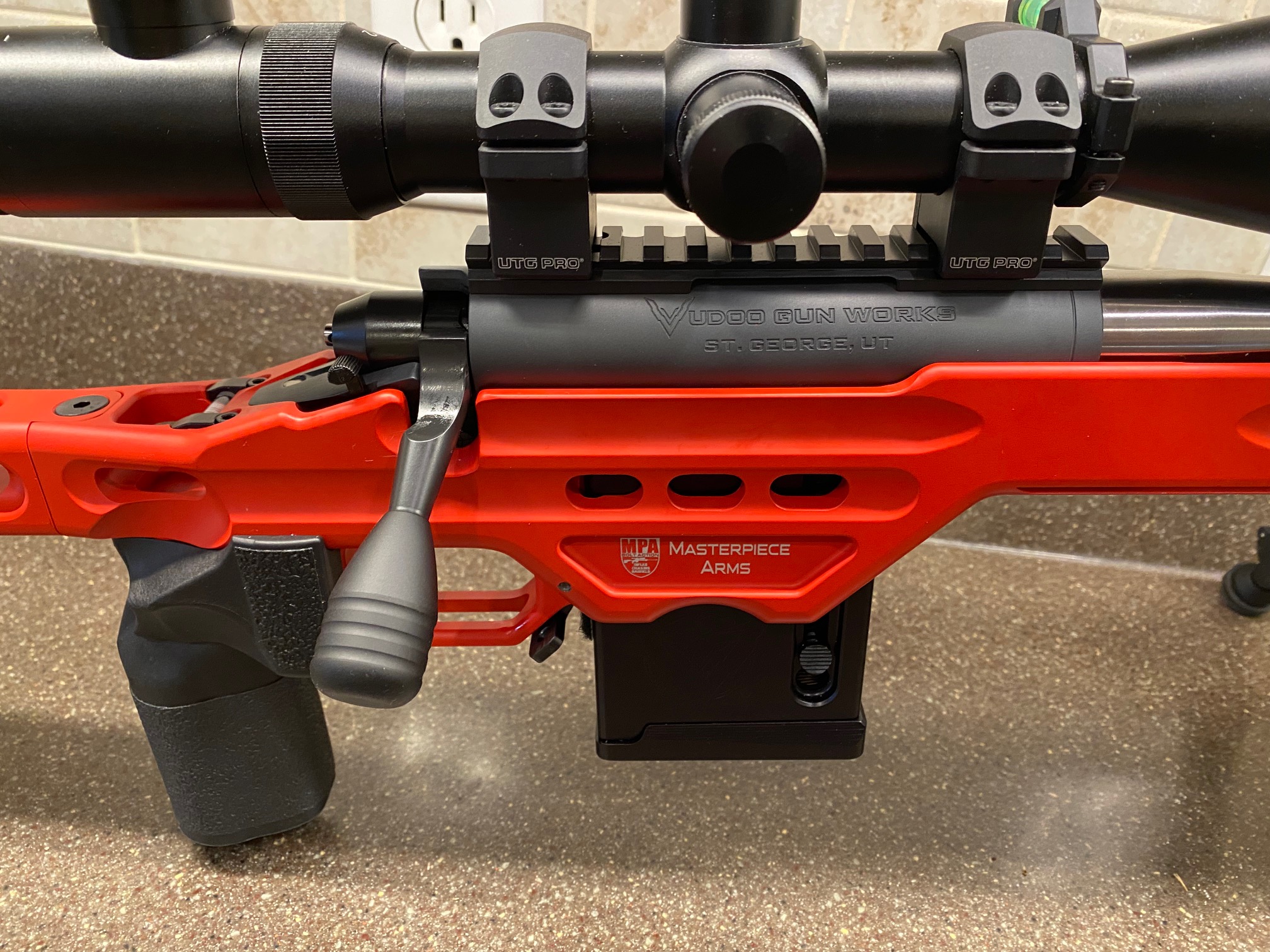

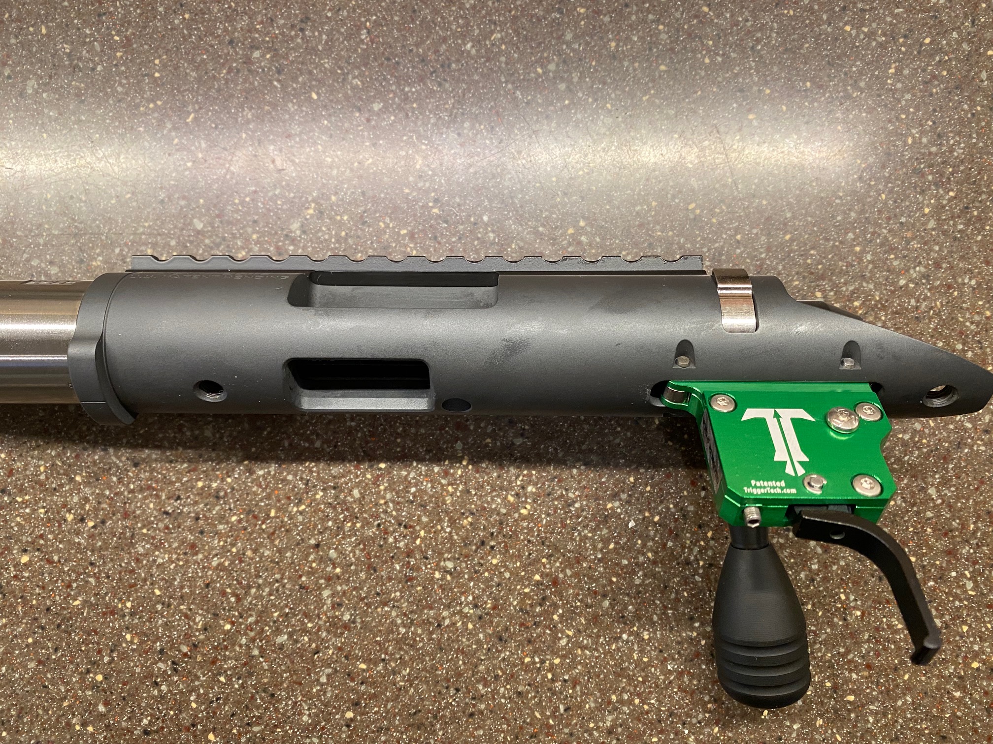

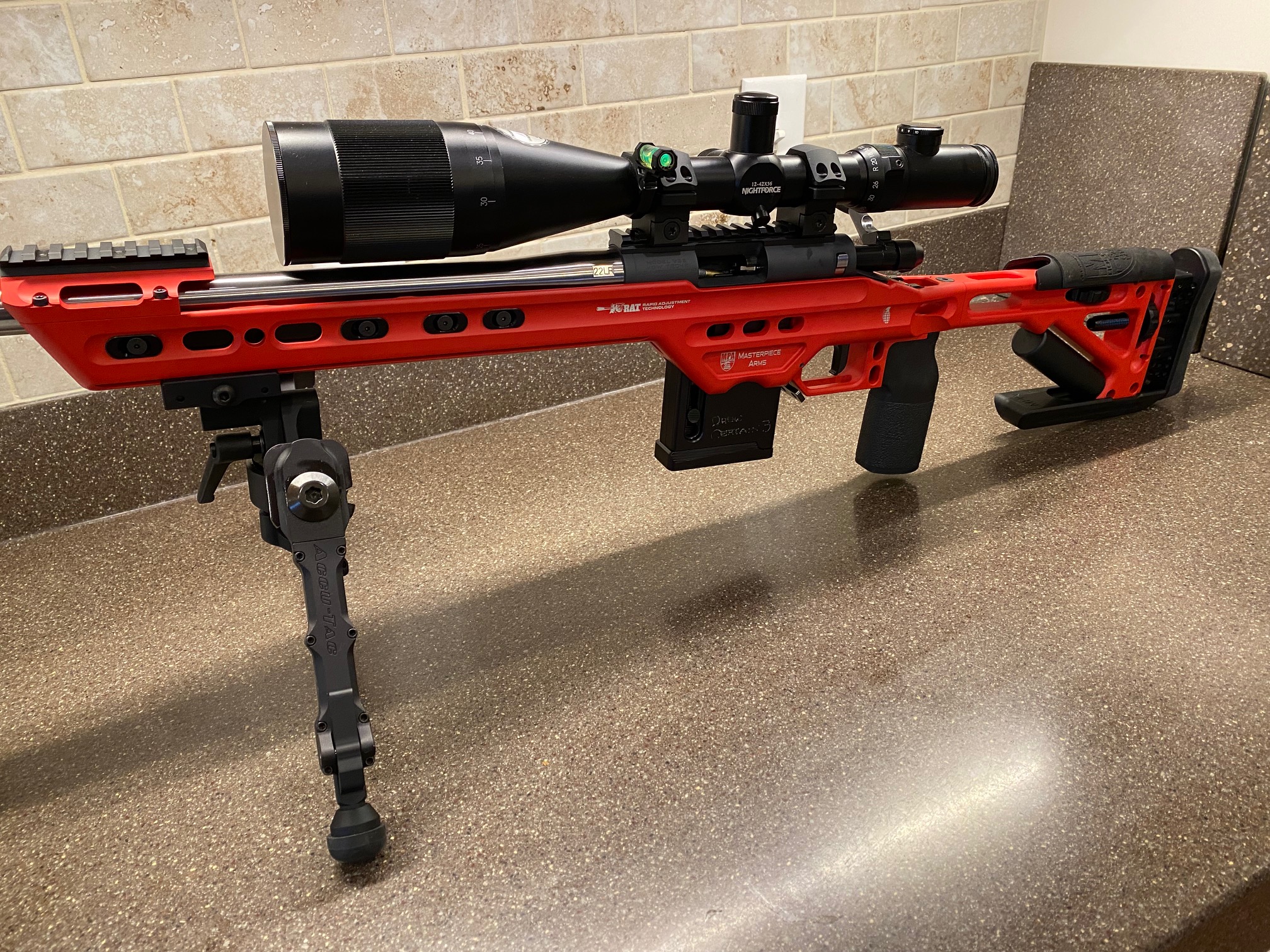

Good afternoon Vudoo Friends.
I have posted some of this on the Single Shot Thread. But it really belongs here. The Repeater Thread....
Well, I loved my RBLP V22S Single Shot so much that I wanted a repeater in that set up. I love being able to look into the chamber without having to stand on my head to do so. I like being able to see when mags are empty... Ordered the 3-60 RBLP Repeater Mid-June and it arrived Wednesday this week. It looks great. I got it set up in an MPA BA Comp Chassis. 20" Bartlein Barrel. Trigger Tech 2 Stage Diamond. I ran a mag full of Eley Match and it put them in and out nicely.
I was able to go shoot this morning. I will post the targets. Description is on the Vudoo Single Shot Thread.
Attached are some pics for your enjoyment...
Shoot straight and enjoy the ride.

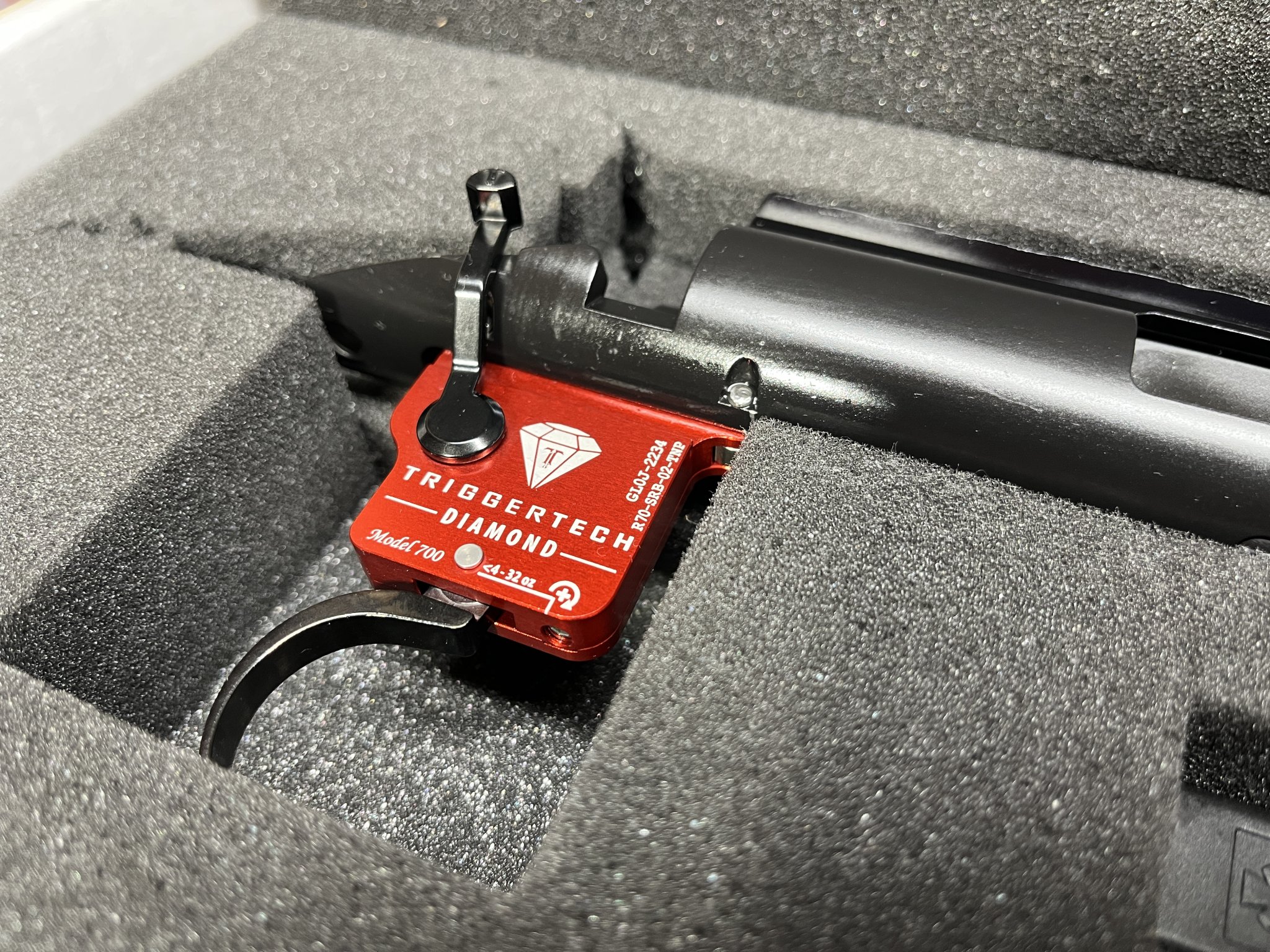

Pretty excited to see my V22 show a glimmer of life. Just installed my TriggerTech Diamond trigger. Scope, rings, bubble level enroute - 2500 rounds of Centre X in the mail. Grayboe stock won’t be here until March 🤦🏽‍♂️ It’s going to be a long winter

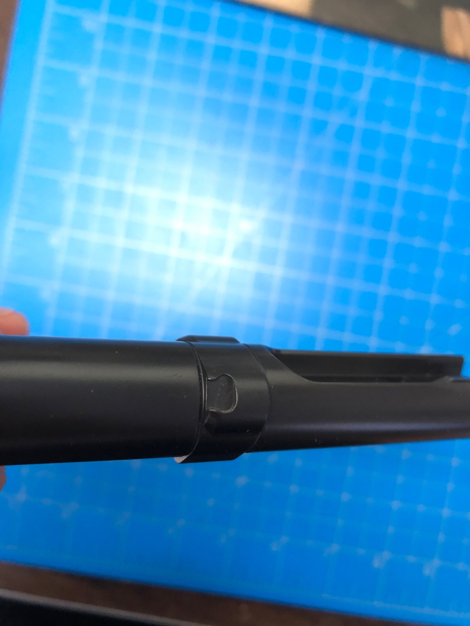

My V22 360 had an ejection issue with Laupa Center-X. By "stuck in the chamber" you mean it extracts the casing, but then bounces inside the chamber, not ejecting? It is a known problem with the 360 that only happens on some. Contact VGW. I sent my bolt in, they shaved off part of the lug on the bolt, allowing the bolt to go back farther so the casing hits the extractor more. It solves the issue. My turn around was a little under two weeks.

No, by stuck in the chamber I mean the brass remains in the chamber. As if the extractors don't have enough strength to pull the brass from the chamber after firing. Strange since its a controlled round feed so clearly the extractors fed the round into the chamber right?
I'll give the rifle its first good cleaning and respond back if this issue continues. Hopefully the cleaning will solve the issue.

The brass expands during ignition. It's just enough to get stuck in your tight chamber.
As said above, they're reamed for Lapua. Keep shooting it and it may clearance itself or call Vudoo and have them fix it. There's really no other solution unless you have your own chamber ream and know how to use it.
Check to make sure your extractor on your bolt isn't chipped and also that it's clean (no gunk underneath it).
