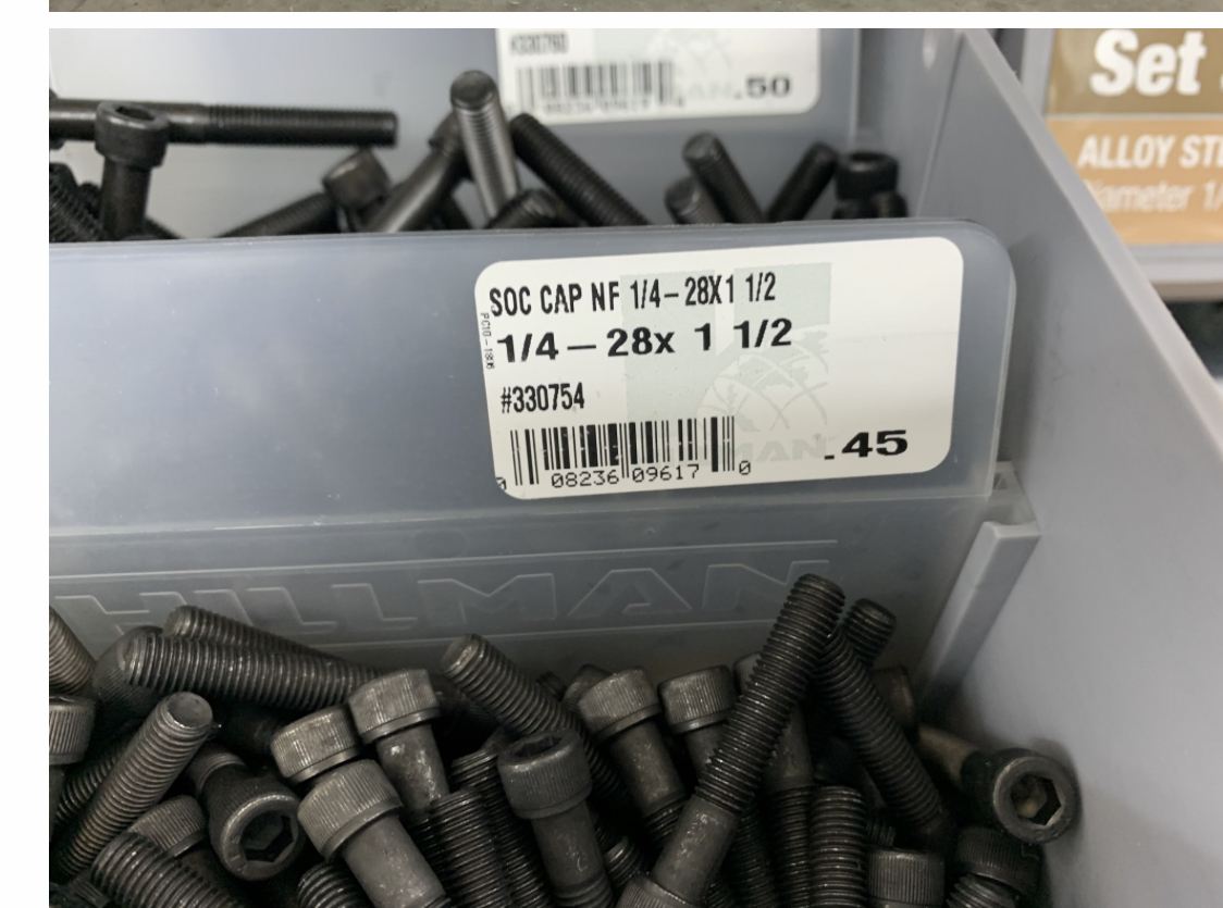

I've had to cut the socket head capscrews that come with the pillar kits that came with several stocks from various makers. They're seldom the correct length; nor have I been able to find the absolute correct length at various hardware stores. I usually wind up putting a cut-off wheel in my Dremel and cut the screws to the right length. Been doing this for years, and don't foresee a better solution, living out in the sticks in western Kansas - the drive to the nearest town with an ACE hardware store is 30+ miles, and it's 60+ miles to the nearest Fastenal - and with Biden's wonderful policies hiking the price of fuel up the way they have, jumping in the truck to drive for a couple of hours isn't just a matter of the time it takes. Our little autoparts store has some selection, and I'm glad they keep at least what they do have. I've looked through the catalog that Fastenal used to supply, as well as MSC's huge catalog, and if someone makes these screws in smaller increments of lengths that would make it possible to buy the exact length required, I haven't found them.
Reactions: fredfish
I picked up several lengths of this one from Ace Hardware as a trial and error.
