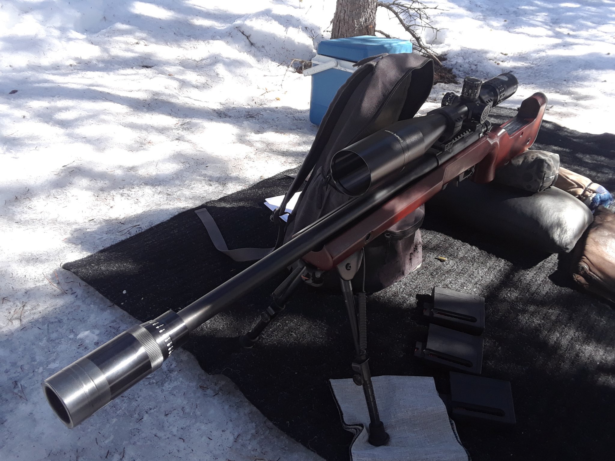

This is a long overdue post on my Vudoo 360. I made the decision to up my game on Dec 27, 2020 when I shot my first 400 score(Fclass 50yds).
I spoke to Mike a month later and the long wait began. The rifle arrived Nov 6,2021 and I shot it the same day and most days since. There were some teething issues with the trigger at about 800 rounds and it took a while to get a tuner on it. I finished off a stinker of a lot of SKPM and then started on a lot of SKRM. Yesterday the round count broke 10k. Now that things are warming up here and RIDING SEASON IS ALMOST OVER I may shoot some CenterX. I have 2.5 cases(8 lots) with four cases(4 lots) coming. Because of my remote location lot testing is not viable. I just buy by the case, tune it and shoot it always trying to get the best out of it I can. As far as I can tell I wouldn't be embarressed if I were to show up at a sanctioned match.
As you can see I have a Foundation stock, Harrell tuner w/weight, Harris bipod, a big ol' sack of rice at the back, a Nightforce 15-55 comp, a daypack catching the brass, and the ammo is in the cooler with 2 liters of boiling water. Oh yeah ... trigger is a Bix comp at 2 oz.

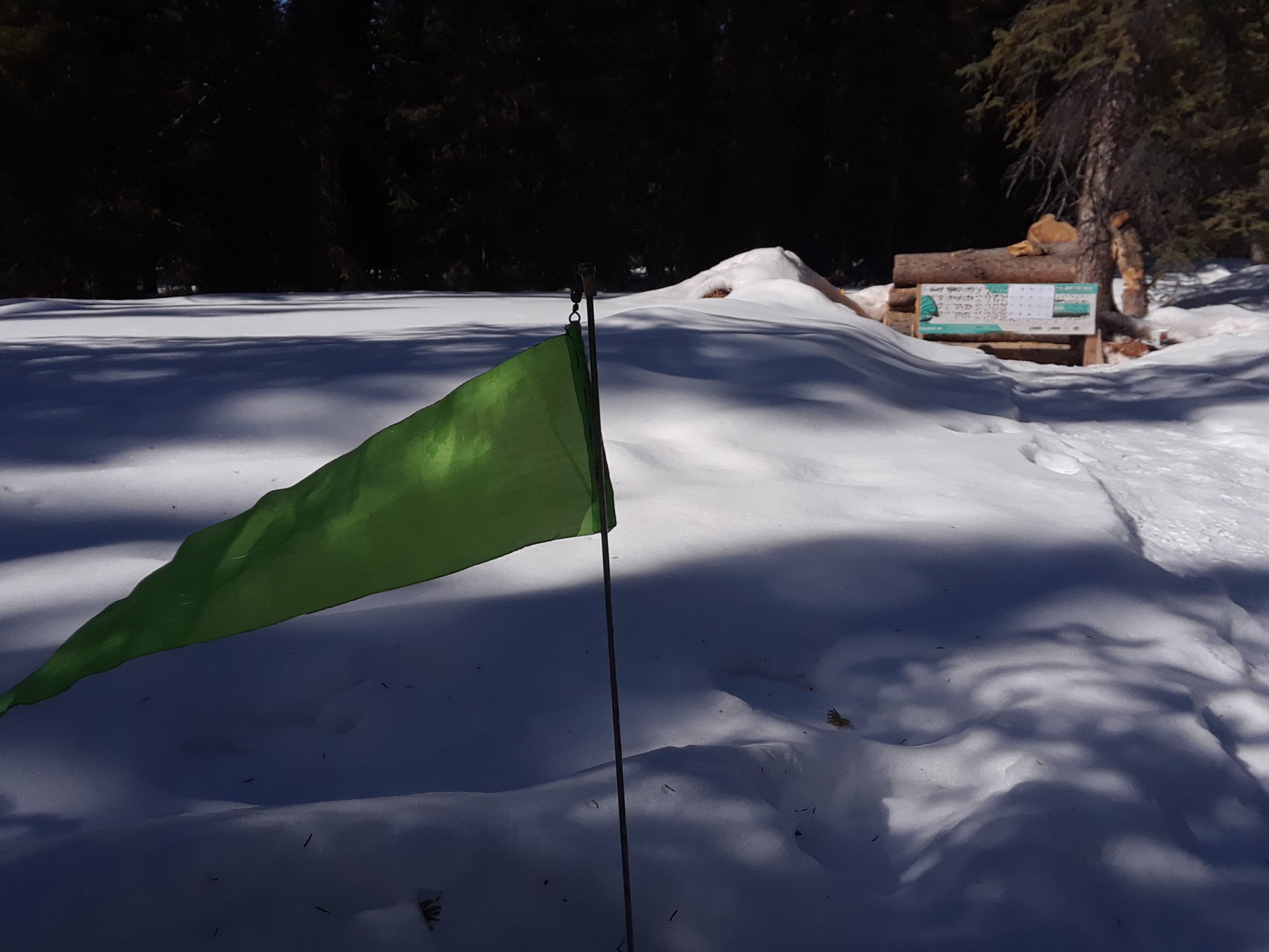

These are my home-made wind flags. A year ago I thought I'd never get the hang of flags ... I started with three and have worked my way up to five.

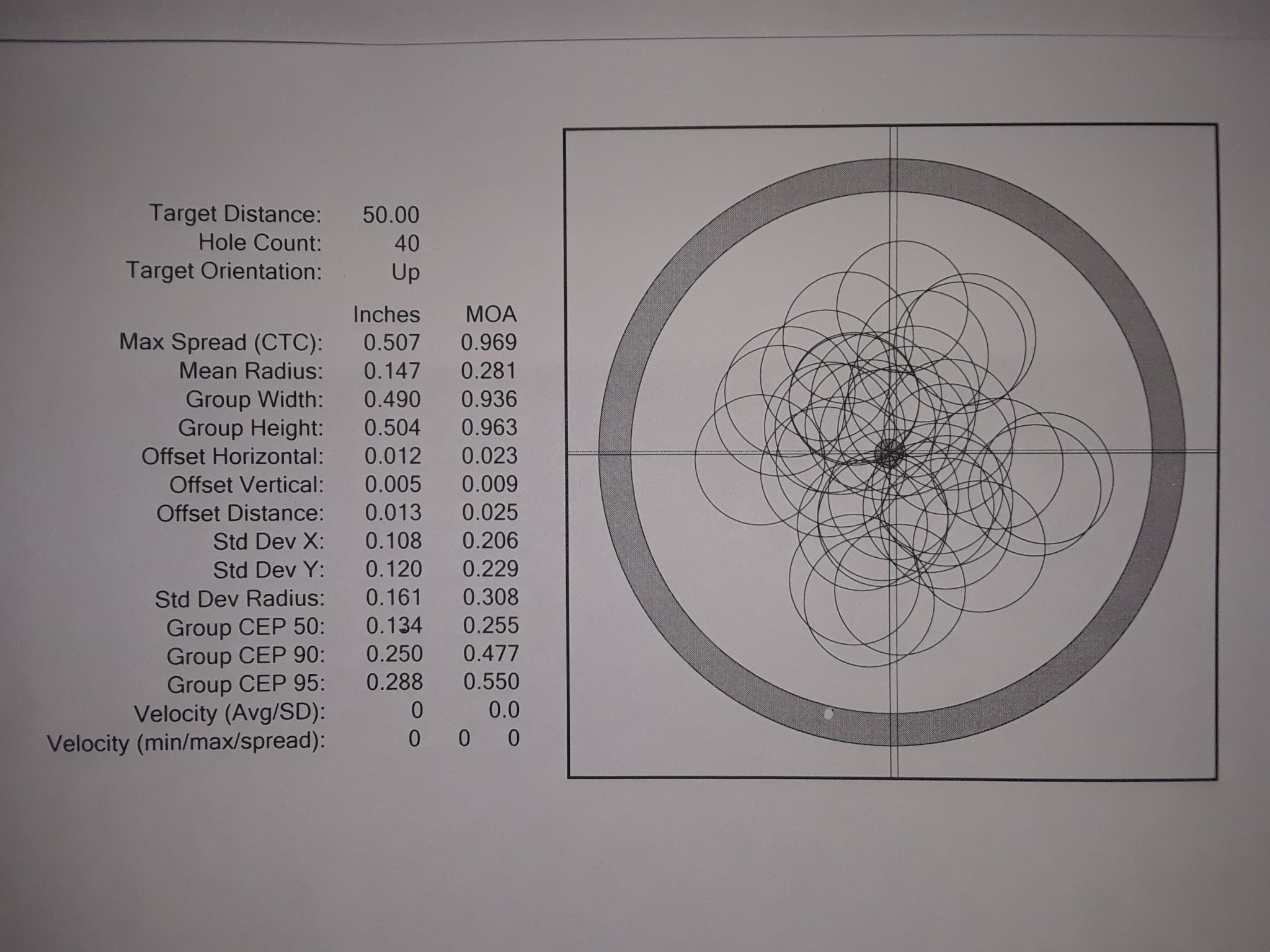

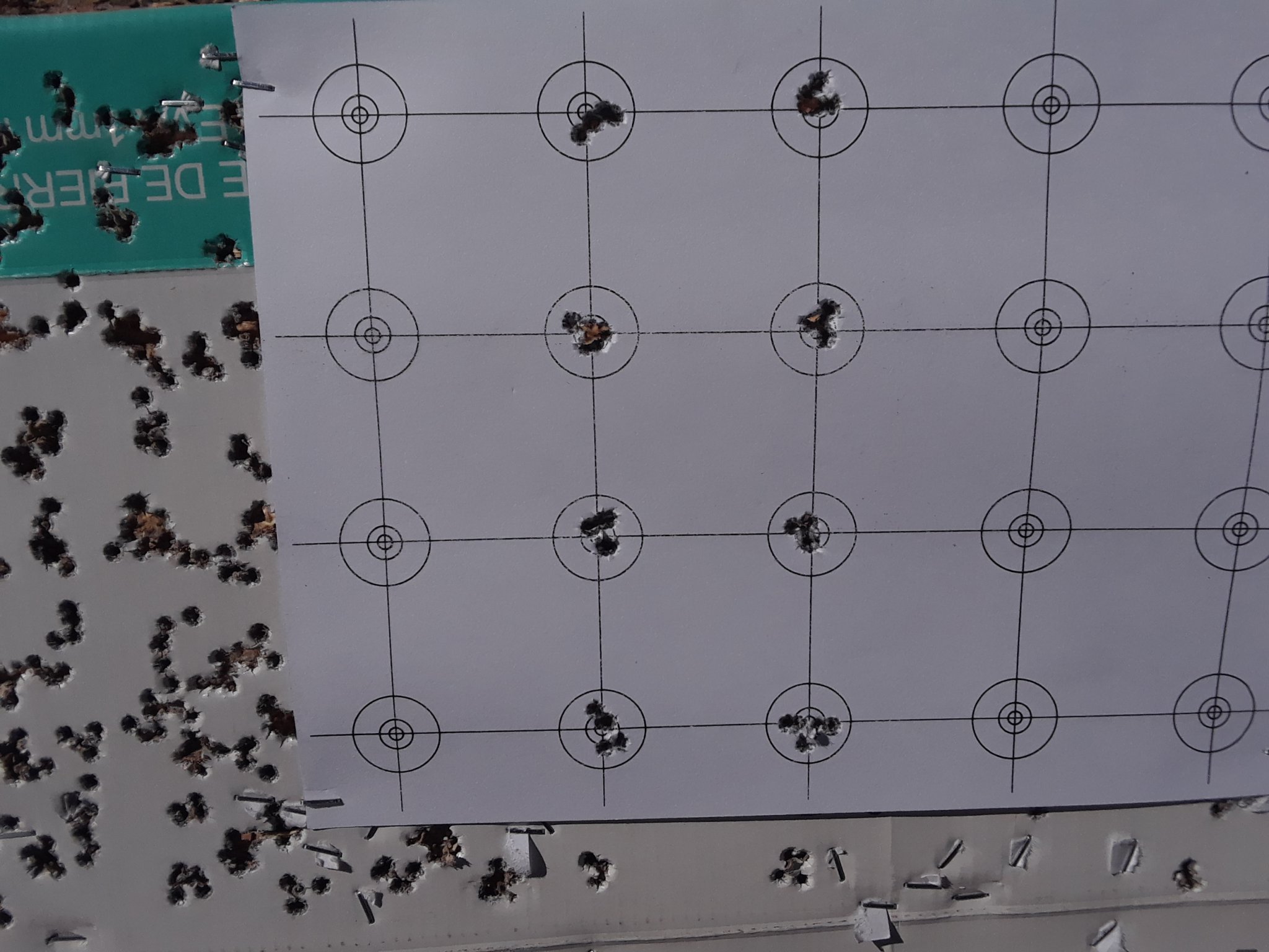

Todays target, another 400. The first one took one and half years, the second one six weeks (anschutz 64 mpr). There was a long drought while I endured the aforementioned stinker lot of SKPM and with this SKRM and my 360 they are a weekly occurrence. Over time I have evolved from measuring groups, to groups and score and now I do score and 40 shot composite group as created in OnTarget as seen below. The large ring on the target is about .9 inches in diameter. The innner rings on the composite are nearly to scale.
That is about as pretty as it gets for me. I sometimes see the mean radius down to .125 but if my scope zero is off I can still drop a point. This 40 shot group measures 18.4mm outside to outside for comparison to Lapua test center results. I feel this shows I have a good tune, the rifle is consistent, I'm not effing up too badly and this is about the best I can expect of this lot of SKRM.

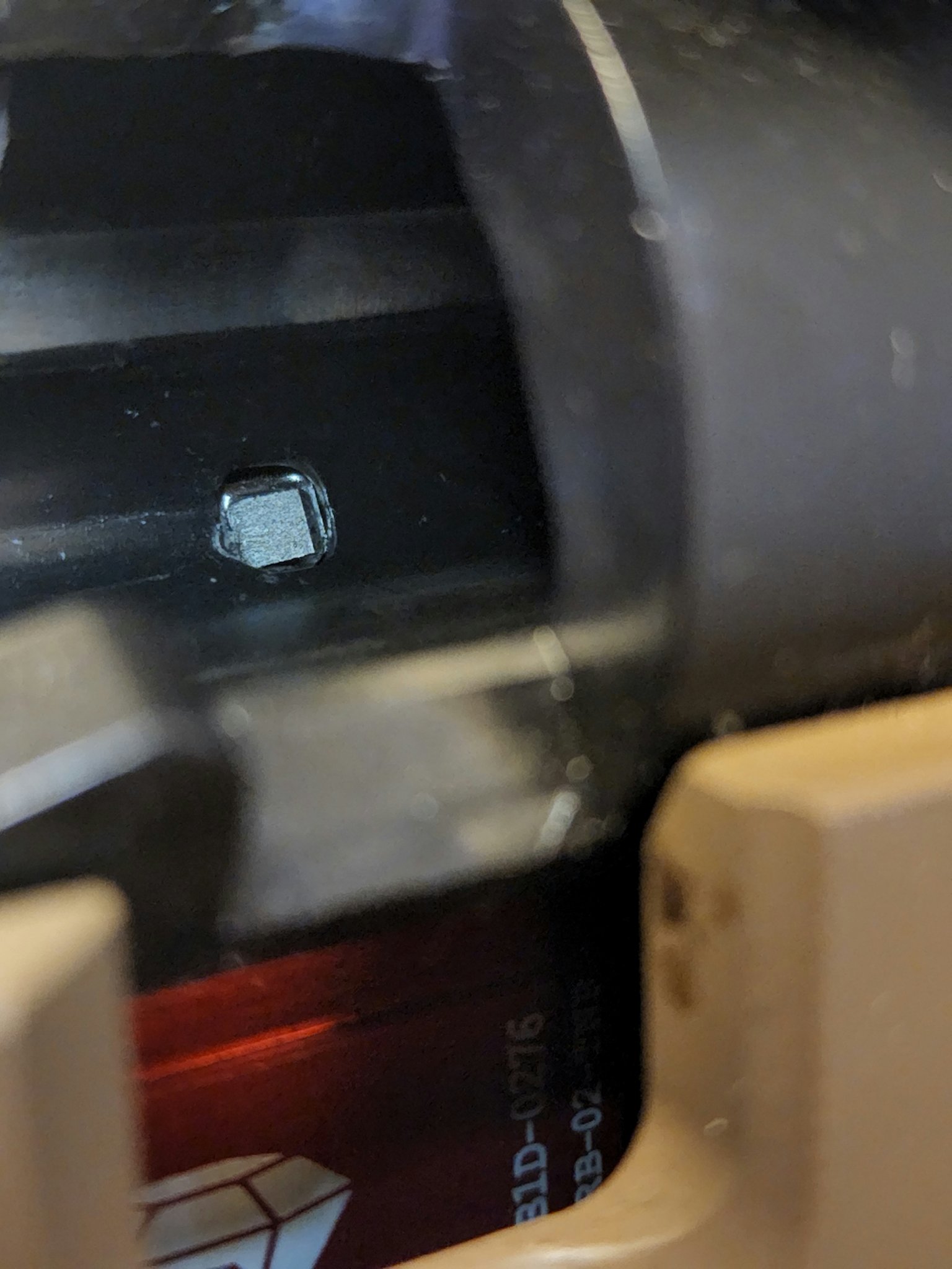

Just took my Vudoo Three60 out of my case after coming back from a match, looks like the bolt stop sheared off?
What's the warranty process like for someone in Canada? Is it possible to just get a bolt stop shipped up and fix it myself or would I have to send the action out? Going to be sending emails out to Vudoo and GBT (Canadian dealer) but since it's Easter weekend I'm not expecting replies until Monday. I have a match in two weeks so I just want to know if I need to spend my weekend sourcing another rifle or if it can be fixed in time. Does anyone know how long the turnaround time is on a fix like this (estimate)?

Easy change. Call them up tomorrow morning and they will send a few out to you.

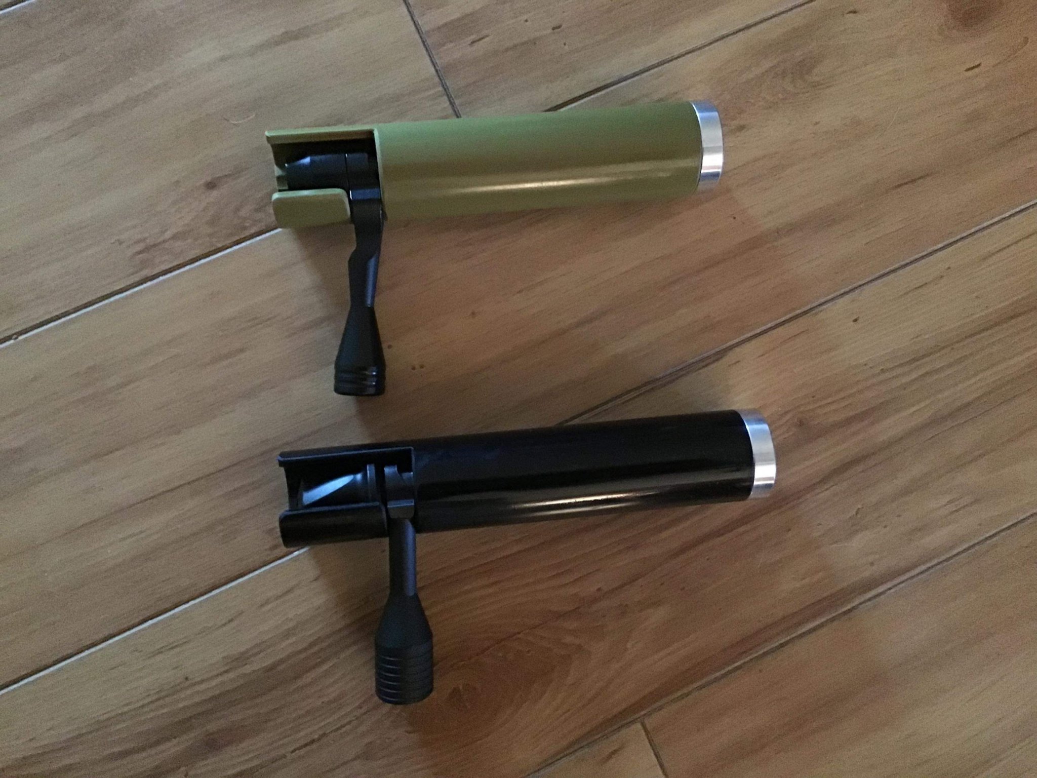

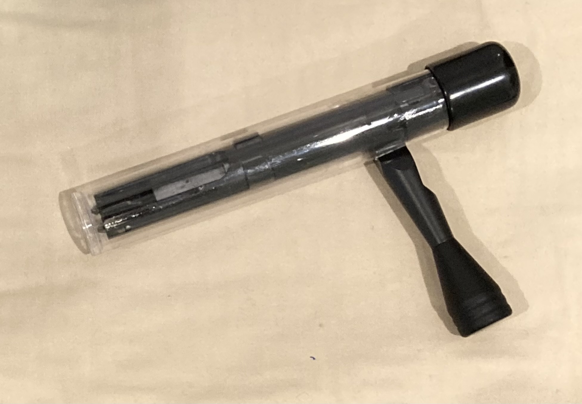

I'm getting ready to put my LH 360 in a hard case for transport and I'd like to do it with the bolt removed. Does anyone know where I can find a left handed bolt protector / holster to keep the bolt from picking up "stuff" in the case?
Thanks, Don
I use these cheap parts from Amazon to make bolt protectors for my Vudoo and Anschutz... just cut a slot in the clear plastic with an X-acto knife for the handle, and slip on the rubber cap.
Amazon product ASIN B07PDBD9QW Amazon product ASIN B07N4Q5YZ6

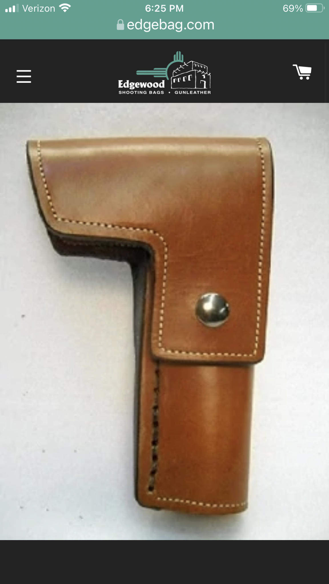

Thanks, Don

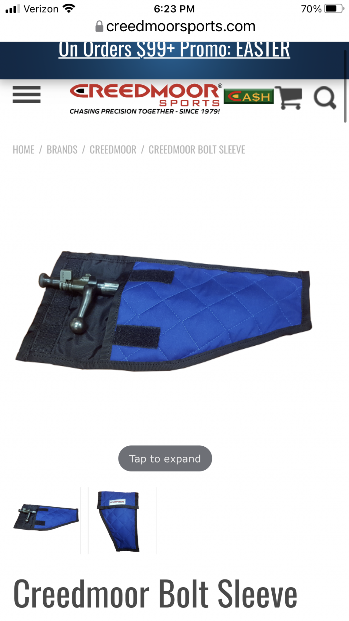

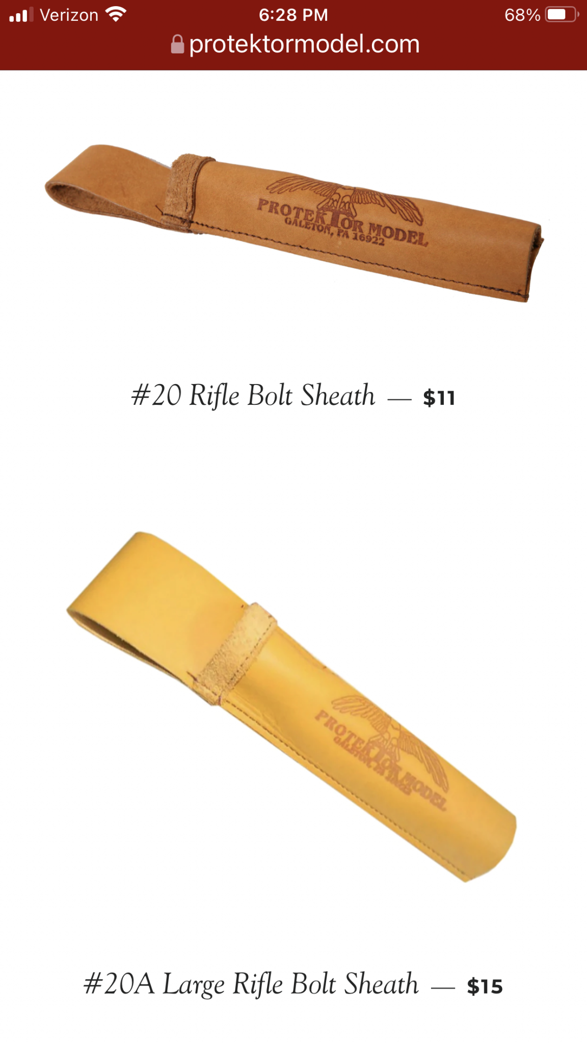

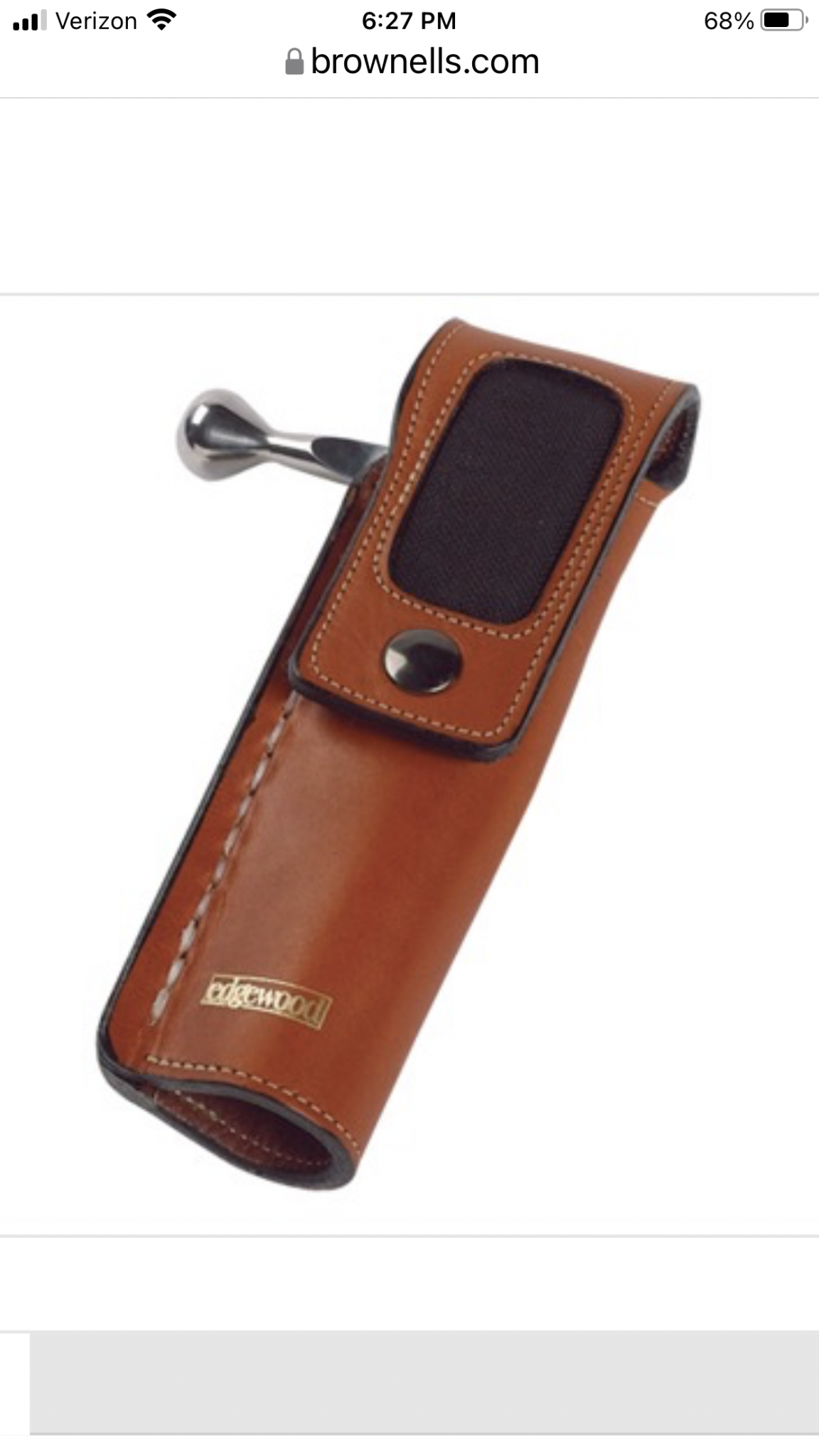

Creedmore , Edgewood and protector have them .Amazon also has other brands of cheaper bolt holsters

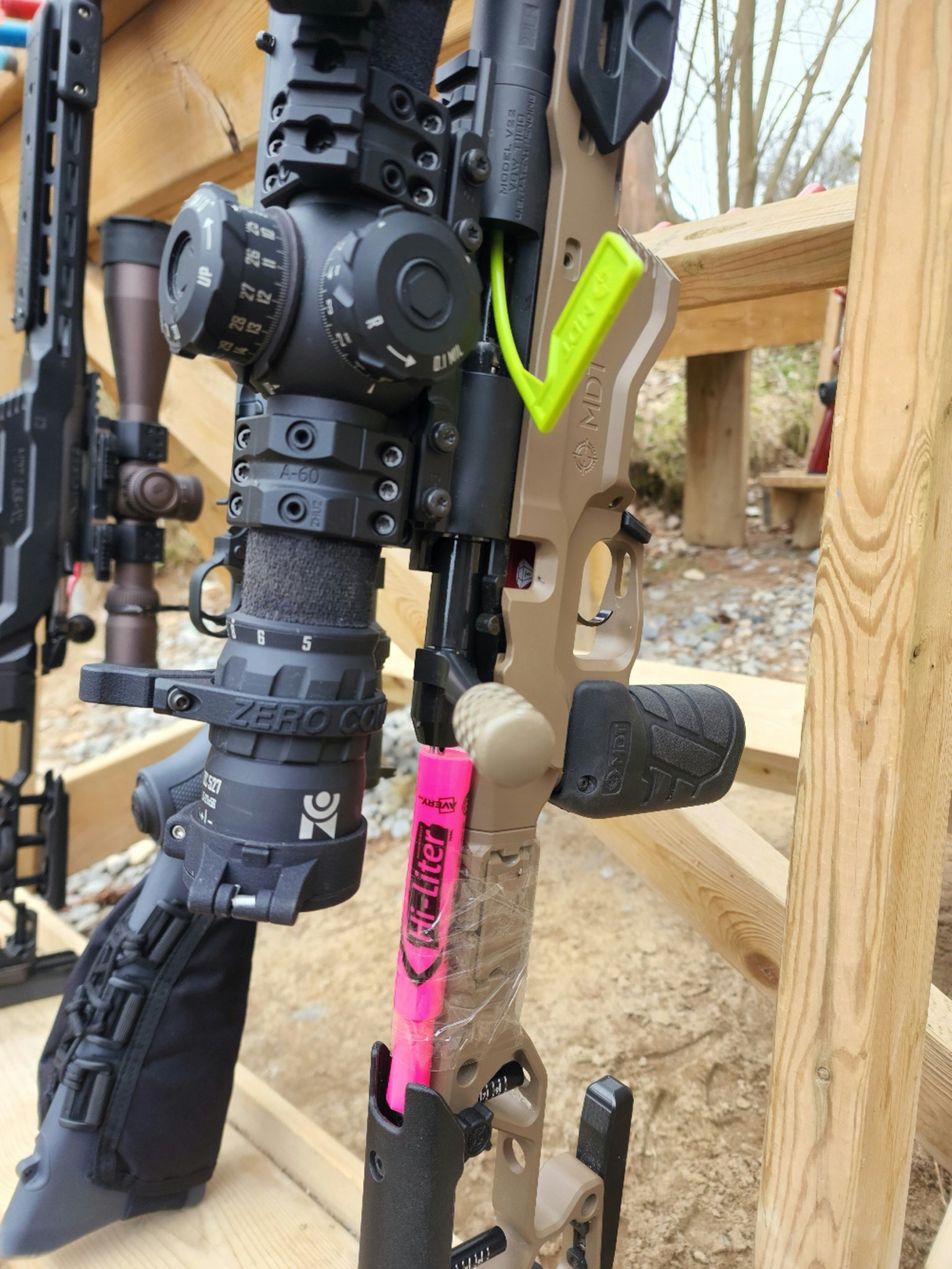

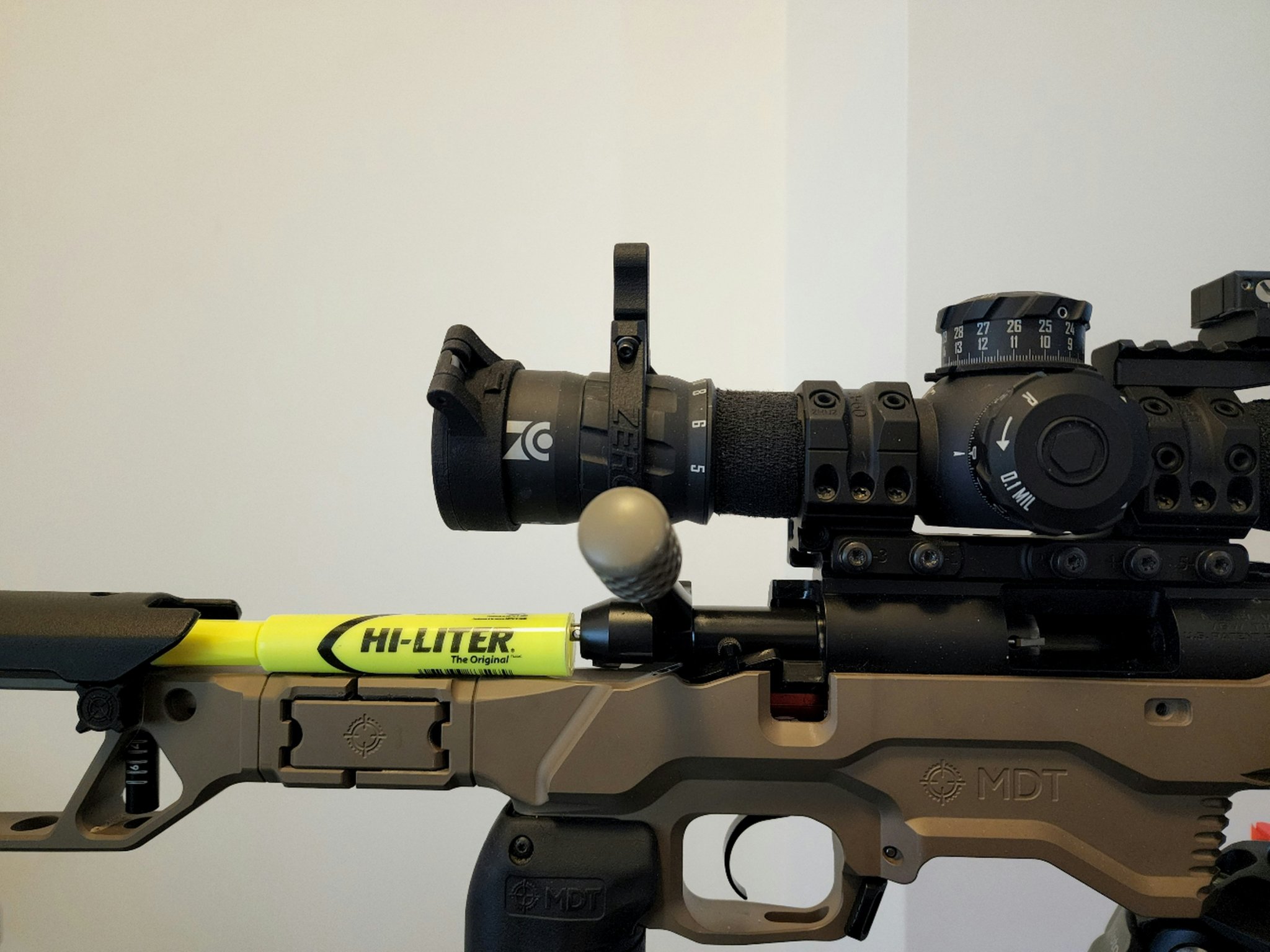

Update to my broken bolt stop.
VGW is sending me a replacement bolt stop as a temporary fix as their permanent solution requires me to send my action out to their Canadian gunsmith. Apparently the bolt stop wasn't heat treated properly. Doesn't look like the bolt stop will arrive before my match this weekend so I had to come up with my own solution...
A hi-lighter is the perfect length to act as a bolt stop when paired with a MDT ACC. 5 figure rifle with a $1 fix.

This happened in one of our matches and we taped the empty Sk/Lapua cartridge holder to the chassis. It worked great.

Love the temp repair

You claim to be Canadian, yet no duct tape in the repair?

Can't tape it yet since it has to be folded in order to fit inside my case. Can't wait to see the looks I get when I pull out a roll of tape on the firing line this weekend.
Debating if I should use duct tape or packing tape. Going to switch it to a pink hi-lighter since they taste better

Just use some vet wrap and make it part of your chassis decorations.
Update: Pink hi-lighter worked perfectly yesterday and I walked away with 1st place open at my local club ORPS match (Canadian NRL22). I think almost everyone asked me why the heck I had a hi-lighter taped on. One guy thought my folding stock was broken.
Now EVERYONE is gonna tape a pink Hi-Liter to their rifle. Until they start arguing about which color is better...
