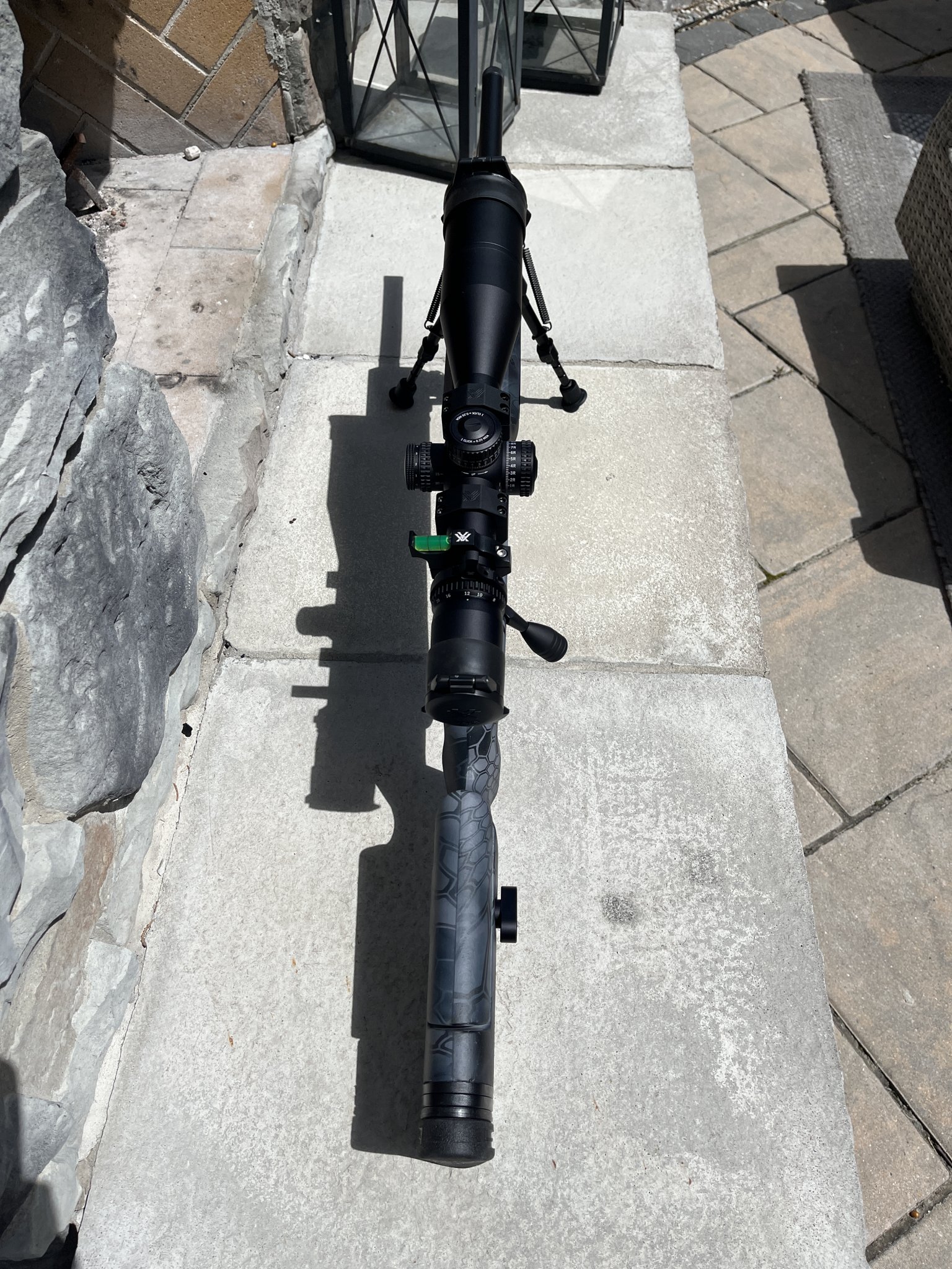

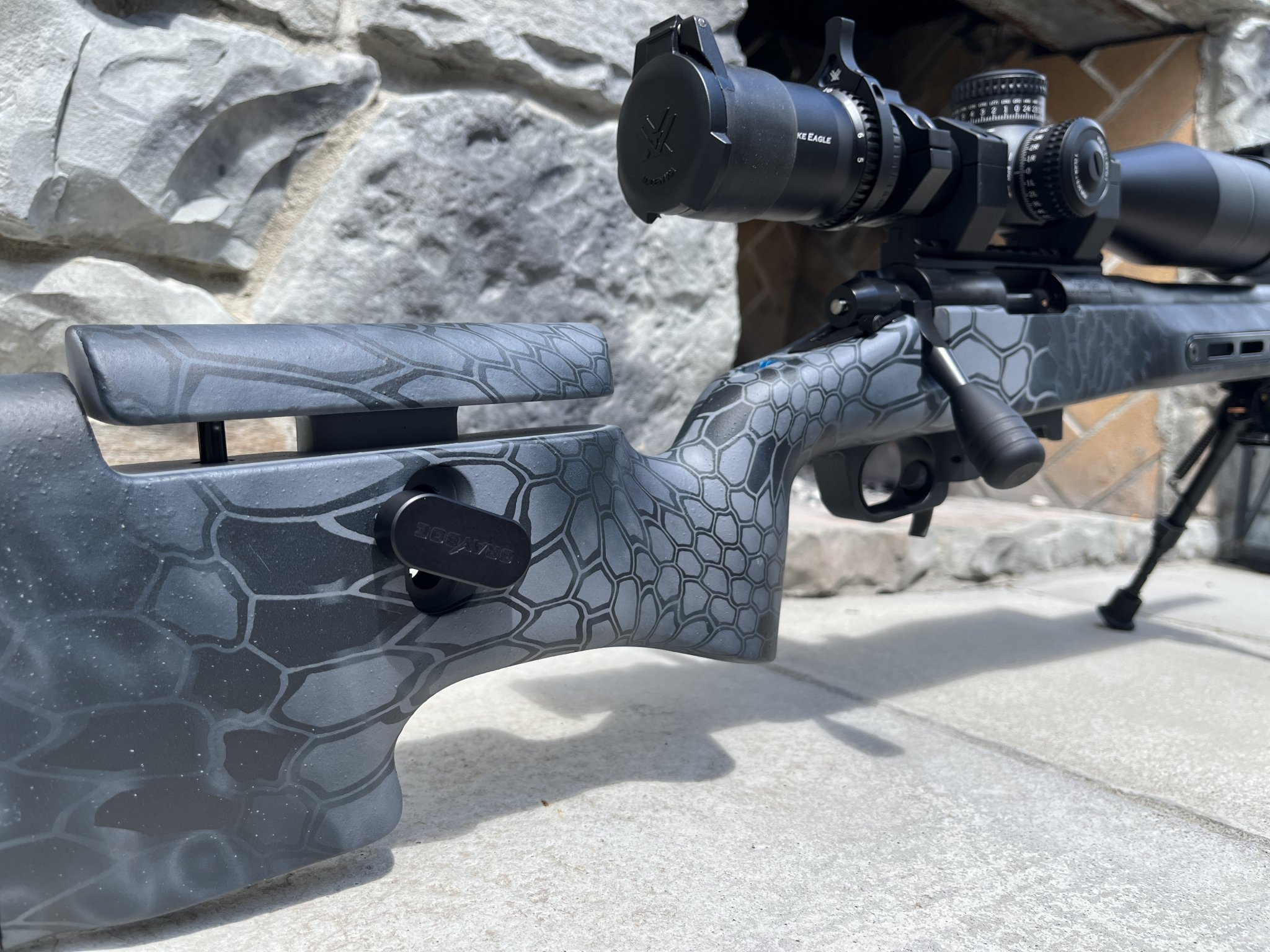

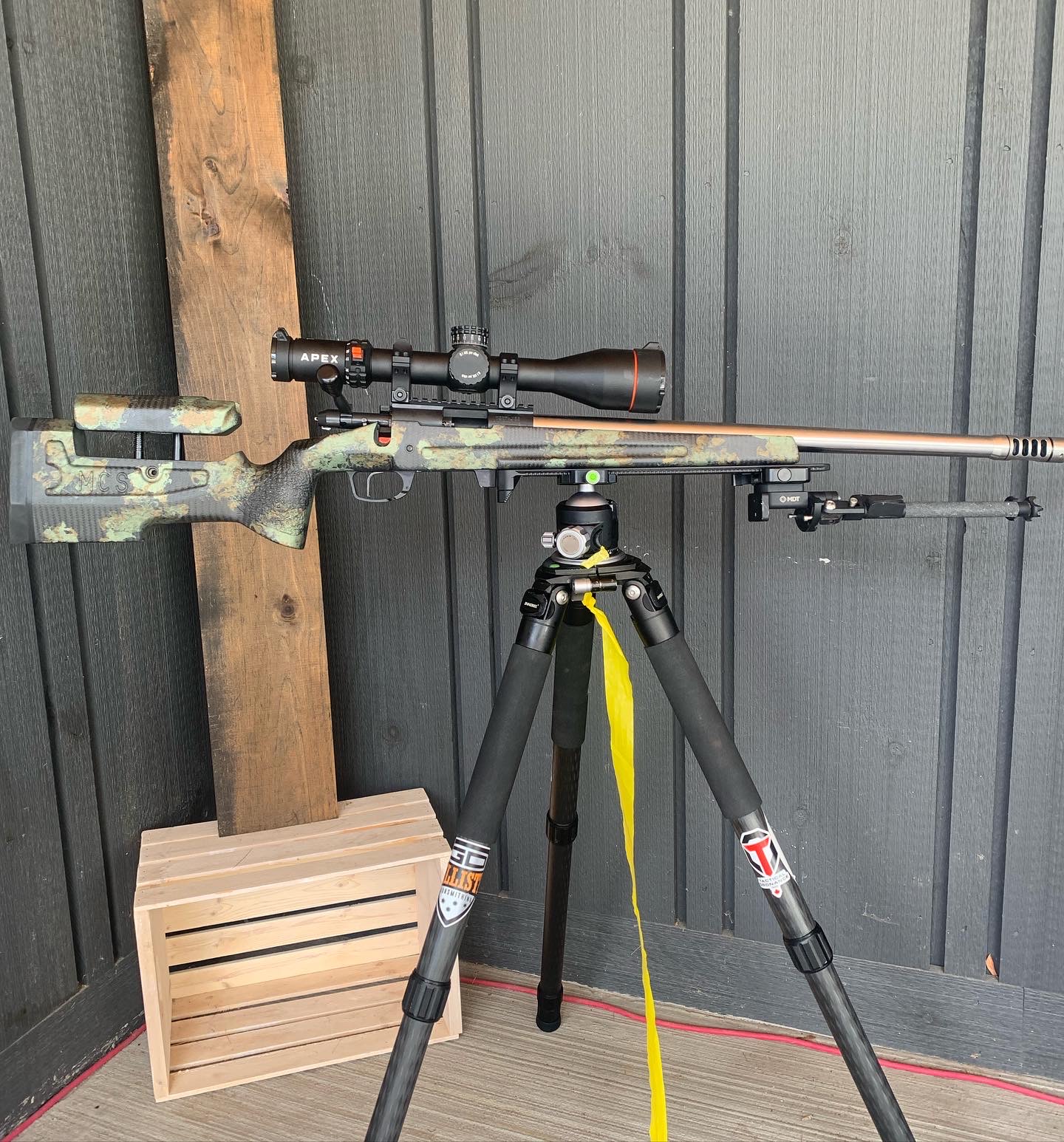

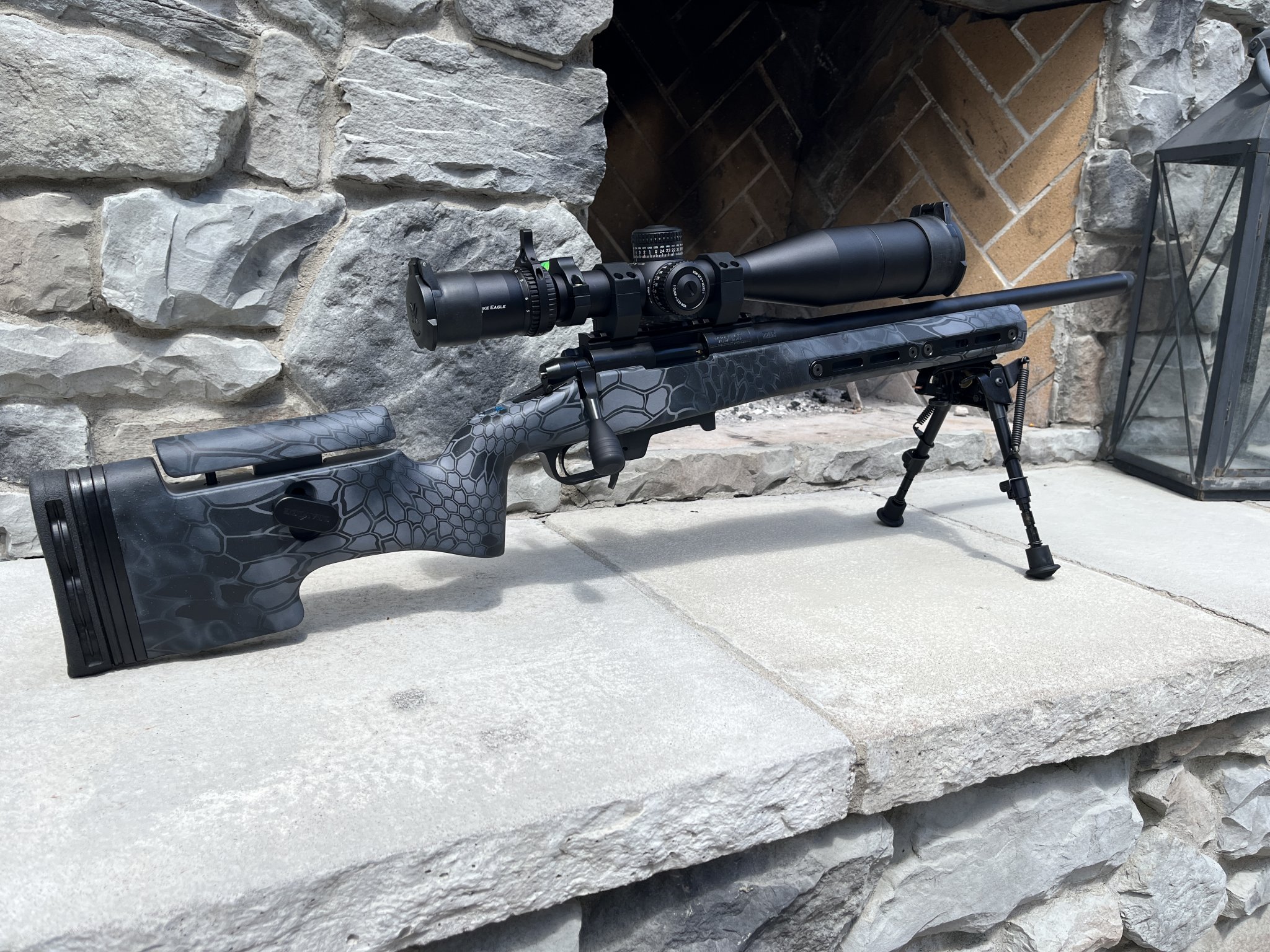

Just wanted to share my excitement. I finally have my V22 together (hand tight) after 8 months of waiting. Grayboe stock was the hold up, mixed with crossing into Canada… but she’s finally here.
View attachment 7922199View attachment 7922200View attachment 7922203View attachment 7922206
Congratulations! That’s a great looking rifle, I like the color scheme on your stock. I just received my Vudoo about two months ago and it was about an 8 month wait. Your going to love shooting this rifle! As far as the magazines go, at this point, I have not had many issues with them yet. I do take my time loading them and that seems to help quite a bit. I‘ve ordered some aluminum mags, so I‘m looking forward to seeing if there is a difference.

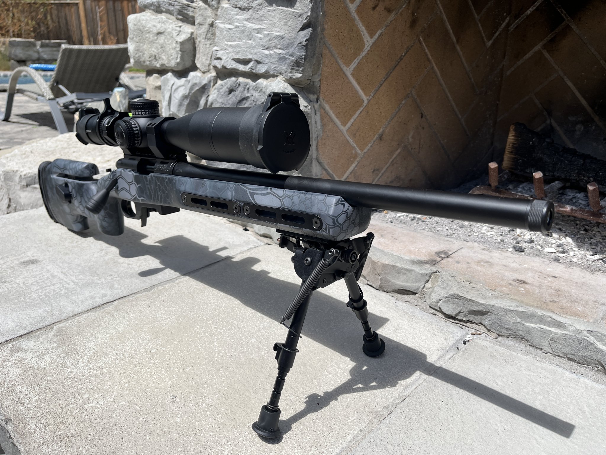

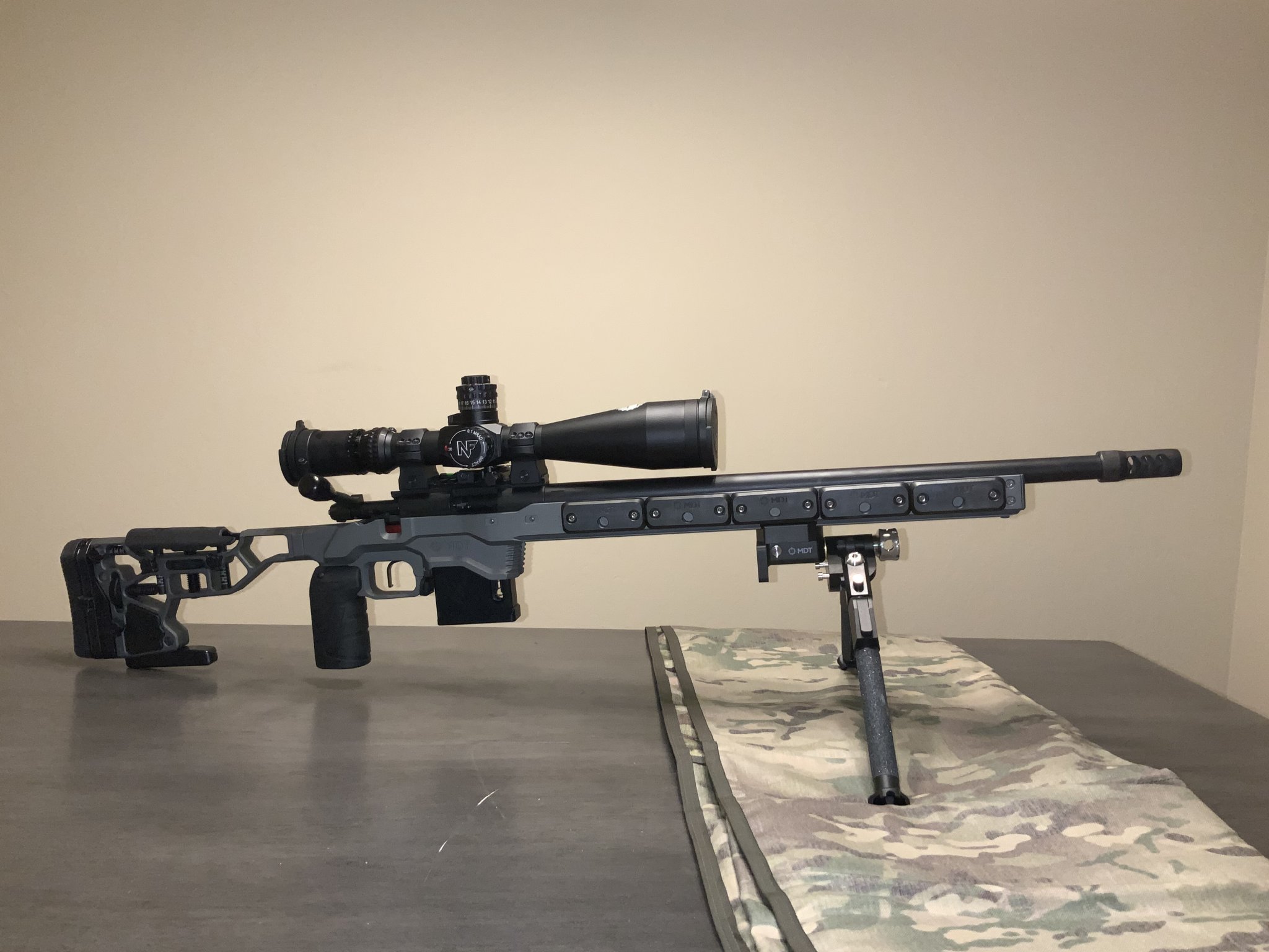

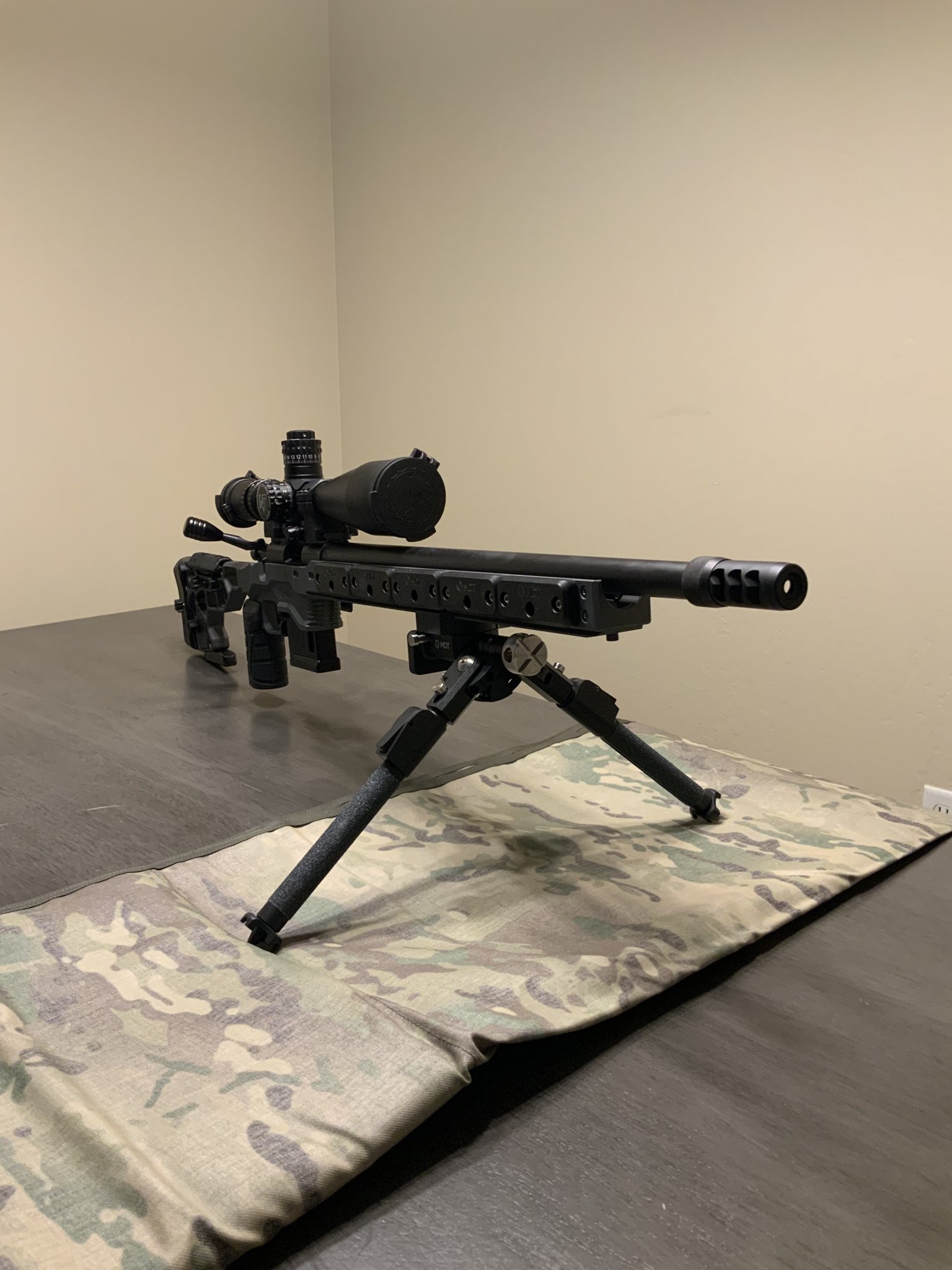

Joined the Vudoo club.
When you’ve got a TT diamond 2 stage just sitting around and a good deal on a V22 18” Kukri pops up in the PX. This place is hard on the bank account haha. Thought I’d try a Bravo and swapped the MK5 off my SPR to get out and shoot it.
Nice set up! Your going to love it! I guess I need to post a pic of my Vudoo.

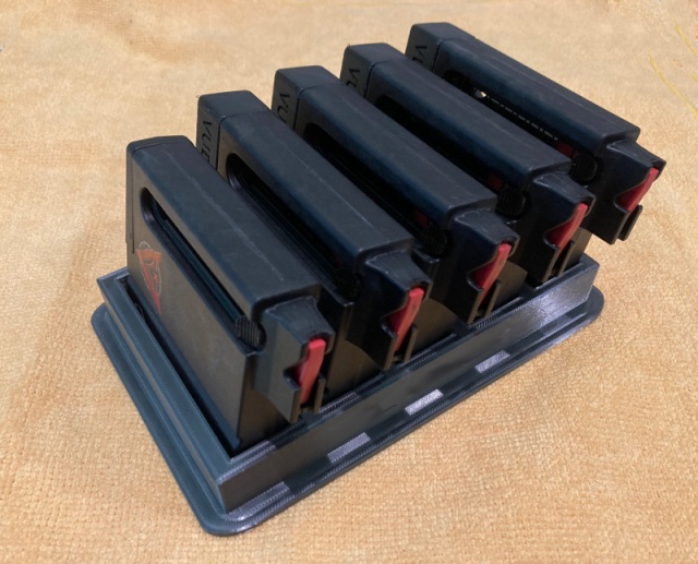

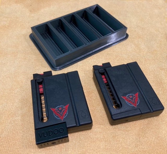

Here shows my setup for the bench at matches that require 5 mags... my warmup/sighter mag as standard 10-rounds, my other four with the extension to hold one extra round in case of a mis-fire. Have never had a feed failure caused by the extensions.

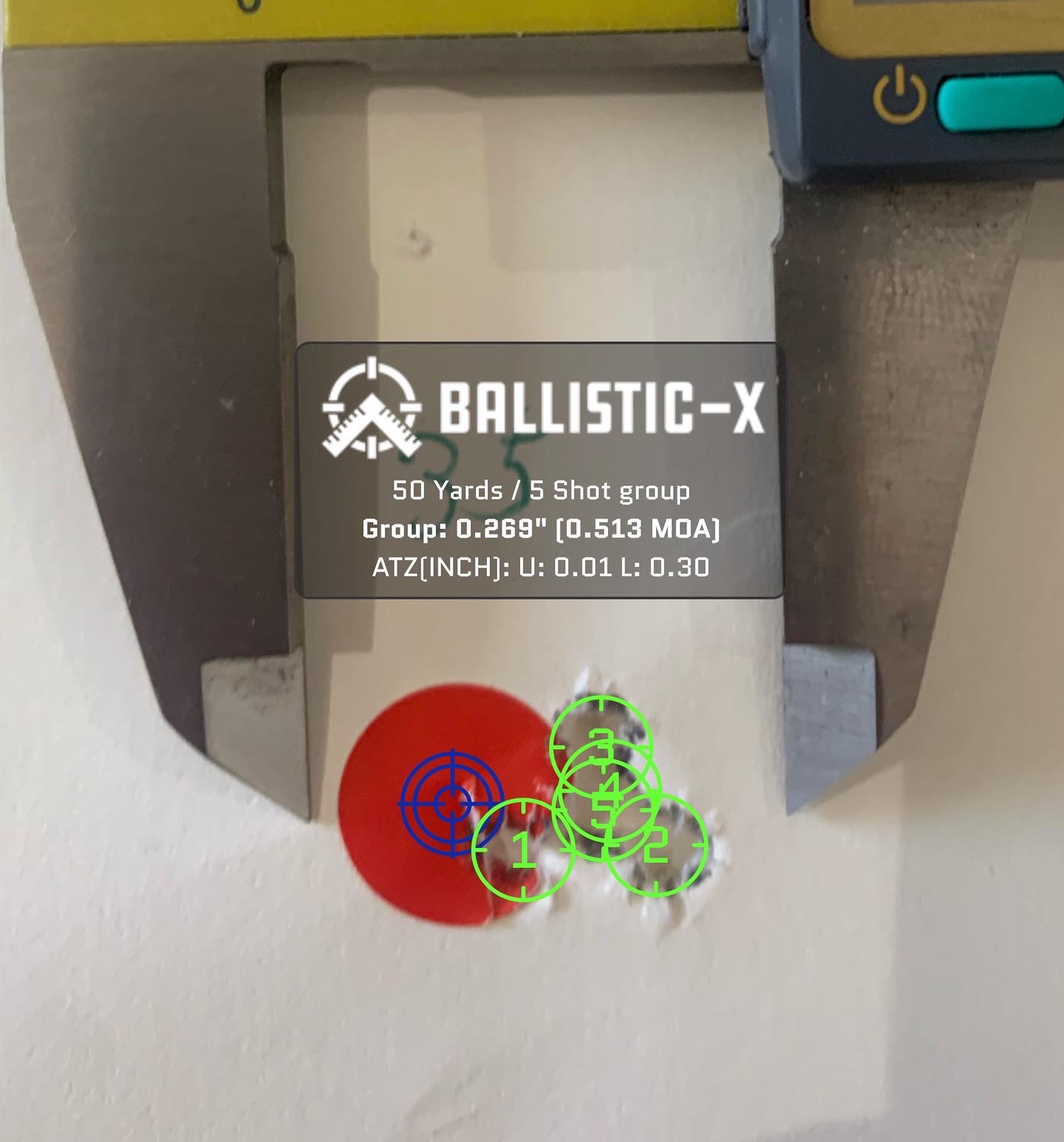

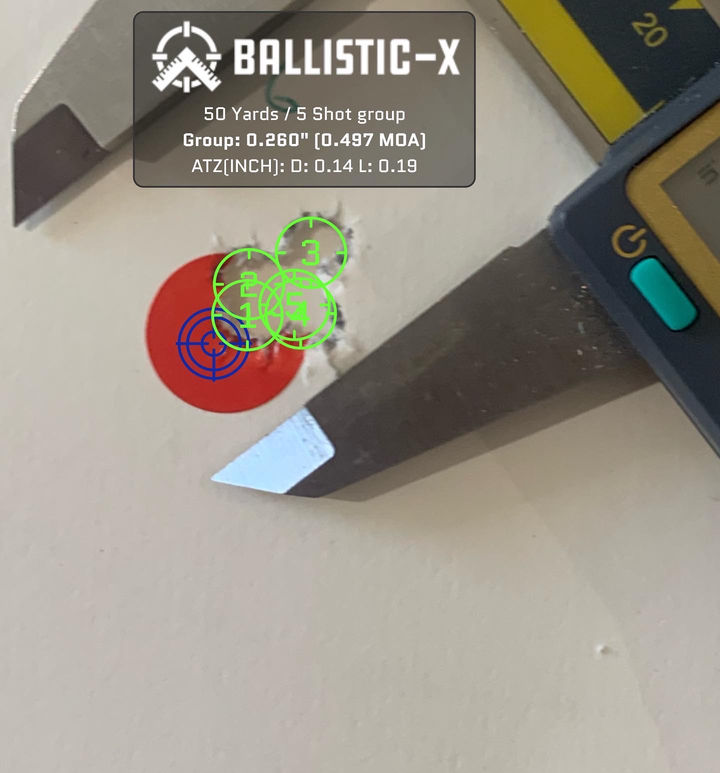

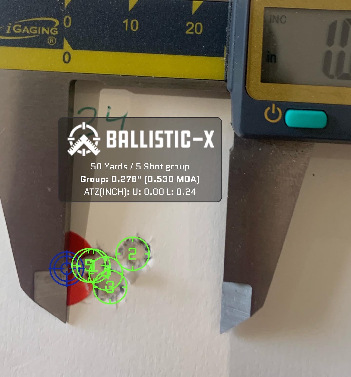

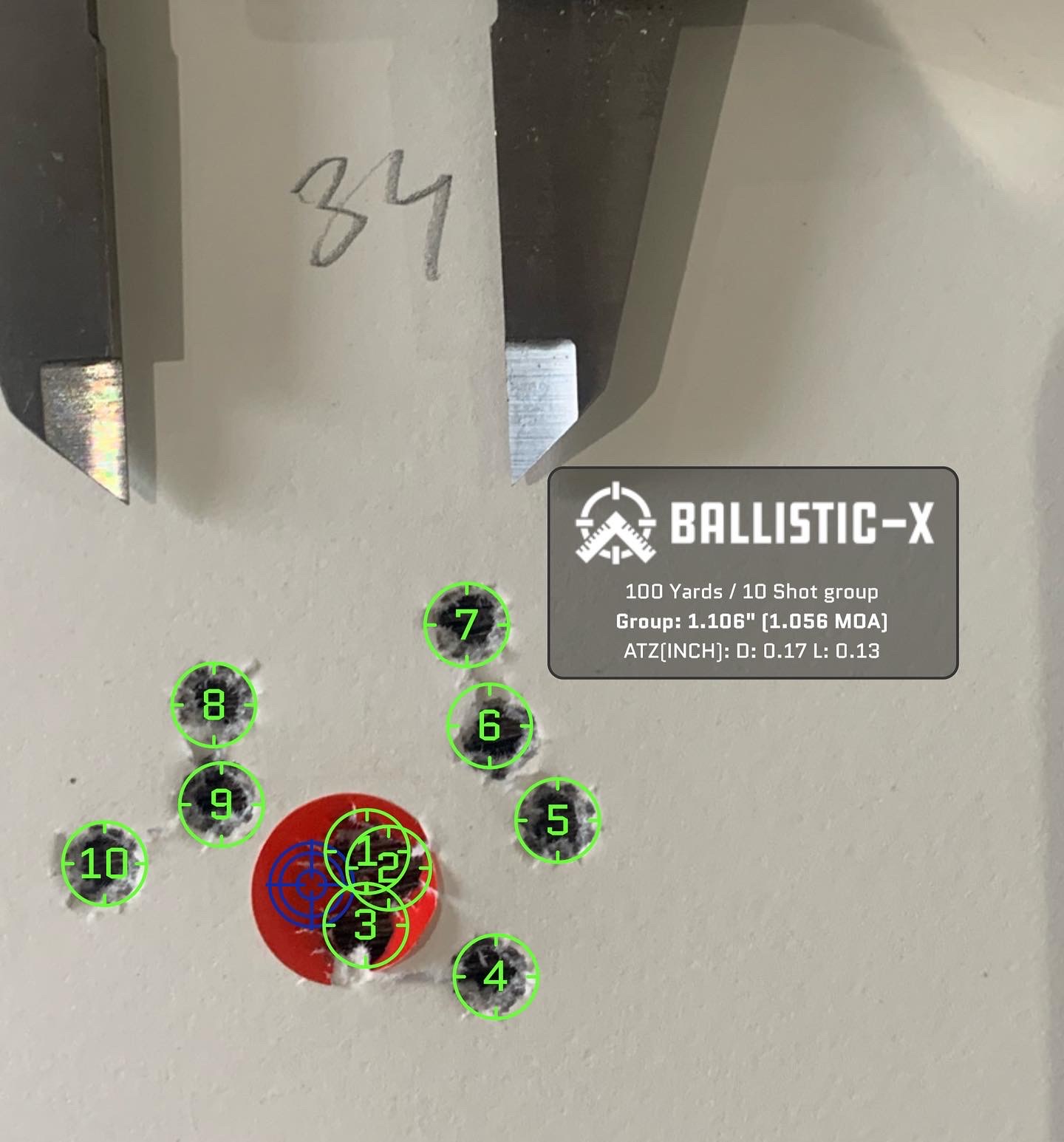

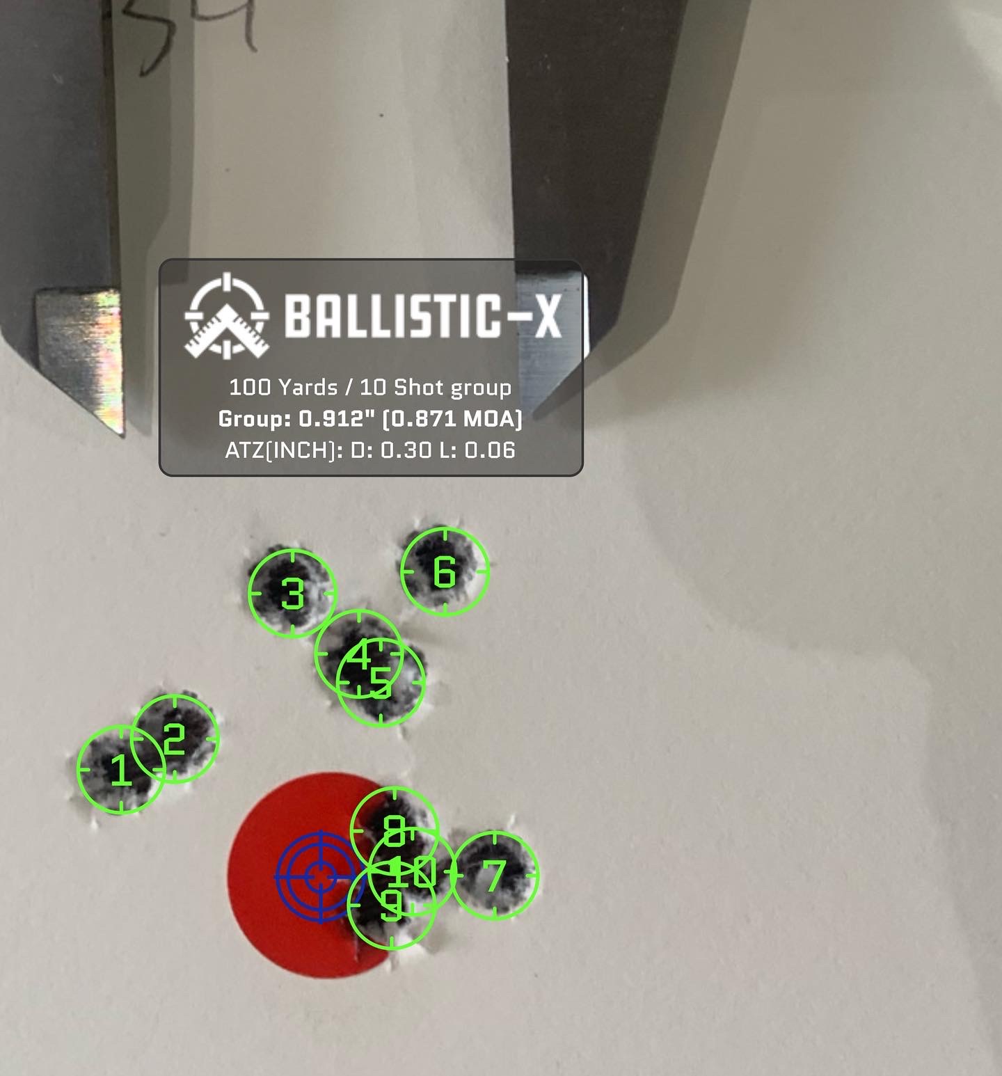

I just got back from the range this morning, and I tried out my new aluminum mags that I received from Vudoo a couple of weeks ago. My initial impression is the aluminum magazines are much easier to change due to their heavier weight, and I had new issues with feeding. I did take my time loading the magazine, and I’m convinced that taking your time loading both types of magazines solves many of the feeding issues and rimlock. However, I‘ve only had my Vudoo for about three months now, and I’ve yet to run it in a 22NRL Match. I‘m hoping the magazines will continue to perform in a match, however, I’ve heard and read there could be issues. I will report back after I shoot my first match with it.

Nice…………! I’m currently using Center X in my rig, and I‘m getting similar results. I shot my Vudoo out to 180 and 230 yards this morning and It was a blast!!!! Next time I go to the range, I’m going to stretch her out to 300, 400 and 500.
I love taking them to distance. My other vudoo shoots Center x awesome and sk almost as well. I’ve been very pleased with that set up but I struggle past 350 ish. I’ve spent a considerable amount of time at 300, 350 and even 375 with good results, but 400 on had been very hit and miss.
This new vudoo has an ibi 1:12 twist and I’m hoping I can increase my hit percentage at 400-500 and shrink groups at 200-350

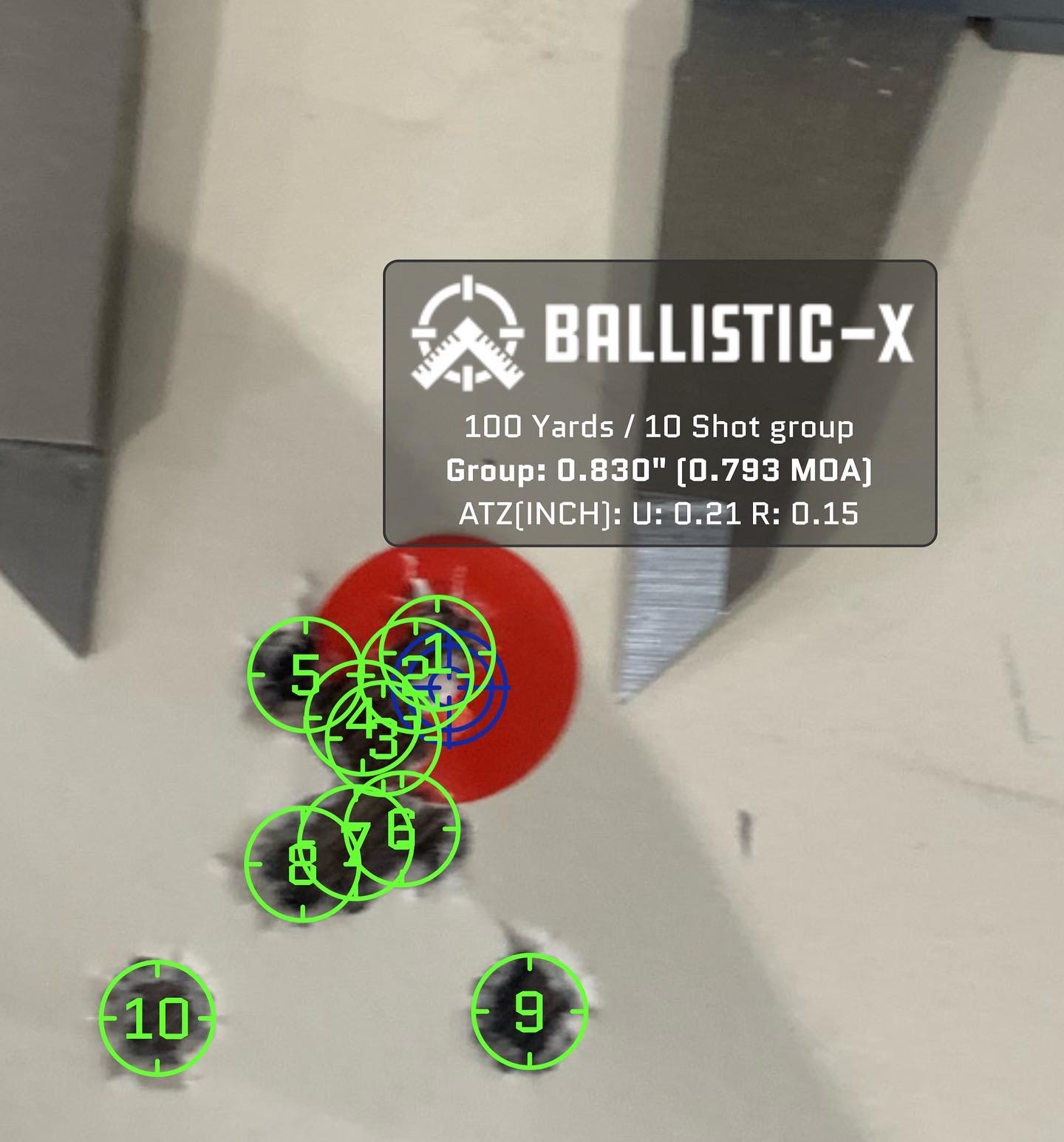

Lol it’s hard to stop at just one. I should have an ultimatum deuce here shortly. Just waiting on the barrel and it will be ready to start testing as well. It will be sporting another ibi 1:12 twist and a second ks 1:10 twist to see how it does.
So far the barrel is preforming great. We actually have 2 identical builds, just different optics and different colours. Both vudoo 360’s, both acc’s, both ibi 1:12’s. The second barrel is absolutely just stacking them at 100. 5- 10 shot groups fired yesterday at 100 and they averaged somewhere in the 3/4moa.

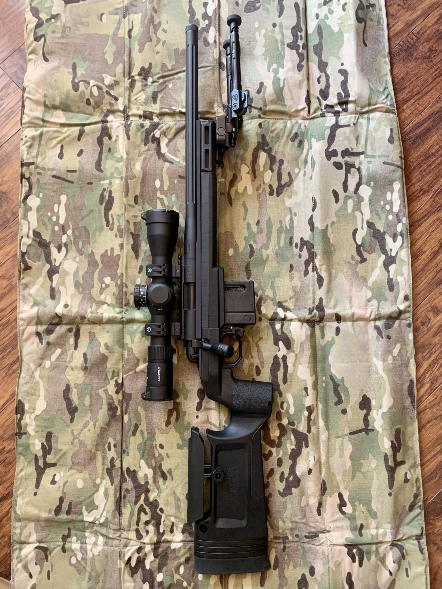

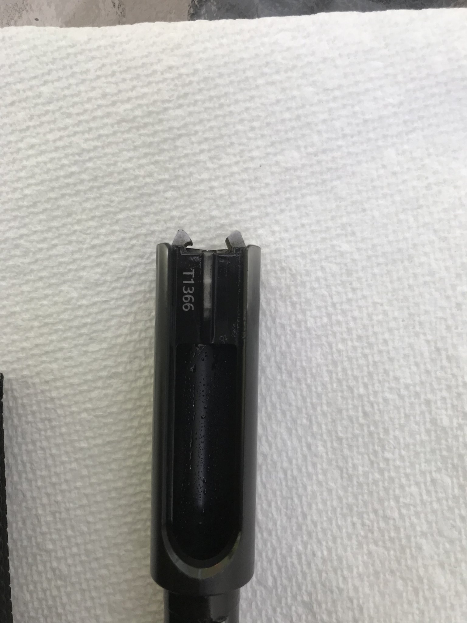

Guys this is a question regarding the picture i have attached. Shot the Vudoo 360 yesterday with a bunch of friends and it shoots lights out. Was cleaning the gun today and looking at the extractor does one look worn or broken? The right side looks like it is worn or possibly broken off, but I don't remember what it looked like before.

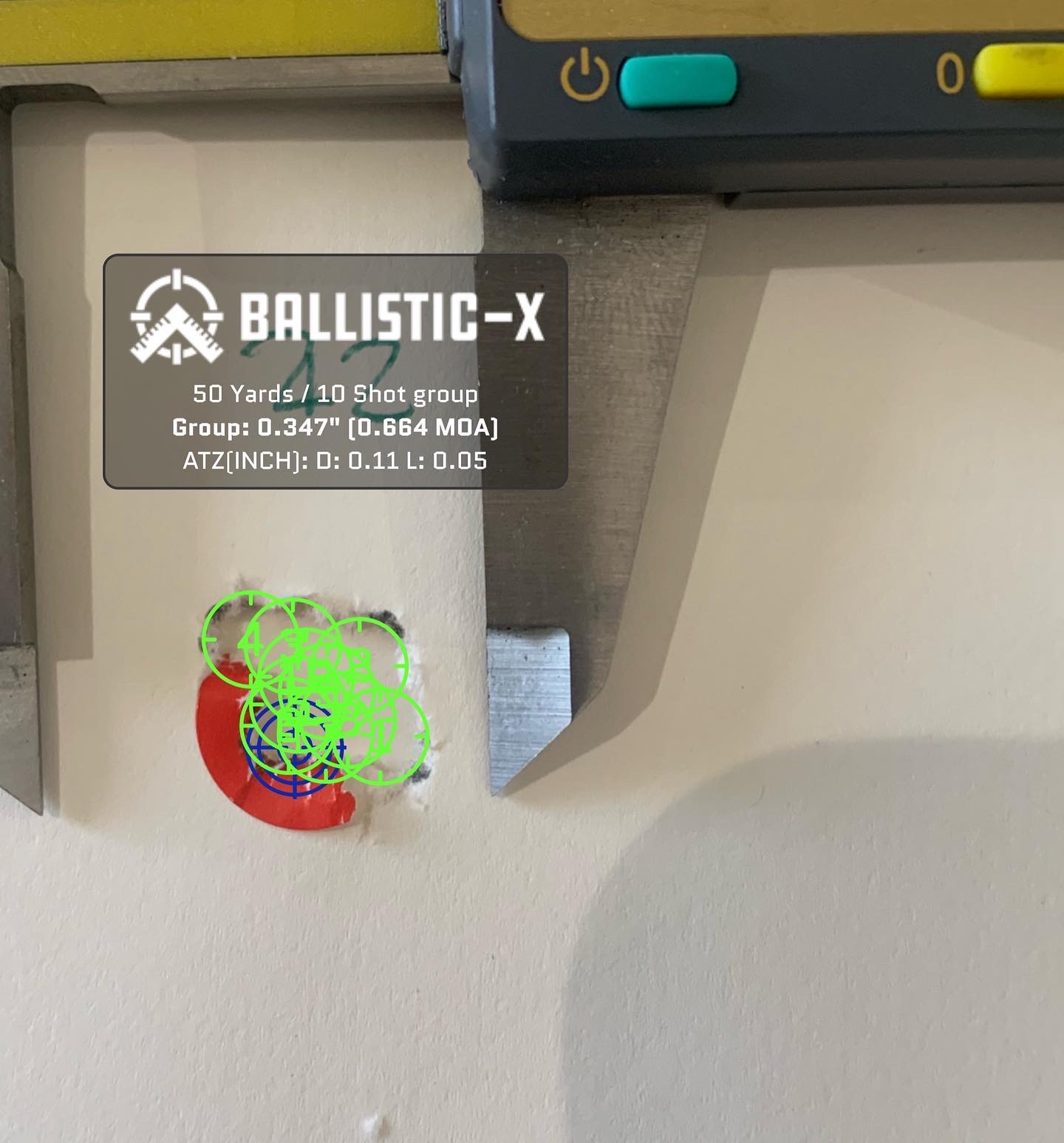

Saturday I spent some time at the indoor range getting a solid zero, checking ES/SD and doing some tuning. The SD was about 7 and it was a pretty painless tune.
Sunday I took it outdoors after our USPSA match. This was 10 shots at 150 meters. I bought 3 cases of it. It was also impressive out to 400 yards.
