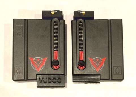

I have been using magazine extensions, but only to get 11 rounds loaded instead of using them for 12. For one thing, I don't want to get rid of the load assist buttons to compress the spring, and I really only want the ONE extra round as a "just-in-case" I have a problem with a failure to load or failure to fire of a round in that magazine, or I want to use a between-targets sighter. But the typical extensions (which is what I was using) are large and I didn't like the way they look.
So... I decided to make a low-profile version of the magazine extension, just enough to comfortably load that extra round. The new version follows the angle of the original magazine. Here's a comparison picture.
They're now available with my other 3D-printed items for Vudoo HERE.

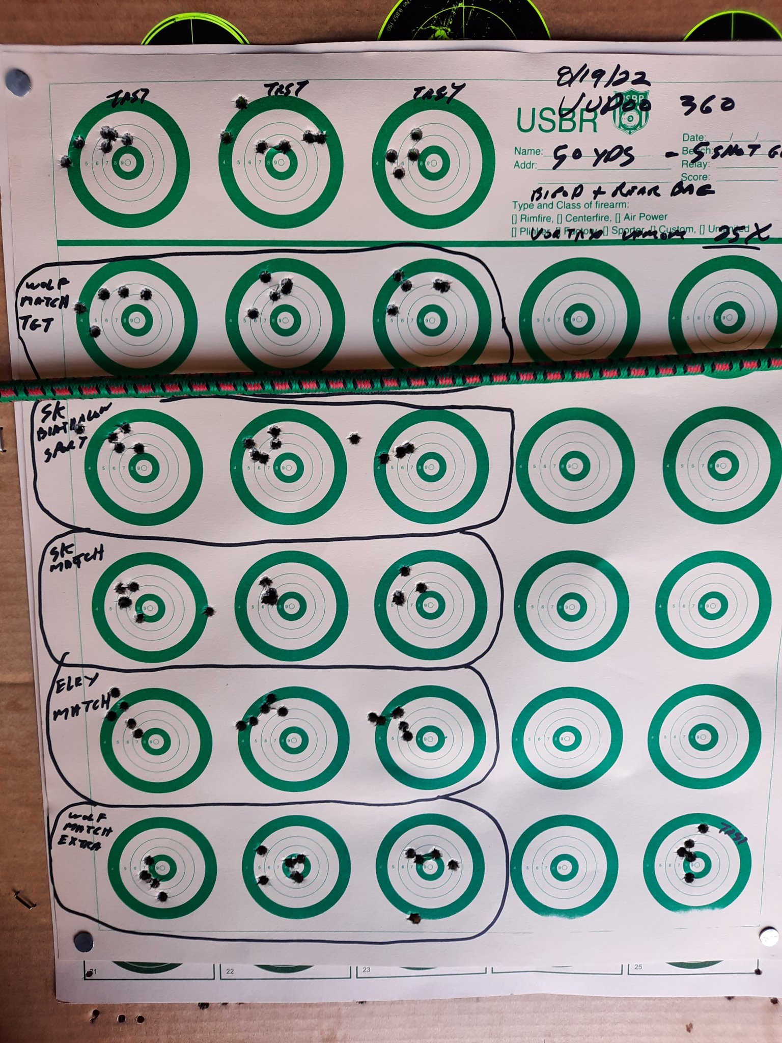

Anyone here ever have to send their Vudoo in for accuracy issues? I've got a 7 week old 360 barreled action that I just can't get to shoot worth a damn. I've tried two different chassis and two different scopes along with multiple good quality ammo on 5-6 different occasions ( with about 600 rounds down range now.) . The gun has been cleaned regularly at every other session or so. I'm at a loss as to what to try next. VGW tells me that they almost never find an issue and that I'll be responsible for costs if I send it in and they don't find anything. Wondering what to expect if I do send it in? So far, this is typical of what it will deliver. ( My Bergara and CZ' 457's both do better so it can't all be me )

With that crappy of groups, I would expect your scope rail is loose.
You could also get a chrono and see if your velocities are really off (meaning that your firing pin might be having inconsistent ignition).
I have almost never, ever heard of a crappy barrel .. crappy to me at Vudoo is putting up .4" groups instead of .2" groups. Those groups in your picture are horrendous for 50yds.
VGW tells me that they almost never find an issue and that I'll be responsible for costs if I send it in and they don't find anything. Wondering what to expect if I do send it in?)
A customer and shooting buddy sent his single-shot back to Vudoo primarily for inconsistent ignition. Turned out to be a headspace issue. Things do occasionally go wrong in manufacturing, even for a Vudoo!
If you send it back to Vudoo (and I suggest sending it back WITH your scope and stock or chassis) and they find out something that isn't a VGW manufacturing issue and charge you for the time but they've figured out the problem, I'd say it would still have been worth it.

Yea, something simple like that is what I was hoping might be the case. I've checked the factory rail and it seems tight. I guess I could put my torque wrench to it though. I've actually put two different scopes on it. (Both were brand new out of the box) just to make sure it wasn't that. I do own a chrony and guess i could drag it out but feel that I shouldn't be trouble shooting a brand new $2K barreled action like this. At this point, I don't even want to look at the gun. Major disappointment.
I'll likely end up doing that. I can't keep it the way it is and can't bring myself to sell it (which I likely will at this point) to some poor SOB the way it sits. At this point, I just wonder if it would be throwing good money after bad.
Well if you don't think it's anything you've done, like didn't set the mag up right and every bullet is scraping, or your muzzle protector is loose, or the scope rail is loose, then something is wrong with the rifle and it should go back to VGW and they shouldn't charge you anything.
Send it back. And if they charge you, they charge you. You already have a significant amount into it. The 'charge' they charge you if they find it's you and not the rifle, shouldn't be more than a few hundred dollars. But I think that's just a threat to keep EVERYONE who wants to send it their perfectly functioning rifle in because it's not up to THEIR impossible standards. If you ever worked retail, you know who I'm talking about.

I was having what I considered accuracy issues with my 360 when I first got it. Maybe not as bad as yours but still pretty unacceptable. I dropped it off at Vudoo and they had it for a bit. Greg there at the shop worked with me. They didn’t find anything mechanically wrong, but felt it had to do with my cleaning routine, which Greg considered to be too much and too often. He had me do a very, VERY thorough cleaning of the entire bore until it shined like new. Basically starting over. Then just shoot it, and pay attention to the chamber only. When I start seeing a carbon ring building up I use some C4 to clean out the chamber ONLY, and pretty much leave the bore alone. I’ll pull a patch or two through the length of the bore to clear the big stuff out but I haven’t done a thorough scrubbing of the bore since Greg had me “start over”. Accuracy steadily improved to what I consider very good. I clean the chamber around every 700-900 rounds, and have almost 5000 total through it now. You might try contacting Greg at the shop to discuss. He’s a really nice guy.

FWIW, I've been in touch with VGW again and they have provided some helpful troubleshooting hints (mainly regarding action screws) I'll run that advice to ground on both chassis with an open (and hopeful mind) before sending it in.
Please share them here!
Sure, much of the advice/troubleshooting is what some would consider common sense (if your into good shooting rifles) but they were thorough in touching bases. They gave me some inspection advice in areas that included: Screw tightness/torque on the chassis; Scope mount screw depth/torque; Lead shaving. I also had a follow up discussion in that they said that I should test for bottoming action screws as their mounting holes on the Vudoo "can be shallower" than others. this is news to me and I know my KRG chassis all use 0.055" washers on their action screws. I'm pulling those chassis apart now to see what consistency I have (and to assure I have no missing washers. In the end, I'll do a Dykem test on those action bolts in the x-ray chassis (which is he one I want to use for this build) to assure there is no bottoming. I'll get this all done (and retest for groups) in the next week and get back to them.
All that said, I've been assured by VGW this will get resolved even if it takes a rebarreling. I'm starting to feel like there is hope here.
Yep, I have seen that front action screw containing the barrel threads a little too often. It's something that a lot of people don't check.
When you buy a complete gun from Vudoo, rather than just a barreled action, they're supposed to have already made sure that's correct.
Of course, WeeHooker's was just a barreled action when he got it.
