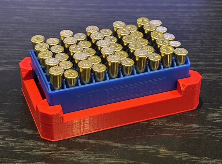

Based on feedback, I've changed the lifter box to have more height stagger between the rows, so now you can actually use it to single-shot load direct from the tray... or of course, it's also still useful as just an easier way to get the cartridges out of the Lapua or SK tray for magazine load or to move to another bench tray instead of having to pry them out with your fingernails. It's available in the classifieds with my other Vudoo items, HERE.

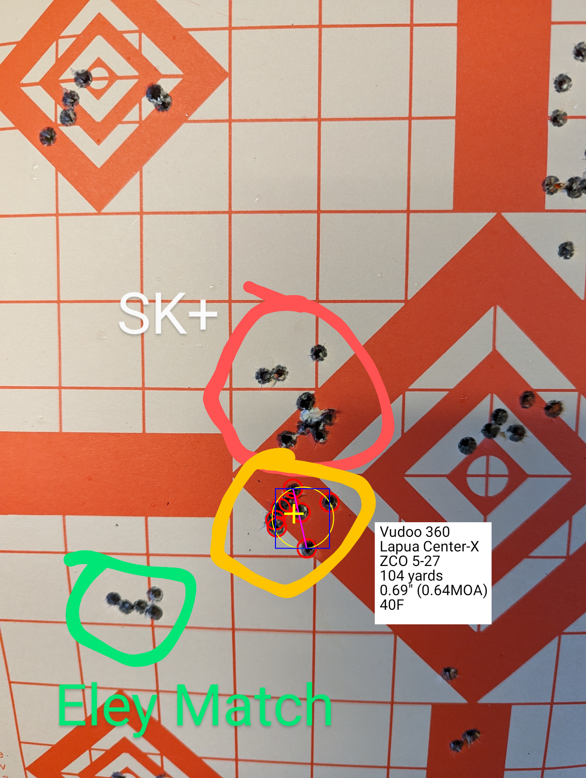

Just got my 23.75" Bartlein Vudoo and took it out. Didn't clean it and just took it right out to the range and shot 100 rounds. First was using SK+ to find a tune setting, and then did 10-round groups with SK+, Center-X, and then Eley Match, but they called ceasefire and didn't want to wait for another target takedown, so I just packed up. Will take it to a match tomorrow, seems to shoot fine :D
The chamber of Vudoo .22 lr rifles is designed for Lapua Center-X. YMMV.
