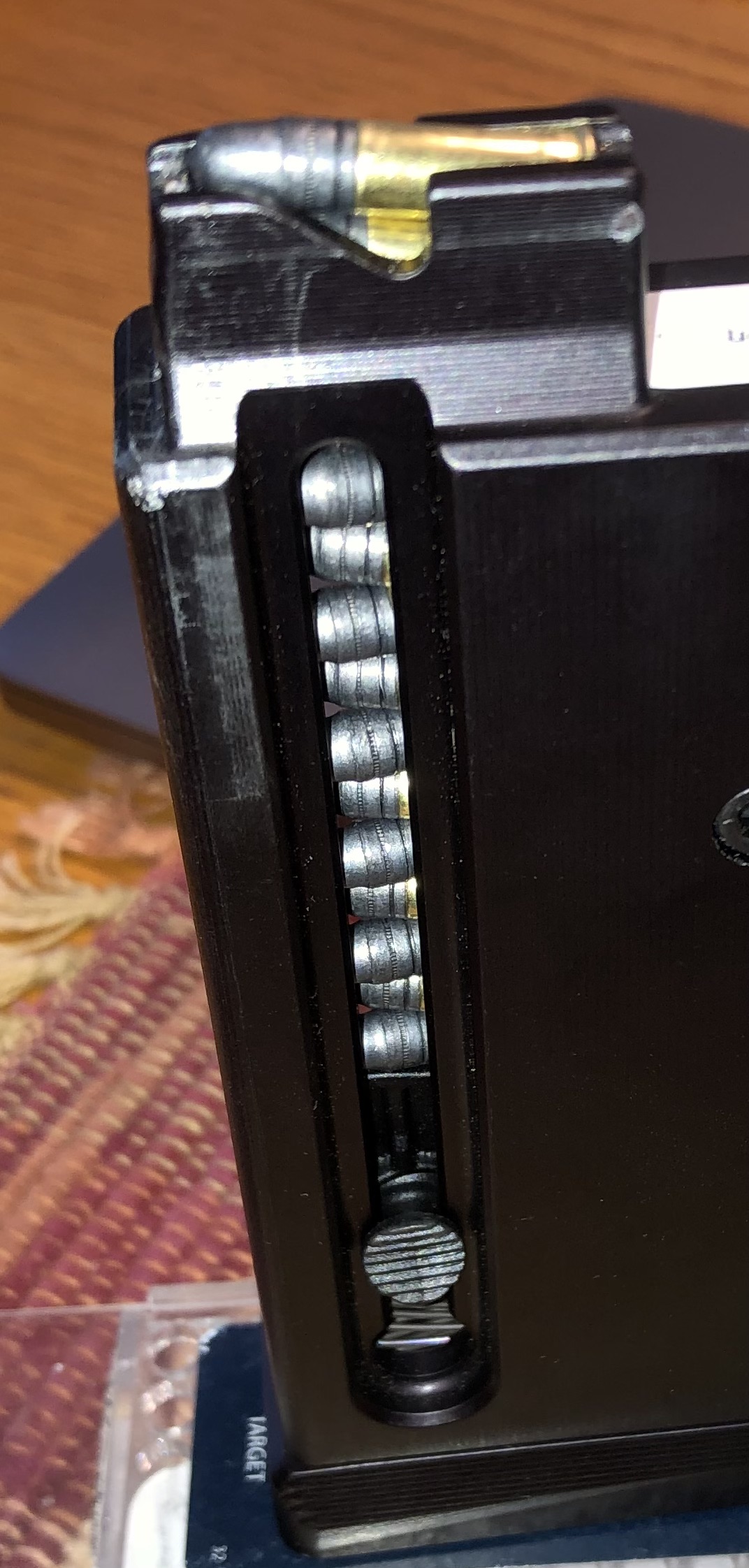

Mags are a tough spot as you are sending a tiny bullet into a tiny hole so any misalignment will mess that up. I would bet that the problem is not so much the magazine itself but the magazine to bottom metal interface. I have had the same magazines for years and in some stocks they feed fine and in others they give issues. Same mags. Different interface. So having a way to adjust it whether in the stock/chassis or the mag would be ideal.
Also pressure against the mag is another issue but easier to fix with a mag block so the bag cant contact the mag.
In all of my work with designing magazines (a task I would not wish upon my own enemy), I have come to realize that many of the problems often associated with the magazine are actually an issue with the geometry and tension of the extractor and tensioner. The magazine has to have enough spring force to overcome the tensioner and extractor to place the cartridge into the bolt face faster than the bolt can pass it by. I have found a lot variation from action to action in the amount of magazine spring pressure needed to accomplish the task.
wait, what if I don't know?! What happens? I have one of those 15 rd mags but I always have issues with it working....
Last thing first: What issue(s) are you having?
The 15-round mags amplify "sensitivities" found in the 10-rounders:
  • The magazine MUST!! be held at the correct height in your chassis or stock.
    My 2019-vintage rifle is in an MPA BA Comp chassis. When it first came from Vudoo, the non-adjustable mag latch allowed about 3/16" or so of vertical play. This was enough to cause feed failures, especially with the last round or two in my 10-round polymer mags. @RAVAGE88 identified the issue immediately upon seeing it. The end result was my receiving an adjustable latch from MPA; as I understand it, that latch is now standard on the BA Comp chassis.
    More broadly, consider the gigantic challenge of stripping a rimmed cartridge with a butter soft bullet off an under-tension stack of cartridges and feeding it into a chamber only a few thousandths of an inch larger in diameter than the bullet, without that bullet suffering scrapes or dents on the way in. Then add the manufacturing tolerances of the plethora of R700 stocks and chassis. It's actually pretty incredible that Vudoos work as well as they do.
  • The mags, ESPECIALLY the 15-rounders, MUST be loaded correctly.
    Look at the cartridge column in my post's photo (included again here) - notice the alternating pattern of the stack. This is accomplished by pressing the follower button down just enough to slide a round under the feed lips, then release the button. The bullet nose should orient itself just above the front of the mag as shown. If the round is "flat" - not angled as shown and the bullet nose points straight at the front wall of the mag - it's wrong; fix it by tapping the base of the mag gently and/or use a fingernail to pull back and down on the cartridge rim; it should pop into position.
    Even if each round is loaded correctly, you may notice two bullet noses on the same side of the mag - no alternation. If you leave that uncorrected, a stoppage is almost guaranteed when the bolt tries to feed that slightly misaligned round.
    The 10-round mags have the same requirement; it's just that the column doesn't show the pattern as clearly.
The "If you know, you know" comment refers to having a 15-round mag with a follower button that makes inserting all 15 incredibly slippery Lapua cartridges in hot weather almost easy. The follower button on ten-round magazines with extensions on them only helps with the first ten, then the last two or five or whatever rounds have to be pushed onto the stack. In August heat, that lube makes manhandling a round onto the stack almost comical.

I can 100% agree with must be loaded correctly. My Gen1 Vudoo feeds from the metal magazines like butter. I have 2- 10's, 3- 12's and a 15. The 15 is the only one that gives me a little issue from time to time on round 14 & 15. I have ordered a couple of longer mag springs from Hoz n' Shield. This should solve that 100%.
    My 2019-vintage rifle is in an MDT BA Comp chassis. When it first came from Vudoo, the non-adjustable mag latch allowed about 3/16" or so of vertical play. This was enough to cause feed failures, especially with the last round or two in my 10-round polymer mags. @RAVAGE88 identified the issue immediately upon seeing it. The end result was my receiving an adjustable latch from MPA; as I understand it, that latch is now standard on the BA Comp chassis.

So, one of Mike's challenges is to "innovate" a feeding solution that's innovative/accurate/precise AND as idiot-proof as possible, while still being marketable. The reality is, while the R700 footprint may not be the optimal accuracy/precision solution, it has damn sure sold a crap ton of Vudoos, Rim-Xs, and Bergaras.
There is also a "usability" component to the solution: if it's too hard to use, what effect does that have on marketability / market uptake?
I have met... too many... Vudoo buyers who loudly proclaimed the rifle was Garbage because it wouldn't feed. Damn near every time, the complainer was pushing the follower button all the way down and dumping in rounds, with the expected result of rim lock and misfeeds. This is not to discount real issues associated with some R700 stocks/chassis that simply would not hold magazines in the REQUIRED position; my original MPA chassis was one of those - and Phil Cashin fixed it, as Mike has described.
Usability of a product, regardless of the vertical, (guns, software, furniture, anything ) HAS to be a primary focus for long term success. It also has to work. Get both.
