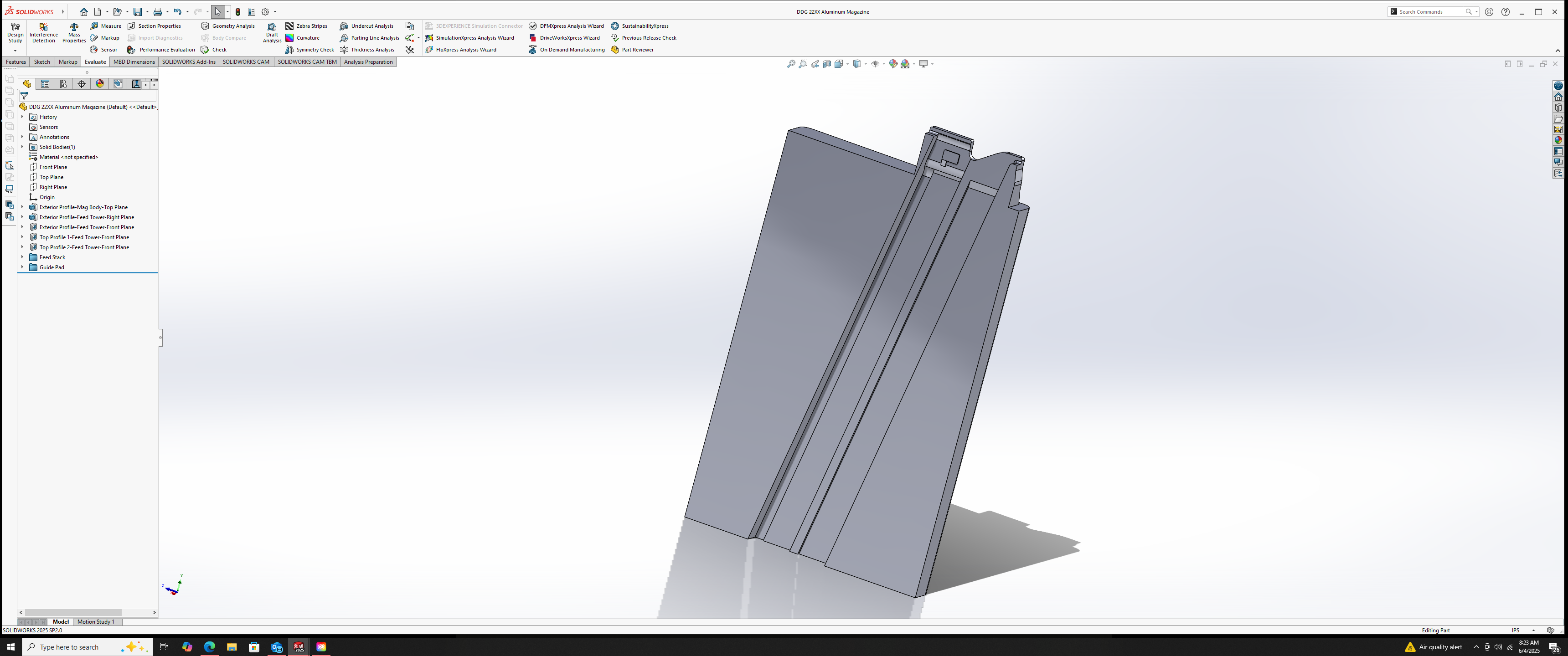

I appreciate the tons of feedback about preferred magazine capacity, and I'm not too surprised about the responses. I won't give too much away at this point, but I'll say now that I'm definitely doing a legit 10 round. I'm focused on modularizing a few things and I believe everyone will be pleased.
As I've worked through this, I've noted a few interesting things and I'm pretty excited about the path to the new magazines. So, another question; given what's been available, what has worked the best for you guys? Where do you see the greater challenges related to feeding (based on how you use your rifles)?
As I mentioned recently, a lot is happening in parallel to try and make everything available around the same timeframe. I'll continue to keep everyone posted and believe I can speak to timelines very soon.

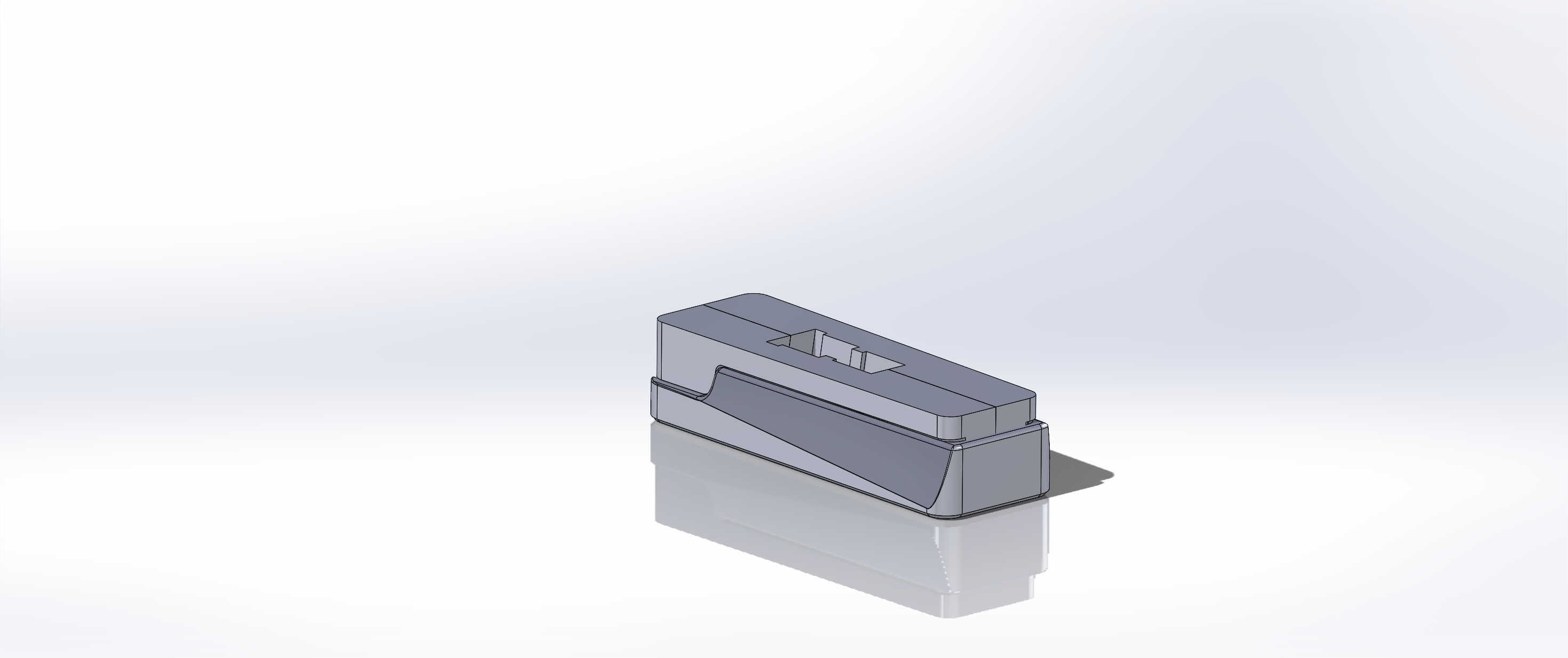

Great info, Dude, and you hit every key point that I have in the project ORD.
I'm doing my DBM again as the original inlet along with the same DBM in what I'm calling my M5x inlet. The DDG M5x DBM will fit all M5 stocks.
I'm having to throttle back the excitement so I don't share more than I should too soon....
MB

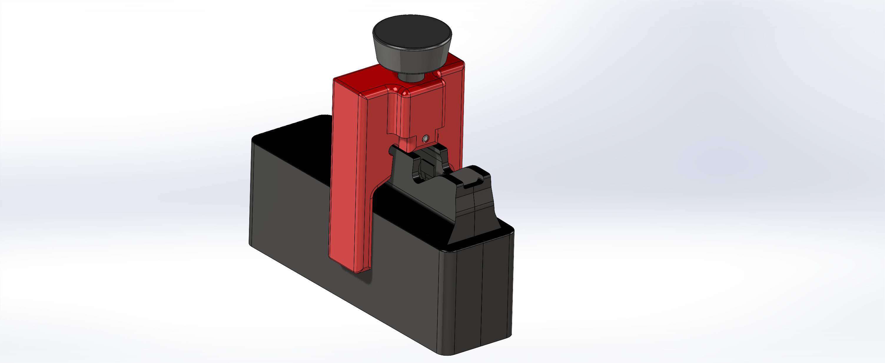

A quick question for everyone. I'm working on a number of things in parallel and as various parts and assemblies come together, I wanted to ask, what's the preference on magazine capacity?
I know the 15 round mags have been popular for NRL/PRS, but are there any preferences for five and 10 round mags?
Also, as I work on the DDG M5x DBM, I've decided not to go beyond the concept phase for the Adjustable Mag Release I featured in a prior post. Instead, I'm doing a different Adjustable Mag Release as part of the M5x design.
While the new DDG 22XXLR Magazines will have an adjustable catch, I'll assure everyone that proper tuning will be straight forward when using the new Magazines in the M5x DBM with the Adjustable Release.
So, let me hear it; what are the preferences for capacity?
