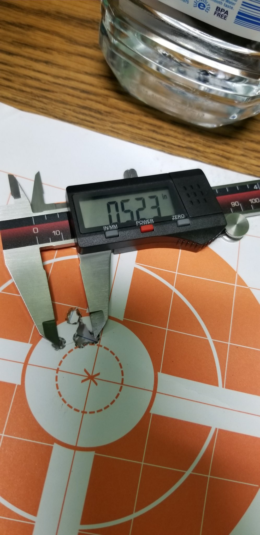

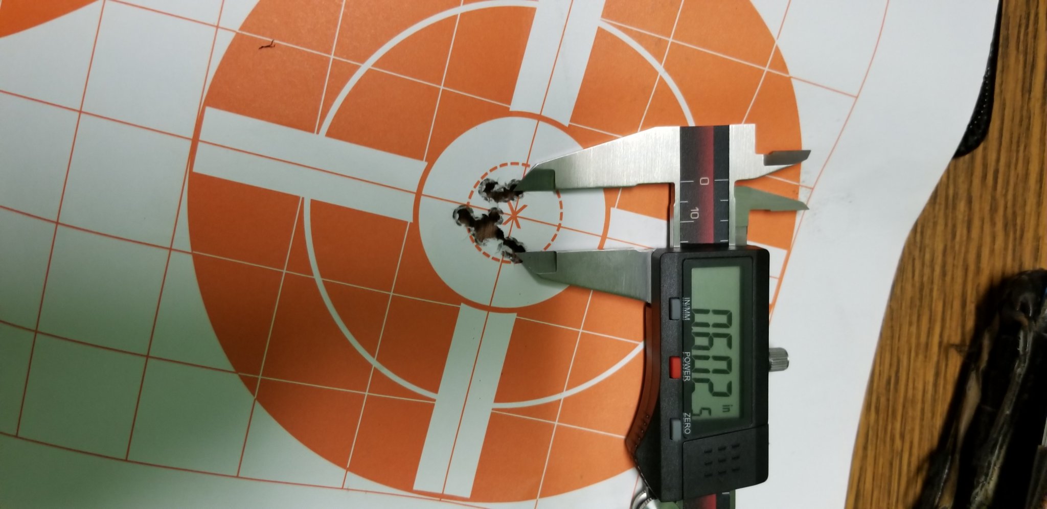

Couple of 10 shot groups at 100 yards with the Lapua X-ACT. Fairly windy day, all other brands had a flyer or two.
That's the sort of accuracy I'd want if shooting smallbore bullseye or BR matches, but $23/box is a bit much for the PRS-style 22RF matches I shoot. I'm hoping that they find an exceptional lot of Center-X or Midas+ for me while my bbl'd action is at Mesa - I need something that's good enough at 200-300yds to be competitive for the few targets we shoot at those distances. A case or two of that would last at least a couple of years at the rate I'm going.

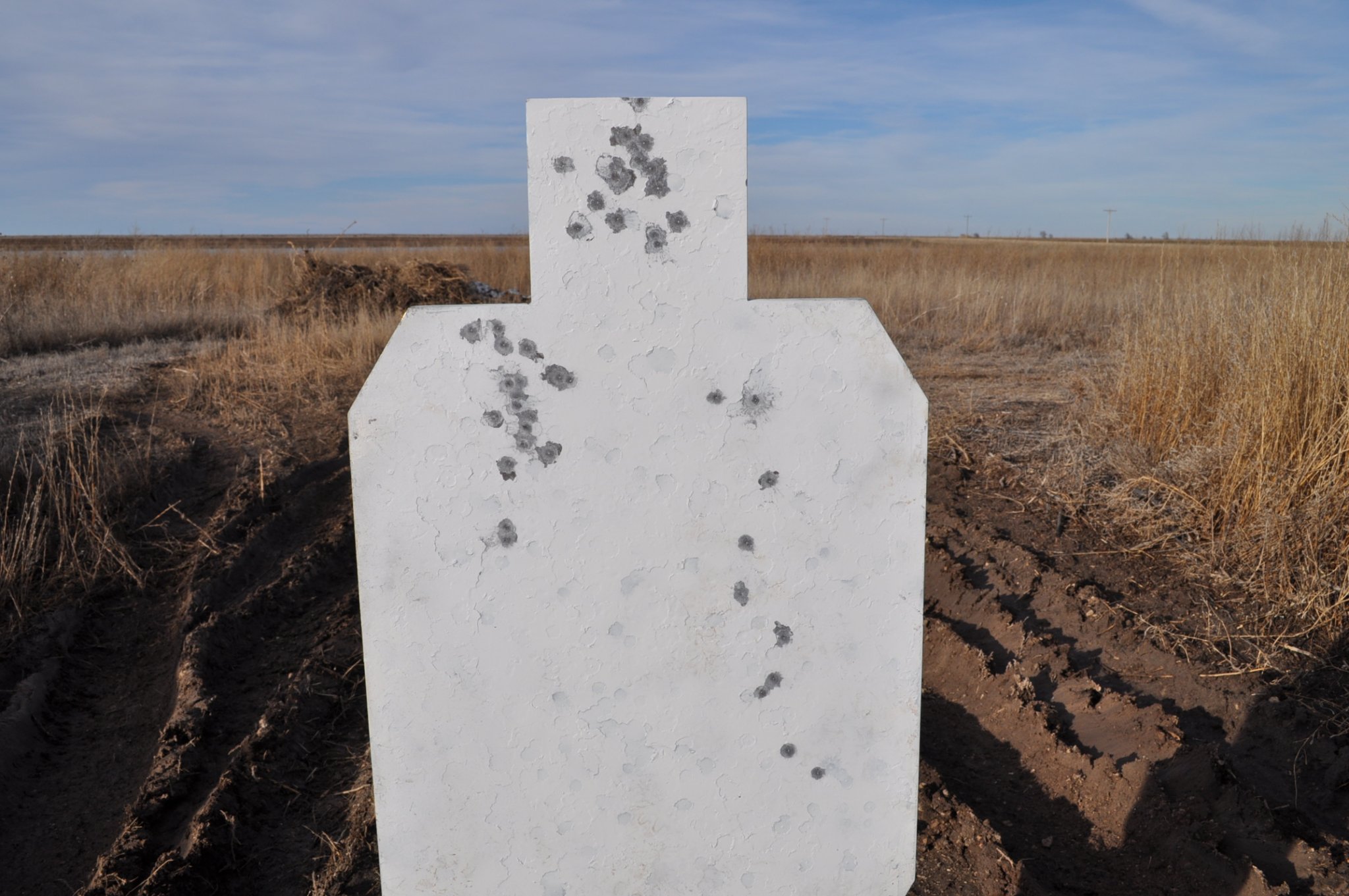

The attached photo is of a full-size IPSC target shot from 210yds with a fairly new 22" Bartlein Kukri V-22: 20rds Lapua Center-X in the head, 20rds Lapua Polar Biathlon on the left, and 10rds of some old Wolf Match Extra on the right. None of these display the type of accuracy I'm looking for, but the Center-X is close. This lot of Polar had an ES of 55 the last time I ran it over the chrono, with very strong correlation between the louder & quieter shots having higher & lower velocities, and hitting higher or lower on the target. It's not acceptable for our purposes. Obviously, the Wolf is crap, and though I haven't tried it yet at 50yds, I doubt it's good enough even that close to be worth much more than plinking at tin cans.
