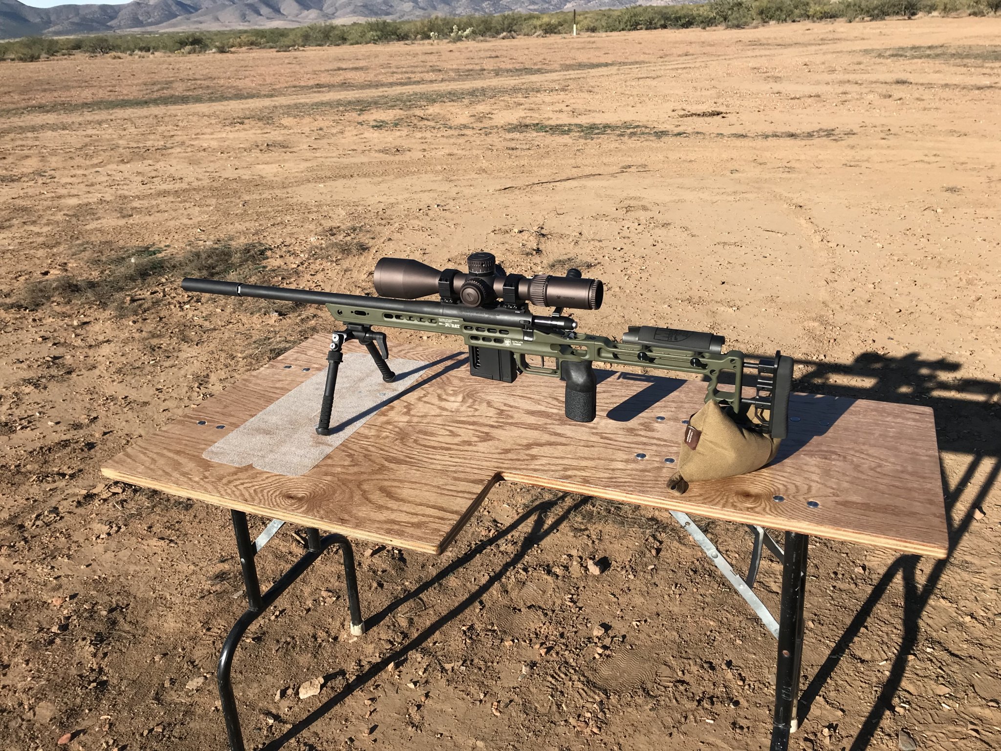

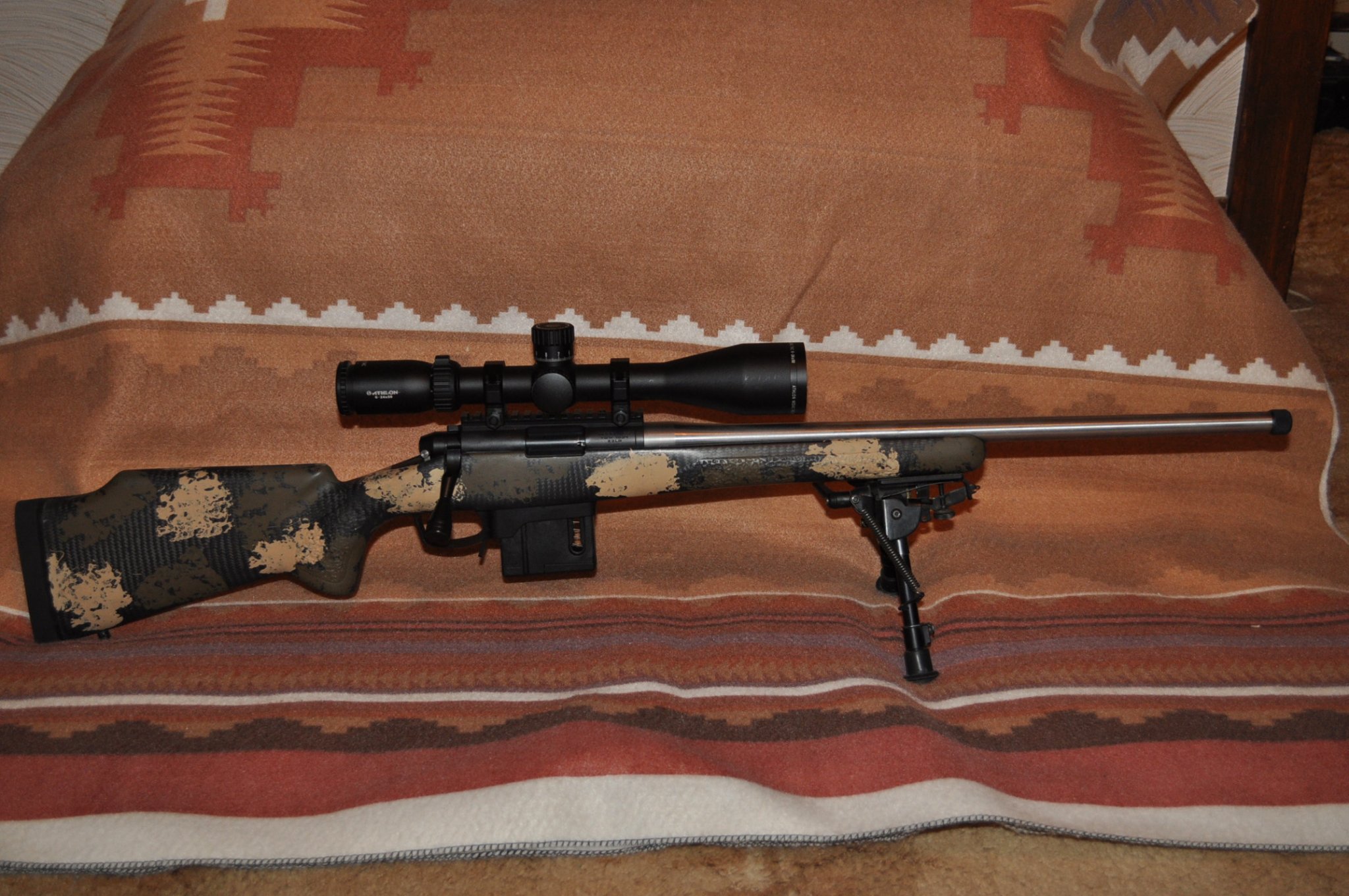

This is my V-22 in a Manners EH2 stock, with a 22" Krieger in their #4 sporter contour. Weight is 9.75lbs with the Athlon 6-24x50 Midas TAC mounted in aluminum TPS TSR rings. I enjoy carrying it around a lot more than I do my other two 14+lbs V-22s with 22"sendero & Kukri bbls, 34mm Cronus scopes, in Manners PRS1T stocks. Those two heavier rifles get the nod for match use, but this lighter 'sporter' V-22 shoots great too - and I should give it a try in one of our local matches. I've CeraKoted the bbl in graphite black since I snapped this photo.

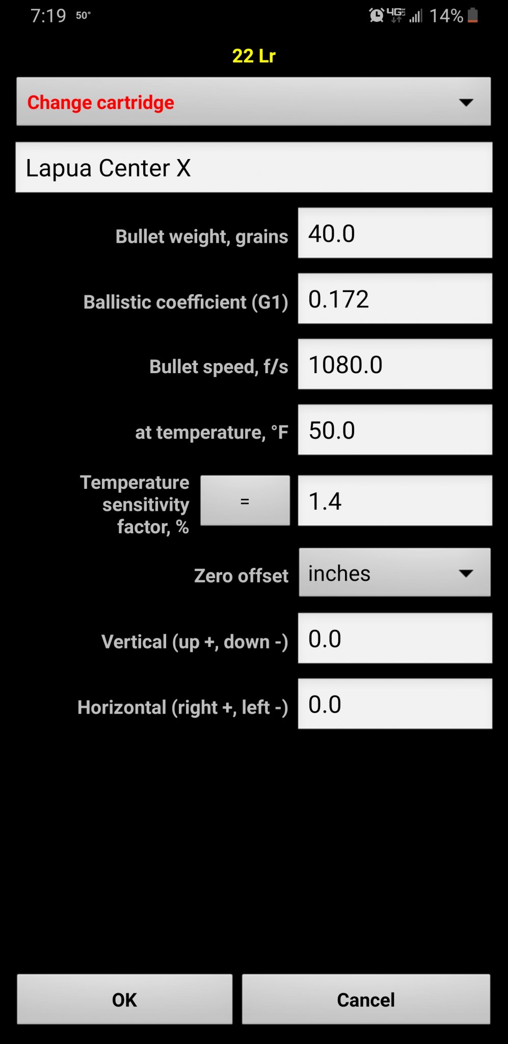

I use strelok+. I adjusted my BC and speed (which looks high compared to most) to match what I was seeing in reality out to 100 yds. I then used the dope strelok provided and was pretty close (within few clicks) at 300. This was my data...
Thanks Flatland. I did read some of ur posts about this sweet looking rifle. Just curious how it does off barricades... If u shoot it in a local match, let us know how it compares to your heavier rifles. I'm just wondering if there is a balance of wt/functionality (not so much to 'match' the wt of a full-sized rifle) but to be able to shoot efficiently off barricades and benefit from a lighter rifle for unsupported
I'm using StrelokPro with very similar numbers. My current lot of Center X is cookin along at 1092 and the solutions are dead on.

Does your BC look as high as mine? I have seen others estimating .14, etc but using velocity and actual drop at the given conditions, i adjusted the hypothetical BC to match what i was seeing and Boom! Seemed to match at 200 and 300. Maybe this BC is close but seems a bit high to me... but it works.
Yep, published BC is what I'm using and it's working. I'm seeing guys run the BC as low as 120 to get their solutions to line up with what they're seeing down range.

Hopefully I'm just repeating what everyone else here knows already, but there is a .22LR Lapua Center X drag function in the "Drag-functions" setting on Strelok. Of course entering observed actual speed should give optimum results.

I'm glad you repeated because I didn't know, and I thought I had been through Strelok Pro pretty well. You do have to go find that specific drag function... I added via the Lapua button at the bottom and selecting it once added to the list of functions. Please correct me if I misstated.

Yep, important piece of info and I didn't think to mention it. Using this drag function makes a big difference.
