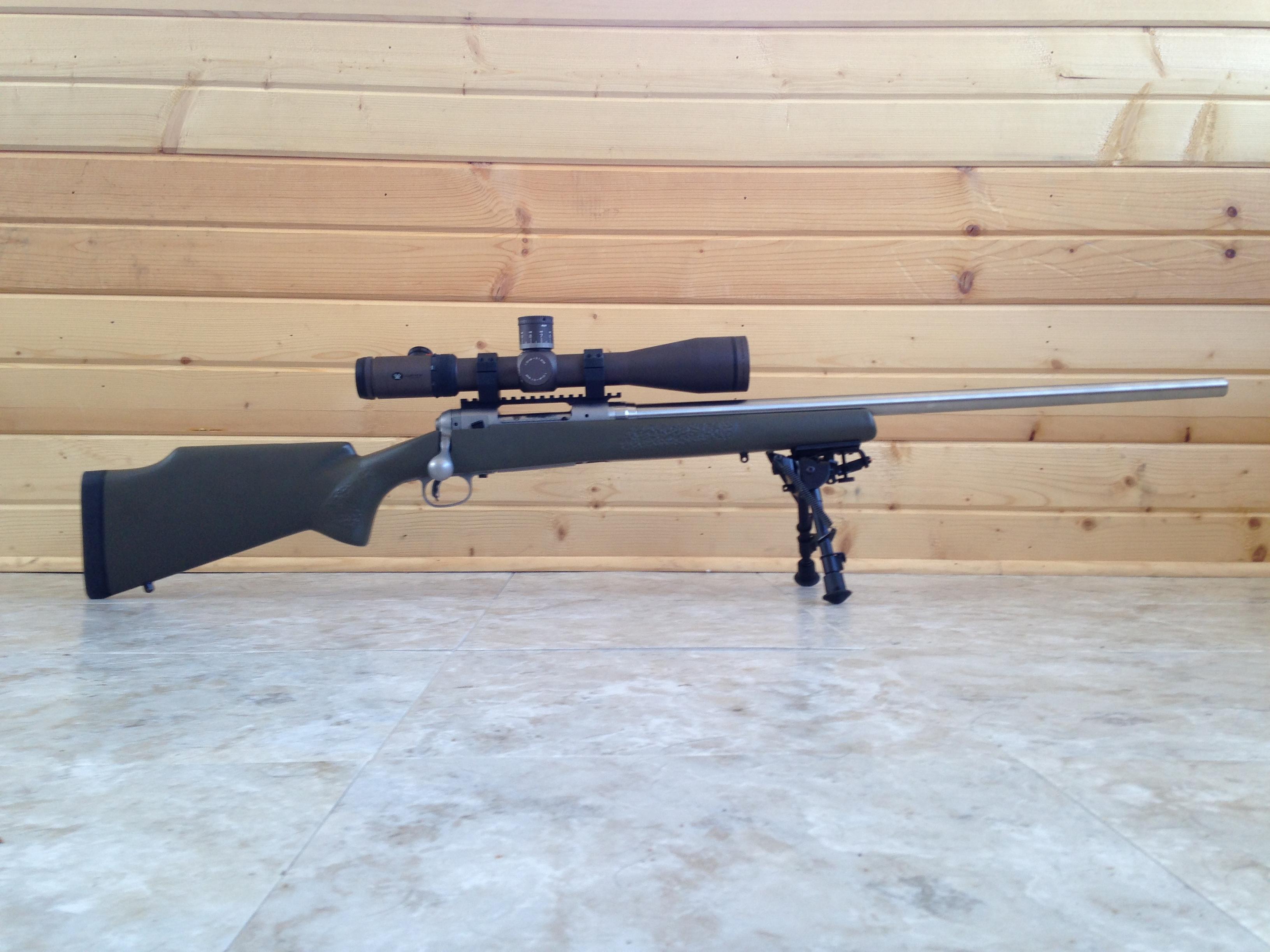

I would like to thank the members of the forum for their help. Also thanks to Jim Briggs at Northland shooters supply.
Specs are-
Savage varmint action
Shilen select match 26'' 1:8 varmint contour in 6.5 creedmoor
Manners T stock
Seekins rings and 20 moa mount
NSS recoil lug and barrel nut
Vortex Razor HD ebr2b 10mrad
This rifle was assembled and bedded by me. (first time for both).

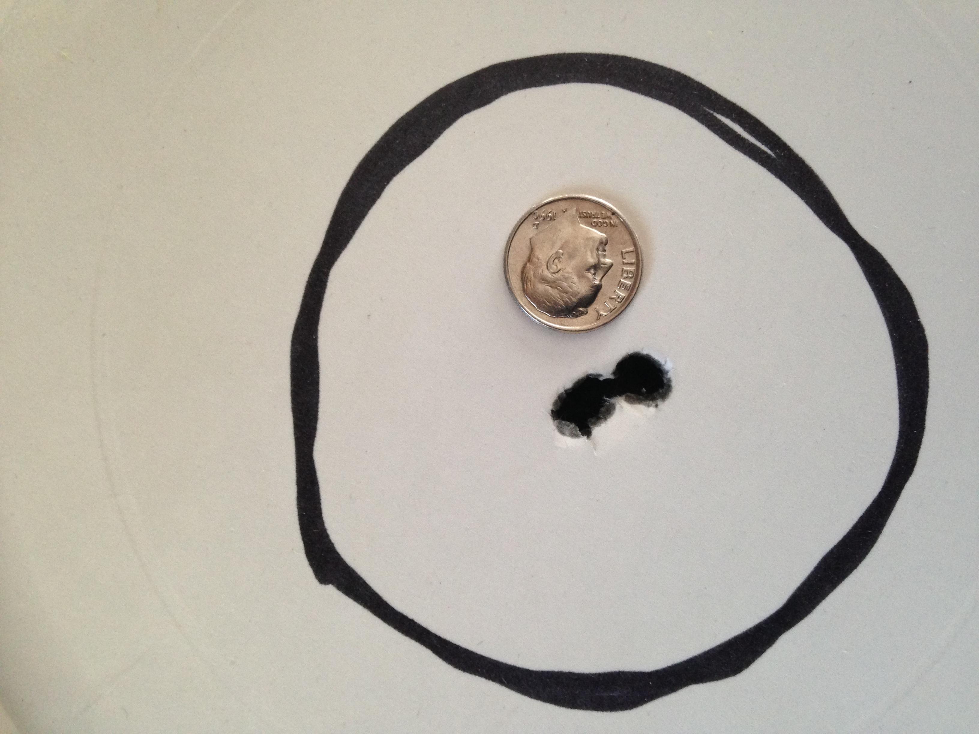

The pic is my best group (5 shots) at 100yds. off a bipod and rear bag with factory 140 gr. AMAX
