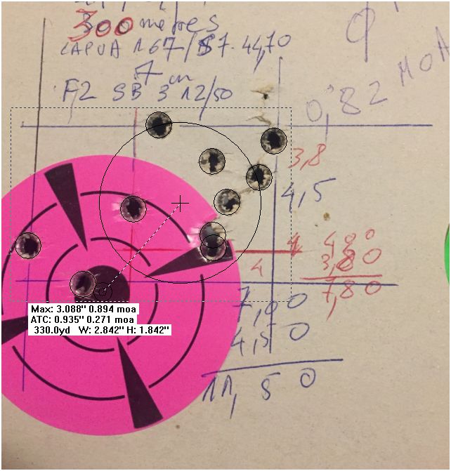

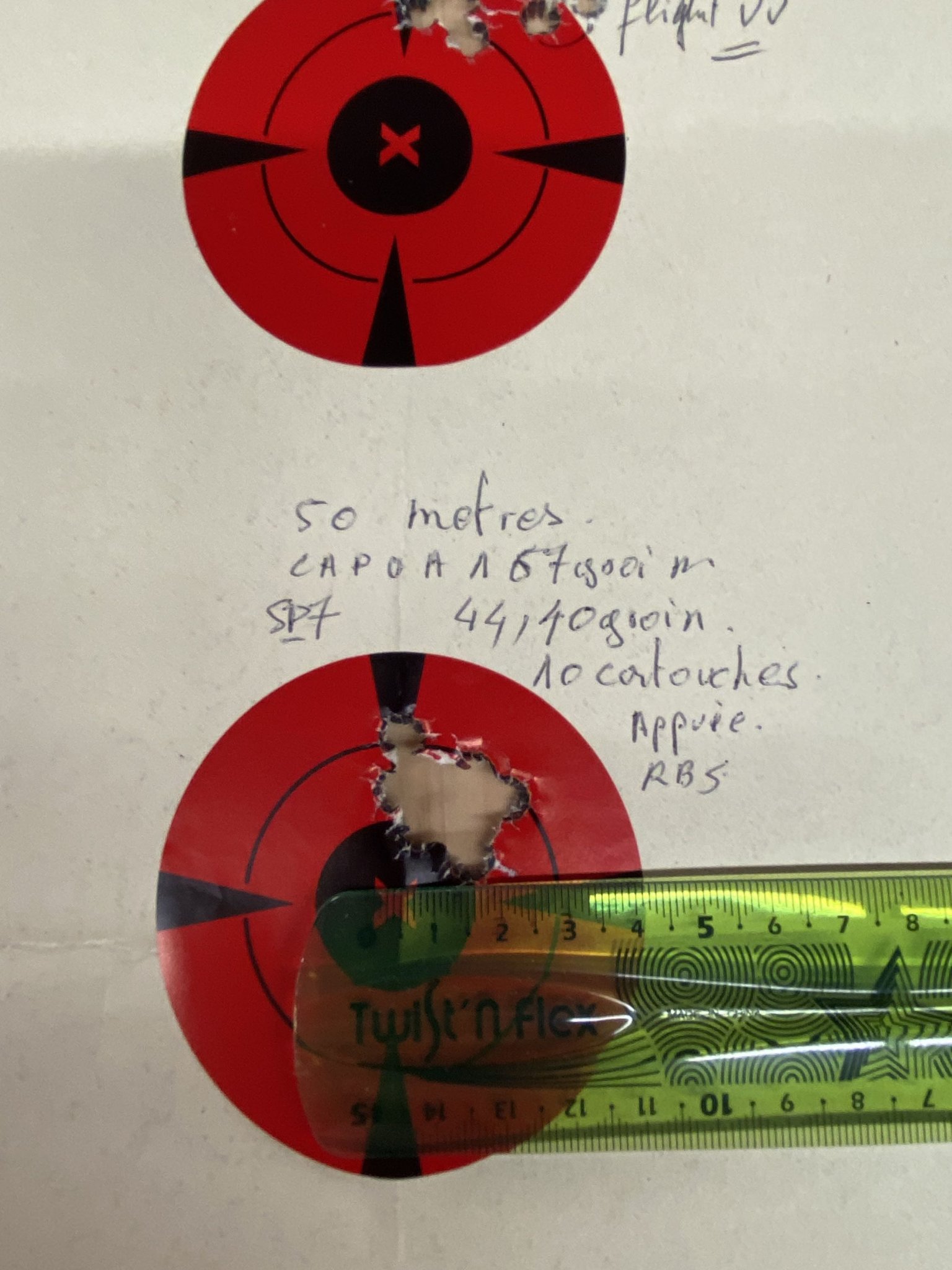

my shooting cardrige reloading with reloading bullet lapua 167 grains speeds 800 meter second, distance 300 meters
Reloading it's only for me I don't responsability
Bullet lapua 167 grains, amorce Br2
Vithanouri N140 43.7 to 44,7 grains, I used 44,7 grains
All long cardrige 73,20 millimeter, I don't put in the magazine because it's long, only put directly in the chamber
With 44,7 grains N140, speed 800, 805 meter seconde

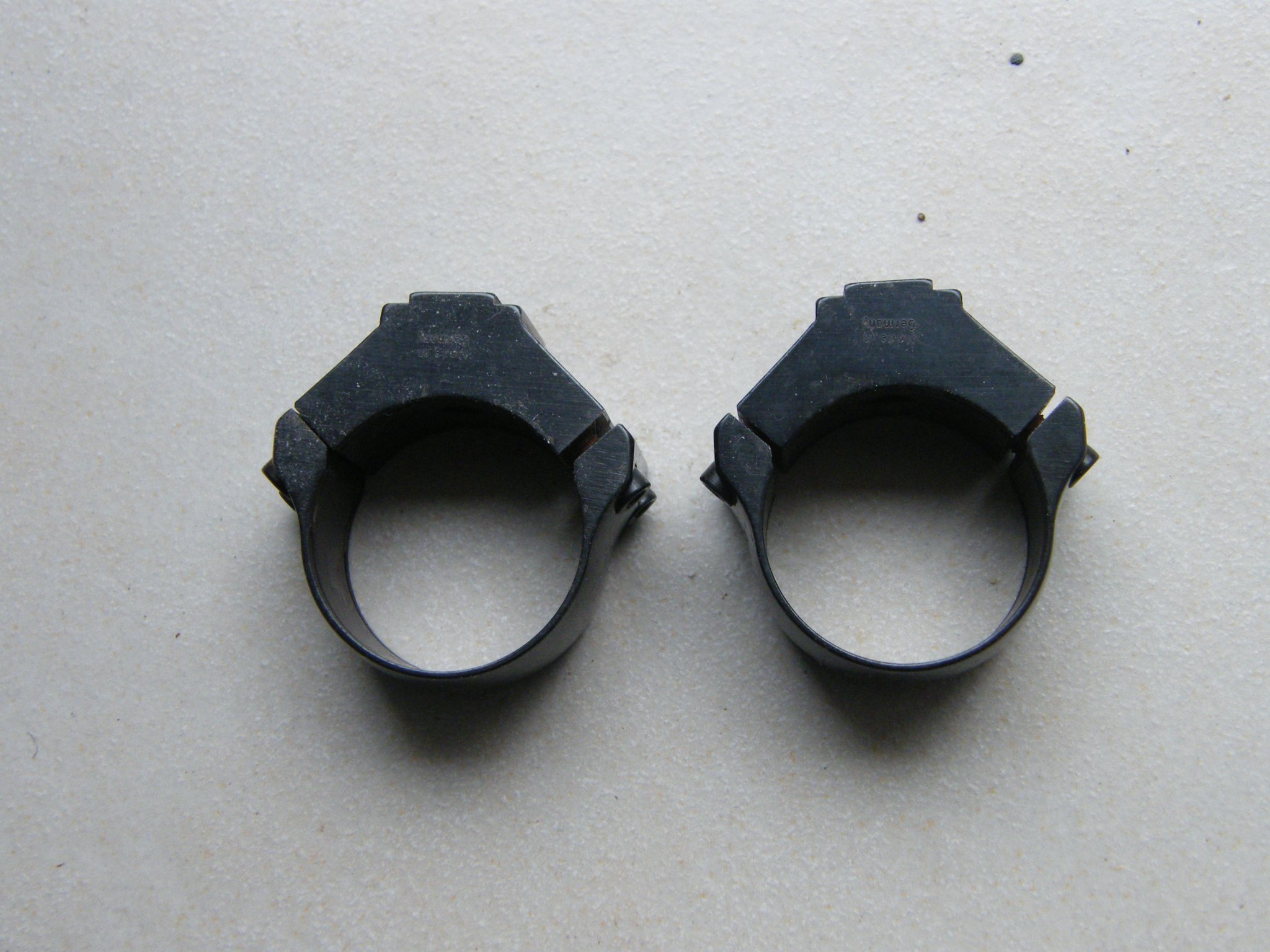

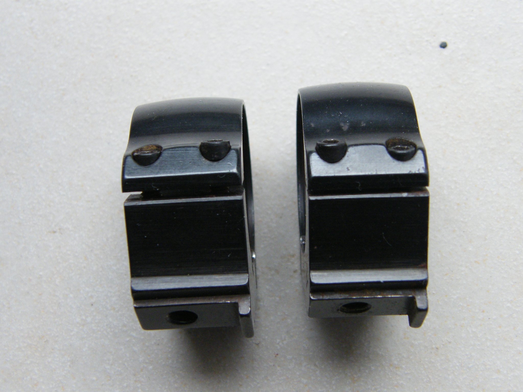

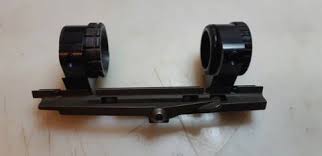

I am looking for an A.r.m.s. 21 for a friend, and the rail stanag A.R'M'S. 6 ? do you find any in the United States? in France I can't find
Scarce on the ground here too. I got my set off ebay from a company called Mounting Solutions but their website shows they are out of stock and Ebay does not have any listed.

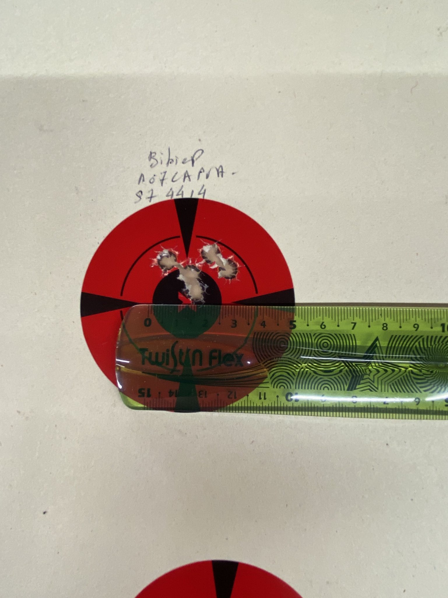

My plan is to test as many cartridges as I can.
in France, arms21 necklaces have not been found for several years either.
there are still stanag collars in france and germany from mastsie PGM and EIS at the beginning of the year I managed to find the eaw manufacture special stang collars for GIGN from 1980, very rare collars.
for the cartridges, yes test the maximum. you put the photos of your shots
………at the beginning of the year I managed to find the eaw manufacture special stang collars for GIGN from 1980, very rare collars.
could you please post photos of the rare GIGN rings? It would be interesting to see them.
It will be a few weeks until I go to the range as it is still hotter than hades around here, and, yes, I will post photos of the various groups by cartridge brand, ……….no matter how embarrassing……..

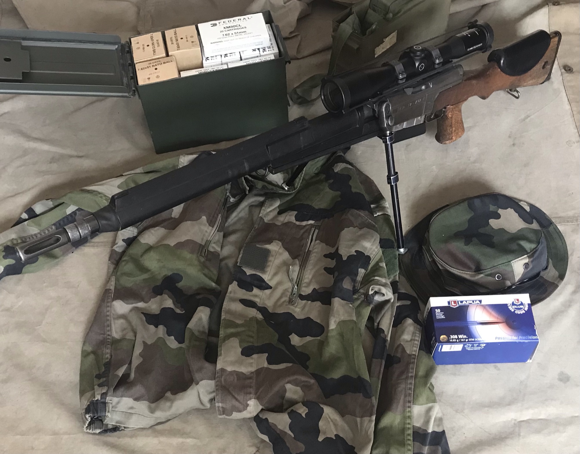

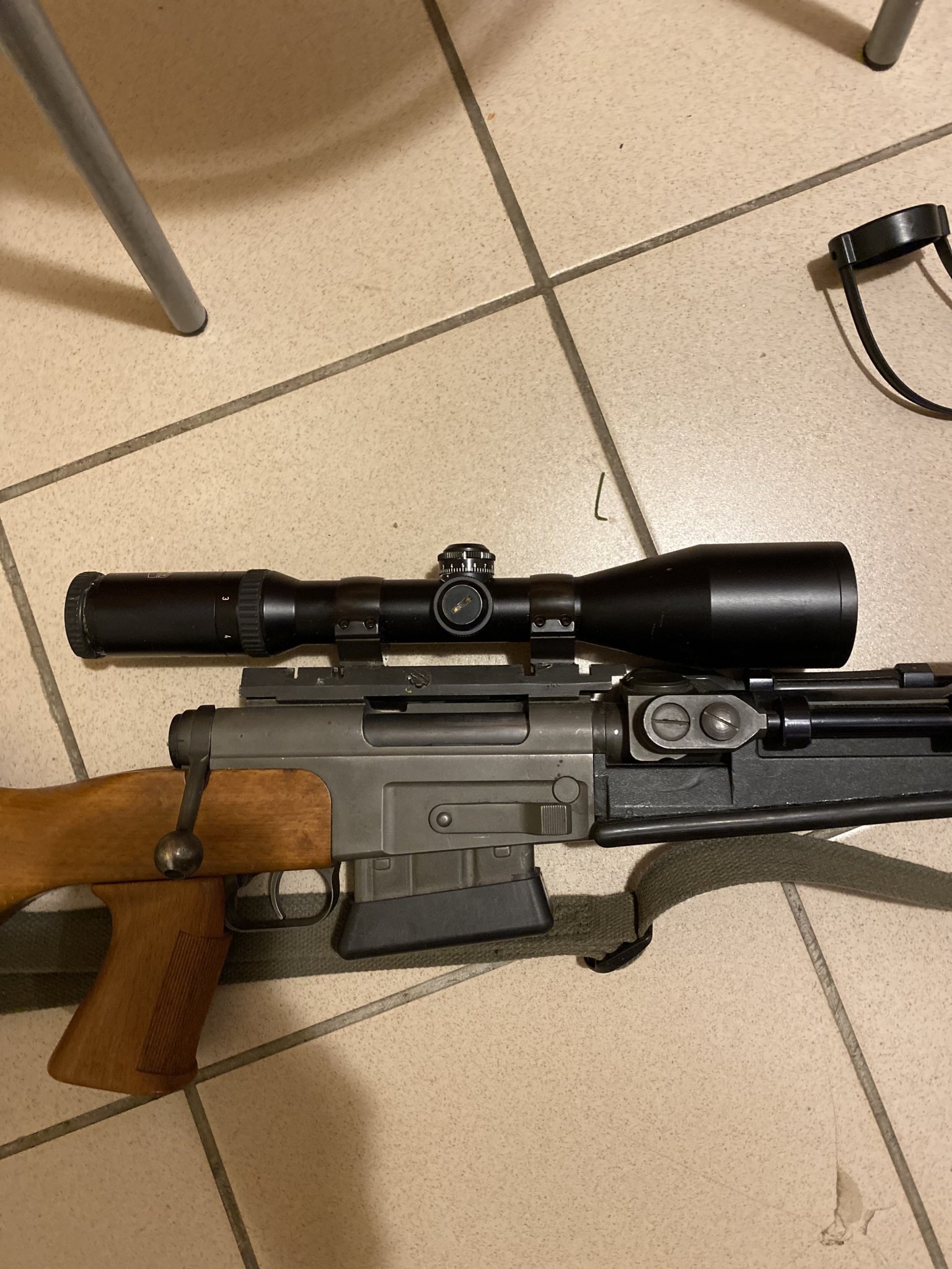

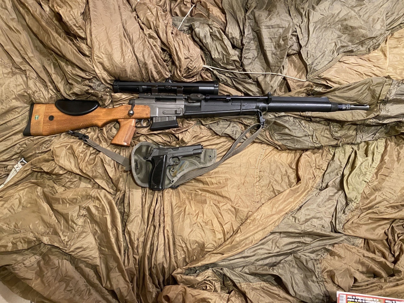

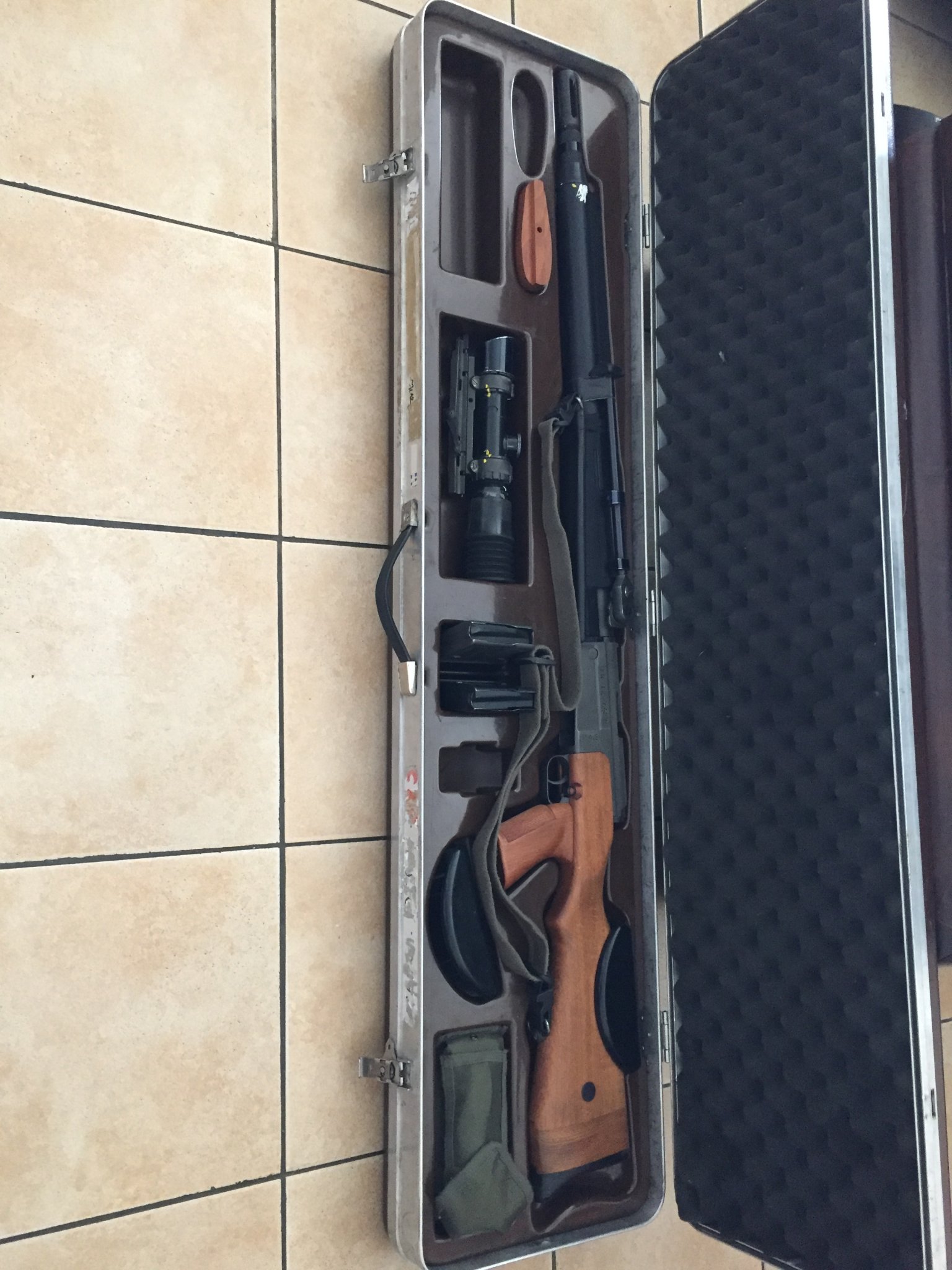

I got it my rifle and it’s cool as a jewel!! I apologize for the lousy photo but a photographer I am not. It’s got a Schmidt Bender 6x42 scope with the A7 reticle. All I had.
Pictured with a French camo shirt and Boonie hat as well as ammo. I was able to find some Lapua 167gr loaded cartridges. I also found 300 Lapua bullets - 167gr - for when I start reloading this caliber.

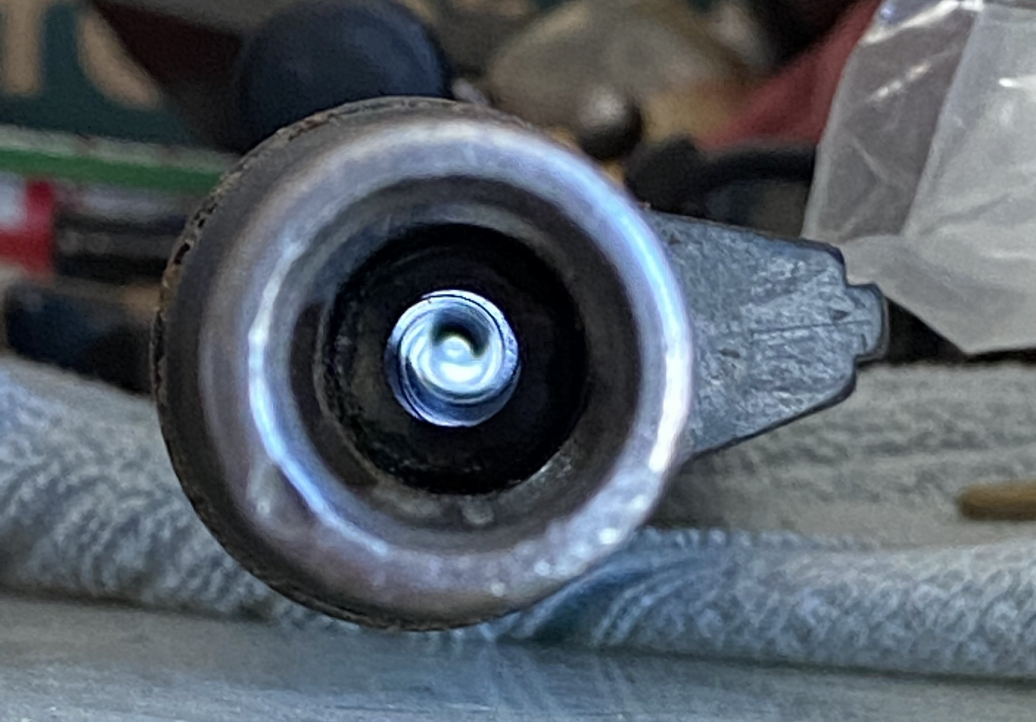

My barrel is clean and has visible rifling but I do not have the expertise to determine how worn it is. I tried to photograph it without success. Does someone have a photo of what an acceptable GIAT 3 twist FRF2 barrel should look like? I guess shooting it would demonstrate whether it was still accurate or not but the weather here is not cooperating.
Hello Levallois,
to know if the barrel is good, of course there are gauges, and measurements indicated the dimensions, gauges, measurements in the book of the army the MAT 11084 manual of repair of the rifle frf2.
if not the easiest, see make test shots with supported shooting distance 200 meters, on 10 cartridges you must not exceed 6 cm in diameter, that class, the weapon is precision. And 40 centimeter and 600 meter the barel is good for precision
if on 200 meters the grouping of the 10 cartridges exceeds 12 centimeters diameter the barel is ruined.

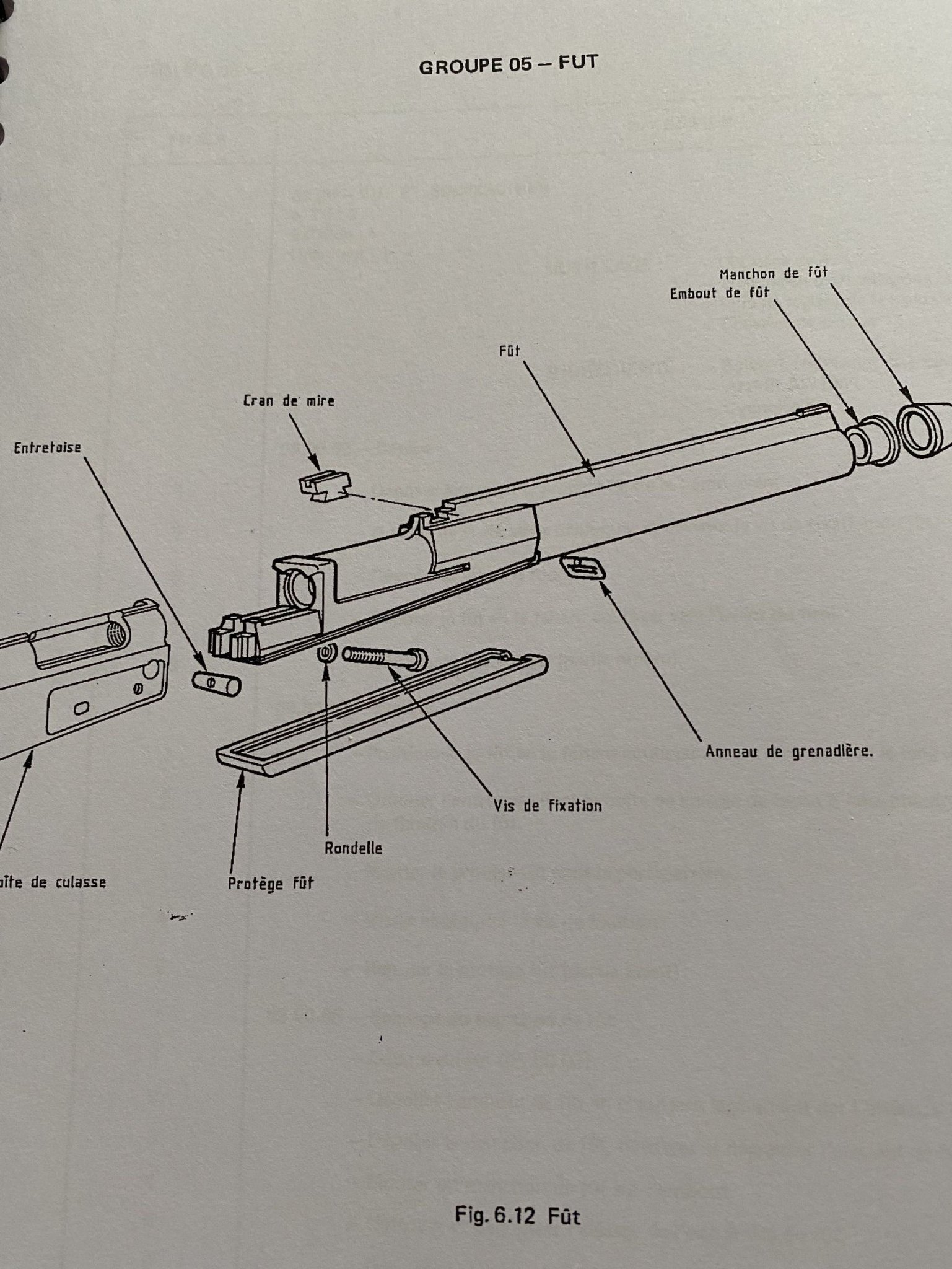

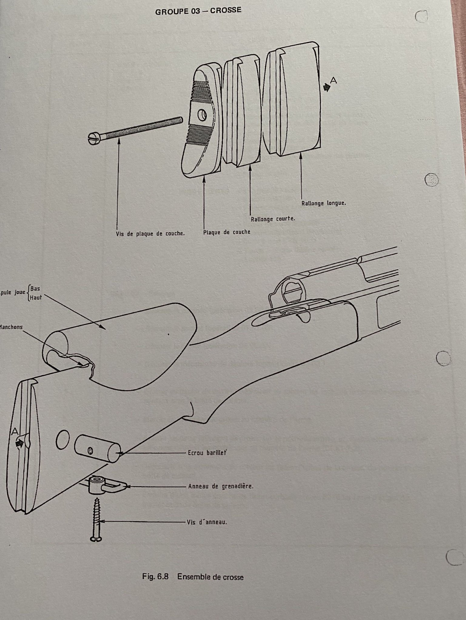

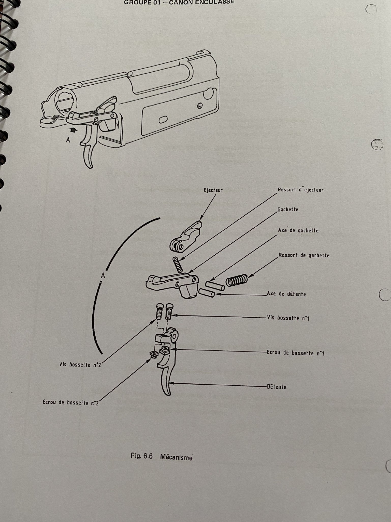

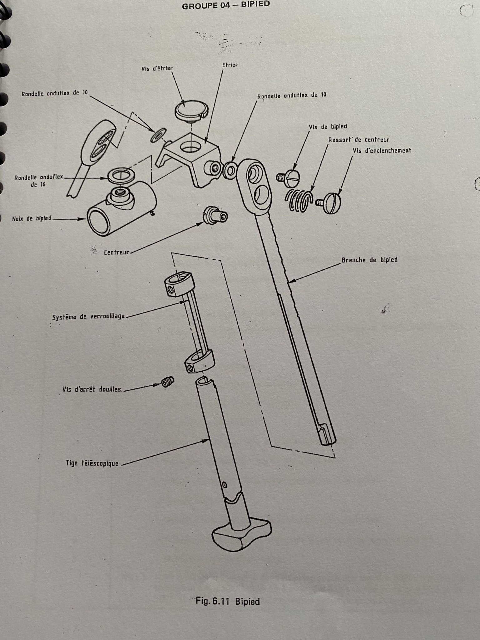

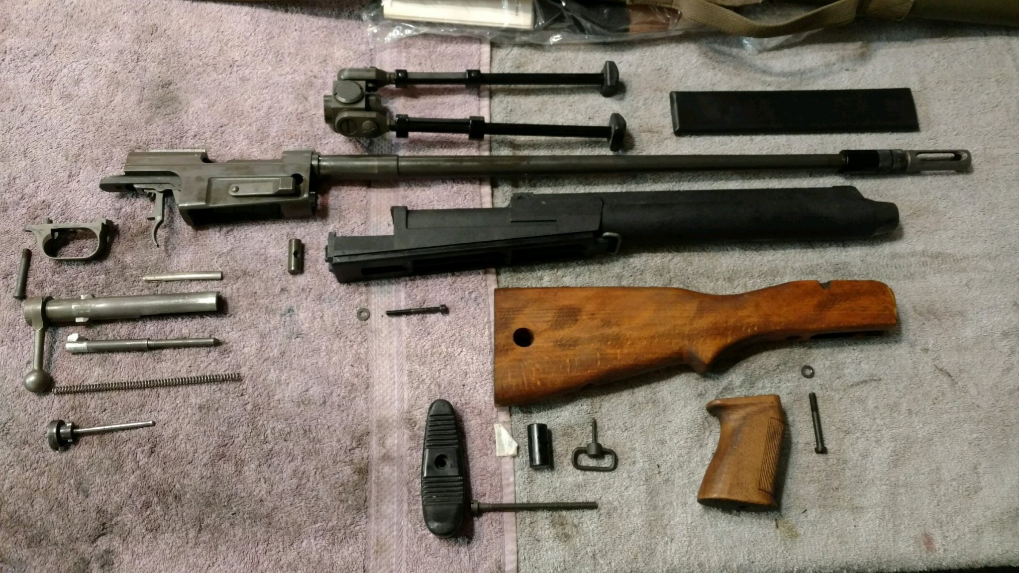

This thread was dangerous! Pulled the trigger on a FRF2 from EuroOptic. Could not be happier with its condition, matching numbers and accessories. Thank you Ricardo for the diagrams!
