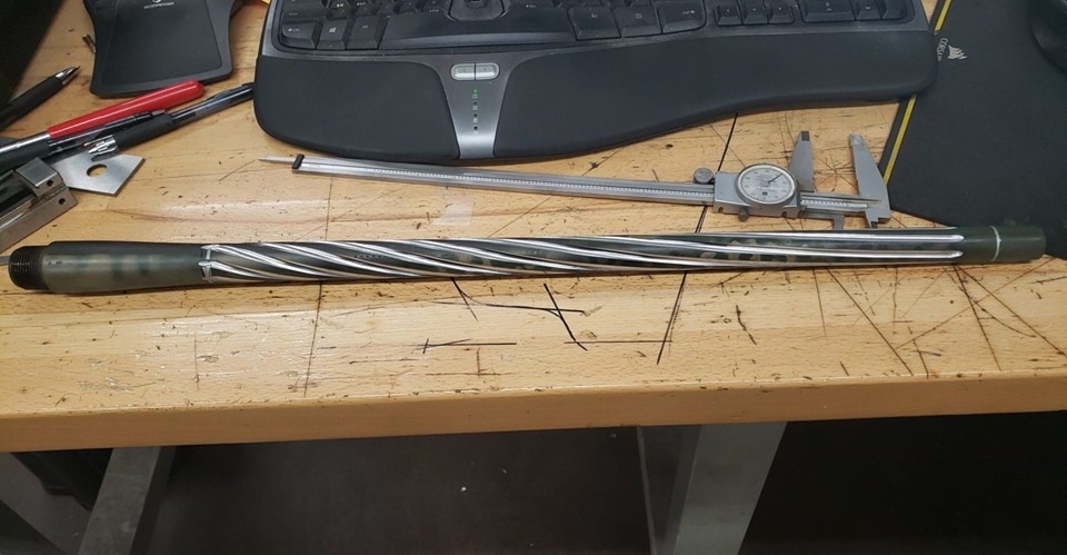

    This has been an after hours project that guys have been working on. Goes like this:
    Go to site, choose it. Game out your desired rate of twist and the progression. Select it, close the deal. The code generates automatically and is stored via your SO number. Once your barrel arrives (or a blank we have in stock) it's loaded and Kalyb simply pulls the SO and hits "cycle smash".
    It's that easy. The front end code work is 99.9% there. Building it into the store to follow shortly.
    Kinda cool. Were not the first to offer this particular style, but I do think were breaking ground in that we are offering it as a truly flexible system that you (client) desides exactly how it plays out.
    Fun stuff.
    This is one of a few test pieces done on take offs.

    Looks badass but wouldn't the gain twist be in the opposite direction inside?
    And that's what a 8:1 to 100:1?
    Could you even do something like that inside?

    Here's a vid clip we did last night. A few small changes remain. Gotta get rid of the G53's at the end of each pass.
    I"m not very good at posting vid clips from FB to forum so I apologize for this thing looking stupid with a bunch of extra clutter.
